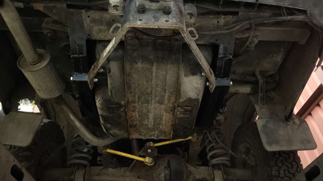

Tow bar mounts are now fitted so hopefully with some paint on it the tank and towbar can go back on, let battle commence tomorrow
Tank thrown back in, exhaust on and towbar booped in with  new m16 bolts

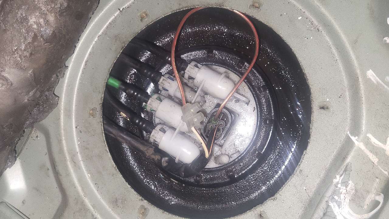

The bloody live pin for the lift pump had overheated and melted out of the socket so i removed it and fed some new wire through the hole and connected outside of the tank so it should be sweet now IMG-20241216-WA0010.jpeg.da0288e932df7a4b318edd42650aca48.jpeg
Then pulled the iveco back for its welding session
IMG-20241216-WA0000.jpeg.707f2f8f82e71c28a4fac290936041d9.jpegi measured and farted around making the chassis rail off the van and set about blasting it in place IMG-20241216-WA0004.jpeg.13531ca2d09e4fa08b59fce8f309e555.jpegIMG-20241216-WA0006.jpeg.a2e9ed613de5006395933950d21132e9.jpegIMG-20241216-WA0014.jpeg.1439f4ea56b87e1e3435330cb411aebd.jpeg
Just need a 100mm jub clip for the airbox and this one can go on its merry way

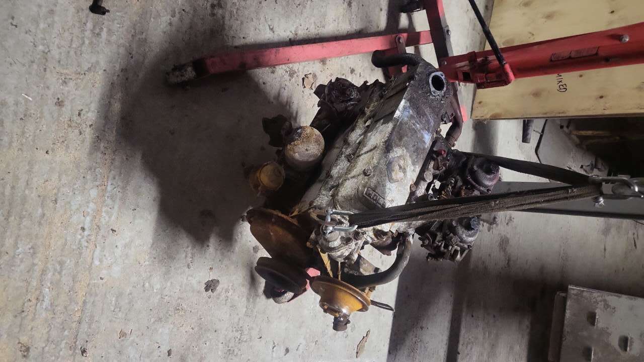

I robbed the 3.5 of its carbs to test the 3.9, and yes as suspected its in perfect order, nice clean waterways amd just generally such a sweet engine!

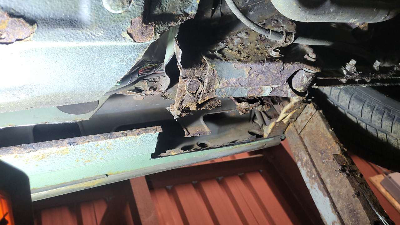

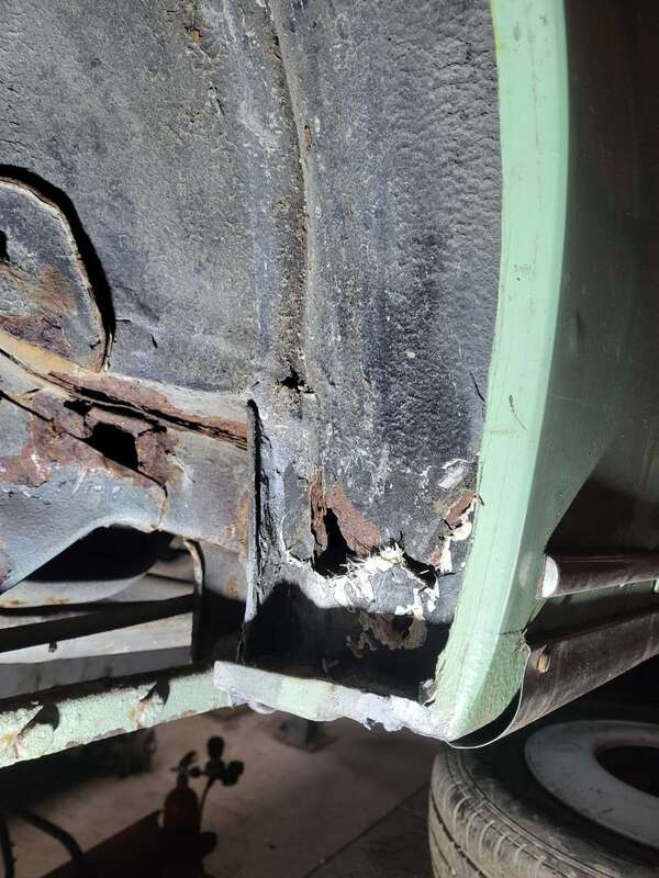

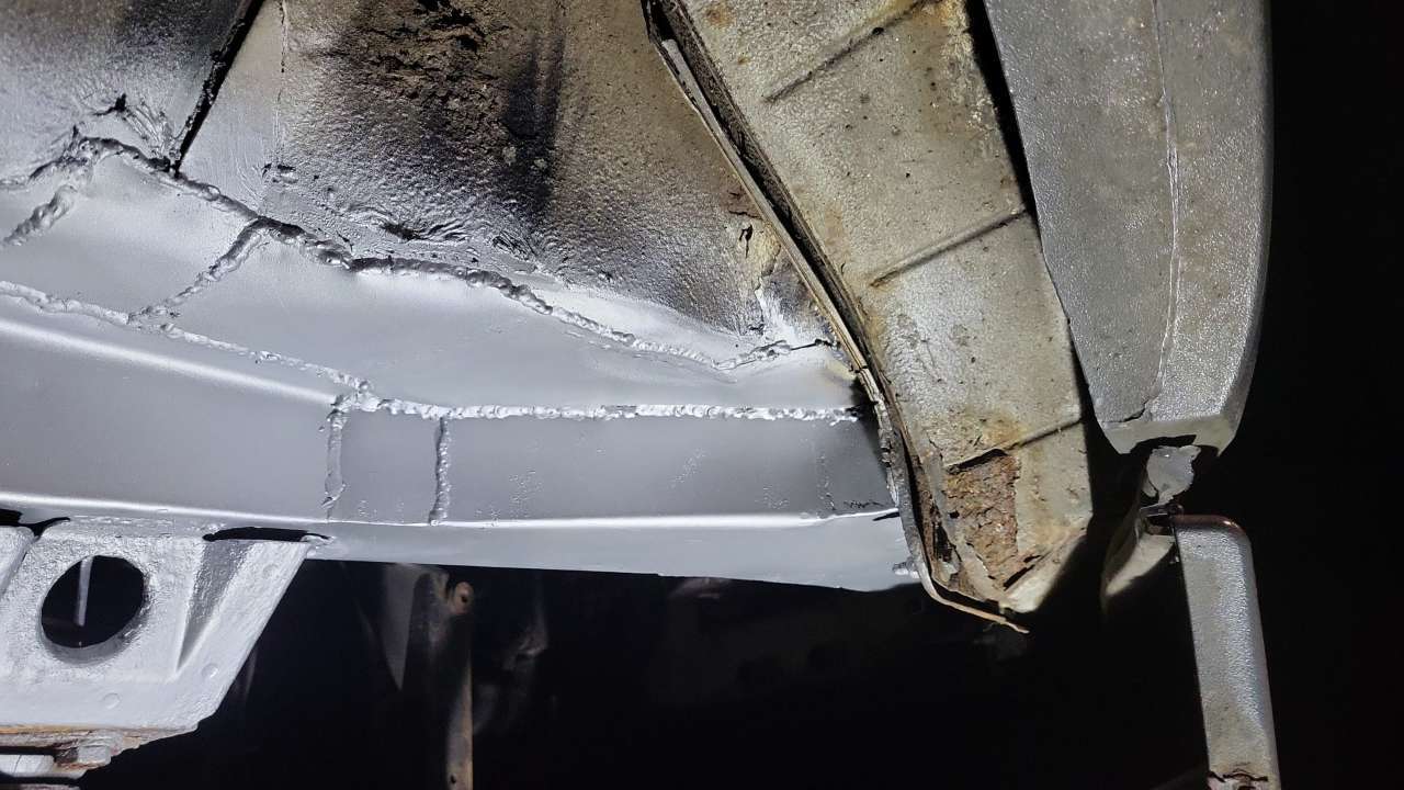

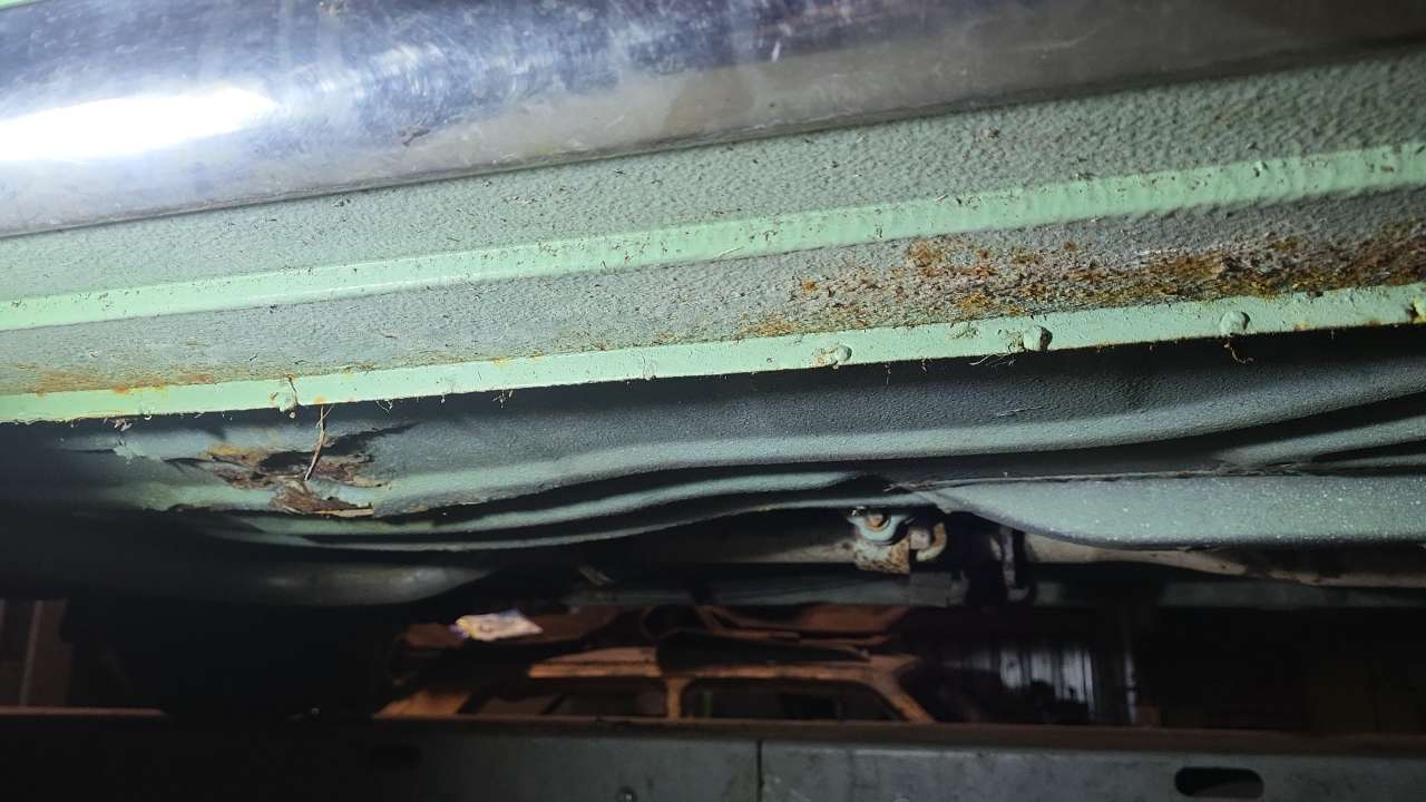

The new outer sill is barely attached to the rotten inner and floor via sparse and snotty welds
This was covered over with black sealant, pulling it off has revealed loads of tricky areas to fix
On this side there is some floatimg welds and yet more rot all along the inner sill

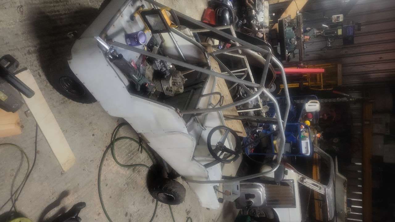

ended up with the daft buggy back again !IMG-20241223-WA0003.jpeg.b3254ffcbe58a9e06eec3d3228e5c493.jpeg

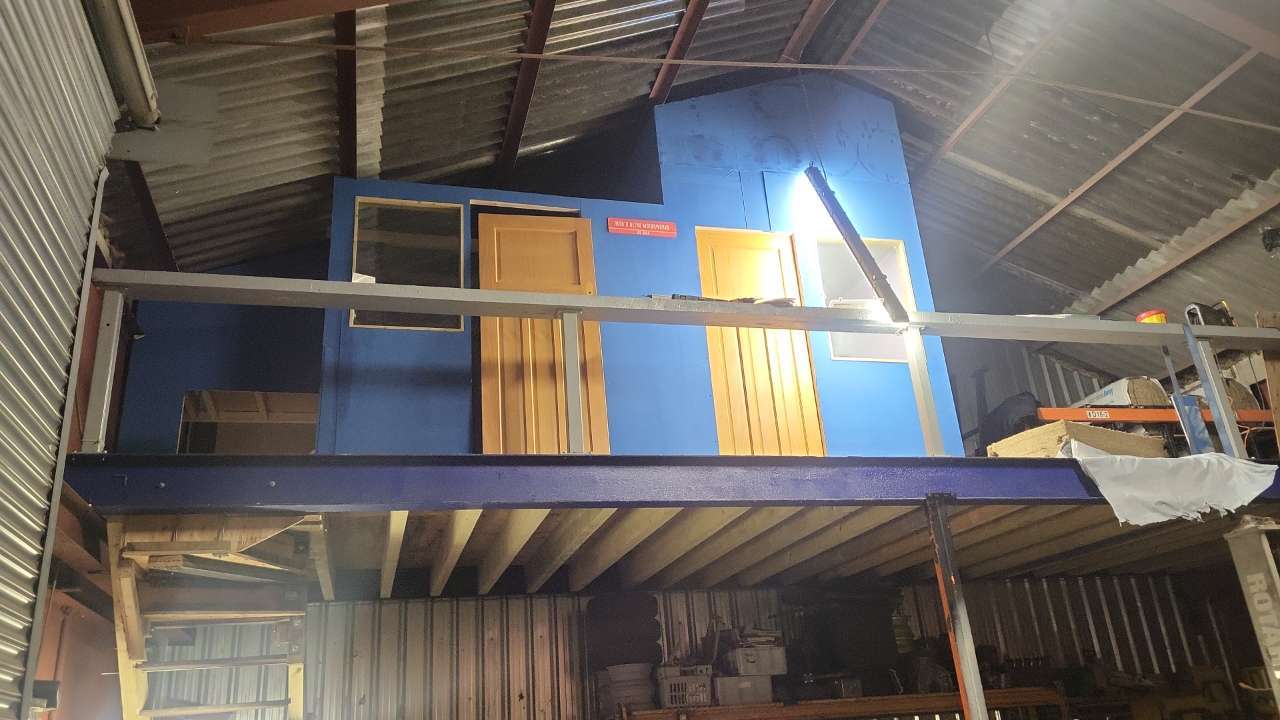

I painted the office walls lilac, the ceiling grey and the outside in our corporate blue, just need some shitey doors to fit and some cheap architrave

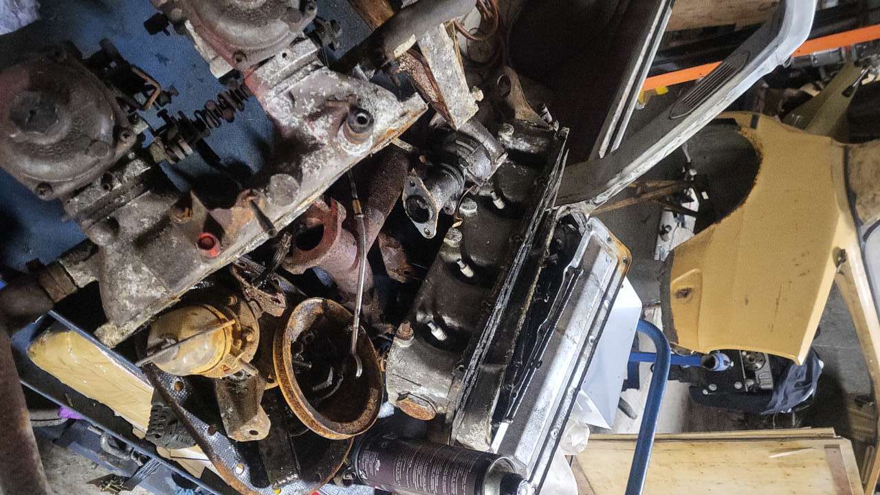

So with the pistons siezed into this i left it full of alkaline degreaser, given the split skirt pistons the freeing up was a given really but i aimed to have them out without undue stress to them as being +20 means they will go again, one issue though since removing them is that 1 cylinder is bloody toast with a huge shallow pit of corrosion  so thats never going to work without something like a +60 over bore
Option A is another block to bore put to +20
Option B is to find the final Oversize pistons
Option C the wildcard would be to turn down a liner and bore the block to accept it however the chances are that it would be mega hard to achieve a uniform interference fit IMG-20241231-WA0002.jpeg.b08eb51a65c725945d1dcdaec8f2f86a.jpeg

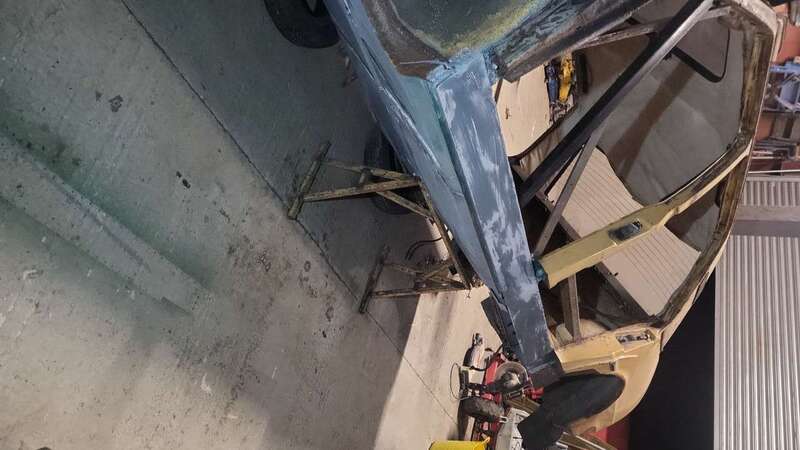

Spent today on this as id cleared it out of shit from inside, underneath,around it and ontop, then set it at a nice working angle, the workshop was getting on my nerves due to having a big unit that I couldn't use and loosing everything instantly, so a big sort out has helped immeasurably!
I made up the inner sill castle section and rear box section, repaired the 2 crossmembers and blasted the mega zinc around it

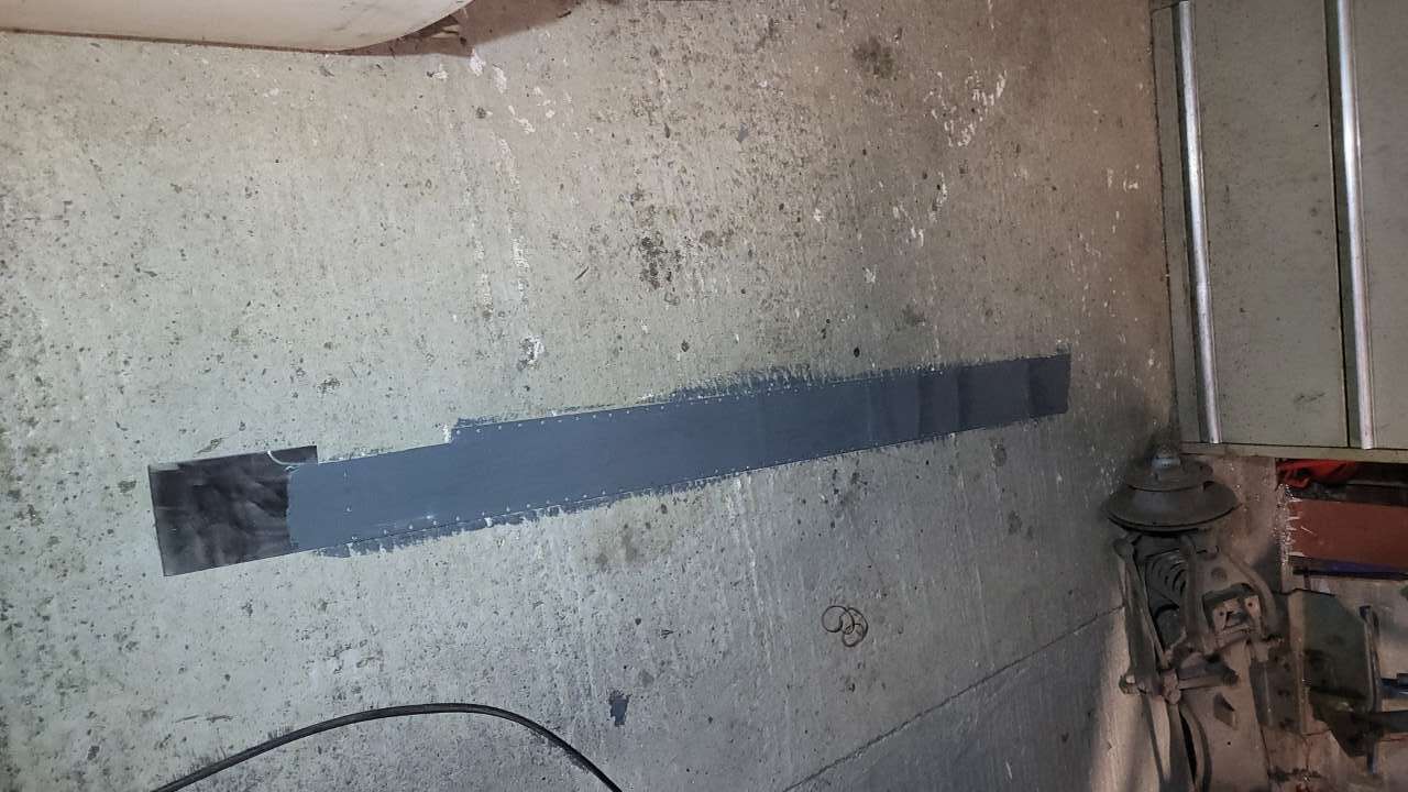

this has been hanging around for ages now, the inner sill, so drilled 150 holes in it and roughed it up as the coating doesnt really stick well otherwise
glad to have go this far as the saggy shell was just sat miserabley in the way as a kind of crappy impractical shelf

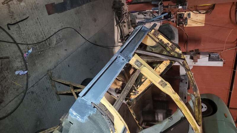

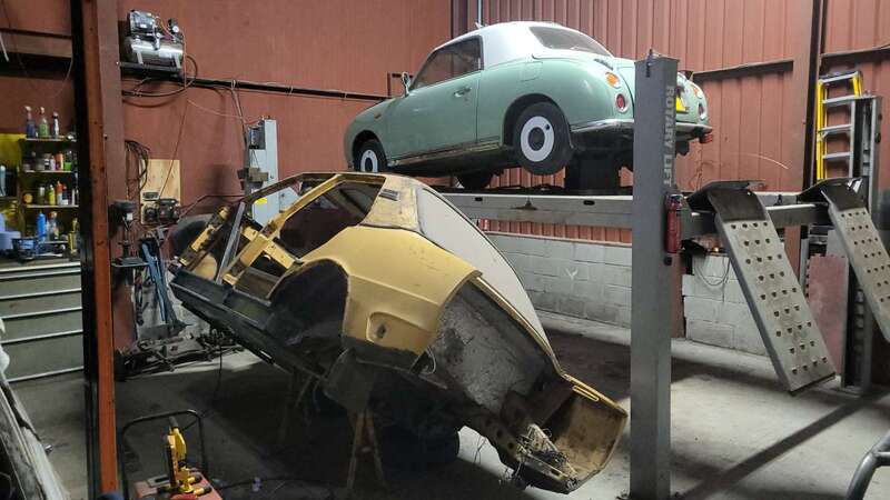

also this figaro,,,for actual FS its going to be a battle getting this right ....IMG-20250107-WA0009.thumb.jpeg.21ae129a4be5a9267f89183f9cf9a2ac.jpegIMG-20250107-WA0007.thumb.jpeg.3a1aef81153d195c5365bc6bd52ed8e7.jpeg

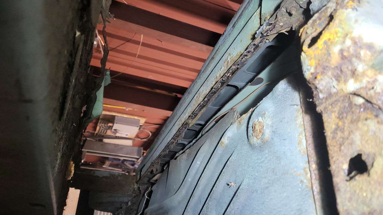

The floorpan is ribbed in all manner of directions, the rear suspension mount is hiding alot of rot with terrible access so I'm going to have to mess about piecemealing it all back together ,,hate doing it like that but don't want another 4 week marathon with a payment battle
Figaro looks very Acclaim-esque underneath. You have my sympathies!
Finally got the inner sill panel attached so it's hot at least rigidity to the structure now !

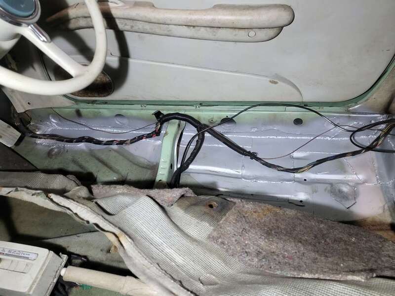

I trimmed down the c20se loom to something less chaotic by trimming out the useless stuff like the washer motor and engine bay faff but there's a few bits of the injection loom that have been messed about with oddly so I need to find a relevant wiring diagram for bosch motoronic 4.5 to make sense of it to run

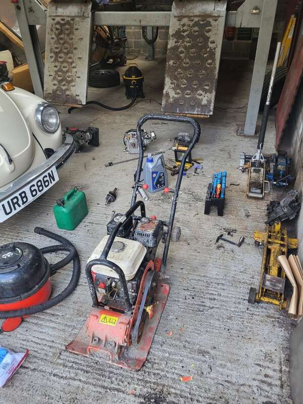

Next up I got a wacker plate dropped off with a blown up gx200, easy I thought untill I swapped the engine over and discovered the wacker clutch uses a 20mm shaft rather than a 3/4" one so I had to swap cranks over to the replacement engine!

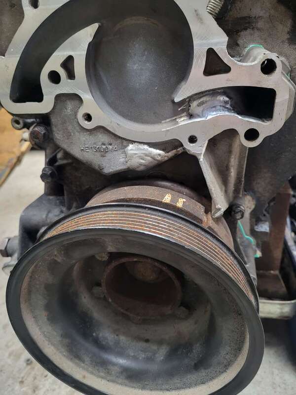

I had to pull the timing cover off the 3.9 for a stuck stud in the block and I bastard cracked the cover with the slide hammer in a threaded boss, so I got it off and a better welder than I got it fixed for not alot 20250112_215937.thumb.jpg.92fb4af4287f235f157ce03f628ad060.jpg20250117_115312.thumb.jpg.4ee88c11c12458b6f64a404eefc278eb.jpg
Sometimes I wonder with tools, mild steel 🤔20250117_123210.thumb.jpg.e209513cedcfe775402251132d9b8bac.jpg

Finally got the figaro sorted both sides, what a tricky bugger it was and tbf it really won't be a long term car unless it's rust proofed to oblivion

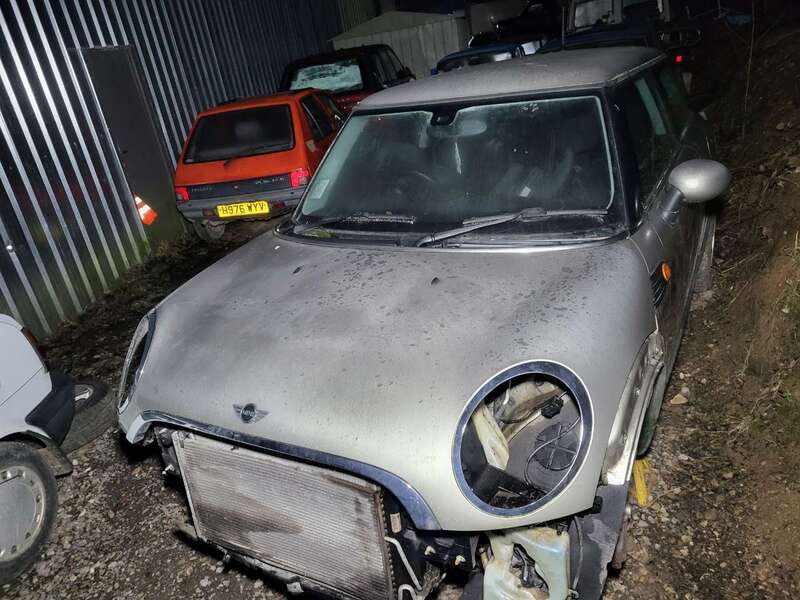

the mini is breaking up well, still got loads of decent bits on it however 20250125_180402.thumb.jpg.d8ca4273cc594c21d96029654a0bcf9f.jpg

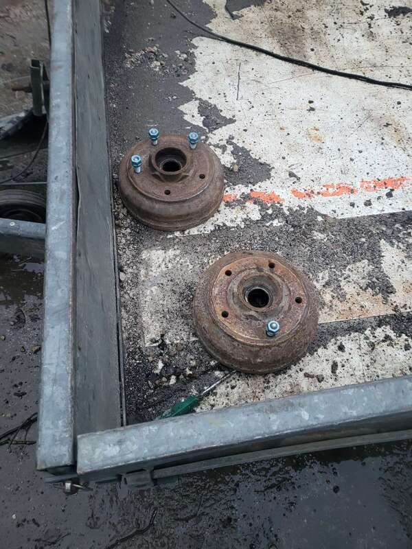

An Ifor williams trailer needed some studs as the threads had pulled out of the drum so drilled them out to 15.3 and banged in some transit ones

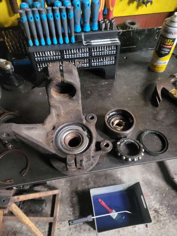

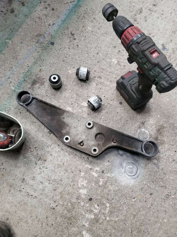

p38 and disco 2 share this stupid rubish where a buggered swivel balljoint boot means a physically demanding strip down for abit of rubber, now as it basically means removal of the hub and half shaft I figured it's daft not to swap the £7 joints!
20250129_181103.thumb.jpg.f0f859eab193ad156ae69d4b23baccc0.jpg20250129_190607.thumb.jpg.df525e74f22dff7e57ca5859283c39f8.jpg
I made the tool out of impact sockets bored to suite the balljoints and some 40mm steel plate, it was more of a struggle to lift it in place than use it !

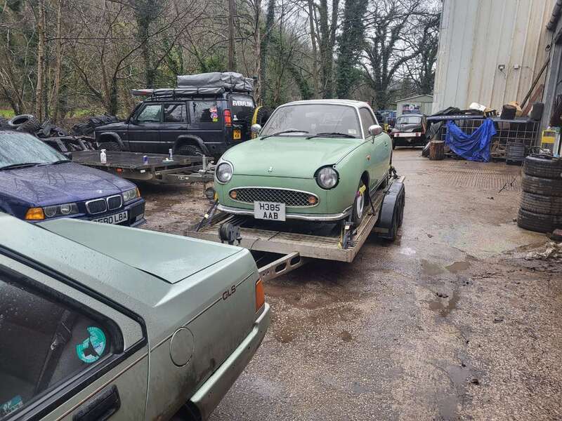

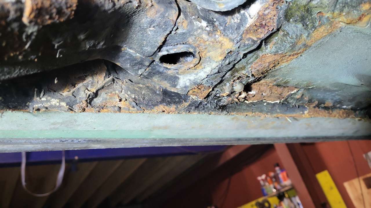

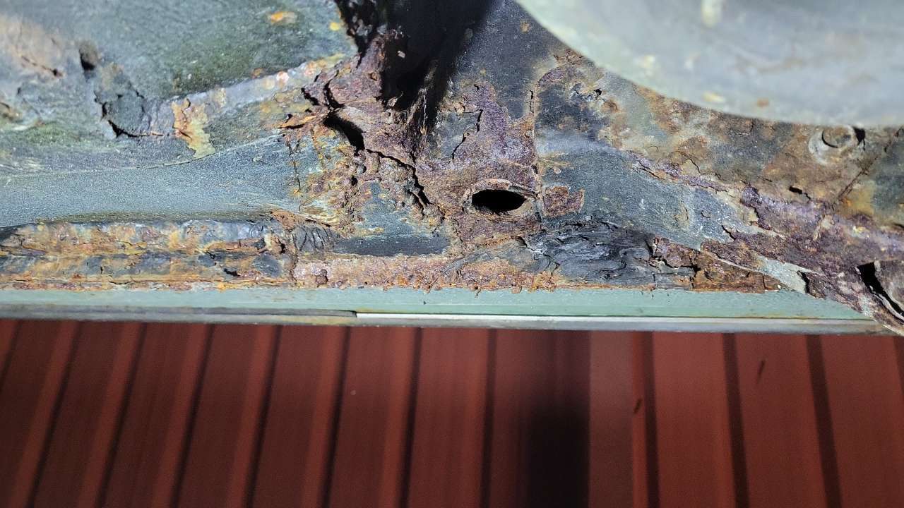

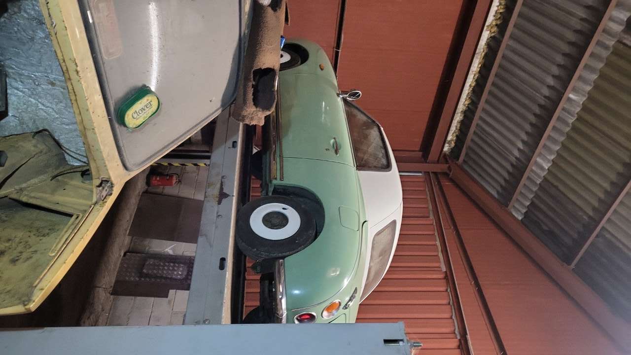

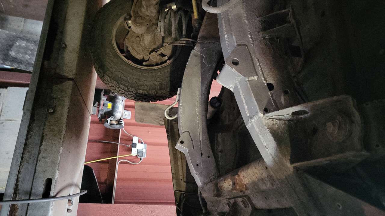

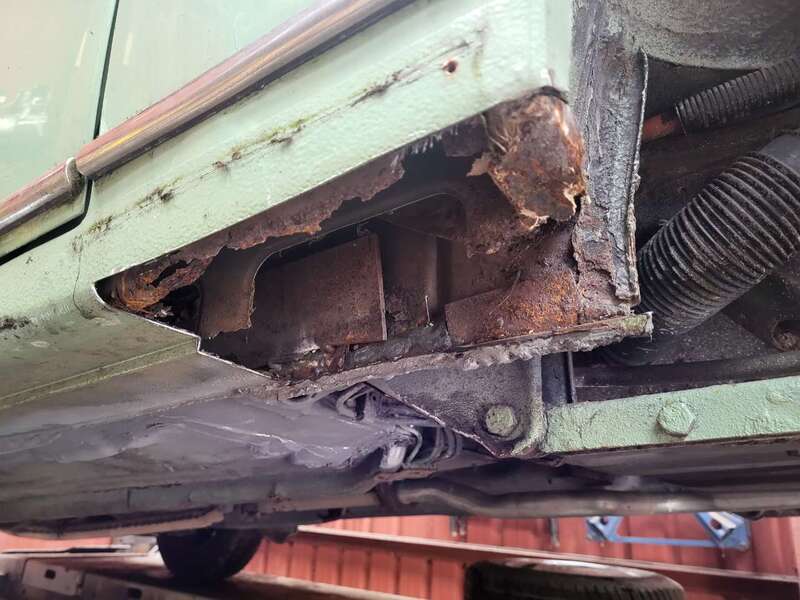

The figaro has become a ball and chain, so long story condensed, it failed the first Mot back in November due to welding , lights, trackrod ends etc, I welded it to the letter of the mot fail and booked it into the same garage as I prefer to use the same tester, anyhow I phoned up asking to drop it off overnight for a morning slot, they were fine with that, except when I went to pick it up they couldn't find an mot booking for it,,,bloody ell I'd mistakenly booked in somewhere else and I couldn't work out where !
So, it went into another mot place short notice where it failed even worse than it did previously on different things, more welding that I'd missed through not actually looking too hard at the restorers body filler and fibre glass shoddiness and the new rear brakes were said to fail due to not locking up.
the absolute state of that shit, 5x100 flat bar pushed into the inner sill and pigeon shitted in place!!
20250205_142822.thumb.jpg.1166b2be75b2ac8b0b42b6fc46eefdf7.jpg20250205_142816.thumb.jpg.de96c9c194deb7ef19b5c3e011cd19c6.jpg20250205_142918.thumb.jpg.bd5190ee82619bacfdb29953044cc1b0.jpg20250205_143858.thumb.jpg.9bd3e50f319ce3d212c469b8de1e60de.jpg20250207_153436.thumb.jpg.0c9fef8f5920d13fe4fb3bbfd0d9f835.jpg

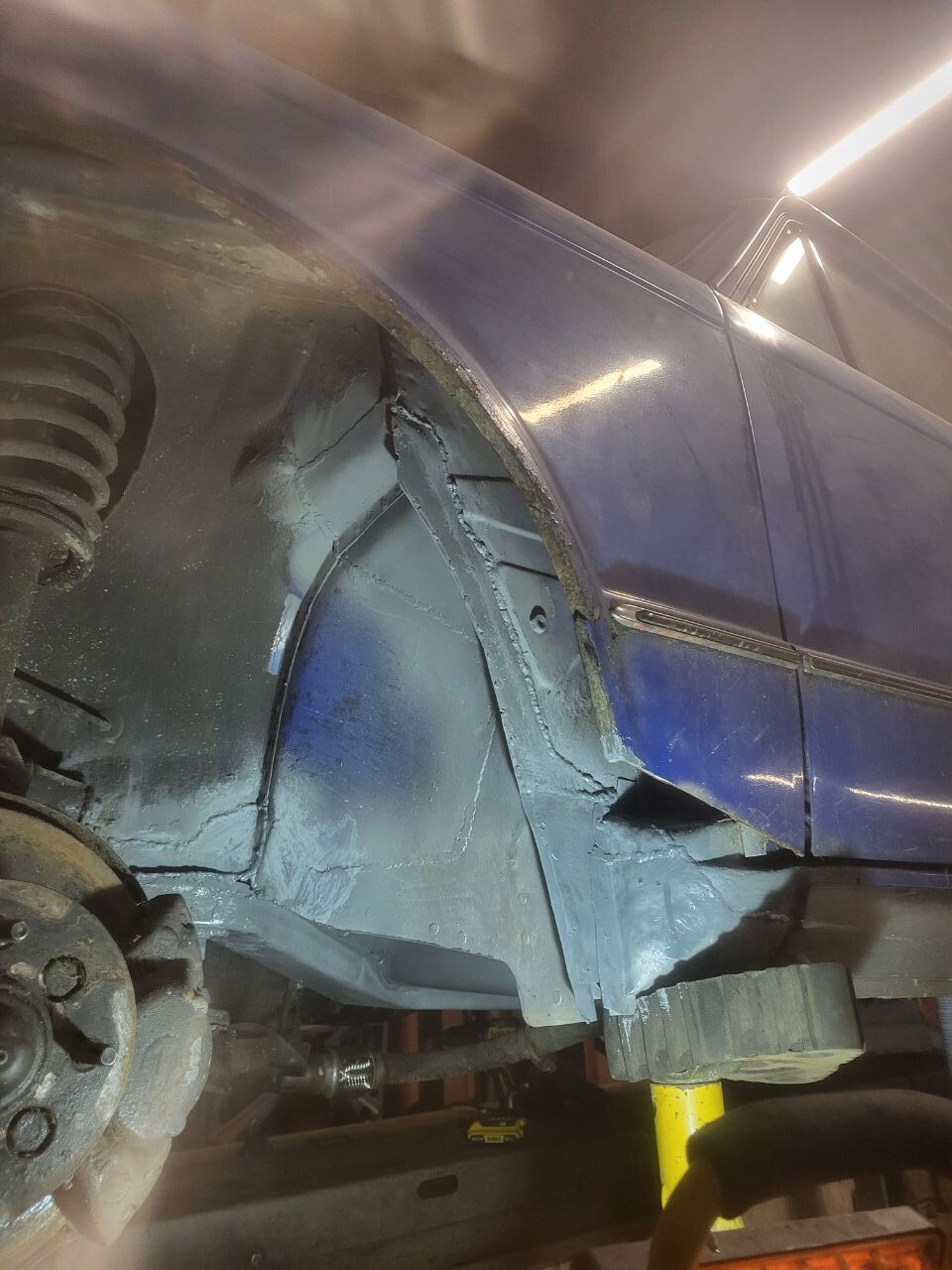

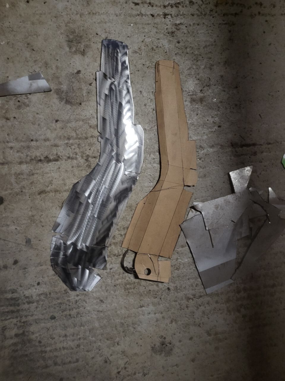

The chassis rail and all that was sorted with some 1.6mm steel, I hate cars that have been bodged this badly by so called professionals, disgusting
20250209_222917.thumb.jpg.9149b1d45bc7c966065dd555df18f62e.jpg20250209_222938.thumb.jpg.06a78045a871165aa6409e394f645d91.jpg
All sorted but not the best with all the rubbish that remains inside the sills and chassis rails, it should have been either welded properly before painting or weighed in

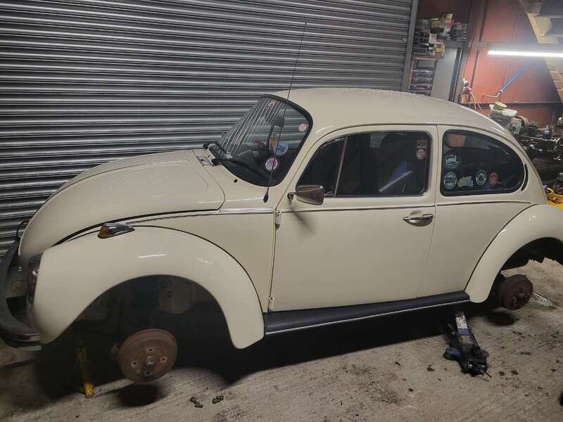

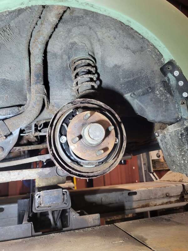

In an effort to get the back brakes to bite better , I've had the drums shot blasted to deglaze the inside as it was producing figures but aparently not enough, my feeling is the modern car brakes factor is playing havoc with the testers opinion maybe20250206_230335.thumb.jpg.2010fa7654a2a581192632556158f457.jpg

Has the Fig already had sills fitted over top the originals or are they supposed to be double skinned?
Oversills have been badly tacked on leaving the original rotten one inside, and the floor/inner sill and inner arches were freshened up with filler, fibreglass and black sealant to conceal the work that should have been done before painting the car
A classic "professional restoration".

I dropped this in for the retest and it failed on rear brakes, so I asked about figures and it was doing about 60 kgf on the service brake, similar ish on the handbrake, so when I got back I ragged it down the lane we have to see how it behaved, I could fairly easily lock the wheels on the handbrake, not so much on the footbrake, I'll stick some wheel cylinders and flexis in to see it it will improve matters, I kind of think the tester wasn't pressing the pedal hard enough as everything else they were testing was current upmarket luxury cars 20250210_143826.thumb.jpg.960ade2e5d4b92c4bd52cd5c863f0bd4.jpg
^^^ this is making me look like an absolute idiot

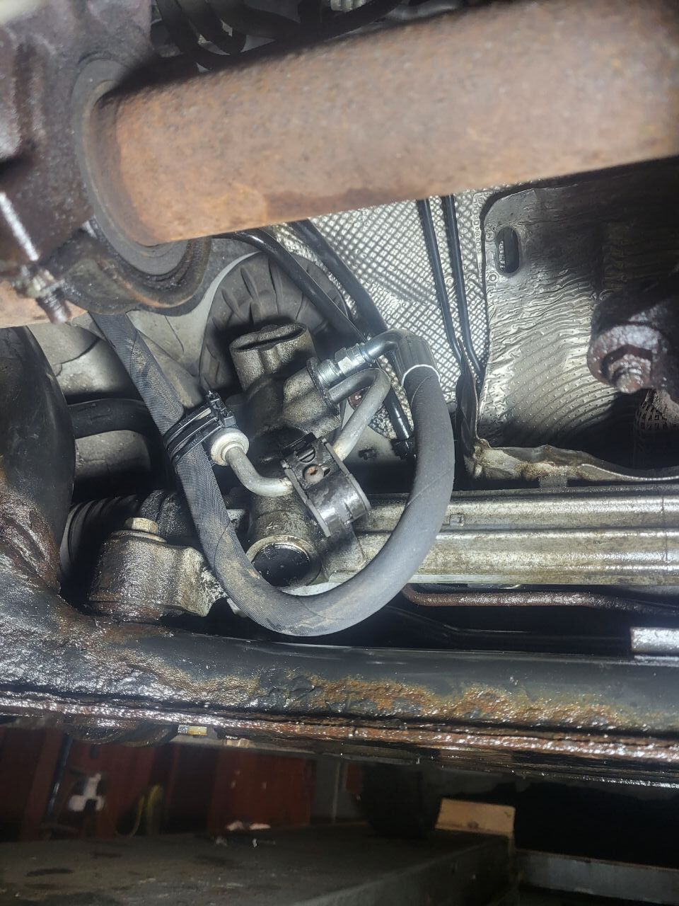

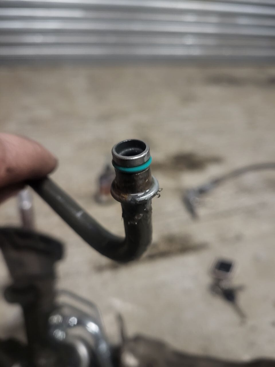

Focus mk2 and abit steering rack leak from the 'o ring'
I got the specific o ring to fit from ford but it made it worse, a second hand rack likely would be similar and a recon was mad money, so I tapped it for a 1/4 bsp nipple and had the line joined to a cone seat swivel

The figaro passed the mot after abit of research the brake test is just usually testers discretion on pedal application so I tried it out to see what the brakes were doing under proper load
All locked up so I asked the tester to press on decently to negate the effect of testing modernity

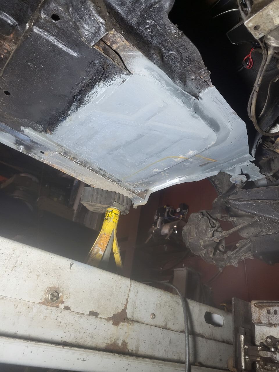

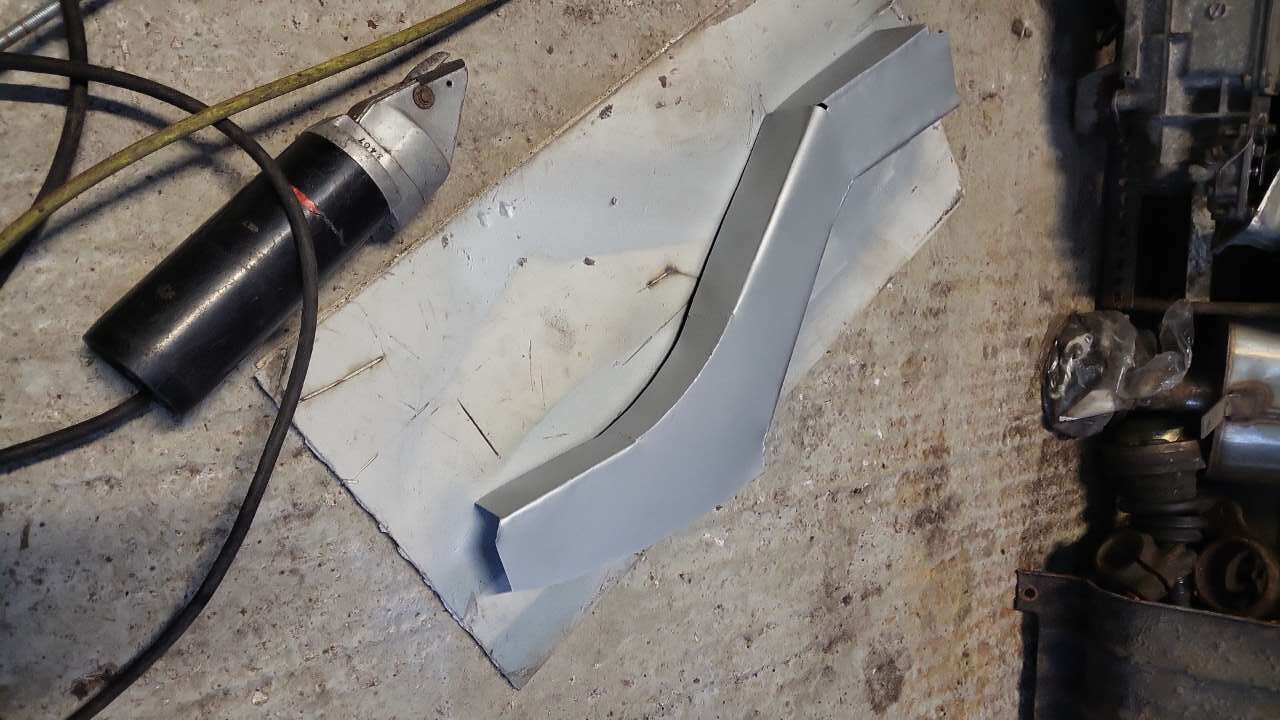

got the chassis rail cut out and hammered into shape, the area it was going onto prepped and it got carefully welded in, the rail was painted internally and will all get the wax blasted in to try and keep it all sweet
20250228_183953.jpg.27155e845abd99a6da0d687a91cf029b.jpg20250228_184003.jpg.4e056caefbd6b73dee6271906ed0f54b.jpg

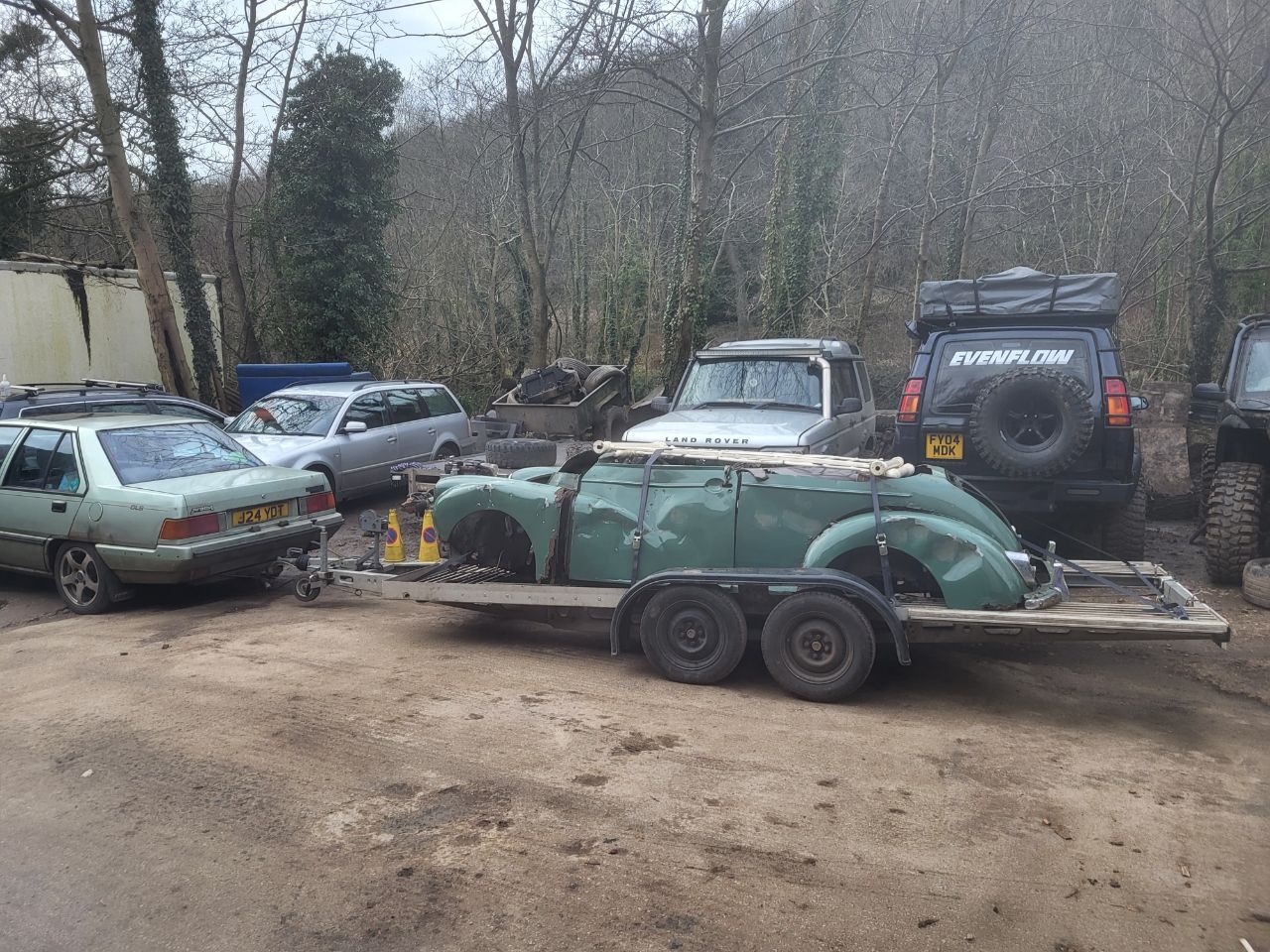

none rusty 205 was actually rusty, so this is awaiting welding work and reassembly for an mot
Ultra rotten minor came in, engine immediately sold as it ran well and it got stripped quickly for parts
^^^^this was not a shame, leaf springs through the floor, sill rotted off the A pillar entirely
Roof is amazing though, apertures are all perfect, drip rails etc and straight so is available for £100
