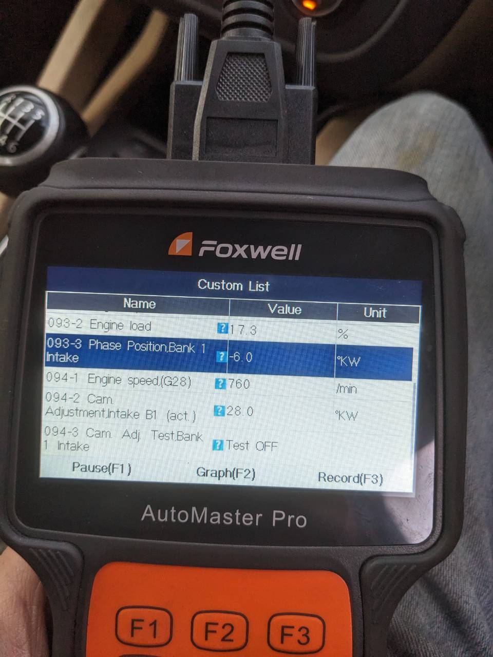

SiC Posted September 16, 2024 Author Posted September 16, 2024 It's somewhere earlier in this thread but the cam chain is at the limits of acceptable tolerances when I checked with VCDS. The engine still has really good compression when I checked that. So worth doing on it and tbh doesn't look that bad of a job (except getting the bolt out). It really does drive well and still feels pretty tight despite the mileage. I think it helps that a previous owner (to me) put genuine Sachs dampers on all round fairly recently. Likewise the springs are all not that old either. Probably would benefit from some of the bushes being replaced to tighten up things further but even right now it's still likely better than many a Golf Mk5 GTI out there. Dave_Q and hpi_matrix 2

SiC Posted September 16, 2024 Author Posted September 16, 2024 Trying to find a picture or reference to the cam timing but can't find anything on this thread flicking through. Anyway this was from my Foxwell reading the same measurement group and values I got on my (genuine) VCDS. The way I read it is that it's requiring -6 degrees to bring it back to correct timing. Which it's successful in doing as the demand is matching actual. Iirc max spec is +/- 6 degrees. So right at the edge of acceptable. Definitely worth changing and wouldn't be a wasted job imo. But then probably be fine for a while yet I reckon. My intention was to do it when the weather warmed up (I bought it in the winter) with the cambelt. But I ended up impulse buying the Z4 and needed to sell this to make room. Which seems to be my MO all too often! (Looking through the thread, I forgot how much time+money I spent on this versus how short I owned it 🙈🙉). That said, the Z4 I've probably enjoyed more over this summer as I missed my Boxster and having a convertible. My 330i does everything this did but makes better (6cyl) noises and it being auto is nice to have too. My view of them may change as we approach winter and both are RWD. 😅 (Also this GTI is lower on the liability scale especially with the spares than those BMW duo - which makes it more boring to me) Would be great if this became another forum bike. Great fun to drive and a car that isn't worth a lot as most want 60k to 100k cars. But those examples are twice to four times as much as this. Those that this end of the price range are invariably fucked and absolute dogs. Whereas this isn't. I see no reason why this car couldn't reach 300k. I always try to never buy the same model car again as always so much else to try. But this is one that I'd definitely consider buying back one time. Even just so I could give it a good spanking around a track. Super nippy turbo setup makes it a great runaround, while the (retrofitted) cruise and decent economy makes it good for longer runs too. Appearance is not embarrassingly scruffy but its not mint so you don't care about the odd car park ding.

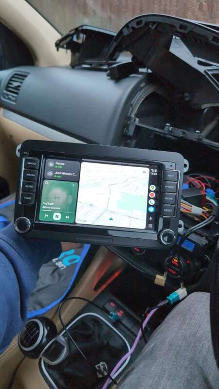

hpi_matrix Posted December 1, 2024 Posted December 1, 2024 Cheapo wireless andriod auto headunit fitted this afternoon. Would recommend. What will last longer? The car or the head unit? PLACE BETZ NOW Cento16v, Joey spud, rainagain and 1 other 4
Jazoli Posted December 2, 2024 Posted December 2, 2024 9 hours ago, hpi_matrix said: Cheapo wireless andriod auto headunit fitted this afternoon. Would recommend. What will last longer? The car or the head unit? PLACE BETZ NOW The head unit probably I’ve had no issues with any that I have fitted, VW’s however….
