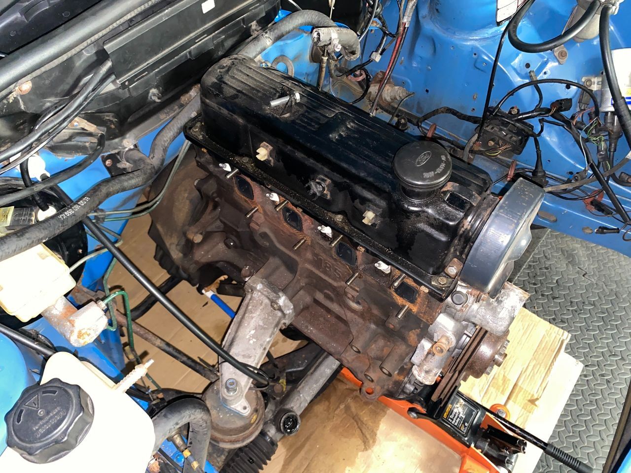

I have made further progress with getting the engine ready for removal.
I removed the exhaust manifold, still attached to the downpipe. Separating the downpipe from the exhaust is a matter of undoing two nuts and bolts and the manifold nuts came off in a couple of minutes. With the manifold and downpipe out of the way, I will have plenty of space to tidy up the engine bay.
On the other side of the engine, I removed the HT leads, fuel pump and associated hoses. I disconnected wiring for the distributor, temperature sensor, oil pressure sensor and a couple of wires that extended to the carburettor. I've taken plenty of photographs from every angle, so putting it all back together again shouldn't be a problem.
I wanted to remove the carburettor together with the inlet manifold as I am unfamiliar with the throttle linkage and choke mechanism and didn't want bits flying off in every direction.
And here it is, in all its glory.
So this is where I am now.
I've loosened off all the engine mounts' bolts so the engine is now almost ready for removal.

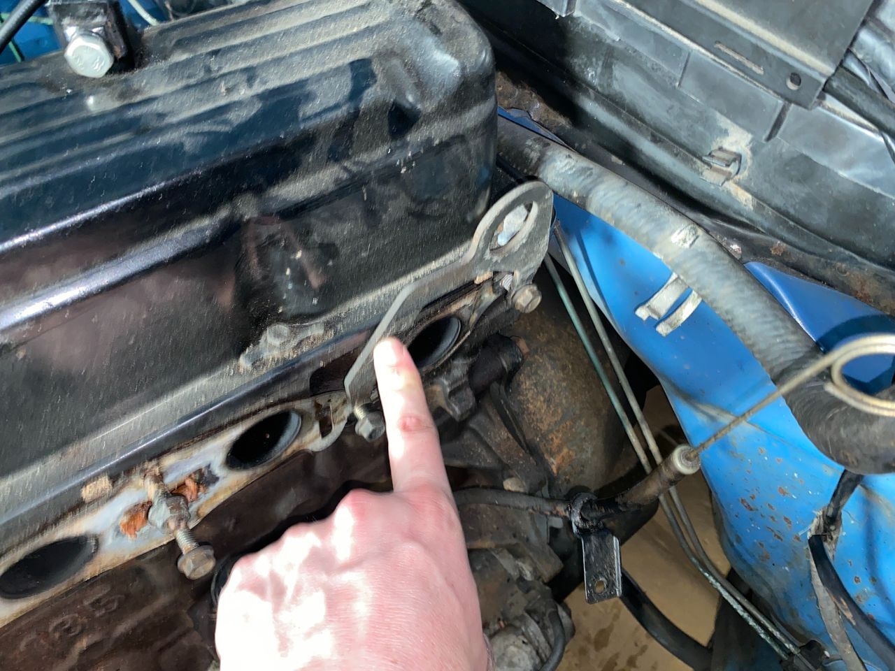

Ford very kindly provided a bracket for removing the engine. It's mounted on the inlet manifold side of the cylinder head.
Will I be able to lift the engine out by suspending it from this bracket? It seems to be located too far back for the engine to come out level.

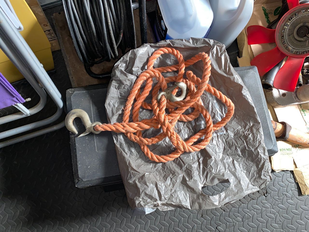

I propose to use a towing rope to lift the engine out. I prefer it to a chain as it won't cause any damage in the event of chain to metal contact.
Keeping the exhaust manifold on is unlikely to be of much help as the rope will not fit through the gaps between manifold and the cylinder head.

You should have an 'ear' like that on the frontmost exhaust port. That will allow you to loop something between them. Let me find a pic.
Here's when I lifted mine back in.
and the bracket at the front is visible here.
Re the paint. It was years ago since I last got close to a Sierra Pinto engine but the sump was painted black and I thought the block and head was too although it was only a thin pissy coat.
Maybe I'm misremembering things.
Noted, I will make a bracket to fit on the exhaust manifold side.

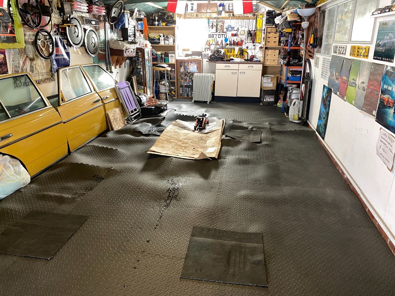

I came home half an hour ago and I could really smell petrol. I opened the garage doors and noticed that everything wasn't fine.

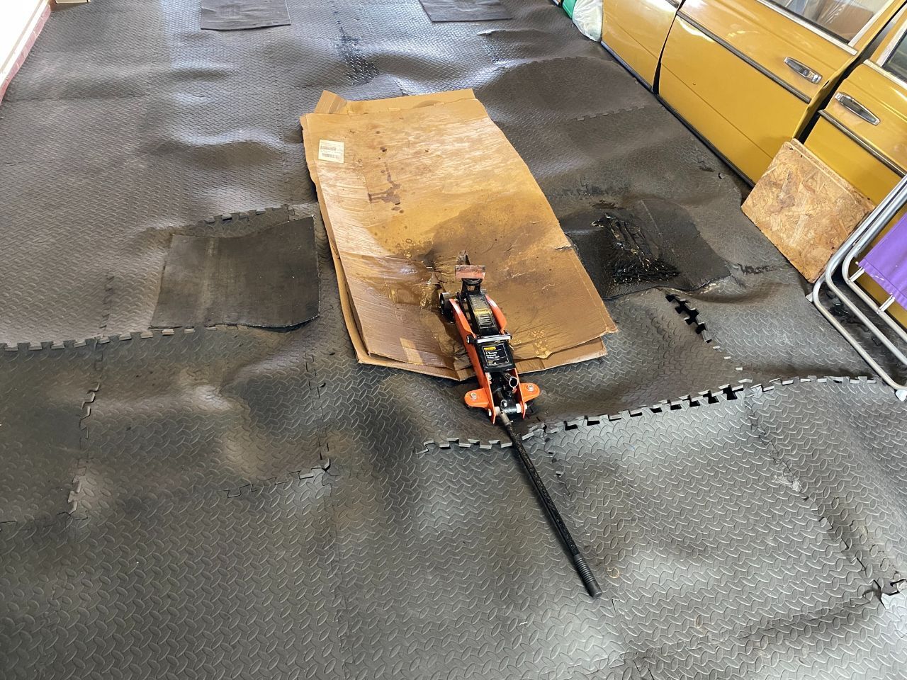

Fuel has leaked out from an uncapped supply pipe and saturated the floor, which has caused the floor panels to debond and distort. As you can imagine, the smell was intense.
I capped the fuel supply pipe.
Why didn't this fucking pipe leak a drop for approx 6 hours whilst I was in the garage yesterday afternoon and evening?
I'm going to have to pull the Sierra out of the garage and strip the floor back to the slab.
I will buy new flooring but will wait to install it until after I have removed the engine and gearbox.

As far as I’m aware Pinto engines always had a black painted block. It was different paint to the gloss or satin paint they used on the sump pan and rocker/timing belt covers. It was a bit like that funny black paint you spray on barbecue’s and stoves. It never seemed to last particularly well though and rust stains came through really quickly and easily.
On mine I’ve used POR15 engine enamel. Ford blue for the rocker/timing belt covers, gloss black on the sump pan and matt black on the block.

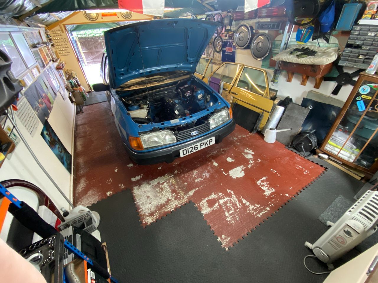

I tied the front section of the exhaust to the gearbox mount and pulled the Sierra out of the workshop.
The aftermath.
What a fucking mess!
Petrol melted the felt backing of a carpet tile that I used to protect the floor.

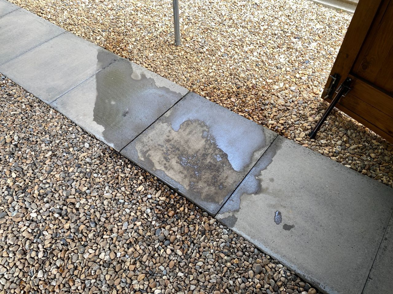

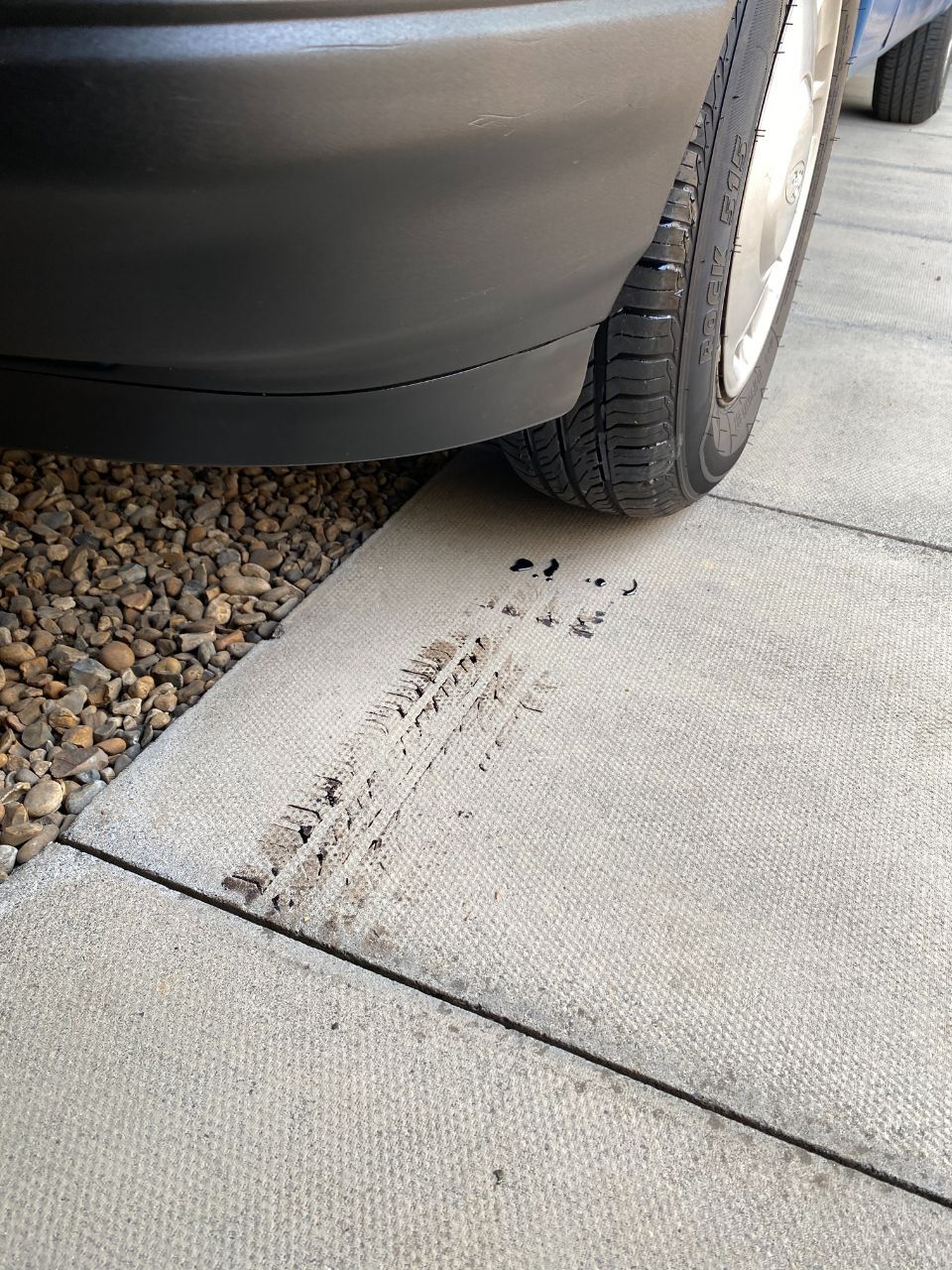

And whilst pulling the Sierra out of the workshop, unbeknownst to me the nearside front tyre deposited some of the melted felt onto the paving outside. Nice.

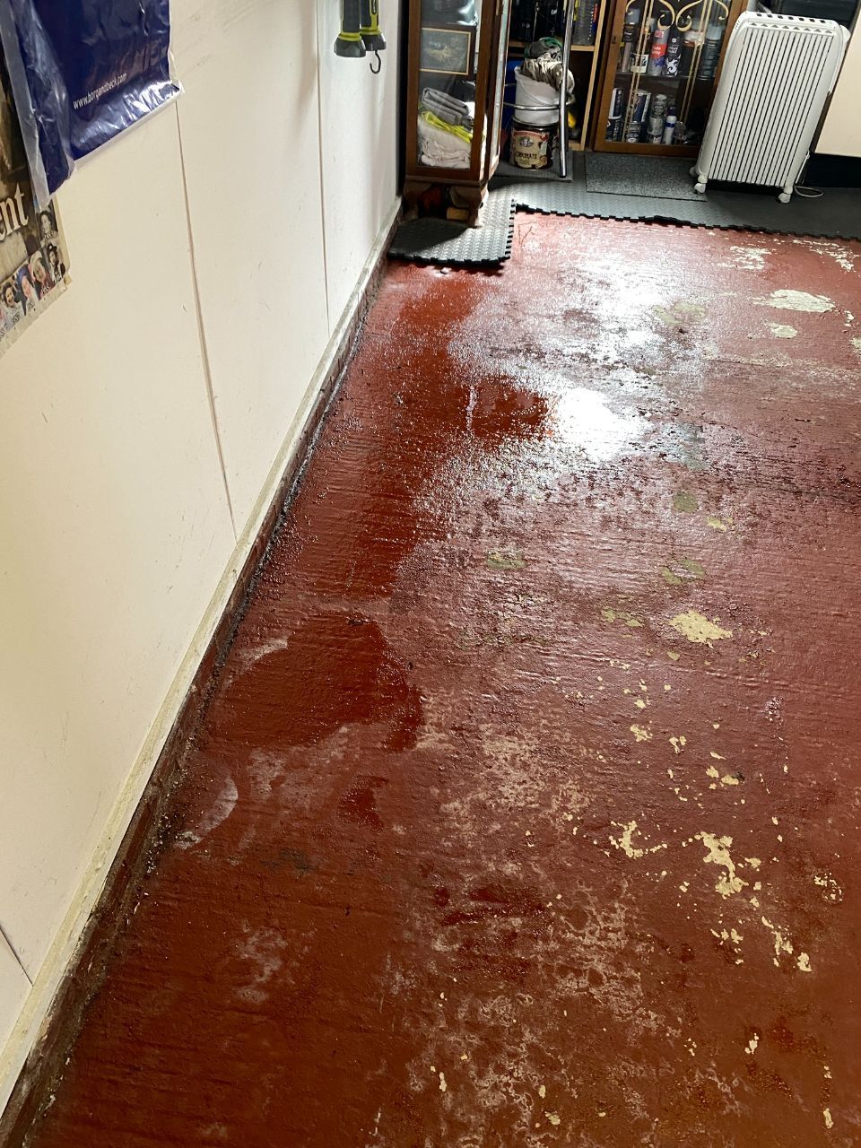

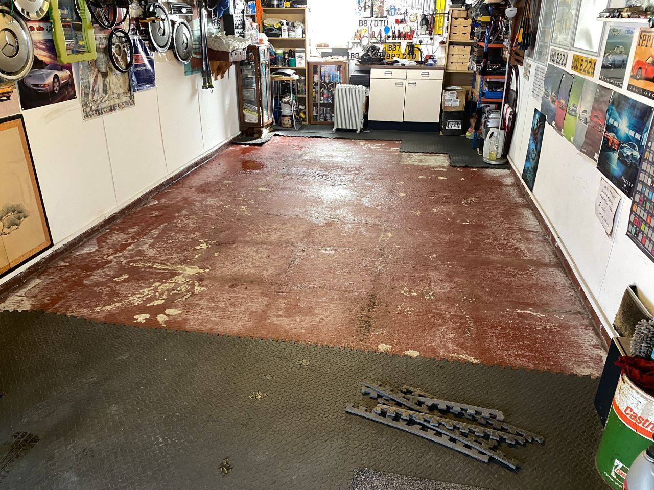

I removed the loosely stored items.
And pulled up the totally fucked floor tiles.
There were still pools of petrol on the slab.
Once I cleaned and dried the floor slab, I put everything back as it was before.
I cleaned the felt residue with petrol and rinsed it off with water.
Most of the staining came off ok.
I will be pressure washing the engine block and gearbox and will do the slabs at the same time.
