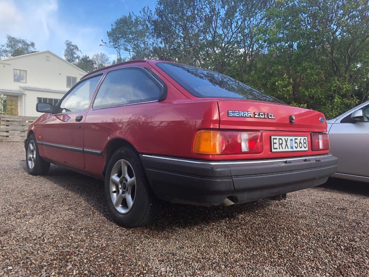

The doors were the same on all any contemporary hatches and Sapphire saloons.  The front doors are the same on estates, but the back doors are different.  Like a lot of cars really.
Most Mk2s had bigger windows and less metal around them.  I have attached a picture of a door, so the metal dimension was less on most Mk2s than Mk1s.  The exception was I believe some early Mk2s that still had the Mk1 window dimensions and deeper metal.  The difference is a bit subtle.
All, I believe absolutely all, Mk2s had the inner door pressing with the new arrangement for door cards.
Hence it was apparently possible to fix an early Mk2 by using a Mk1 door with the inner of a Mk2 door welded in.
Does it matter?  Well not really, unless you have one of those incredibly elusive early Mk2s and need a new door.

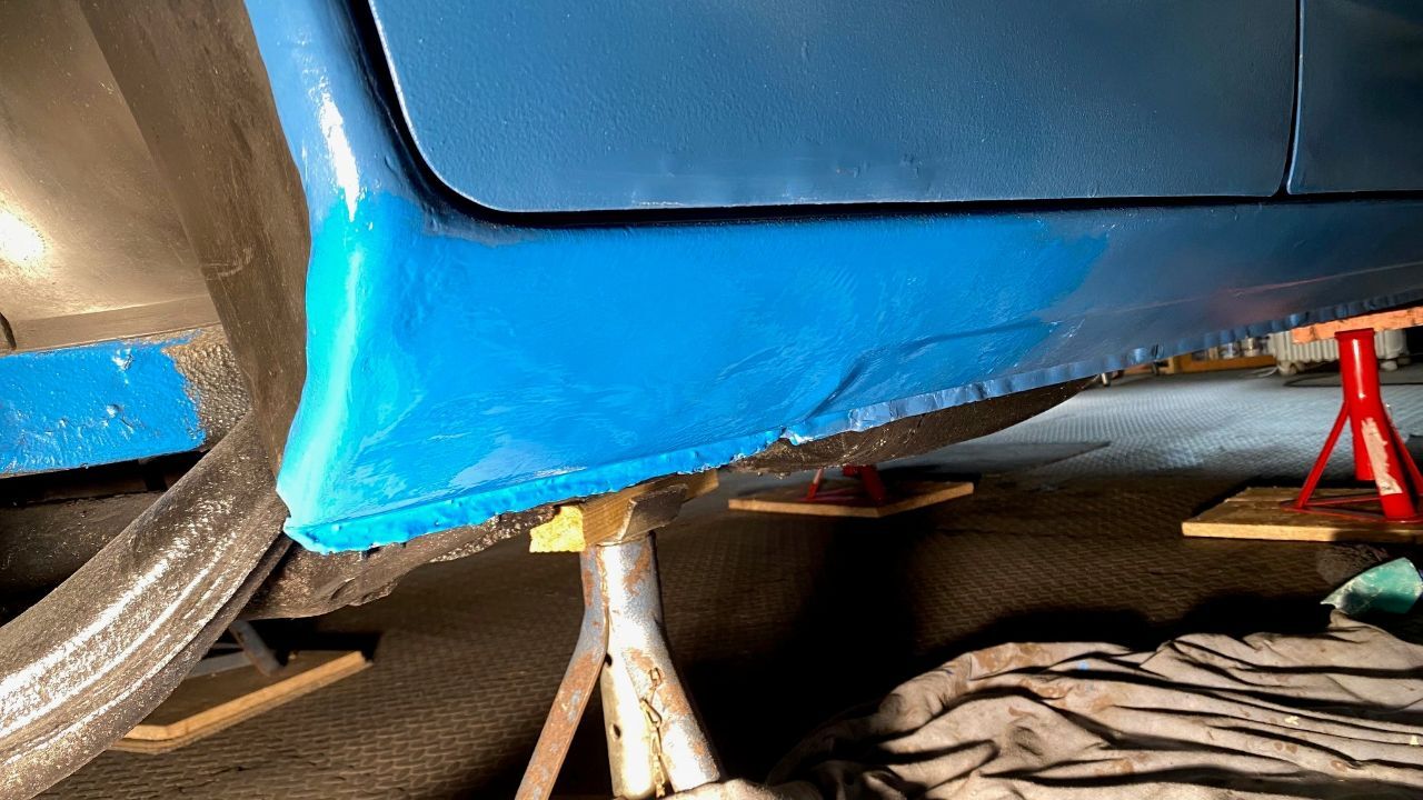

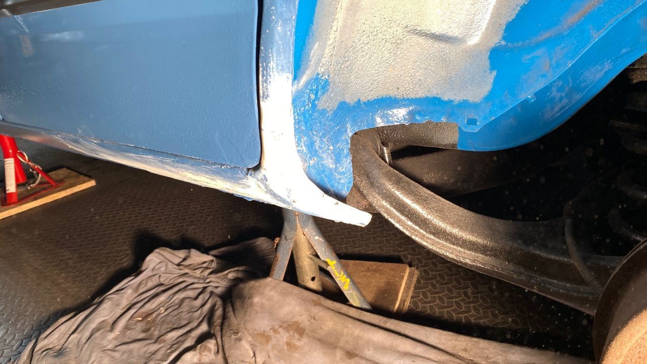

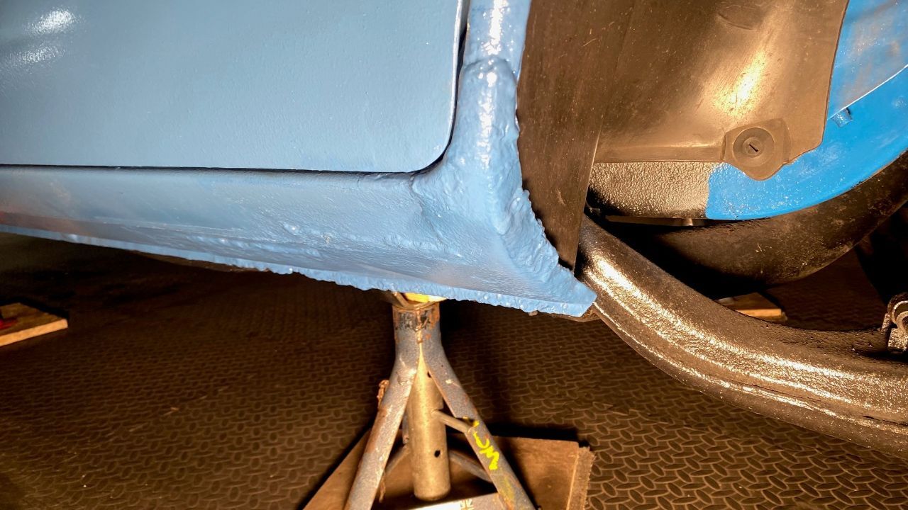

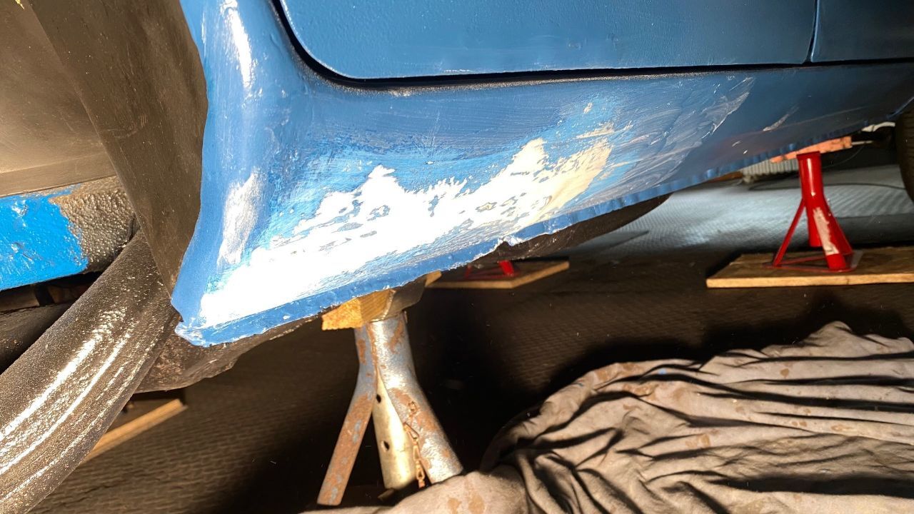

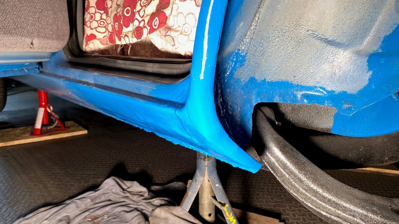

The backs of the Sierra's sills have been welded at some point before I bought it last year.
The repair patches are of industrial strength but the quality of the welds was a bit agricultural.
Apologies in advance for the shit quality photographs, my iPhone gets confused when I take photos whilst the garage spotlight is on.
This was the nearside sill, the bottom of the arch was particularly ugly.
The offside was better but still not pretty.
Using an angle grinder, I smoothed out the welds as best as possible, then applied a skim of filler over the joints.
Nearside.
Offside.
I have given the repairs a coat of Rust-Oleum paint, which has great self-levelling qualities and will seal the filler.
Nearside.
Offside.
I need to make good a couple of more patches but the sills look more even now.
Once the paint has fully cured, I will spray the sills with Mariner Blue aerosol, which is what I did a year ago when I first tarted up the sills.

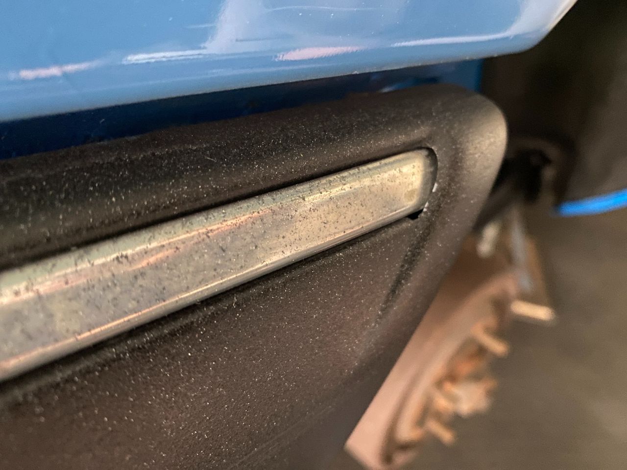

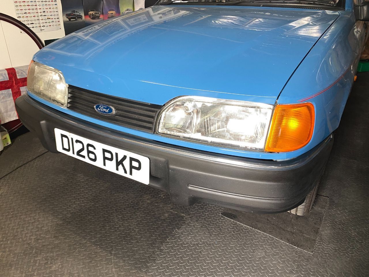

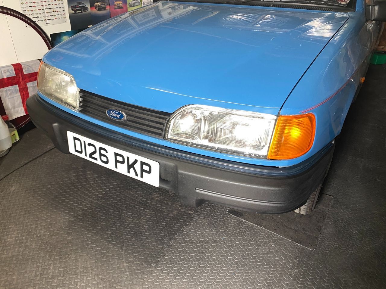

Regular readers might remember that the front bumper chrome* trim was badly sun damaged when I bought the Sierra.
This is what it looked like.
As a temporary solution, I put what was supposed to be silver coloured insulation tape over the trim.
Unfortunately, the silver tape wasn't silver and the bumper looked shit.

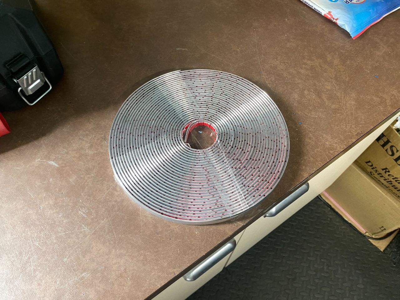

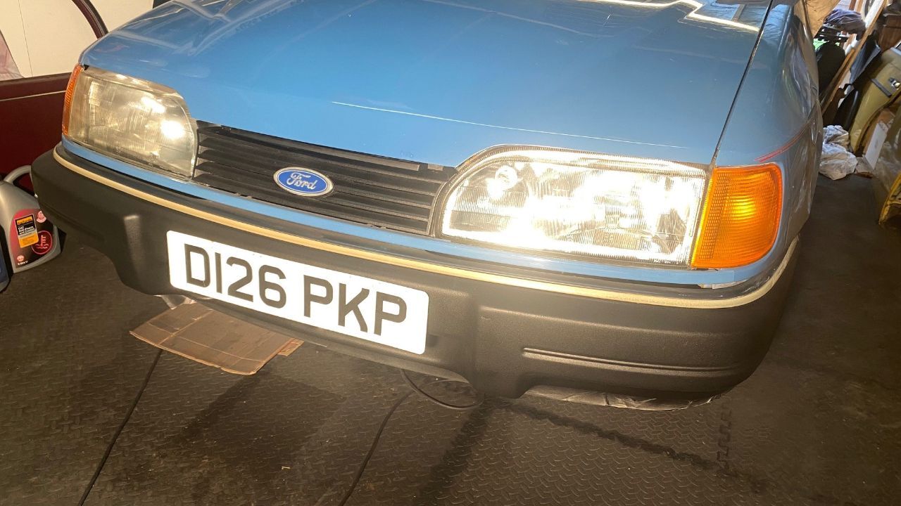

A guy on a Facebook Sierra group was selling new lengths of OEM matching trim for £30, inc p&p. So I splashed out.

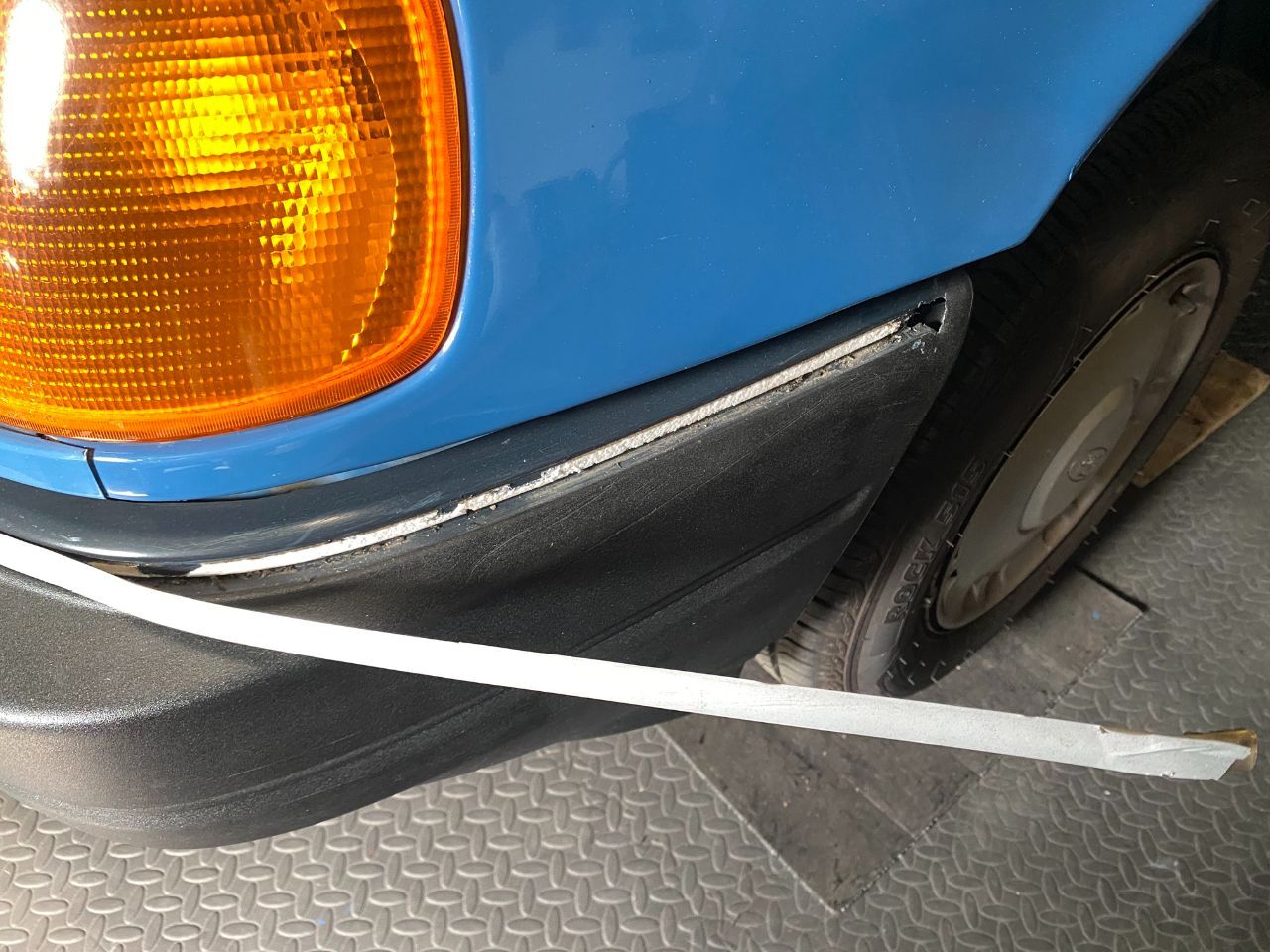

Removing the old trim was easy enough but a lot of adhesive residue was left on the bumper.
Luckily, the adhesive residue came off easily with a flathead screwdriver.
A quick wipe over and the bumper was ready to receive the new trim.
The new trim is adhesive backed so fitting it was a doddle.
Looks good?

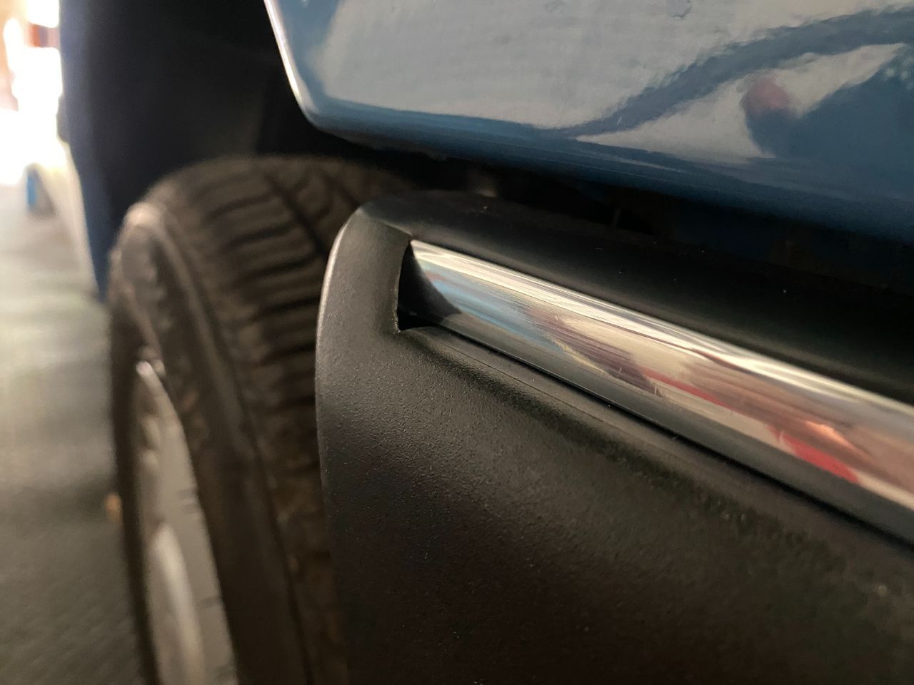

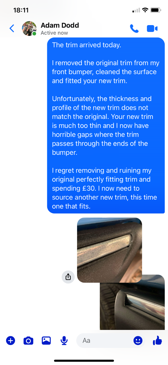

Not quite. The trim definitely isn't to OEM standards! The new trim is about half as thick as the original stuff, the profile is therefore completely different and it doesn't fit properly into the bumper ends.
This is how it should fit:
And this is the new trim:
I know that it's not right and to me it looks utter bollocks. I'm pissed off.
I'm going to complain to the seller.

OEM my arse, Looks like the Chinese stick of stuff I've just uses on the MGB.
Reminds me of the sort of chrome trim that Halfords sells.
Not that it's any consolation, but my dad suffered the exact same situation when trying to replace the pitted bumper chrome inserts on his Sierra Ghia... 27 years ago. We got a roll just like that, and it was just as wrong. My suspicion is the profile is right for the side rubbing strips but not the bumpers. I never did test to find out, though. I suspect the chrome for the bumpers comes (or came... when you could still get it) as actual shaped pieces rather than on a flexible roll.
12 minutes ago, vinyljunky said:
Maybe a more buxom adhesive tape would be a short term improvement?
Maybe but there’s a possibility that the thicker double sided tape would be visible along the top of the shitty thin trim.
I sent the seller a polite complaint message.
He’s seen it but hasn’t responded.
Yup.
Same as the stuff I used on the Acclaim's door rubbing strips when it had them fitted. Probably worth about £8 delivered I'm afraid.
It is, at least, fairly hardy. If you had some thicker sticky foam type stuff you could run a thin line of it along the lower edge of the recess forcing the trim to sit at an angle and potentially sit more flush at the bottom...
1 hour ago, yes oui si said:
Put a second layer on.
i thought this too

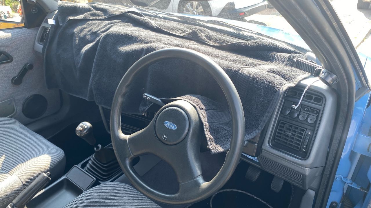

I took the Sierra to Staines and back today, via the M40, M25 and A30 today. It was hot and sunny and to protect my crack-free dash, I protect it with a thick towel whilst the Sierra is left out in the sun. As lovely as the concept of driving a classic Ford (or any other classic) in summer weather sounds, it's actually not that much fun, with a stuffy interior and air-con-free ventilation.

I laughed out loud when I saw that towel.  I thought I was the only one who does stuff like that.  Mk2 Sierra dashes are loads better than Mk1s, but anything will crack eventually.  I think it is worth doing.
