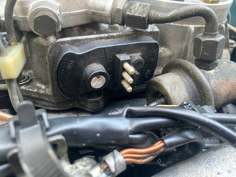

Conrad D. Conelrad Posted December 27, 2023 Author Posted December 27, 2023 2 hours ago, SiC said: Did you have any luck disconnecting the ECU? Might struggle to start and run when cold but should be generally fine when warm. I haven't tried it yet. I'm currently experimenting with only disconnecting the potentiometer. Positive so far. 2 hours ago, SiC said: Hold on, quick sanity check! Are you measuring the right terminals? Hard to tell as Imgur is shite for zooming in. But from what I can tell the round thing on yours is on the right but that picture on the left. It caught my attention as the (genuinely) fascinating link @Volksy sent above says the below. Makes sense to get lower resistance if measuring the other terminals. I believe so. Not clear in my photo but my potentiometer is oriented the same as the diagram. Volksy, Back_For_More and Rust Collector 2 1
SiC Posted December 27, 2023 Posted December 27, 2023 9 minutes ago, Conrad D. Conelrad said: I believe so. Not clear in my photo but my potentiometer is oriented the same as the diagram. Yeah soz. I wrote it, flicked through the post again and then saw the other angle showing the round bit. So deleted it. You must have caught the post before I got a chance to delete it. What does the bottom two contacts read? Also do you get a smooth resistance change as you move the air flow valve with no dead spots?

Conrad D. Conelrad Posted December 29, 2023 Author Posted December 29, 2023 With the potentiometer unplugged, the Baby Benz has done 50 miles in varied conditions without stalling. So here’s a £70 vote of confidence: don’t let me down now, hurensohn! How does it drive with a bit of the injection system unplugged? Beautifully! I’ve fallen back in love with the car. The only noticeable issue is that it doesn’t know what to do with itself for the first few seconds of a cold start but settles once the throttle has been blipped. RobT, Shep Shepherd, Coprolalia and 27 others 29 1
