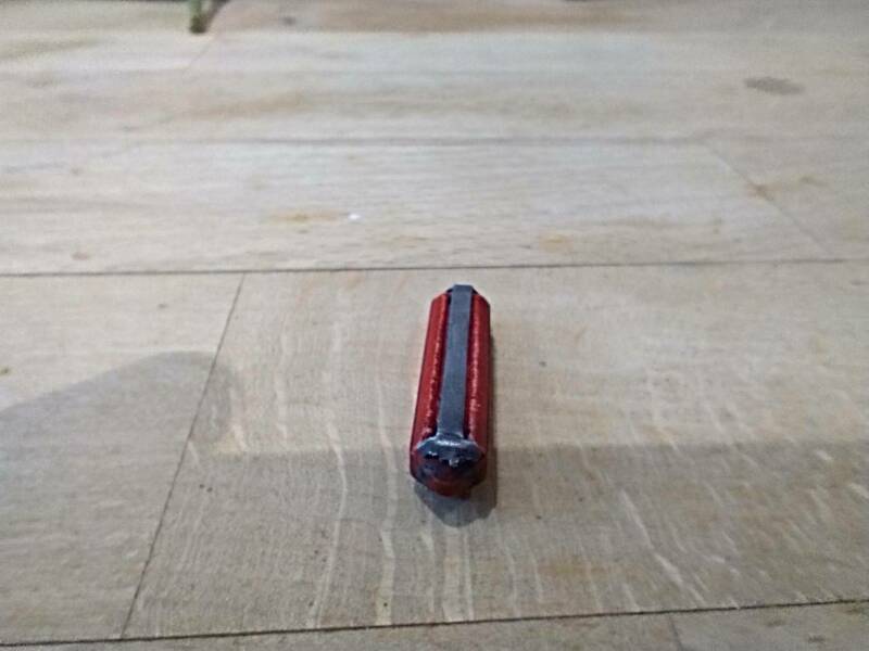

Rusty Pelican Posted February 29, 2024 Author Posted February 29, 2024 So this is why the Hazards didnt hazard and a few interior lights didnt get bright . didnt spot it just looking as the fuse aint blown

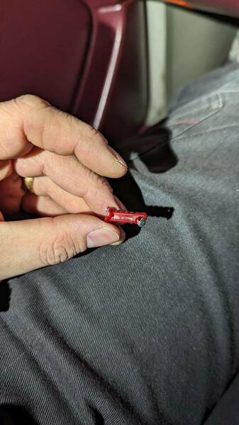

loserone Posted February 29, 2024 Posted February 29, 2024 My blower fuse went the other day Is the plastic supposed to melt like this? I've never come across these kinds of fuse before
Rusty Pelican Posted February 29, 2024 Author Posted February 29, 2024 15 minutes ago, loserone said: My blower fuse went the other day Is the plastic supposed to melt like this? I've never come across these kinds of fuse before Decent ones are actual ceramic , modern crap ones are thermoplastic rubbish , no they arnt supposed to melt
Volksy Posted March 1, 2024 Posted March 1, 2024 12 hours ago, loserone said: My blower fuse went the other day Is the plastic supposed to melt like this? I've never come across these kinds of fuse before My blower fuse was blowing on the S Class. The motor was trying to seize up. I've replaced it with a new one from AutoDoc. Was about £100 for the unit. Mine was supplied in LHD format but you can swap the motor out to the old housing. loserone and Rusty Pelican 1 1
Conrad D. Conelrad Posted March 3, 2024 Posted March 3, 2024 Continental fuses are awful. Fiddly to remove, fiddly to insert, and like to blow without looking like they've blown. Maybe the ceramic ones are better, but I doubt it. Even if you buy them from Mercedes they're the plastic type.
Rusty Pelican Posted March 5, 2024 Author Posted March 5, 2024 On 03/03/2024 at 11:51, Conrad D. Conelrad said: Continental fuses are awful. Fiddly to remove, fiddly to insert, and like to blow without looking like they've blown. Maybe the ceramic ones are better, but I doubt it. Even if you buy them from Mercedes they're the plastic type. They are all plastic now , i have found ten 8A and ten 25A proper ceramic ones at a local garage though , still need the 16A ones . yep mine just corroded on one end , looked perfect at a glance
