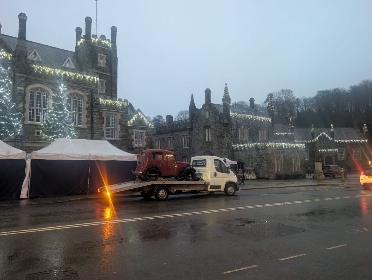

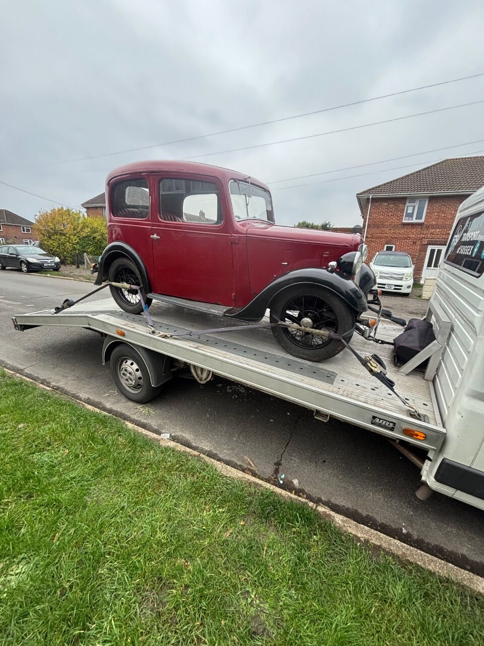

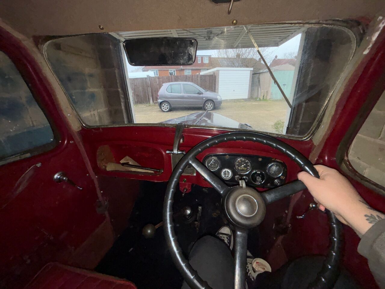

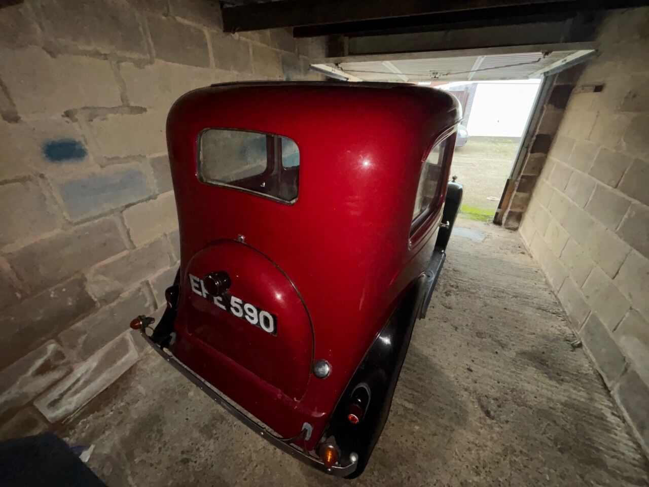

She’s here!!
and first things first… Awww she’s so CUTE 😍😍😍
everything is like a full sized car but just scaled down to almost toy car levels! I just wanna hug it like a big teddy bear 🥰❤️❤️
Right, sorry I think I got a little carried away there
so as cute as the 7 is it does have a few issues to address after the rush of Christmas, first and foremost the starting issue, I tried to get her running but unfortunately no luck, I noticed after opening the bonnet that there was a load of water sat directly on top of the plugs, I wiped away the water and tried again, it’s very handy being able to just pull the starter motor cable from under the bonnet, and I could see water bubbling coming from the plug holes, I obviously immediately stopped play there incase I hydro locked the engine, I’m gonna come back after Christmas with my tools and whip the plugs out and properly investigate, but yeah overall I’m really excited about it

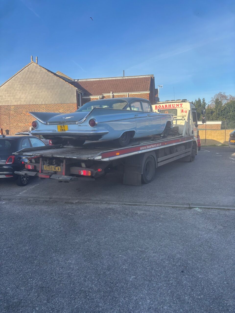

And she’s gone
had a good catch up with the friend who bought it and it’s getting delivered straight to an American car garage to begin the process of restoring it
he also agreed to sell me his lovely 1960 Dodge in the not too distant future so perhaps I’ll be getting another land yacht sooner than I thought
  • Weird Car changed the title to Weird Car’s weird cars!
Certainly no beavertail recovery for that one!
Looks like it only just fitted on the 7.5tonner too?
Definitely a tight fit, I felt a little bad for the driver having to reverse that rig down the tiny tight roads leading into mine

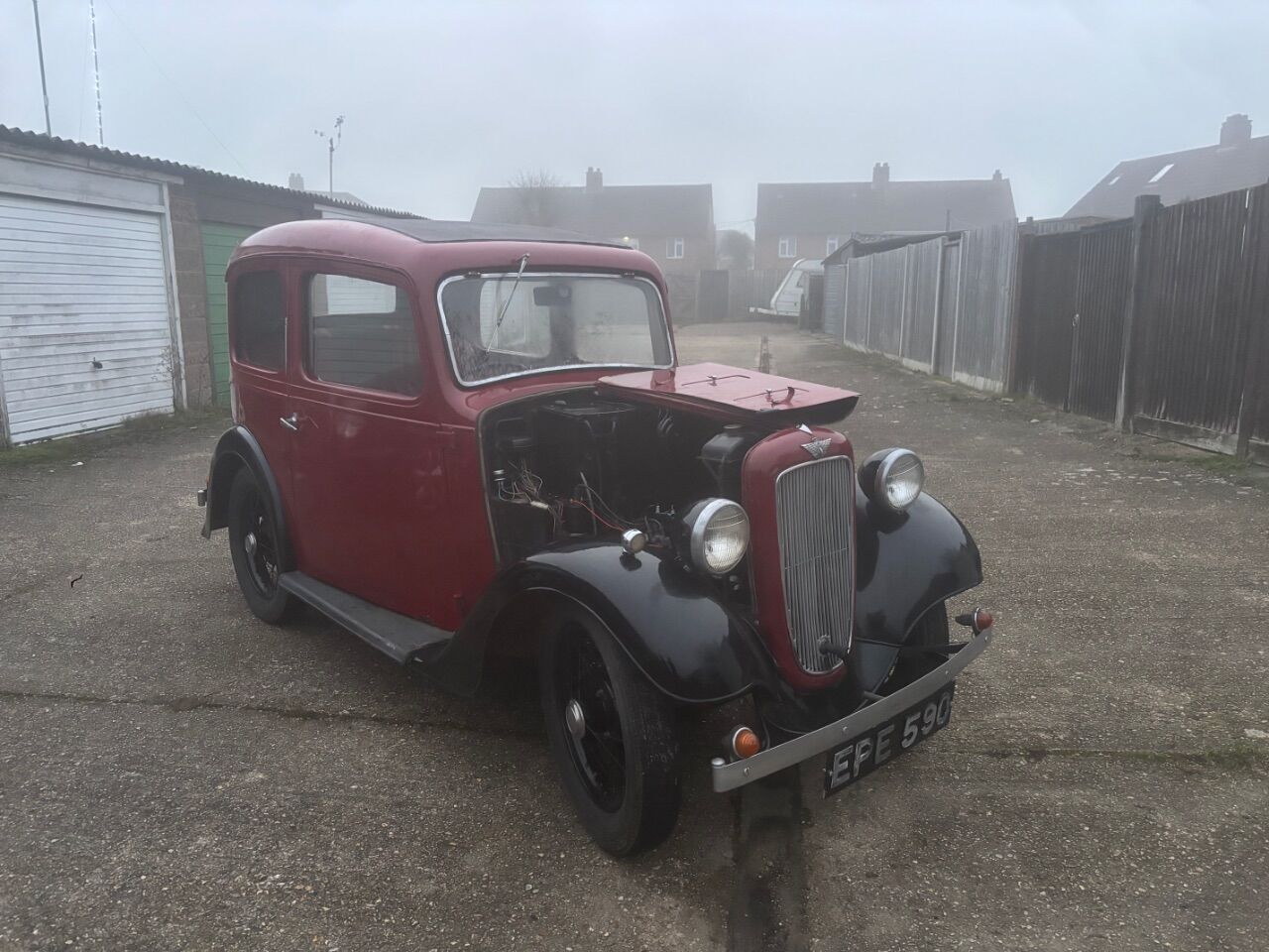

Sit rep again

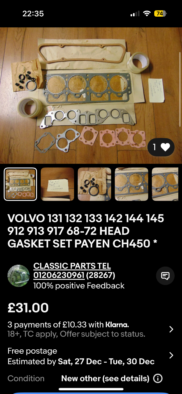

Had a tinker with the 7 today, all the plugs are soaked in water, I have a suspicion water has been making its way into the engine compartment via the top bonnet hinge and has ruined the plugs, testing the spark from the leads it’s very strong so new plugs have been ordered
As a warning, I have to say I've never managed to make a prewar car run on new plugs. If you can find a set of 1930s plugs you'll be starting from a much better place, but even 1950s or '60s plugs would be better than anything you can buy today. If you have to get new plugs, use the Green Spark Plug Co (https://www.gsparkplug.com/ ) which sells NOS plugs
