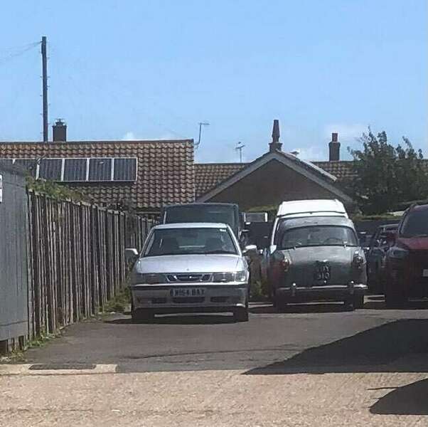

Crackers Posted July 15, 2023 Posted July 15, 2023 I really hope I see this floating around the area at some point, it's gorgeous. If you see a skinny goon in a Saab waving and tooting at you, you'll know I've spotted you 😅 eddyramrod, PicantoJon, Matty and 2 others 2 3
Weird Car Posted July 15, 2023 Author Posted July 15, 2023 3 minutes ago, Crackers said: I really hope I see this floating around the area at some point, it's gorgeous. If you see a skinny goon in a Saab waving and tooting at you, you'll know I've spotted you 😅 Please excuse me if you wave and I don’t notice, once I’m driving a classic I’m usually zoned out in my own world imagining everything as if it were the 50s! I’m weird I know 😂🤓 Crackers, Matty, eddyramrod and 2 others 3 2

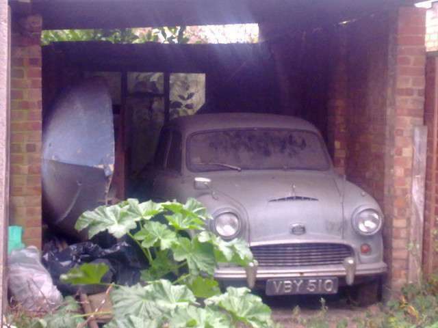

Weird Car Posted July 17, 2023 Author Posted July 17, 2023 Dropped Audrey off with my favourite local garage today, getting the indicators sorted as they’ve now decided to stop working entirely, she should hopefully be back in action on Saturday if it’s not too complicated a fix. so I’m terms of her history it’s all a bit vague really, she didn’t come with any paperwork except the promise of the V5 when it arrives at the PO’s house but having a little look on the DVLA database suggests she was sitting until at least 1985, Googling the reg bought up this image taken in 2009 of her sitting in a garage which was quite a pleasant surprise. @LightBulbFun you’re a wiz with DVLA do you happen to know where VBY510 was originally registered? And if they still hold public records that could help trace previous owners? Her dealer badge suggests Croydon but I’m not sure if she was registered there too? LightBulbFun and N Dentressangle 2
LightBulbFun Posted July 17, 2023 Posted July 17, 2023 12 minutes ago, Weird Car said: @LightBulbFun you’re a wiz with DVLA do you happen to know where VBY510 was originally registered? And if they still hold public records that could help trace previous owners? Her dealer badge suggests Croydon but I’m not sure if she was registered there too? Croydon registered indeed she is sadly all Croydon records where destroyed on that subject do you happen to have any close up shots of the number plates for me to oggle at? they look original, and given that @Zelandeth's P4 is also Croydon registered and had a very interesting physical rear number plate I am kinda curious if your Cambridge also might have a White Bronze Ltd set of number plates? you can read about me digging into that over here https://autoshite.com/topic/29443-zels-motoring-adventuresmerc-renault-rover-vw-ac-model-70-a-sinclair-c5-1207-van-mot-progress-at-last/page/159/?tab=comments#comment-2765752 as a side note looking at its DVLA record, it last had a Keeper change of the 19th of November 1977, and came off the road in 1985, that 1977 V5 will still be valid if you can find it! but dont send it into the DVLA, just use the 11 digit number to keeper change online sadly a V5 that old wont actually have previous keeper details on it, but it will contain the date from when VBY510 was computerised , and sometimes the DVLC back then would return the old buff logbook, so if do wonder if that might be lurking somewhere? and of course as a general note, nicely bought! she looks like a lovely old thing, looking forward to seeing it out and about and all that (as a side note if you can get the garage to save the old indicator bulbs, if they still have markings on them I might be able to decode their date-code for you, if the car has been off the road since 85, they might be quite old, or even original to the car) N Dentressangle, Tickman and Weird Car 2 1
SiC Posted July 17, 2023 Posted July 17, 2023 20 minutes ago, Weird Car said: getting the indicators sorted as they’ve now decided to stop working entirely On that age iirc it's the TWICE unit that controls them. I remember many people had issues with fuses failing and stopping the indicators working. Even if the fuse looks good visually they can micro fracture inside and not be easily visible. Weird Car 1
Weird Car Posted July 17, 2023 Author Posted July 17, 2023 1 hour ago, LightBulbFun said: Croydon registered indeed she is sadly all Croydon records where destroyed That’s a shame. 1 hour ago, LightBulbFun said: on that subject do you happen to have any close up shots of the number plates Not at the moment but I’ll get you some once I have her back 1 hour ago, LightBulbFun said: it last had a Keeper change of the 19th of November 1977, and came off the road in 1985, that 1977 V5 will still be valid if you can find it! but dont send it into the DVLA, just use the 11 digit number to keeper change online That’s interesting to know that she changed owners in 77, unfortunately I don’t have any other v5’s or buff logbooks thanks for the help. 1 hour ago, SiC said: On that age iirc it's the TWICE unit that controls them. I remember many people had issues with fuses failing and stopping the indicators working. Even if the fuse looks good visually they can micro fracture inside and not be easily visible. That’s useful to know, thanks, hopefully it’ll be a simple job for the guys at the garage then, the PO told me the grounds were a bit naff so they were really dim and temperamental. SiC and LightBulbFun 2
