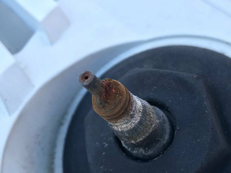

One crumbling casualty from the heater motor swap; The barb for the screen wash hose out of the wiper arm disintegrated. The centre pipe survives and is quite solid, but is way too small to simply pop on some new hose.
I need some sort of collar to make the outer diameter up to that of the inner diameter of the hose. Hmm.
