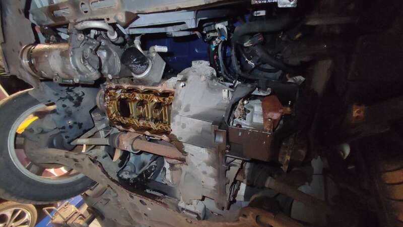

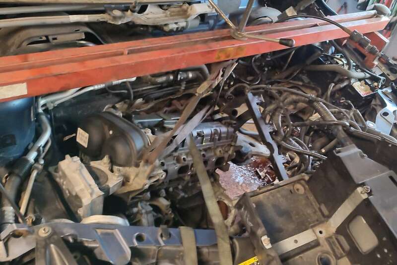

RoverFolkUs Posted July 8, 2023 Author Posted July 8, 2023 8 minutes ago, Zelandeth said: That's some impressive carnage. Guessing the engine was turning at some speed when this happened then? Low gear, high ish speed, so a fair bit of momentum from the car which just kept turning the engine after the initial hydrolock I wasn't expecting it as it wasn't that deep, although the air intake of a Focus is fairly low. Could have reacted sooner by putting the clutch in quicker but it would have still been curtains for this engine so it's just one of those things 🤷
RoverFolkUs Posted July 8, 2023 Author Posted July 8, 2023 7 minutes ago, Jenson Velcro said: Is throwing a rod a common problem with those engines? What do you think caused it? Yes it was a hydrolock unfortunately, this engine was sweet and they're usually pretty solid. The failure was not the fault of itself
MorrisItalSLX Posted July 8, 2023 Posted July 8, 2023 16 hours ago, RoverFolkUs said: Oh dear 😳🤣🤣 .... Oh hello number 1 conrod, you decided to make a bid for freedom... Yep, it's even smashed the crank ladder carrier...!!! That shouldn't be facing that way... A 2nd hole in the block.. Let's not waste any time stripping this down and getting it out then.. more tomorrow! PicantoJon, Eyersey1234 and RoverFolkUs 3

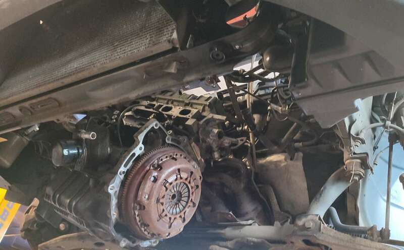

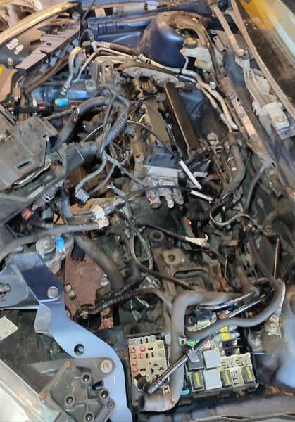

RoverFolkUs Posted July 8, 2023 Author Posted July 8, 2023 I had a spare few hours this afternoon to continue with the engine removal. Honestly this has been a piece of cake so far, only one rounded bolt which had to be cut off for the mani-cat bracket, but even the exhaust manifold nuts and the single bolt came out without snapping or any heat! Even the little 10mm's holding the manifold heat shield came out without snapping! Images don't do justice of just how stripped this is, but all wiring, pipes and ancillaries are either disconnected/removed and stowed away. I decided these nuts were a sign to pack away and reconvene tomorrow as the oxyacetylene was boxed in at the opposite end of the workshop! Enjoy this upskirted image of its undercarriage, hopefully this does more justice showing what's left.. All useful ancillaries boxed up in case the transplant engine will need any. I've removed the power steering pump and pipes complete without disturbing the union from hell. If you know, you know! And yes I'll probably be reusing that coolant.. because Autoshite rebuild Please spare any comments questioning "why have you taken that off, don't need to" - when you're doing something like this its usually more time efficient to strip the old engine down as much as possible so you can get it out in one hit without farting around looking for hidden cables and connections and subsequently running the risk of damaging something important or destroying some £50 coolant housing or whatever. So yes, it's literally just the engine, gearbox and exhaust left so I reckon another hour or two and that engine will be out! I'm going to opt for dropping it out from underneath by getting the car as low as possible on the ramp, the underbonnet engine support onto the engine, lower it onto a couple of tyres and then lift the car off it. That's the plan Looks like the car boot will be rained off in the morning so that will free up a bit more time as well. rob88h, AnnoyingPentium, sierraman and 14 others 16 1

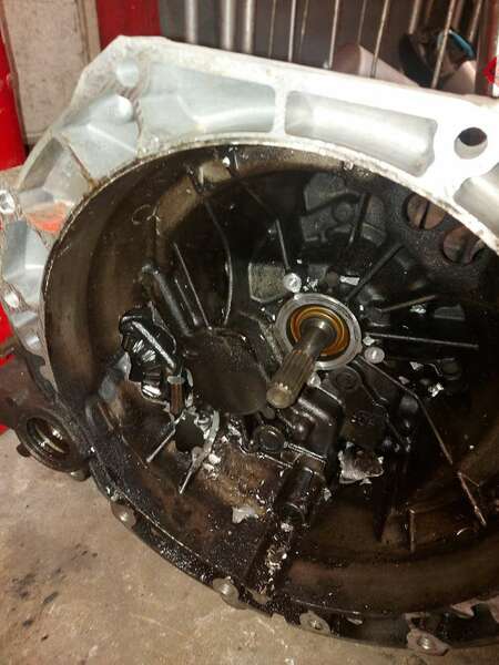

RoverFolkUs Posted July 8, 2023 Author Posted July 8, 2023 1 hour ago, Matty said: Ford's eh. Is that off something fairly new? I've seen a lot of Ford manual box failures 2018 onwards.. Matty 1
RoverFolkUs Posted July 8, 2023 Author Posted July 8, 2023 55 minutes ago, beko1987 said: I think it's a great idea tbh, best of luck to you! Rebuild all the duplicate ancilleires at your leisure that your left with then swap them over. Voila new* engine! Then refurb and ebay the now redundant ones now you know what your doing from the first ones Thank you Now there's an idea, my original thought was to sell off the excess but the hoarder that lives inside me loves the idea of keeping a load of spares just in case 😉😆 GrumpiusMaximus, beko1987 and High Jetter 1 2
Matty Posted July 8, 2023 Posted July 8, 2023 54 minutes ago, RoverFolkUs said: Is that off something fairly new? I've seen a lot of Ford manual box failures 2018 onwards.. Nah its the standard IB5 out my ST. Span the diff bearings on my missus going round a roundabout and spat the diff out the casing. 200 quid second hand gearbox, quick going over and new bearings here and there. New clutch and back on the road. Try doing that with something modern 😄 RoverFolkUs 1

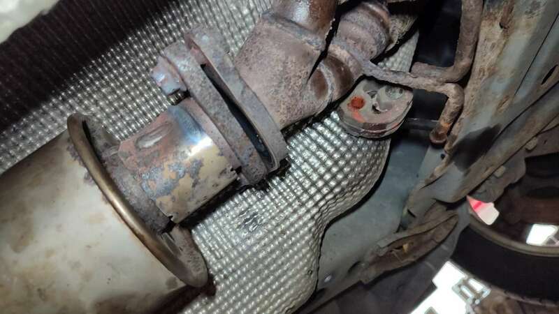

RoverFolkUs Posted July 9, 2023 Author Posted July 9, 2023 So, I reconvened this afternoon and got those very rusty nuts off. There's no substitute for oxyacetylene and a well fitting socket! With the exhaust out the way, next job was to get the gearbox out... Even the driveshafts came out of the hubs ok which is rare for these Focii! I noticed a split lower ball joint cover on the offside front.. which is annoying as I need to check if it's replaceable or moulded. If it's moulded then it can wait until MOT time because the ball joint itself is fine. Gearbox out, not much left holding the engine in! Rigged up a very Autoshite-style engine support because the engine crane was blocked in by another car and numerous obstacles which I couldn't be arsed to shift out the way. Worked a treat though! Lowered the engine onto the tyres, undid the engine mount and then lowered the engine support, and it's on its way out! Like an elephant giving birth Raise the car, and she's out! Is there a prize for winning cambelt roulette? 🤣 And that's all for now folks! Now to get everything ordered. The clutch is still in excellent condition so I'll be reusing that, but I'll probably replace the concentric slave cylinder while the box is out. New cambelt kit for the new engine if it needs it, and most importantly, finding the best donor engine! I'll pilferage as many salvageable parts off the old engine to reuse/keep/sell, and then lob the carcass in the scrap! Had a gander at the rear brakes, all I can tell is that the friction material seems very brittle and crumbly so that may be the cause of the persistent noise I was experiencing, I wonder if the shoes have been previously contaminated adw1977, djim, AnnoyingPentium and 17 others 20
twosmoke300 Posted July 9, 2023 Posted July 9, 2023 Pas union from hell . Oh yeh I know alllllll about that fucker RoverFolkUs 1
RoverFolkUs Posted July 9, 2023 Author Posted July 9, 2023 3 minutes ago, twosmoke300 said: Pas union from hell . Oh yeh I know alllllll about that fucker What were they thinking and what ever was wrong with a banjo? 😂 So stupid that if you undo it (if you even manage to without cutting the pipe first!) then it will leak if you reuse it. You can't just replace the nut unless you carefully cut it off so you've got to budget for new pipes and the union whenever you have to take it apart!

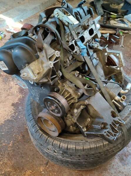

Noel Tidybeard Posted July 9, 2023 Posted July 9, 2023 will you head fit an "ordinary" block? RoverFolkUs 1
RoverFolkUs Posted July 9, 2023 Author Posted July 9, 2023 5 minutes ago, Noel Tidybeard said: will you head fit an "ordinary" block? Yes it should do, only the camshafts and pulleys are different for the Ti-VCT in terms of the engine itself, but pretty much all of the ancillaries are different so it would need a lot of swapping over. I've totted it up, and if I went for that block on eBay for £150, by stripping down my engine and putting all the good parts, I'll be another couple hundred quid deep in "engine build sundries" to have an unknown bottom end.. Alternatively, £380-420 buys me an engine accompanied with a video of it running and from a similar mileage car I dare say the block might be the same (or only similar and subsequently not interchangable) as a MK1 but I can't be sure on that, there's bound to be some difference, but it's still the Sigma family engine so the bare bones should be almost identical 🤔 GrumpiusMaximus 1
Dave_Q Posted July 9, 2023 Posted July 9, 2023 Designing and validating blocks and pistons and stuff is expensive so if they are the same capacity I'd be very surprised if the basic short engine was different just to add some adjustment to the cams RoverFolkUs 1
RoverFolkUs Posted July 9, 2023 Author Posted July 9, 2023 Just now, Dave_Q said: Designing and validating blocks and pistons and stuff is expensive so if they are the same capacity I'd be very surprised if the basic short engine was different just to add some adjustment to the cams I think you're right, if I already had one to hand I'd definitely be trying it, or if the very kind offer up-thread wasn't in Liverpool - 5 hours away from me, but I think the "correct" engine is cheap enough as I could get the "normal" engine for around £250 with a lot more choice, but I probably wouldn't be much better off by the time it's all built up.
