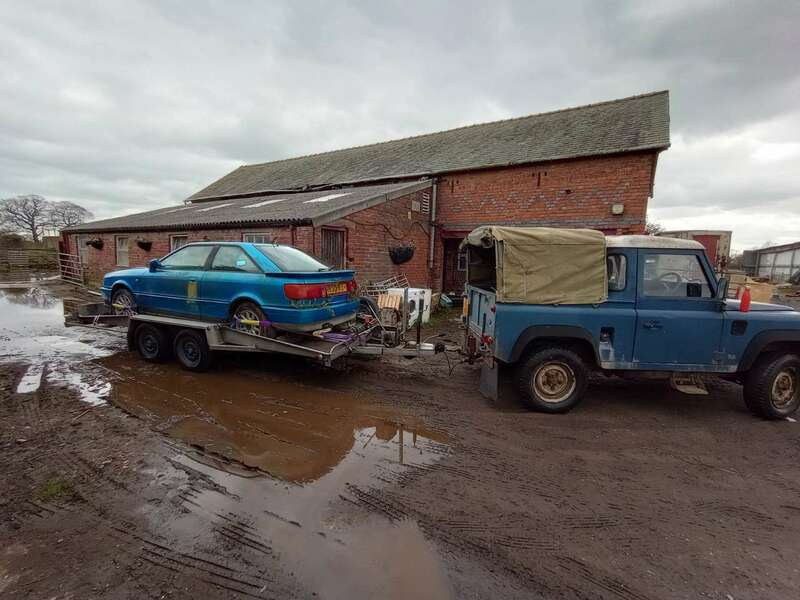

Blake's Den Posted April 15, 2023 Posted April 15, 2023 Firstly I need to state that this isn't my car but I have been asked to get it into a running state. So, whats the story? This is my brother in laws car. He was using it as his daily driver but it was costing him a lot to run so he just parked it up and bought something cheap. That was 15 years ago! It has survived quite well considering no preperation was done prior to parking it up. All four tyres were flat and badly perished, there were two trees grwoing through the back bumper (!) and it looks like a mouse had been living in the airbox. Attempts to get in running on site identifed that the fuel pump wasn't working so I winched it onto my trailer and dragged it home with the Defender. After eventually finding the fuel pump I ended up bodging in a spare pump that I had from my Santa Fe. This worked great, so much so that I had fuel pouring out under the car! A quick investigation found a damaged fuel line which I quickly bypassed. Once there was fuel at the engine it fired up straight away. All is not well though. There is a really loud tappety noise coming from what I think is the left bank of cylinders. I haven't investigated this further yet but I'm hoping that it is just a stuck valve or a dodgy hydraulic tappet. The car is in surprisingly good condition with minimal rust underneath. The sills are solid and even the interior has held up OK. I don't think that it will take much to get this back on the road if the engine problems are nothing major. It is my understanding that these ABC Audi engines are fairly robust. Here is the video of the car. Don't forget to like, comment and subscribe etc. Twiggy, tooSavvy, Six-cylinder and 29 others 32

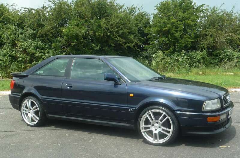

Six-cylinder Posted April 16, 2023 Posted April 16, 2023 I liked mine a lot when I had it, a 2.6 manual. Blake's Den and JMotor 2
Blake's Den Posted April 16, 2023 Author Posted April 16, 2023 3 minutes ago, Six-cylinder said: I liked mine a lot when I had it, a 2.6 manual. Oooff! That looks smart 🙂 Six-cylinder 1

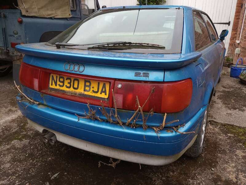

Blake's Den Posted April 17, 2023 Author Posted April 17, 2023 I'm amazed at how popular this video has been. There does seem to be a lot of love for these Audis. I'm hoping to get some more content on it filmed this week but in the meantime here is a better picture of the tree/bush growing out of the rear bumper 🤣 Scruffy Bodger, sierraman, GrumpiusMaximus and 5 others 7 1

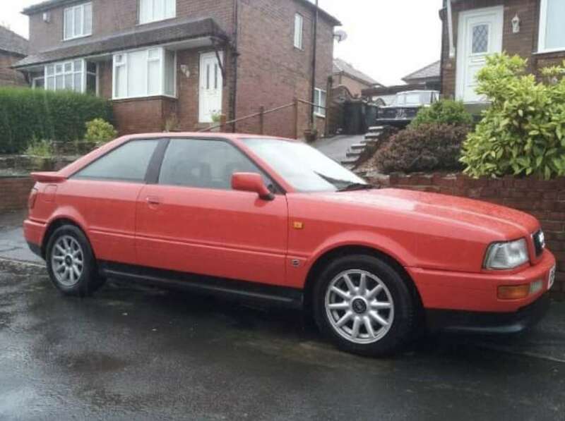

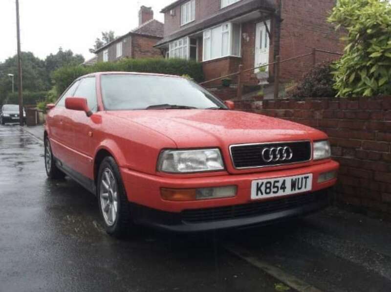

Volksy Posted April 18, 2023 Posted April 18, 2023 I'm pretty sure that fuse box and electrical gremlins killed @HillmanImps one of these. I know he had it at various specialists* who then killed it more. Blake's Den 1
HillmanImp Posted April 18, 2023 Posted April 18, 2023 1 hour ago, Volksy said: I'm pretty sure that fuse box and electrical gremlins killed @HillmanImps one of these. I know he had it at various specialists* who then killed it more. Yeah, if I remember rightly, I think the crankshaft sensor had gone whwn it broke down but the garage it got dragged to took off the fuse box cover and water got in and spelt the end. Think a friend of @Lankytimstill has it stashed away somewhere though. Loved that car, definitely in my top 5. So nice to drive AND to look at. It did seem to use more fuel than any car I've had before or since though but it figured out that I was working out the fuel economy and broke its mileometer. Back in the days when you could get a nice 17yr old car for £500. Blake's Den and Dave_Q 2
