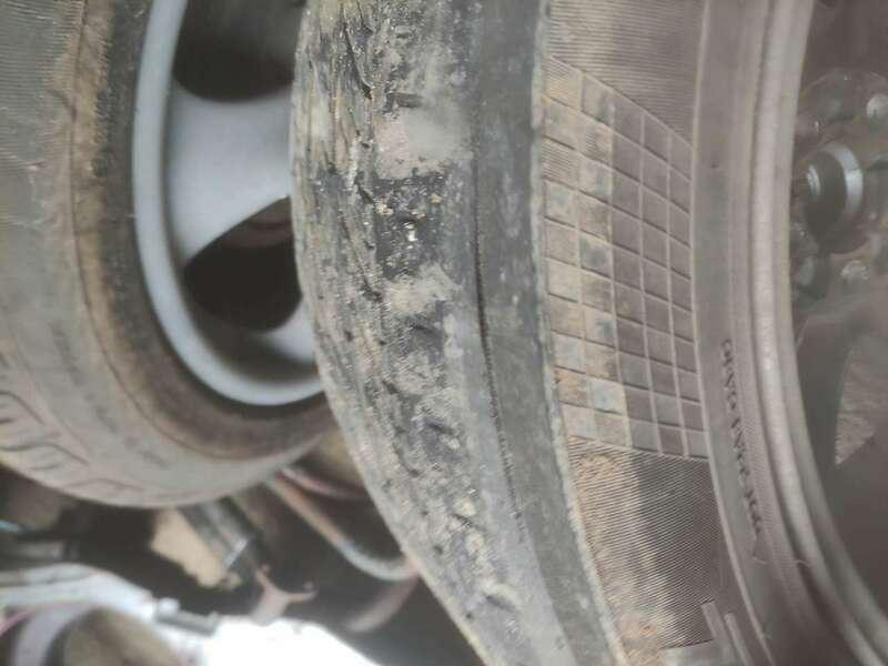

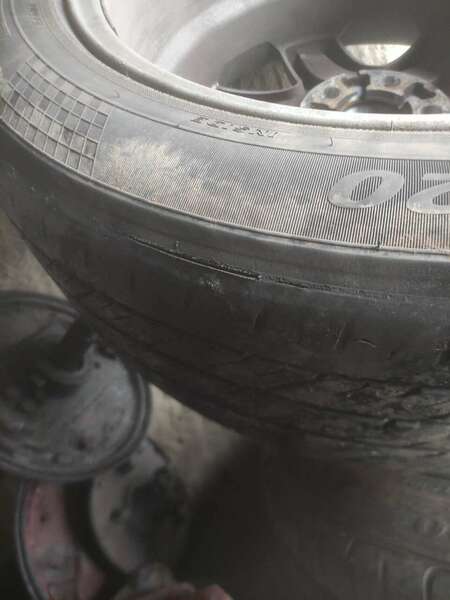

DaveDorson Posted March 27, 2023 Author Posted March 27, 2023 Shock and suprise.. my rear tyres are looking a bit crap on the inner edge. Â Add knuckle joint bushes (top and bottom, genuine) to my shopping list.

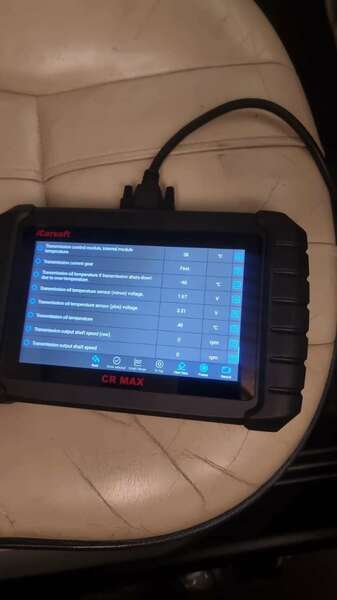

DaveDorson Posted August 20, 2023 Author Posted August 20, 2023 Lack of updates due to lazy and it just working for the most part.  Finally did the gearbox service, and did the mechatronics seals and sleeve seals while it was apart so hopefully it'll stay dry under it now. Already noted an improvement in shifts so it was worth doing.  I took two photos  One of the old oil and some old oil from my mates A6 CVT in a bucket with the filter and pan on the floor, the magnets had a bit of debris but it wasn't horrific. The other  Of the diagnostics. The fill to level procedure on these is basically fill when cold until it dribbles and then get the oil to the right temp (45-60c) and fill until it dribbles out the fill hole with the engine running, hence the diag being plugged in while filling to check the box temp. The whole job was done on the floor, with the car at full height and stands under to make sure it didn't drop, there's enough access to get under and do it for the home mechanic and my ramp had a paid job on it. The only special tool I used was a compressed air fluid filler and adaptor to fill the box, but it could be done with a large fluid syringe it would just take more time and be a bit more of a faff. The only real access issue is the exhaust having the cats right near the fill plug area and the mechatronics sleeve being a bit of a pain to apply enough pressure to in order to compress the scroll seal enough to re clip it place.  Royale80, N Dentressangle, Cookiesouwest and 11 others 14

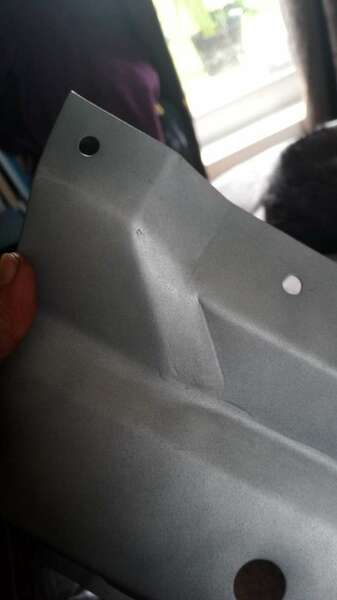

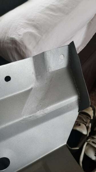

DaveDorson Posted August 31, 2023 Author Posted August 31, 2023 Because doing sills and arches on these is inevitable, and although mine are OK now, they are going to need to be done, when I saw some rear sill repair panels on eBay and knowing you can't buy panels for doing sills, I jumped in and bought them.  These are meant to be amazing quality according to the community, as I understand there's only one guy making panels for them and I assume they came from that source.  Here's what the eBay advert showed: Shapes alright, award to press it due to the design so even though I winced at paying the best part of £200 (small saving over buying from the guy who makes to order, but without the big wait time).  Here's what the pictures didn't show:      Ok so I appreciate you can spend a lot of time making such a panel and I'm sure my time welding up German cars with *quality* pattern panels has spoiled me a bit but is that really worthy of £110 a panel? Ah well.  PicantoJon, N Dentressangle, CreepingJesus and 1 other 4
