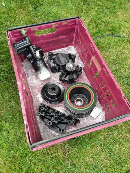

This part is tedious. I am descaling and painting all the bits that I took off and this heat is baking me. I've been at it for a couple of days now and I've thrown the towel in to escape the sun. Good opportunity to catch up as there is a bit to discuss. First off, I have realised that there is what I now call 'the daily spend' and this is for anything that I've found along the way that needs replacing. There is something- every day! This is on top of the stuff that I've already got... none of which I can fit yet.
As an example, when I removed the two tensioners (one for the ancillaries and one for the supercharger belts) and the two idle pulleys, I discovered that all their bearings sounded like someone was dragging a box across a floor.
New replacements were ordered up and only then I realised that I'd ordered a modified idler pulley for the supercharger belt. This revised pulley is for a double sided ribbed belt, not the single which I have! The reason for the modification is to cure the cold start squeal (which I had) so getting the mod wasn't so bad, but I've got a new single sided belt for the old pulley. That means that I had to order a new double sided belt.
This type of scenario was a thing, as I have the early engine and Jag have made changes for improvement along the way.
I suppose I could off set that belt and some of pulleys cost as there is a recent water pump that was loosely bolted in and weeping...
Everything else like the AC pump, alternator (which is also recent), and PS pump were in good shape.

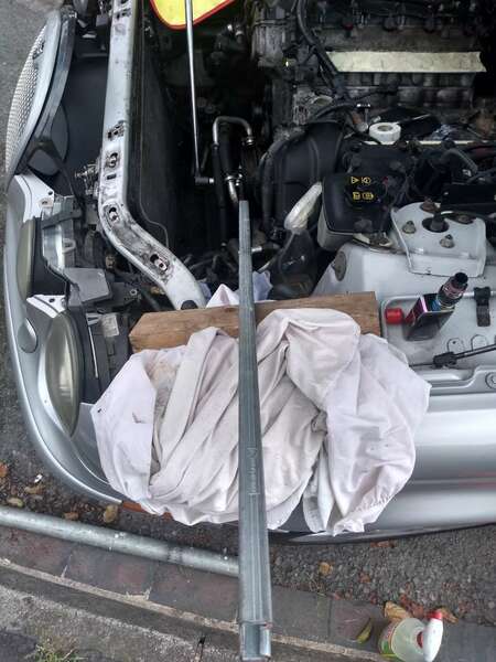

So you see that Crank pulley in the above image? Yeah, getting that off was the next milestone to hit. She's on at 375Nm with thread lock and legend has it that it is frowned upon to a) use a locking pin to hold the engine and 2) rotate the engine backwards.
Something like this:
The main issue I had was that apart from it being effing tight, the special tool that I got was for the V8. Great right? No...
The supercharged has the extended crank pulley so the tool is now not long enough to reach into the pulley, sit flush, and bolt up. That is unless you have a bearing press set like me!
All that was needed was one of the sleeves to go over the business end of the tool and some longer threaded bolts made up, like those shown above. It worked... just...

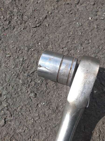

To add extra challenge, the only 24mm socket I had, split on me a long time ago... something to do with a 3 meter scaffold tube, but it refuses to die and completed this task without fail too.

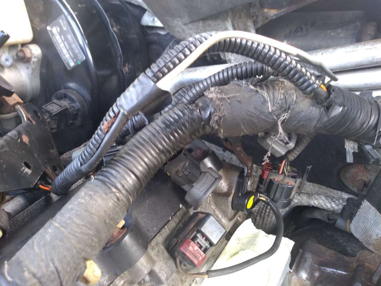

And that's a 200£ pipe believe it or not. Let's have a look at the wiring repairs whilst we are here eh?
Nice! Let me explain what's going on here, this is the supply and comms to the throttle body control. There is one green factory wire, connected to a big white, different gauge wire, connected to something in a black sleeve, connected to the rest of the original green wire. Along the way, they have torn off an earth connection which is supposed to connect to the head, and that's that fuzzy bit of bare cable just poking out of the sheathing. "Carz fixed sir... £twelve hunnit pls"!
Shockingly*, this was carried out by a Cat specialist in Coventry and that follows along the lines of all the shit work this car has had done to it, and the area from where I got it from. You can't argue with the facts.
That's not all though, it gets much more eye opening later.

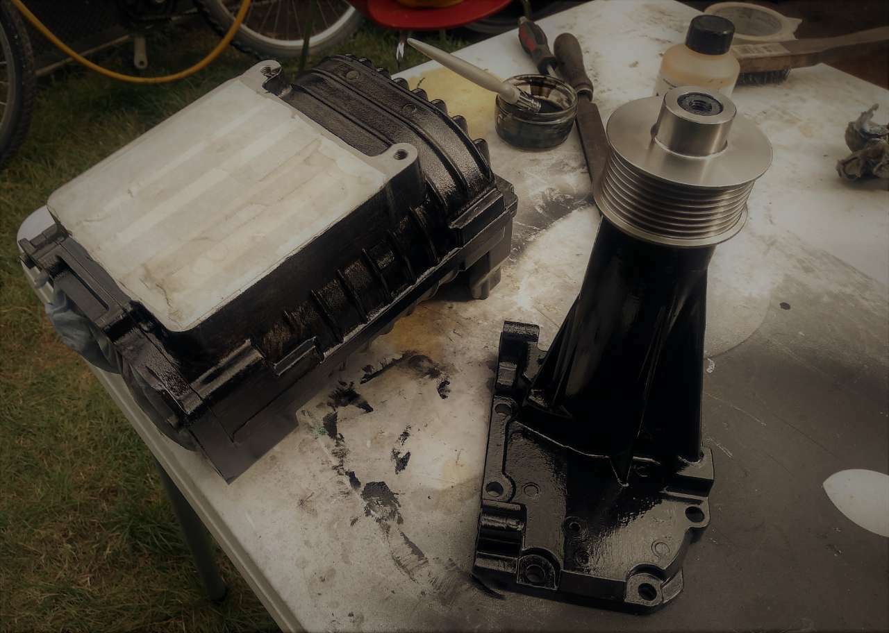

The supercharger is getting rebuilt by me once the kit turns up. It was to be sent away but then I realised that there's two parts to the service, the snout and the body. I was under the impression that the service was £300 but then later found that that was for the snout only! So to get the snout and body serviced, and a 6% pulley (smaller for moar powah) fitted, I'd be looking at a fart over £800. No.
I bought a... let's call it a kit in it's infant stages of testing, for 135£. This includes bearings, coupler and oil. My coupler, the bushy bit that connects the pulley shaft to the main veins, is original and of the spring dampered type. The replacement will be a cushioned oil filled type out of polyurethane. Mine has play but it's not excessive which is gr8, this new coupler will eliminate any sloppiness for instant charge! Downside is that it makes a noise described as marbles in a tin. Some have no noise, so I need to suck it and see really. Two bearings in this M112 supercharger cannot be changed really as they are built in during manufacture and they are submerged in oil, failure is rare.
The 6% pulley was not cheap and it will complete that component. I favoured a 10% reduction pulley but even though the casting of the snout needs to be ground down for clearance with that, this engine is problematic with heat dispersal and a 10% will produce heat that cannot be managed well by the existing cooling system set up. I am modifying the cooling slightly but, I'd rather have easily enough cooling than not enough.

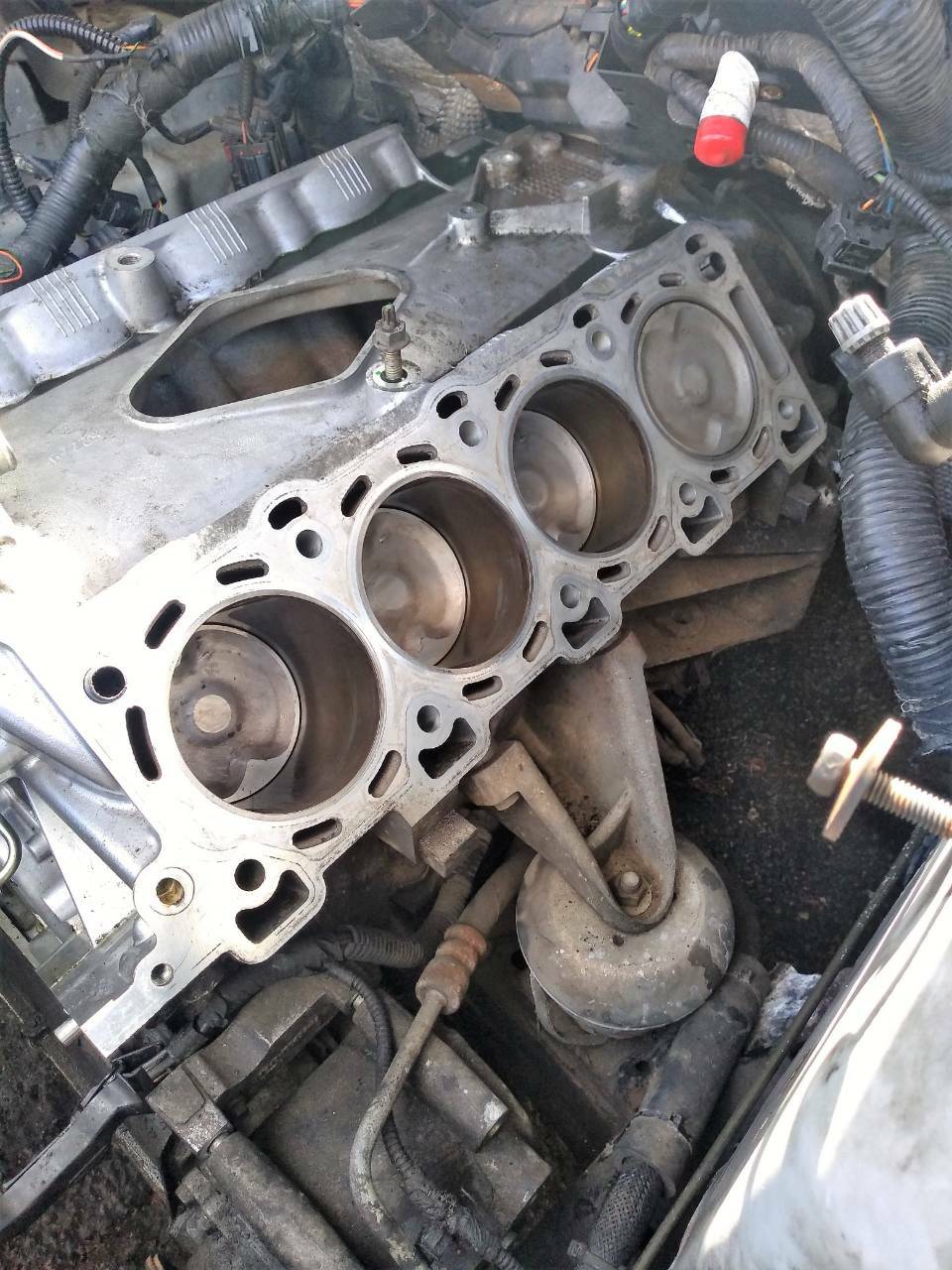

Heads released without a fight and were removed. As the exposed block is going to sit for a few days, any coolant was dried up and a liberal squirting of penetration oil was applied. That's all left until I get to cleaning and painting it all.

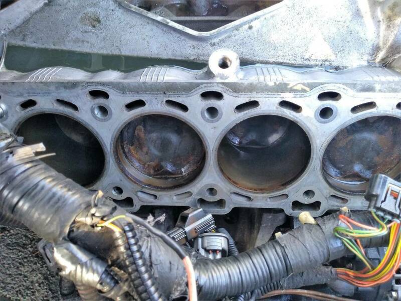

The combustion side of things showed that it had been overfuelling for a long time with glaze and carbon build up. I know what is causing this, the blow from the manifold (and now added EGR apparently).
The blows will cause a lean reading at Lambda which will cause the ECU to run it rich, when in fact, it just has a blow (or several) and it's missing combustion measures.

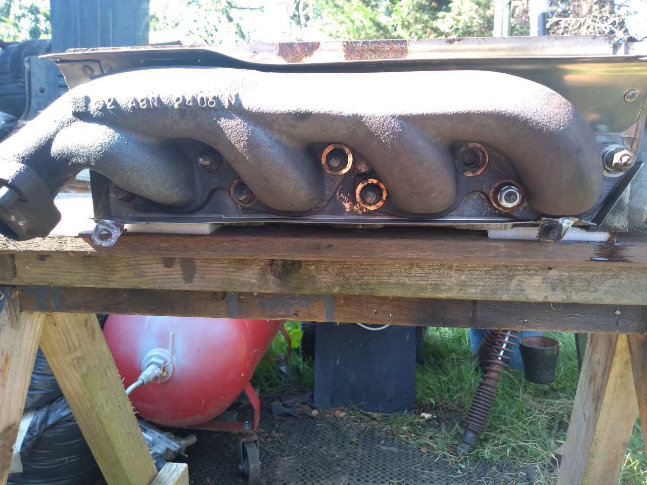

The next milestone is afoot, what is going on with the manifold?
I have been dying to see this manifold. Sure, it's just a blow, but the snapped stud and loose stud don't make sense, especially as the heat shield was correctly replaced and the fixings were pretty rotten. I suspect that the specialists would not have bothered with that and whenever someone was there, it was a long time ago.
Here is what we are looking at:
Specifically this bit...
The shiny nut I managed to put on as this stud was loose and the nut behind it rotten and solid and the other stud I could tighten. I got enough grab on them to tighten it a bit more but couldn't get it flat against the head. It did stop the EML from coming on every time I booted it though, and you see that snapped guy there? These things don't snap by themselves... or do they?
Remember that I could not really see or get anything of any worth onto these whilst they were in the car and this was all behind a nicely fitted heat shield box. My first impressions are that I can't see any major blow marks! Don't worry, it's not going to let us down...
That shiny back plate there is part of the gasket structure and it needs to come off now.
Ahh, there she is!
A blow on 3 ports too, it wasn't messing around. It's in a pretty shit state. My aim on this day was to get all the studs out of both heads. First of all we go to the one at the top right with a simple t30 socket, it came out no problem, but I could see why it wouldn't tighten-

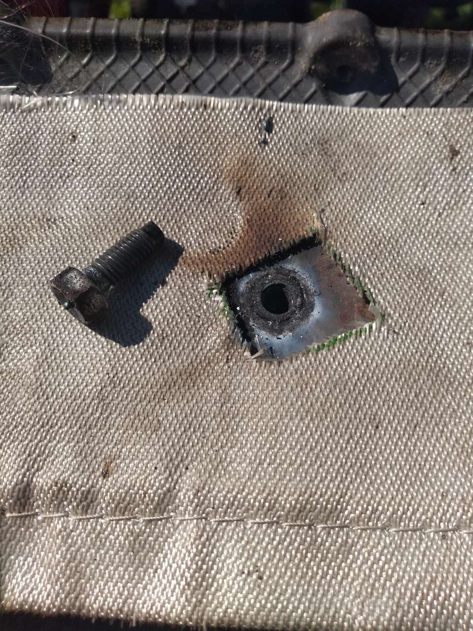

Next is the snapped stud. With an Aluminium head you can mig a nut onto the snapped guy and the head won't damage. Clean the snap with some brake cleaner, hold the nut with a shit spanner and mig away!
Note the use of a bit of fire blanket and this is a measure to stop any splatter going down to the valve seats through the exhaust port. Wound right out... this is easy as pie.

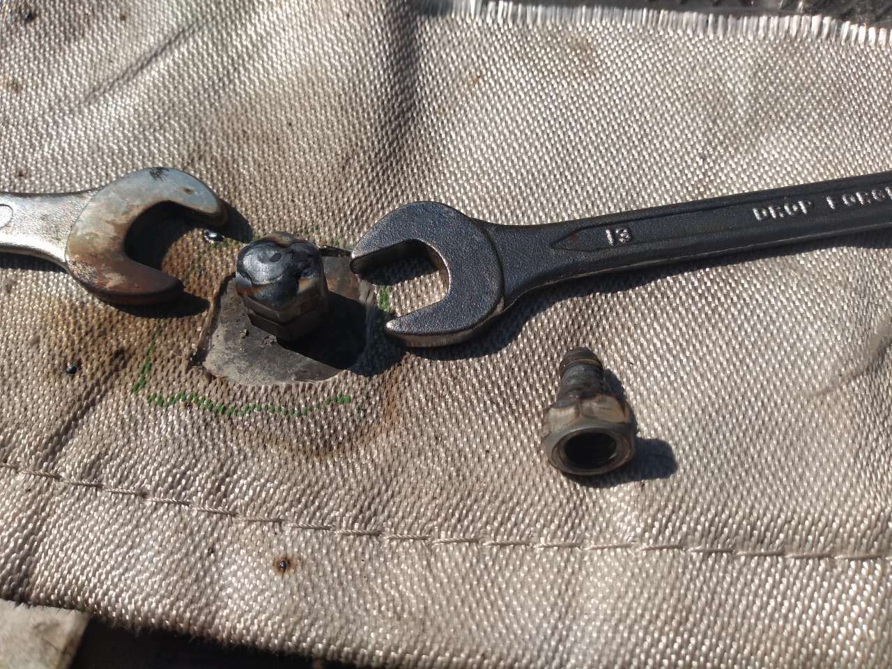

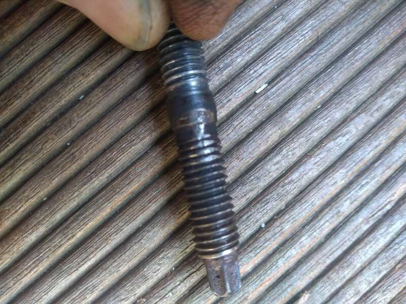

Up next, Mr 'I aint moving for toffee'. I really didn't want to snap this guy so tried the double nut technique, no dice. I then welded the nut on to the stud, the heat likely helping to break any corrosion...
We have a succeed!
You see there why I use the shit spanners, don't want to be burning up the good tools here.
All studs out of this head, cleanly and now they are ready to be tapped out later.

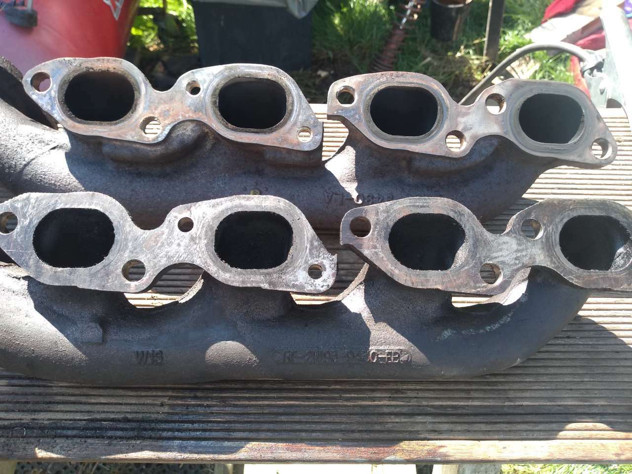

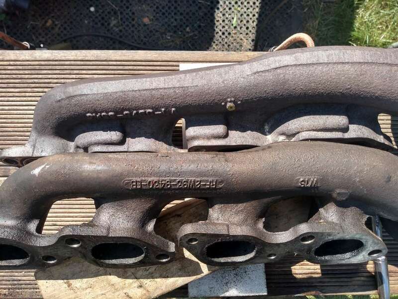

Here, I produced a thing which compares the old exhaust manifold against the revised replacement:
The old is on the left and the new one on the right. Look at those bore sizes! I would go as far to say that this is an upgrade for the old STR!

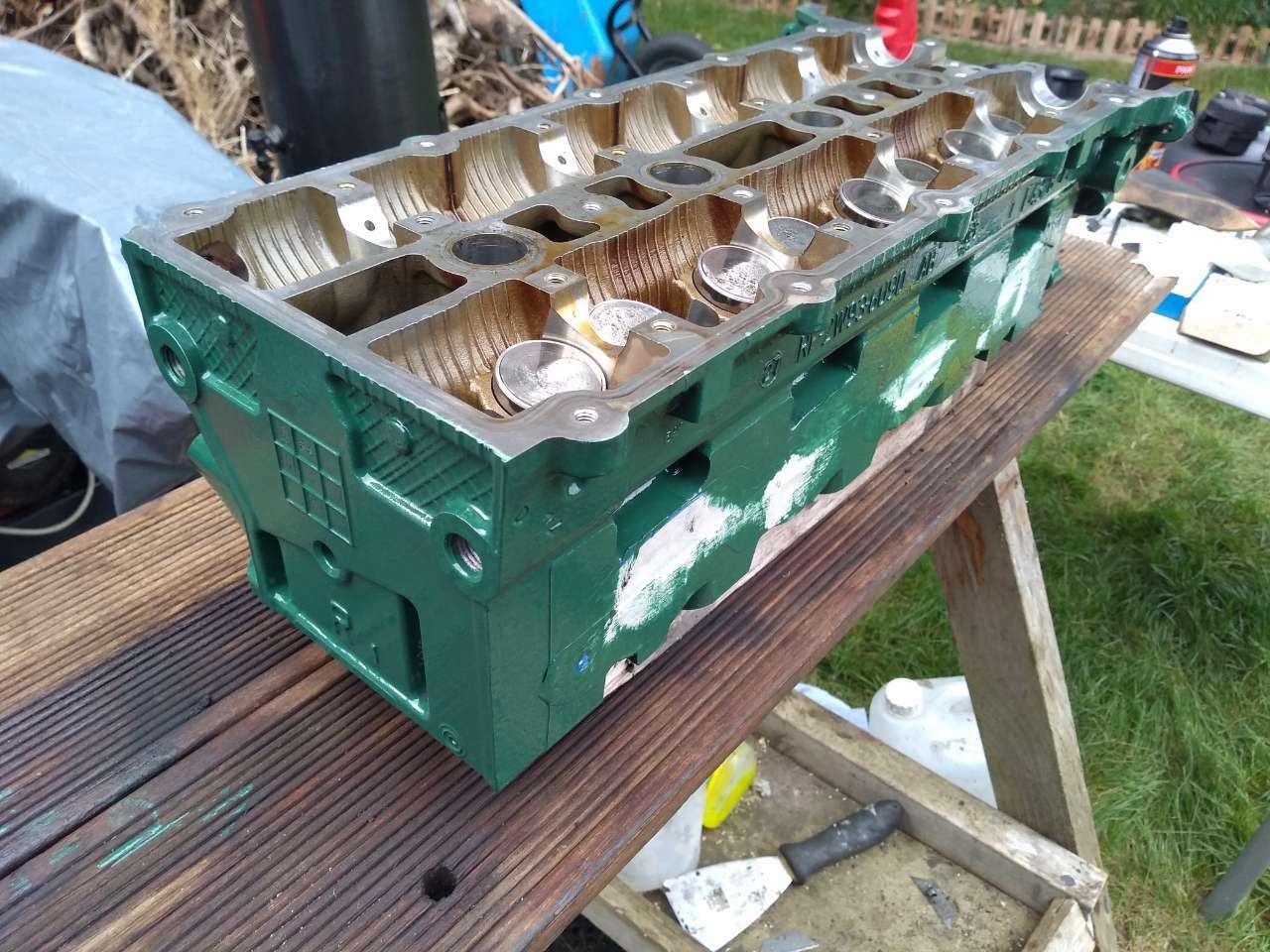

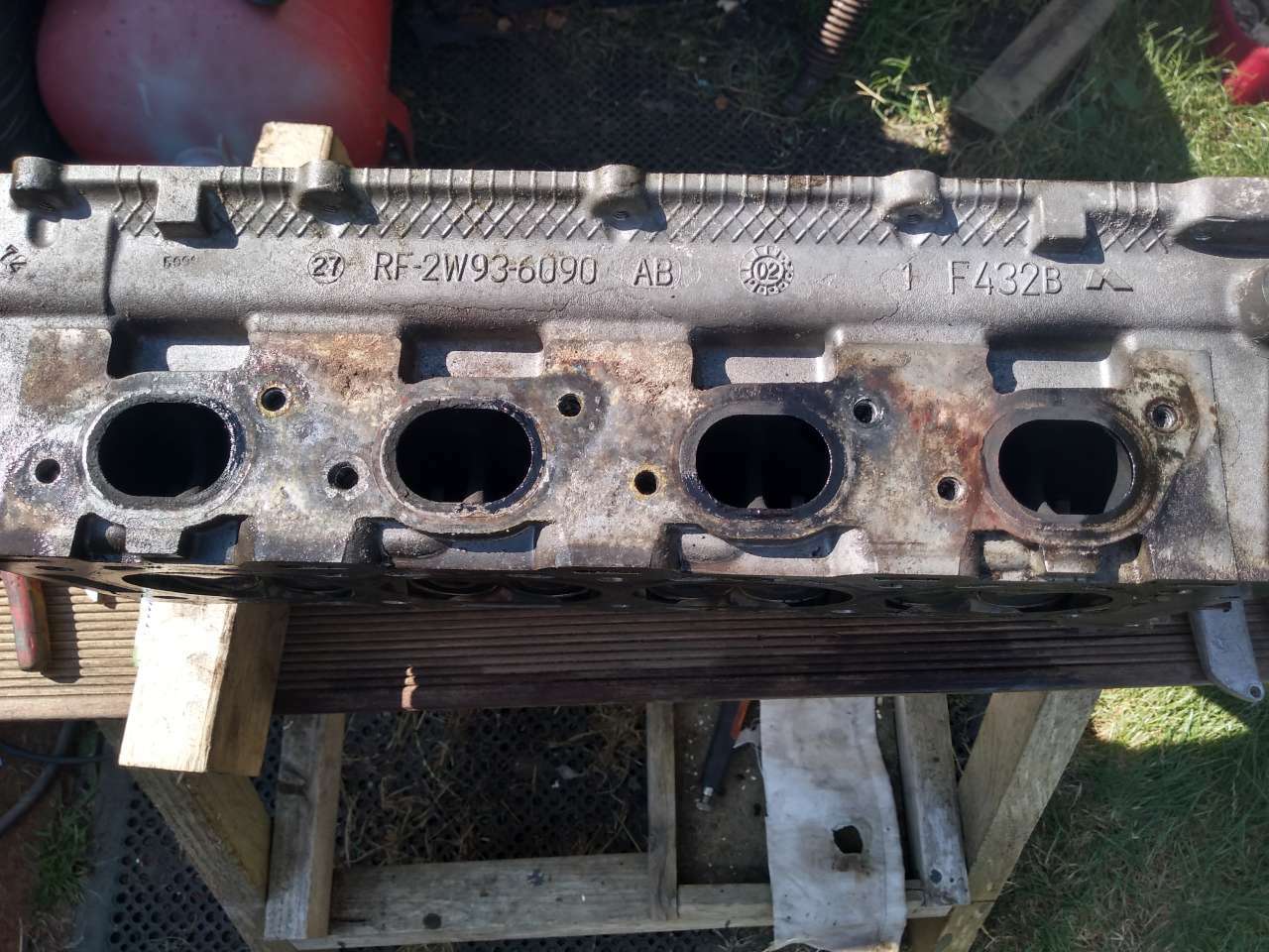

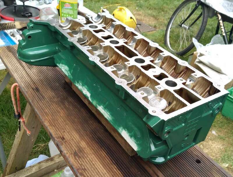

Today was consumed with moar cleaning, checking, and painting mundane engine parts. There is a few. To give myself some inspiration, I decided to tackle that manky head. There will be no media blasting, chemical dipping or other such nonsense, no, this is all to be done by hand, like in ye olden days.

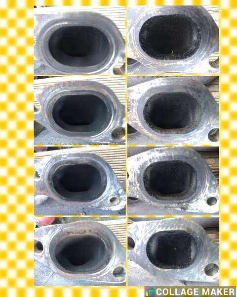

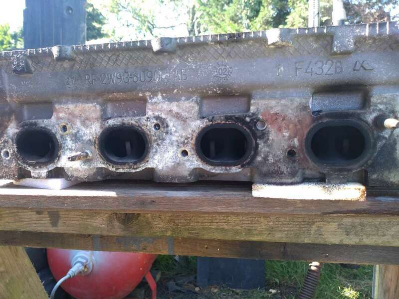

First we need put on our engineering hat, get that head, and to remove the corrosion, debris and other junk that we don't want. I bought some plastic scrapers for things like this but they've turned out to be just a frilly gimmick, luckily I have thousands of Stanley blades and a chisel. The excessive amount of corrosion here made things slow and the ally was burred up in places, nothing that a big, long, and flat file couldn't sort out. It's effectively been skimmed.
It's clean and  it's flat, so it'll do it's job and the stud threads all got a tap run down them to remove corrosion and thread lock. Yes, I was waiting for the tap to shear in one, but it all cleared out lovely.

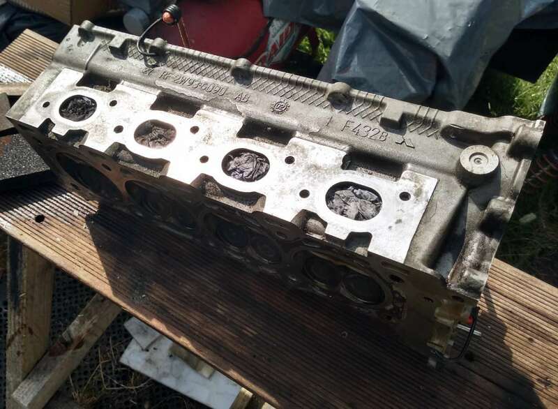

Next the business bit got a de-scale...
It was quite satisfying chipping away at the carbon build up.
I then turned my attention to the inlet side which was much the same as the exhaust side. After sorting that side out, I got all excited and decided to initiate the decoration sequence. This is where it's going boys...
It's a bit of a shame that once it's all squeezed back in, there won't be much to see, but I know it's there and that's what counts! Besides, when I'm doing this all again next year after bending 2 valves and spitting a head gasket out on my first track day, it'll be a lot more pleasant to take apart.

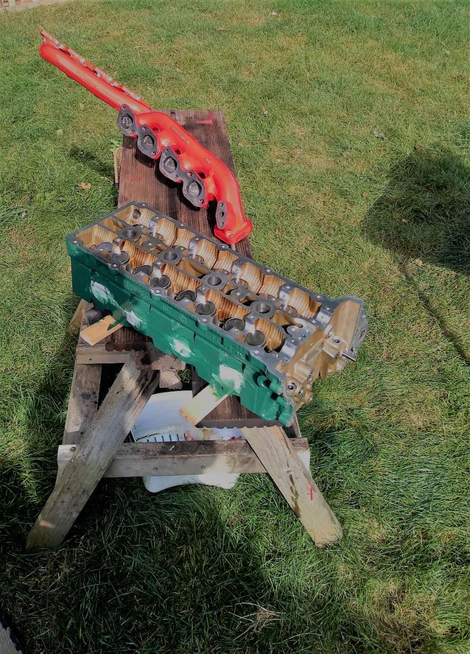

Smoll update because this bit is slow and boring.
The other manifold turned up, so now I have a pair of later manifolds, I reckon my ones will just go to scrap as they are problematic. First off with these things is that no one removes the downpipe fixings because they are arsehats to get out half the time, and need a lot of heat... and that takes a while. Then they need to be tapped out to clean the threads up and this is slow and painful X4.
Every bit I've took off this engine is getting checked and painted and that includes these manifolds. Yesterday was spent removing the fixings, cleaning them up and supporting them for painting in such a way that all areas could be accessed and they are not swinging around on a couple of bits of wire. That done, I got the paint, brush, and as I cut the tape sealing the lid on the tin... it started to drop water out of the sky really slowly and annoyingly.
Undeterred, I managed to squish my whole rig into the little space left in the shed and got to painting whilst climbing over car parts and tools.
Today they could have their second coat outside.
Stay with me here, I have artist GCE's.

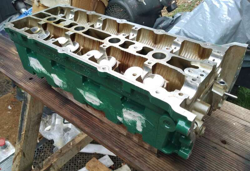

That didn't take so long so next on the list is the other head which needs total cleaning and the threads cleaned out.
And that is ready for paint tomorrow. Note my special skimming* file.
The collection of painted bits are mounting up:
There are other bits done, but there is still a bin full of stuff to do!

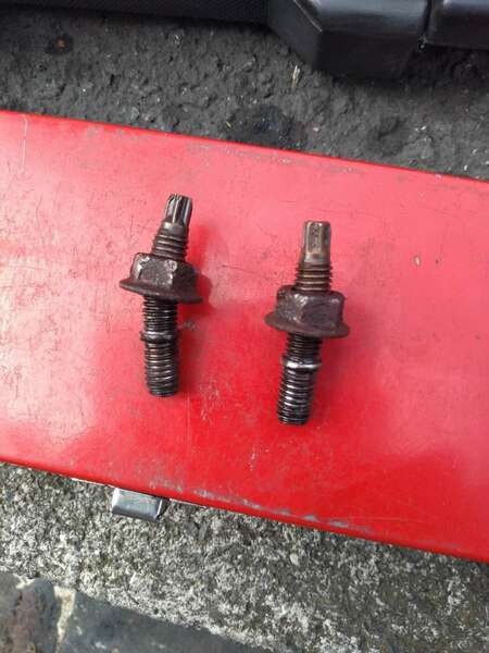

I needed new studs for the down pipes, EGR, and manifolds. The downpipe studs are a bit Jaguar but are not mega money and the EGR are too really as I looked about, but only needed two of those so bit the bullet and got all that from Barratts. The studs for the manifold though, I need 16 and the Jag ones are like just over 3£ each, without nuts! Of course they are weird lengths and proportions but I found VW ones which will do the job just fine as they are pretty close and I got 20 of those, with nuts for 14£ delivered!

Yes, these engines can get to 967 degrees centigrade. I was once warned that covering my SC intake pipe with vinyl would destroy most of the UK in a hideous fire ball, bigger than the sun. In reality, it just needed a dusting off now and then and looked pretty cool.
The cylinder head paint is only 20BHP, but with the manifold pack, we're looking at nearer to 3000 at the spare wheel.

You need a press for the supercharger build. That is a fact. I have one but it was buried at the back of 99000 car parts in the shed. So I got that out. The SC pulley is 'on there' but after my marathon shed clearance, the press breathed on it, and it all fell to bits.
Re-bearing the snout transfer spindle was not straight forward. Once I had built it, the spindle was all bound up and hard to turn. Something wasn't right. I had to take it apart again and the new bearing got destroyed in a fit of anger and frustration. Luckily, the old bearing was fine so I put that in and then the oil seal on and then pressed on the new pulley. This bound up with the casing and the whole thing wouldn't operate. Not only that, the spindle was not pushed through completely as it was too short through the pulley. The pulley, although smaller, has the same central mounting dimensions and it was not the same as it was before. Cut a long story short, it all came apart again so I could work out where it was going wrong.
I engineered* some of the casing off where the pulley was to sit over, and rebuilt the spindle for the third time. SUCCESS!
The cleaning was also a nightmare and tedious and as for the needle bearings in the main casing... after that fucking around, they can stay as they are... they work just fine. It got a lick of paint and will get put back together tomorrow with it's new coupler and then I don't ever want to see it again.

Not losing the will to live or anything but, you know when you wish you hadn't started something...
TEDIOUS!
That is the word of the week kids. I still have a crate of bits to clean and paint but they are all basic castings so not very in depth.
The other head got painted and all the threads tapped out and cleaned. The new studs turned up and both heads got fitted up and a final prep clean ready to be fitted. The supercharger was put back together and got prepped for fitting. Needs oil yet.
Washers... forgot to get some washers for the manifolds. Out of the billion bits of hardware I have stashed, nothing worked well enough so I ordered some thick, stainless jobbies and a 100 normal stainless M8's as I'm out apparently, these are for other things.

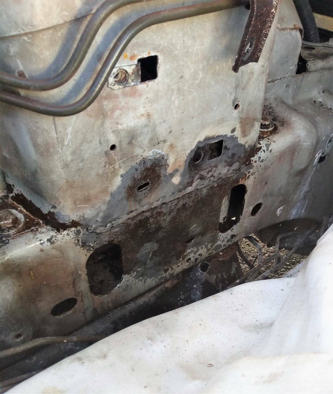

What was looming on the Horizon was the pig arse job of cleaning the block, pistons and engine bay in general. I wasn't looking forward to this and just didn't know where to start with it. At the beginning is my usual resolution.
Rust...

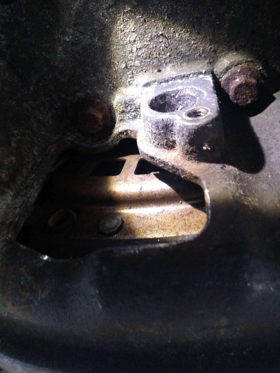

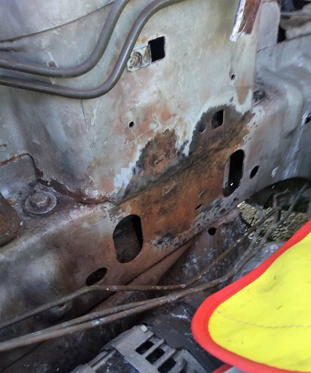

Potato cam engaged! This is the bottom of the O/S turret. A great shit trap on all these models. Crap is accumulated in this box section from within the inner arch and sits on the chassis rail FOREVER. Here we can see (sort of) that the grot has seeped down the overlapping panel and destroyed it, marked in the yellow pen. I intended to cut a small section and weld in new plate but decided to cut the whole lot out and weld the panel cut directly to the chassis rail.
Snip...
Then the rust could do one and sparkly stick commences. Note the Gr8* condition of the unfinished paint, thanks Jag, but look below for improvements!
Racecar.
That was shit, so moving on...
Pistolas!
Grim yeah? Watch this...
BOOM!

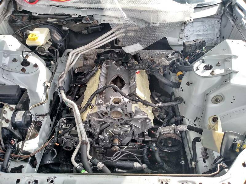

Then I proceeded to clean 89% of the engine bay with degreaser and a toothbrush!
What a load of bollocks that was, but it's the last worst bit out of the way really. Now it opens up for a bit of painting, wiring repairs, and a general tidy up. In the above image, the bubble wrap is inadvertently covering my latest modification. I decided that in order for this to be a real race car, the AC needs to be ripped out. It doesn't work and I found that it had been bodged which was shocking. One of the Schrader valves must have been leaking and instead of changing the simple valve, clearly the better option was to fill it with JB weld and stick the cap back on. Yeahhhhhh.
Anyhoos, by removing the ridiculous AC pipework and the massive cooler in the rad pack, I have gained an inch of space and extra air flows for the important stuff. I should measure up the compressor mounting and pulley position so that I can eventually bin in and fit an idler pulley or just get a shorter belt if it works, don't know yet. I don't use AC in cars, never have, and it never works!
A day off tomorrow perhaps. I want to get the looms fixed up good next but I'm running the risk that in a car renowned for breaking it's wires, I've had to move these looms a fair bit and I'll get it all done and then have to go tracing seventeen broken wires when it's all done... I guess whatever happens, happens right? 😆
One word of warning about just stainlessing everything, are you using stainless for the exhaust manifold studs, and do you know what they use originally?
Generally it's not stainless, some sort of high alloy steel and the reason being that the types of stainless used for fasteners (austenitic) have a thermal expansion somewhere around 1.6x higher than the cast manifold they are clamping, which can lead to some uncool situations with regard to not leaking when hot.
And exhaust manifolds are hot and we don't want to find you at the bottom of the nearest sea when you've put it all back together and the manifold is blowing.
Sorry if you're not planning to use stainless manifold studs, (you may have mentioned and I've missed it) but I'd probably not is the point I'm getting at here. Fine for nuts and lower temperature stuff.
Anyway that's the message, as you were.
Cheers for that. The studs remain as steel. It's the washers retaining the manifold that are stainless. I'm trying to avoid getting the corroded nubbins that they turn into. I have seen cast spacers used by Jaguar but I've not seen them used on this model, and there were none on it. Thanks for the advice, it may be worth spending an hour setting up a test rig and heating it to 9000 degrees to see how my chosen set up reacts. Good plan!
