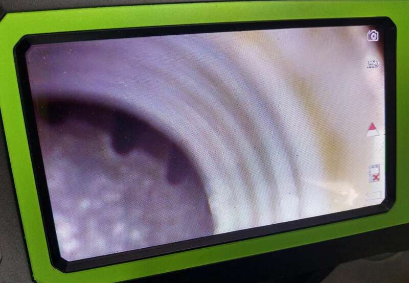

Whist I was at it, I cut open the old engine oil filter to look for crap, and it was dirty but there was no nasty bits. I cut the fuel filter open too. I was a little surprised at what I saw.
Don't mind the metal shavings, I took a saw to it, what surprised me was the way in which the grey rubber had started to break up. Not so bad if the bulk of it was before filtration but I found some after too.
And you can tell that by looking into the hole in the middle. There was actually a fragment in there. This was a Wix filter.
I cannot tell how long it's been in there and have to assume it's longer than 6 years. It's a good reminder to change your filters gents. I now need to have a look at the fuel system after filtration and check none of this rubber crap has made it through. Great.

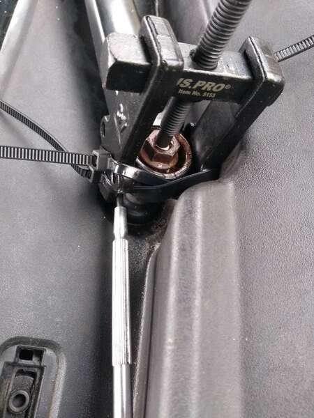

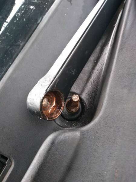

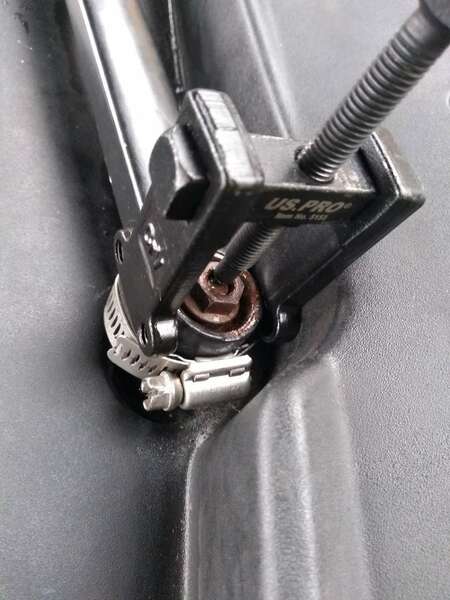

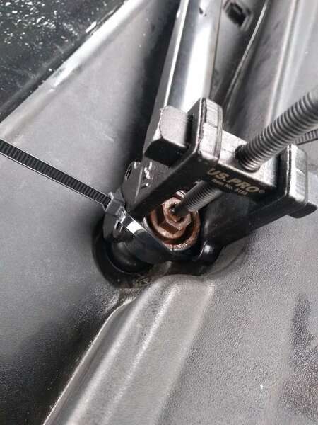

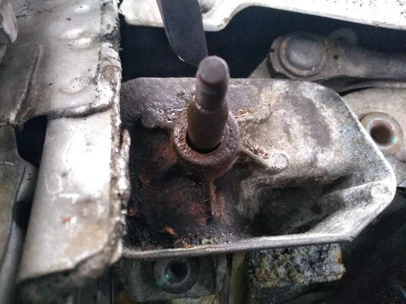

Say, er... that list of works to do today was a bit optimistic. I couldn't get a start on it until lunchtime and then it took another 45 minutes attempting to get the wiper arm off. Brian struggled. I had to disassemble Brian as a fundimental part of it would not work due to the wiper arm being in the way. We are now naming it Bri, as 50% of the tool is missing.

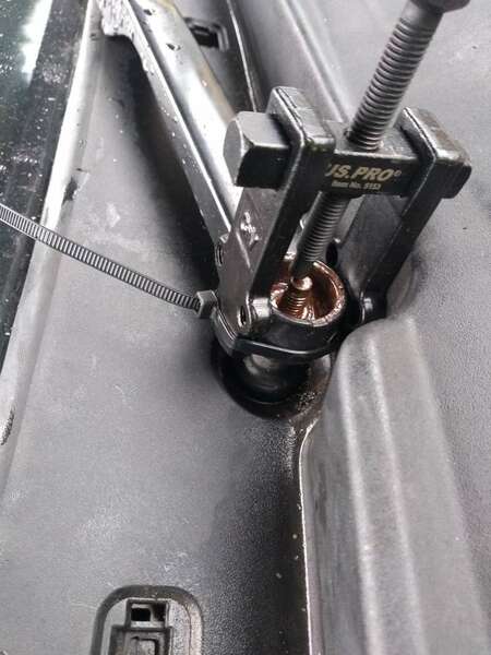

The issue was that I could not fit the bolts which kept the two sides of the puller taught. This meant that it would just clumsily slip over the arm. I had an idea.
PLAN A
The pressure screw just slipped off the spindle. Darn it.
PLAN B
Add more ties and the nut.
The clamp just slipped over the wiper arm. Darn it!
PLAN C
Add tie lower down.
She's biting but still slipping clumsily off. Darn it!
PLAN D
Install a socket at the top to stop the clamps collapsing...
It's tight, is it working? Nope. The clamps are still loosing bite but only on one side. Progress?
PLAN E
Introduce something for the clamp to bite on...
The cable ties are now stretching and it's losing grip, and clumsily falling apart. This isn't working is it?
PLAN F
Moar tougher restraint!
POP!
YAY! (distant round of applause)
That took way longer than it should have. There are a couple of factors here that didn't help. a) there's no room to put a tool in and 2) the bottom of the arm is beveled.
Still, we won. Then the real nasty stuff could commence!

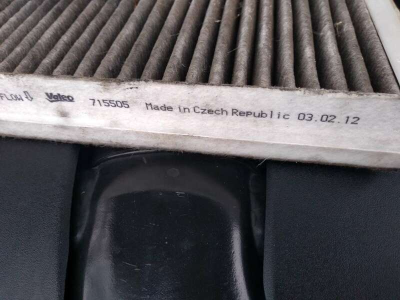

First off, the bit I've been wanting to get at for a while... the pollen filter! This sucker (see what I did there?) had been in there for a while and was quite heavy. Note the date on it.

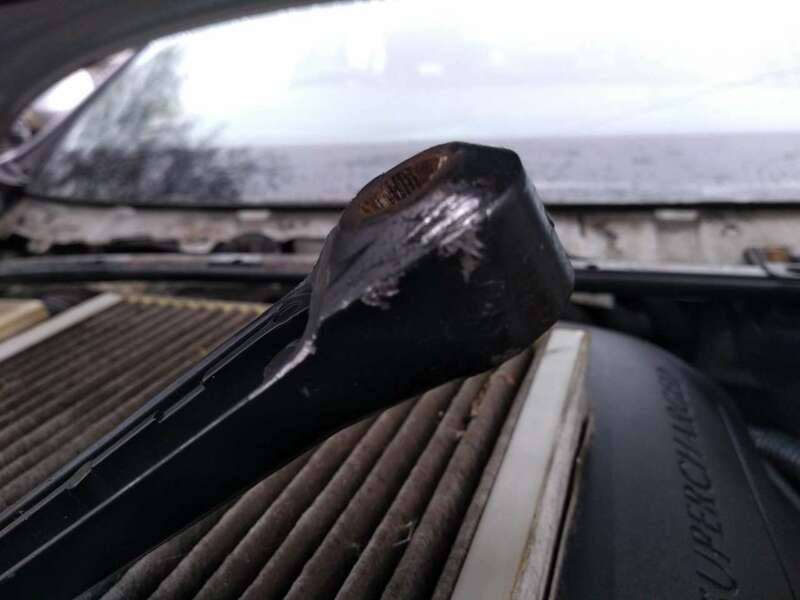

Then it was a look at the linkage. The actual linkage bit is fine but there is wear on a brass sleeve in the drivers wiper mount. This is causing some movement. The spindle also rises and falls vertically by about 10mm for whatever reason. A washer and retaining circlip have been removed prior to this image being taken.
I ate up this play by temporarily installing a couple of washers to see it's effect.
The whole mechanism was unbolted and those bolts greased and put back in, forcing the mechanism as far up towards the windscreen as possible. I'd like to see if I can replace that brass bushing and also see if the mechanism removes without taking out the servo!
A bit of garden hose was stuck in the vacuum and taped in place, this allowed me to suck out all the debris laying about in the depths. The rubber drain was removed from the drivers side, it was blocked.
There was a fair bit of corrosion there too so it was all cleaned off, as were the wiper arm spindles. Liberal amounts of grease was applied absolutely everywhere. This is something that I done on my black Stype some years ago which was in bad shape, much like this, and it has been trouble free maintenance since then.
The passenger side drain was also blocked, pine needles too, and a lot of them! This image was taken after I had spent too long ramming a small vacuum hose down there and it repeatedly blocking and pulling crap up.
So, to better access this I removed the cabin filter box and the plastic tray surround under that. I couldn't get the tray surround out as it seems the strut bar needs to come out and I've seen all those bolts shear and I'm not ready for that fight yet, so left that in and just moved it over to make access. It cleaned up well with a final wipe over with my oily rag. Then the plastics were cleaned and refitted.
The screen and plastic deflectors to the sides were all cleaned too. There was some remains of insulation but I removed it as it was falling to bits and covering all my cleaned bits with white dust. I shall get some thermal deadening mat to replace it. At least now I can access there with no more bother.
A new filter was bunged in and it was all put back. The drivers wiper now does not contact the bonnet despite the wear, it's close but misses in some weird display of optical illusion.

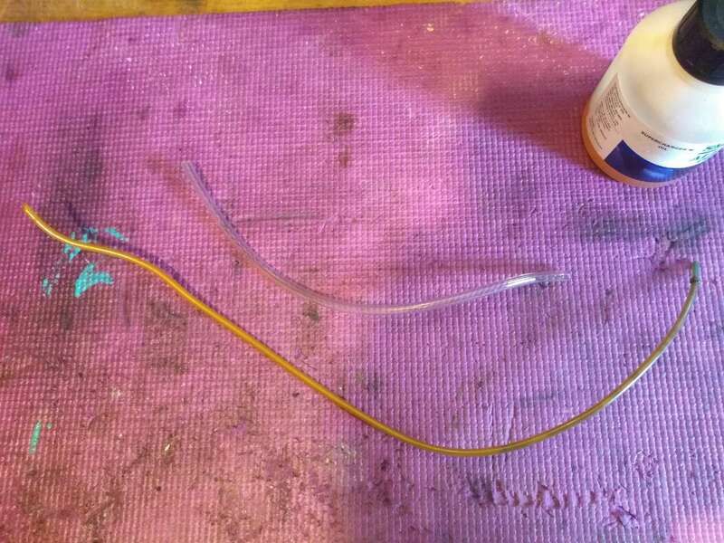

Welp, that wasn't too bad really. Great tip to ram something down the engine to close off any holes. The plug got dropped several times whilst I fudged around with my sausage fingers.
The Americans say a 3/16th allen key goes in. I could not get an allen key in there, 4mm was too small and 5mm couldn't get in, I think I have one 4.5mm but that's MIA by the looks of things. So, being British, I stuck a T30 in there and cracked it off by sticking a tube over it.
For what it was worth, I removed the intake, because you need too really and took off another breather from bank 1, it just made tight access that little bit better, plus I could see if the breather plastic hose had gone brittle, which it hasn't.
I found that it paid to clean the face with a wire brush as there was a lot of debris shifting about and I didn't want that going back in there. I messed about with sucking out stuff, I read that there was some success by attaching a WD40 type straw to the syringe but I only managed to pull out 40 odd ml and I couldn't seal the pipe joins enough. It just seemed to suck in more air than strain it through the small straw.

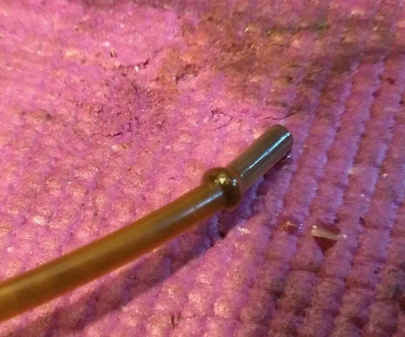

So I went to the shed. In there I found a 1986 BMW vacuum line.
IMG_20230126_132018713_BURST000_COVER_TOP.thumb.jpg.a81083a73ec48a05fad02fd022a7bce4.jpg
And this had a handy shape in it...
IMG_20230126_132026976_BURST000_COVER_TOP.thumb.jpg.b32de21507fc5c933f989a7be370c602.jpg
This allowed the tube supplied in the oil pack to be forced over and secured with a tie. The bore was bigger too so sucking was not such a slow process. I cut the end at an angle as I believe this would allow the end to slip in places better than a straight cut end.
Ignore the crap on it, this was taken when I was clearing up!
I still messed around trying to get the tube somewhere near any oil, it's a bit like blindly smashing it into a brick wall. I read that going to the left has better results as something was obstructing the entry point. I wondered what this was so got the endoscope out.
Top of hole...
Bottom left of hole...
So there is a giant bit of metal in the way but also a little passage but I only had a 5mm gap between the cog and the casing.
Shooting the tube over to the left and massaging it downwards saw success. The rear of the car was jacked up a little and I removed a total of 127ml from the supercharger.
They aren't joking when they say the old fluid looks like a black coffee. The smell wasn't too bad, I can describe it as 'synthetic fish', and you can taste it in the air. It tastes exactly like it smells... which is weird.
Getting the car level, I removed the makeshift oil sucker pipework and just used what came in the kit. I got 150ml of new oil in with it dribbling out. Getting the plug back in was fiddly, verging on frustrating, and this is where the rammed in tissue comes into play... but it got there in the end. It's either loose or tight and I didn't want to hang off it because hopefully, it'll see another change. It took a shade over 2 hours from getting the stuff out and putting it away, so not too bad!

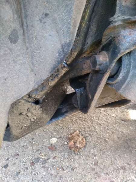

I've just spent 2 days bound up in the rear suspension, trying to sort out from the subframe to those bleedin bushes!
The subframe was minging, a past custodian had carried out work that involved painting all the rust, stones, and mud in MOT black and it wasn't pretty. Like most British made products, the bits you don't see much get infested with corrosion and the case of the rear frame on these S Bypes is no different.
I only wanted to swap some bushes over but I couldn't ignore that. So, most of the rear frame got a beating from some blunt metal, a wire brushing and a tickle of rust cure and prevention.
This car is also haunted. I now know this because for the third time, I have gone to take images of it close up and my phone battery has died after a couple of snaps with over 40% battery left. Today was 56% and this does not happen elsewhere, so explain that.

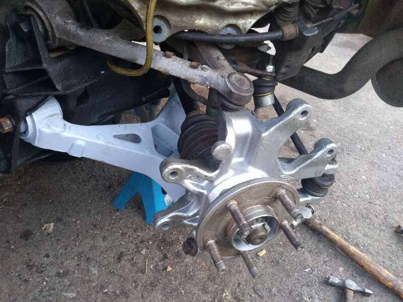

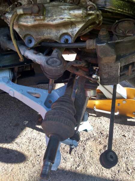

I started with the OSR bottom arm off, that involves removing most of the stuff in the way but I did see that it had replacement copper brake lines routed badly and replacement speed sensors of which the wiring was left laying on active suspension components. These were put right.
The rear track rods are almost toast and I have cheapy replacements but opted to wait until I can get the proper kit, funds are tight to non existent for now for this car as it's eaten everything! Hold that thought though.
A professional* had been here before as there was evidence of sawing out stuck bolts and hammer marks on the handbrake calipers which I had to file out so they looked half decent again.
They had beaten the crap out of that one, so it must have stuck at some point, which is normal.

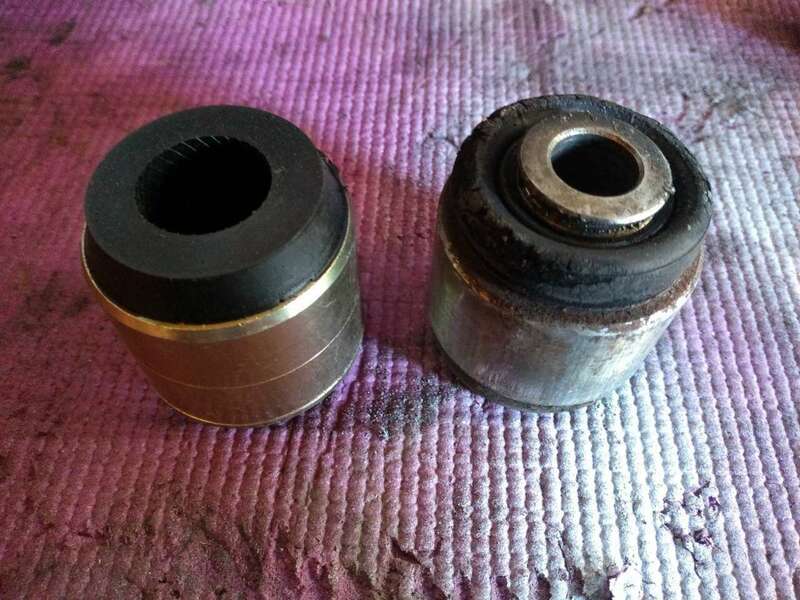

The bushes were pressed forcefully taken out and there was nothing nice about that. The arm did not fit in the press at all to remove them, so a bit of heat and 9000 wops with thor saw them gone.
Stupid things. Little did I know that these new bushes (the metal insert is missing in the image) were going to bite me right in the arse!

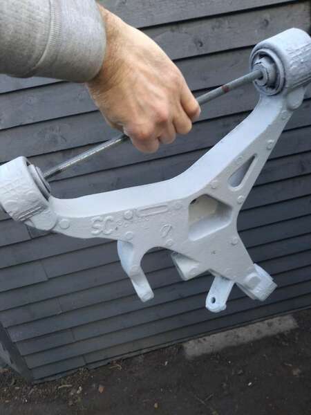

The arms were manky so I found some cheap primer in the shed to cheer them up a bit.
I'm not sure if the 'SC' on them means for the supercharged? I compared them to the spare 3L arms and they are only a bit beefier, but they are pretty much identical. I reckon that in the event of an emergency, the 3L ones could be used.
More painting of 'orrible bits...
Refitting the arms...

How did this happen then? Well, it goes back to Jaguar using 2 sized bushes in the arm and 1 size carrier hub. No-one knows what's going on so they say "measure it M8", which I did. I have the smaller ones at 54mm or something. The bigger are 59mm. Because they don't do 54mm aftermarket poly they say use the inner bushes here and it'll work out right for ya.
As we can see, it doesn't. I'm pissed about that because if I had been tightening it laying underneath, I would have seen that the ally carrier could not have taken the slack, instead I had the stupid brake disc in my face and done it blind.
To compound the issue, this was the NS and that wasn't even causing a problem in the first place! I just had to be proper and do it right by changing in pairs... IDIOT!

PARTS AHOY!

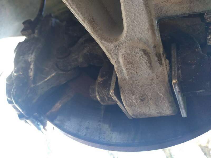

The arm to the bottom right of the image is the bit I broke... too much bend on it.
It's a bit like parts darts except I actually need all the parts I'm throwing at it!

10 hours ago, Crispian_J_Hotson said:
PARTS AHOY!
That looks as if it was quite spendy. I believe @Cluffy might get staff discount although it's only about 10%, which after the faff of posting is bugger all.
Even the oil seal was 17 squids! Classy motors, Jags 😉
SHE'S ALIVE!2!!1! (again)
Today was spent focused on an end result of getting it back to rolling around and frequently breaking, in other words, normal. What follows is an epic post containing images of Tarmac and the sky, with shagged and mundane car parts thrown in!

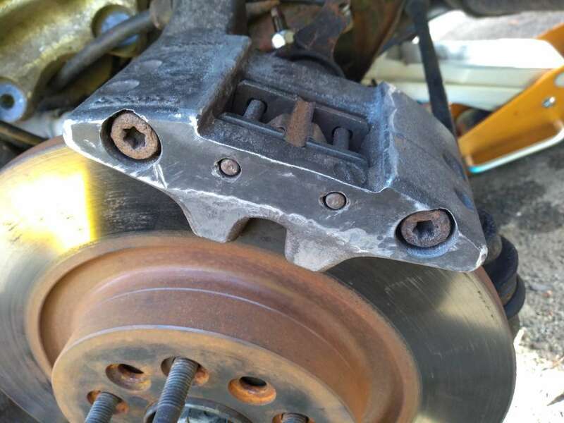

I started on the OSR lower outer bush. I found it way better to remove the calipers and brake disc as I could see what was going on this time plus I needed to ease the forks apart to get washers in tight because this side had bent a bit, but did not snap.
I planned to see what I could get in there, maybe massage the bend back out with a bit of heat and pack out the gap. The washers that I was using for packers are solid lumps with plenty of surface area, they also have been sitting in the shed for 4 years since I bought them home from the end of a building project where they weren't used.
Luckily, I didn't need that many and the aim was to get 2 per side plus any other thing I could ram in there. I got out the heat but the butane was so cold that it wasn't dispersing correctly out of the torch, I left it in the sun for a bit but there was no change and I was in two minds anyway about bending on it and settled to scrap the idea and see how it went as it was.
Well that worked out alright, it needed a slim washer added on the left side just to eat up a couple of mm. Nothing broke and it went up tight.

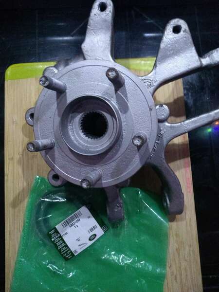

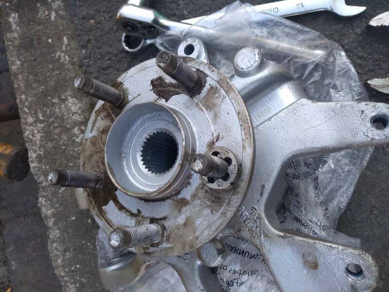

Then the NSR carrier had to be completely removed (because I busted it) and that was pretty straight forward. The top wishbone ball joint was not tight so I checked the OSR and that too was not tight, so then I had to check everything that I hadn't touched. Alarmingly, the NSR hub nut which is supposed to be 300Nm of tightness, wasn't 300Nm and undone really easily! It looks as though a bearing had been done some time ago and had been fitted by Weedy Walter.

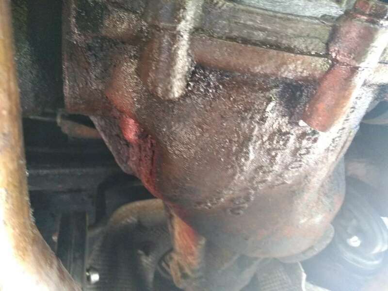

Here's a better look at my crack:
Carrier removed:
This gave me access to the half shaft which I needed to pull out so that I could change the diff seal because it was making a bit of a mess. Cue potato cam...
I know that if I hadn't broke that carrier, this wouldn't have got done for a long time!

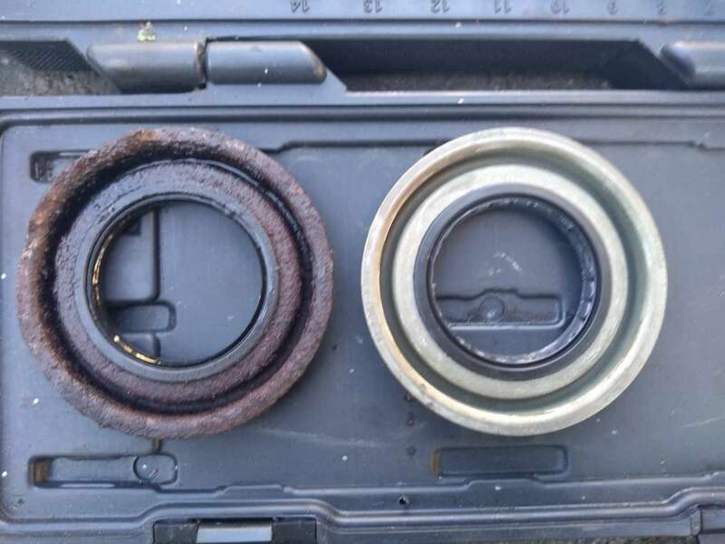

Seal removal was ok, but the exhaust limited access with tools, I thought about removing it but it's been fudged together with a tonne of exhaust paste and is blowing on every joint. I'll be wasting my time, creating problems and it's going in the bin eventually, so I worked around it.
Look... Seals!
It's just worn out... 10 years ago.
But wait, what is this on the Jaguar original part...
FOMOCO Trademark of Ford Motor Company - Registration Number 3645991

Then I could go back to doing what I was originally meant to be doing- Replacing the carrier!
First off, the replacement carrier had been painted in 'It looks like new M8 silver' and that included all the bolt holes and wheel studs so they all needed to be cleaned off as I don't want to make life hard by binding all this stuff up when I'm putting it back together!
And at long last, it went on...

HA! Yes, the seal crosses over to FORD 2R8Z-4B416-AA, Lincoln LS and Thunder Bird. This caught my eye though...
2003 Ford Thunderbird James Bond Edition Convertible 2-Door 3.9L 242Cu. In. V8 GAS DOHC Naturally Aspirated
