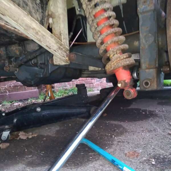

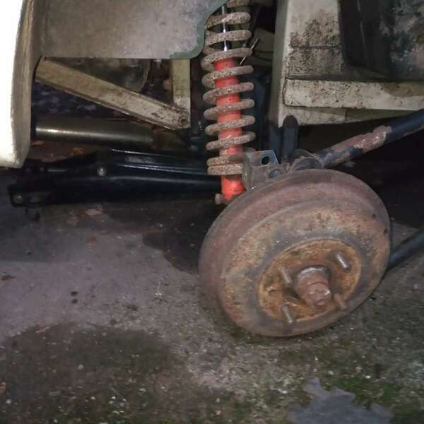

Next job on the list is the back axle,  I figured I could do this on the drive...
the design of this six link live axle makes the fixings rather difficult to access - my ugga dugga gun is not getting in there.......
Red shock absorbers - because red = fast!
Look at that axle travel!
Finally at rest

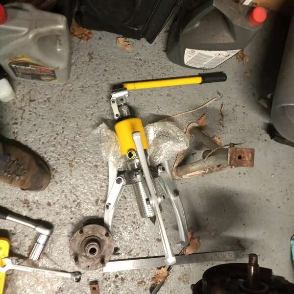

Just the fun job of stripping it and then figuring out what is wrong, I have a hub puller but I am waiting for the Ebay fairy to deliver more axle stands so I can actually support the thing with out the aid of the wheels.

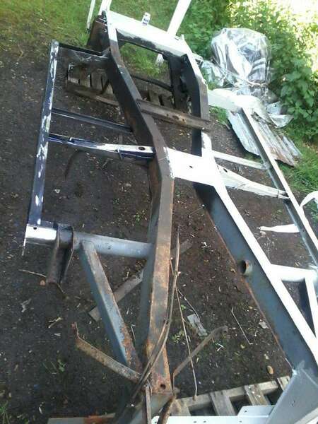

The chassis is comparible to a small lorry in places.
Your not kidding either, piccies from the chassis clean up from a few years and a house move ago.....
It's how chassis were. Spitfire is no different, and that's hardly a paragon of torsional stiffness.

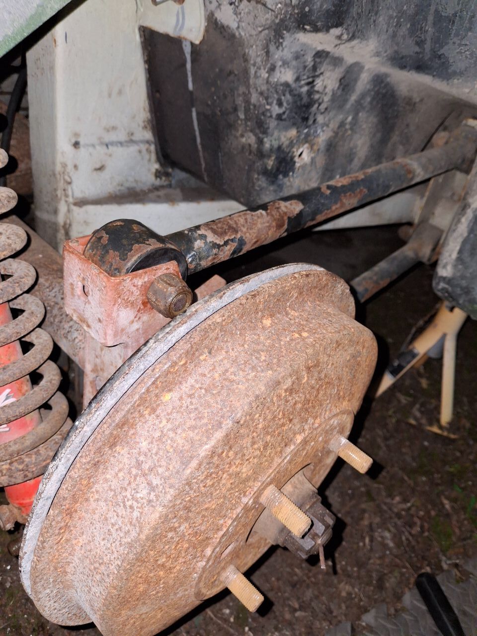

Then I moved on to the hubs, these are notorious as they are tapper fit and take tones of pressure to shift. I purchased a ten ton puller off a well known auction site as I had previous success with these. Got it in place and wound it up and instead of a nice satisfying BANG! there was more of a whimper and an oil leak but the hub staid put 😕 .
Back in the post went the puller and my search for a better one started. I ended up with a sci fi looking 20 ton puller
And off came the first hub, a proper satisfying crack this time, no messing!
Ta dah...
Hopefully it will treat the other hub with equal ruthlessness. The only negative of the experience was the hub pullers instructions I am not sure what the horse was for?

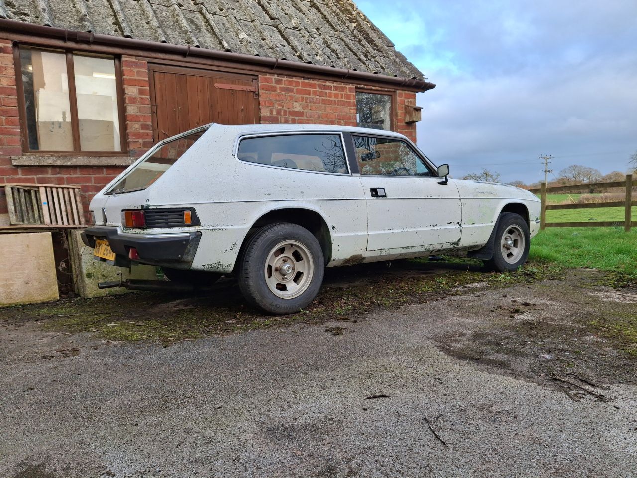

Some time may have gone by since I last updated this thread! Probably time for an update then.....
Last summer I bought an allegedly good back axle for the car, tucked it under the back for safe keeping and the car just sort of sat there feeling neglected. Then I bought an XK8 got distracted, nearly bought a project Discovery but then had a financial scare and backed out and started a for sale thread for the Scimitar.
I have to admit, I had serious second thoughts on selling the plastic nightmare fortunately/unfortunately nobody made me an offer so I have decided I better get on with fixing the car and try and make it into something I will want to keep.
First job, fit the axle..
20250914_173441.jpg.1a32bf362ff6a082bfcc118adf584aaa.jpg.3dea818e5b7adbe86e25e29ec2f5bca2.jpgWhat a fiddly job that was, not helped by the fact that the hard standing seems to have gained an unpleasant layer of moss...
Had a bit of  fight to get the trailing arms in place...
Then I made a couple of stupid discoverys... I thought I had all the Scimitar bits sensibly stored and labelled..... Engine parts in one box, rear diff bits in another, back axle and hubs all gathered together but were the hell had I left my trailing arm bolts? Actually I still haven't found them, I had to use temporary bolts to connect the trailing arms to the axle, should be okay for very low speed manouevring till I find/buy new nuts and bolts.
Secondly the Panhard rods connect to a mount which is bolted to the diff cover, for some reason a previous owner has used strange Allen head bolts to secure it, I dont have an issue with them being Allen heads, I do have a beef with the fact that they appear to be 6.5mm rather than 6 or 7mm. I had a real job finding a tool which would actually fit the size!
Wheels in place, still not back on the ground yet for various reasons....
So the project  is back on, hopefully the next update wont be in 3 years time!

Small update, yet sort of big, I found the original suspension bolts, so spent a bit of time knocking out the temporary bolts and fighting with the originals to get the bolted in
Originals back in....
And for the first time in a couple of years, its actually back on its wheels...
Look at that beautiful paint.......
Just needs some new rear brake lines oh and the engine sorting* and its back on the road.....
*Sounds simple but its either a rebuild, find a decent Essex at a sensible price or maybe engine swap??

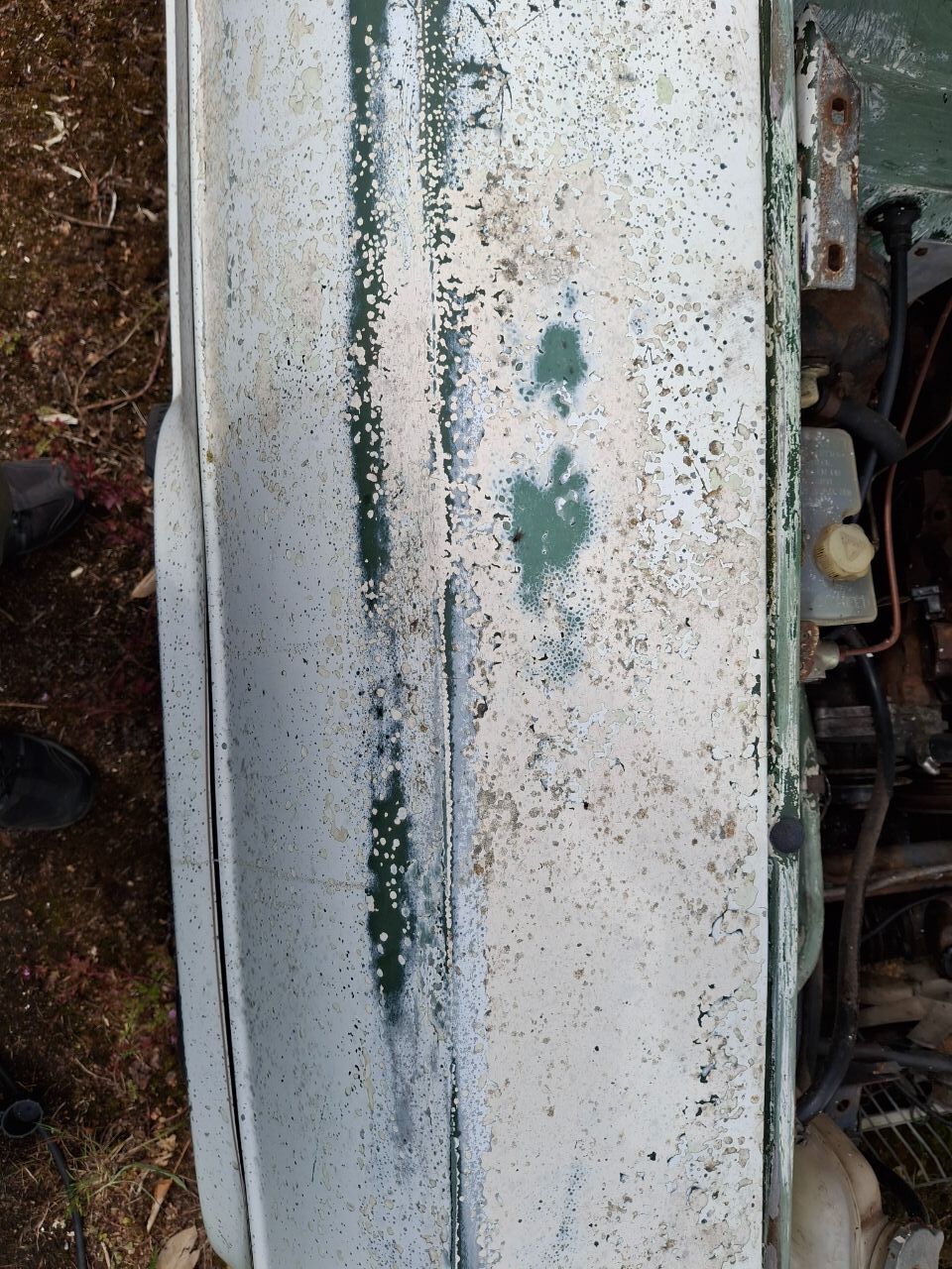

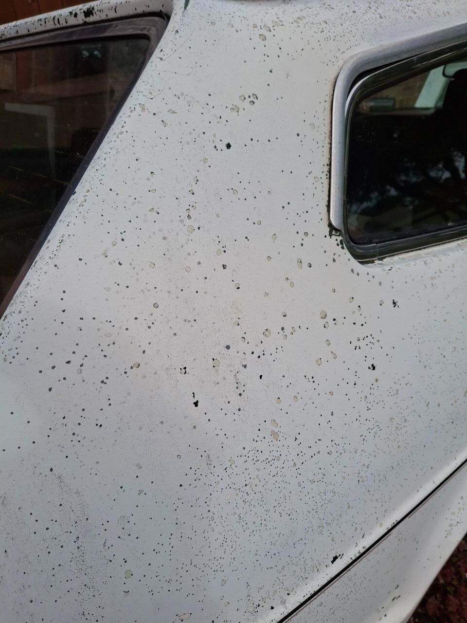

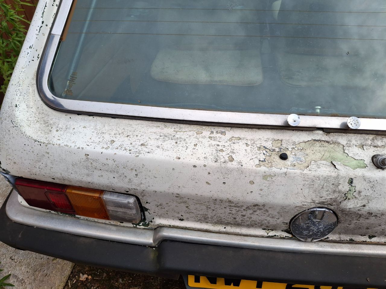

The paint is a mess,  the car was originally dark green and someone has done a terrible job re painting it white. The white paint is coming off revealing some strange layers underneath. I cannot decide if it looks nicely distressed or bloody awful!
A closer look at the Scimitar skin condition....
Tailgate horror ...
Roof braille
Wing of wonder....
3/4 panel acne......
Its almost art.

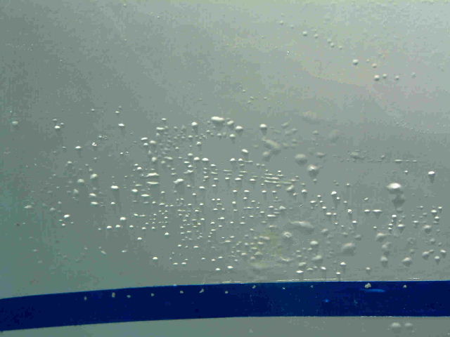

Looks like someone has chucked a load of filler/high build primer over the original Green gelcoat layer, the paint has then reacted with the filler probably due to the filler not being allowed to cure properly before the paint was applied.
Probably what's casing the issue where it's peeling is where the GRP body panel has flexed and the filler paint layer is too stiff to flex with the GRP?
The Green gelcoat is probably shagged as well, time has moved on though so GRP paints are much better as long as you key it well and use the right primer. I know of multi million pound super yachts where they fair the boats with filler and then paint them with PU paint instead of using good tooling to take the mould off.
The pits look like a grp boat when it blisters. Which usually only happens when a hull sits in water.

The paint is blistering as moisture has got into the underlying layers usualy a layer of spray filler,  really it needs stripping back to the gel coat, low baking to dry it out then sealing with epoxy before re-finising in the normal way.
