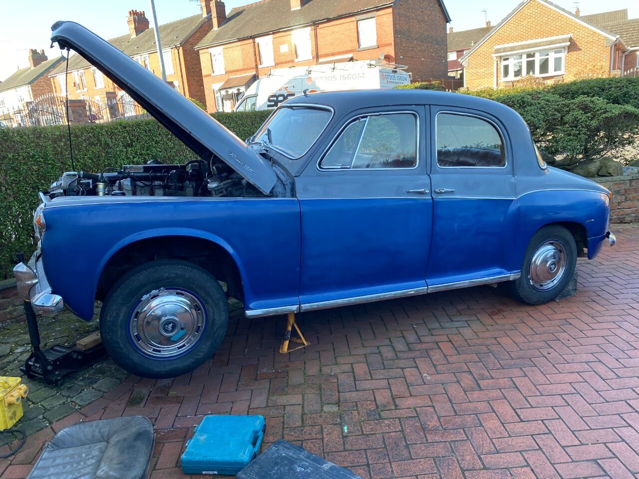

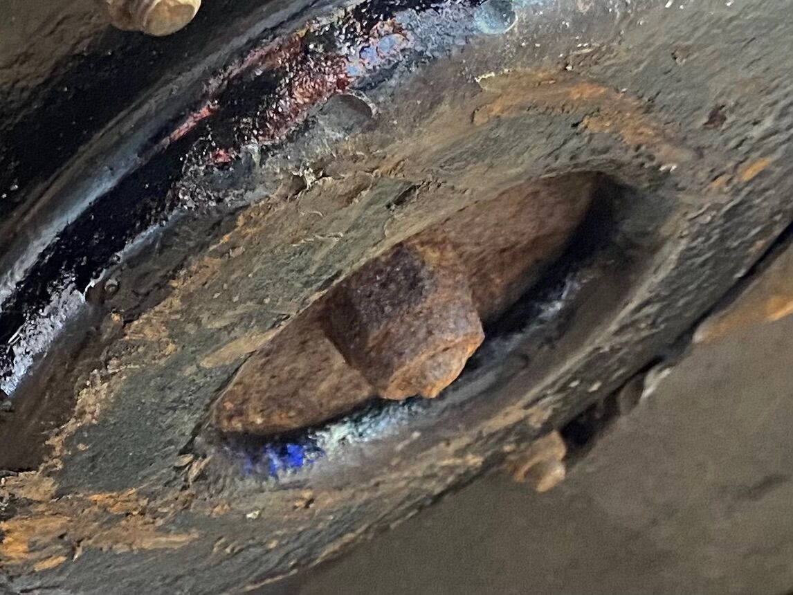

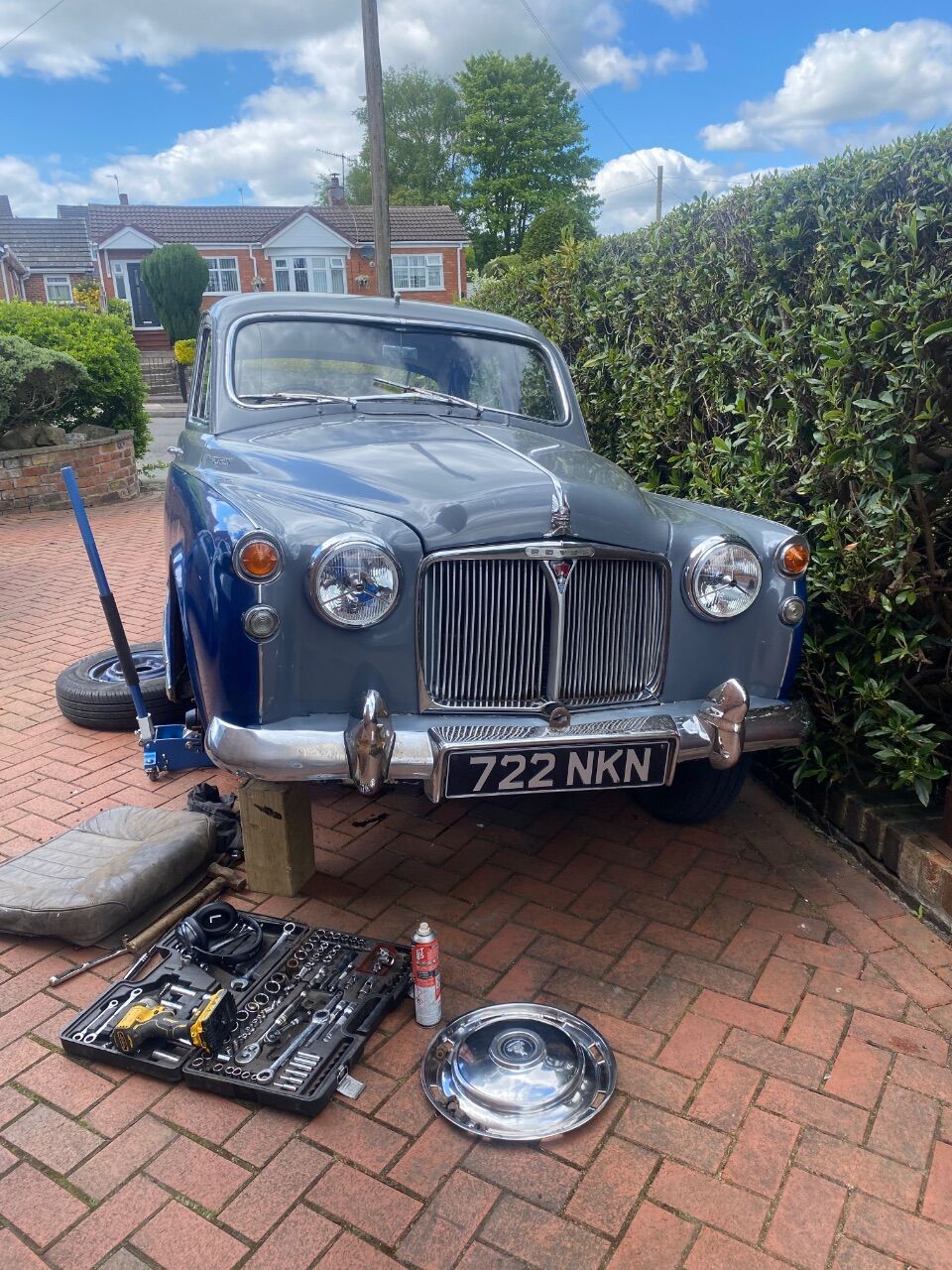

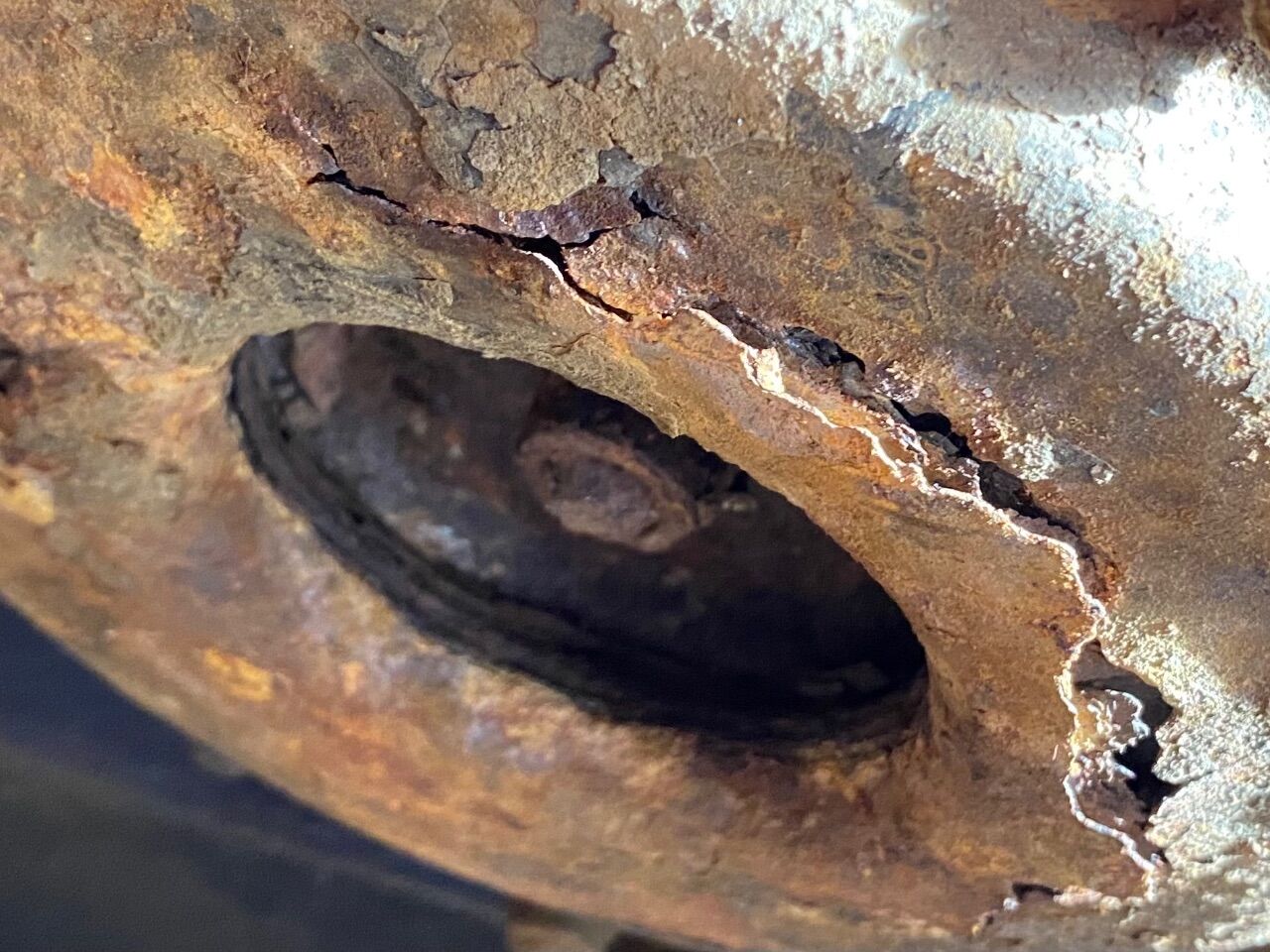

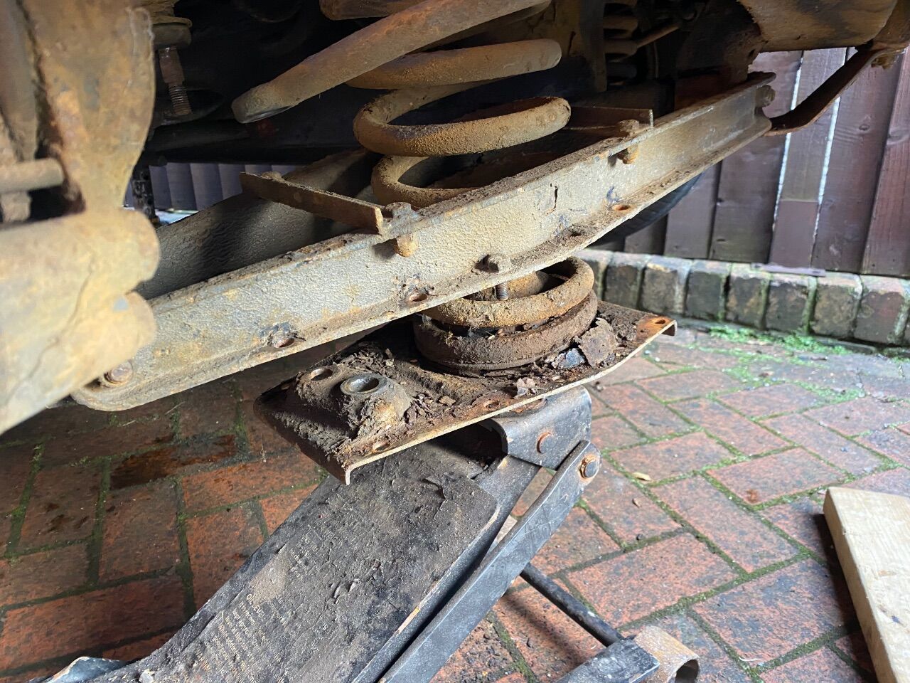

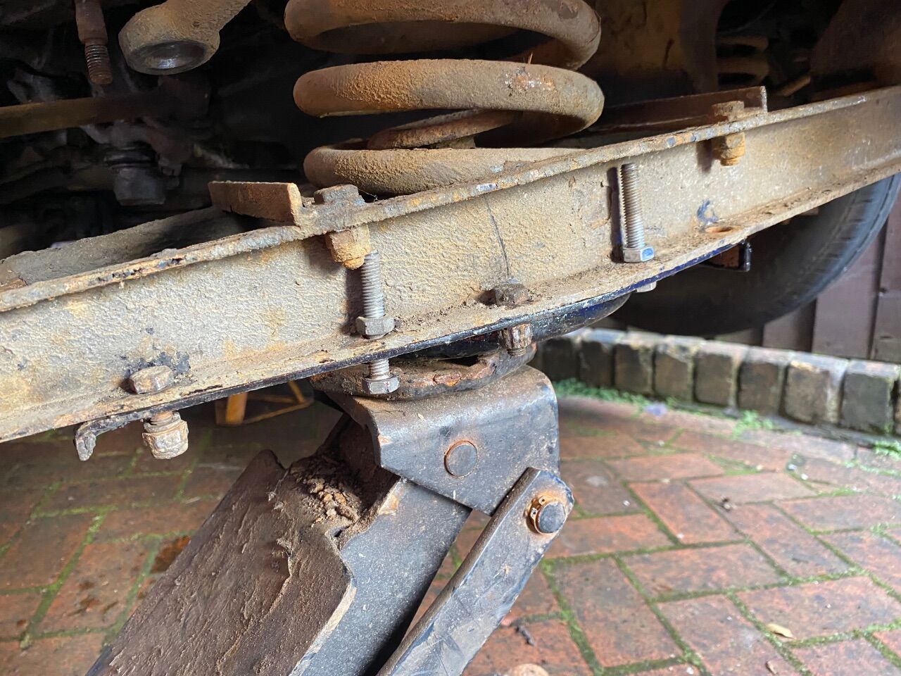

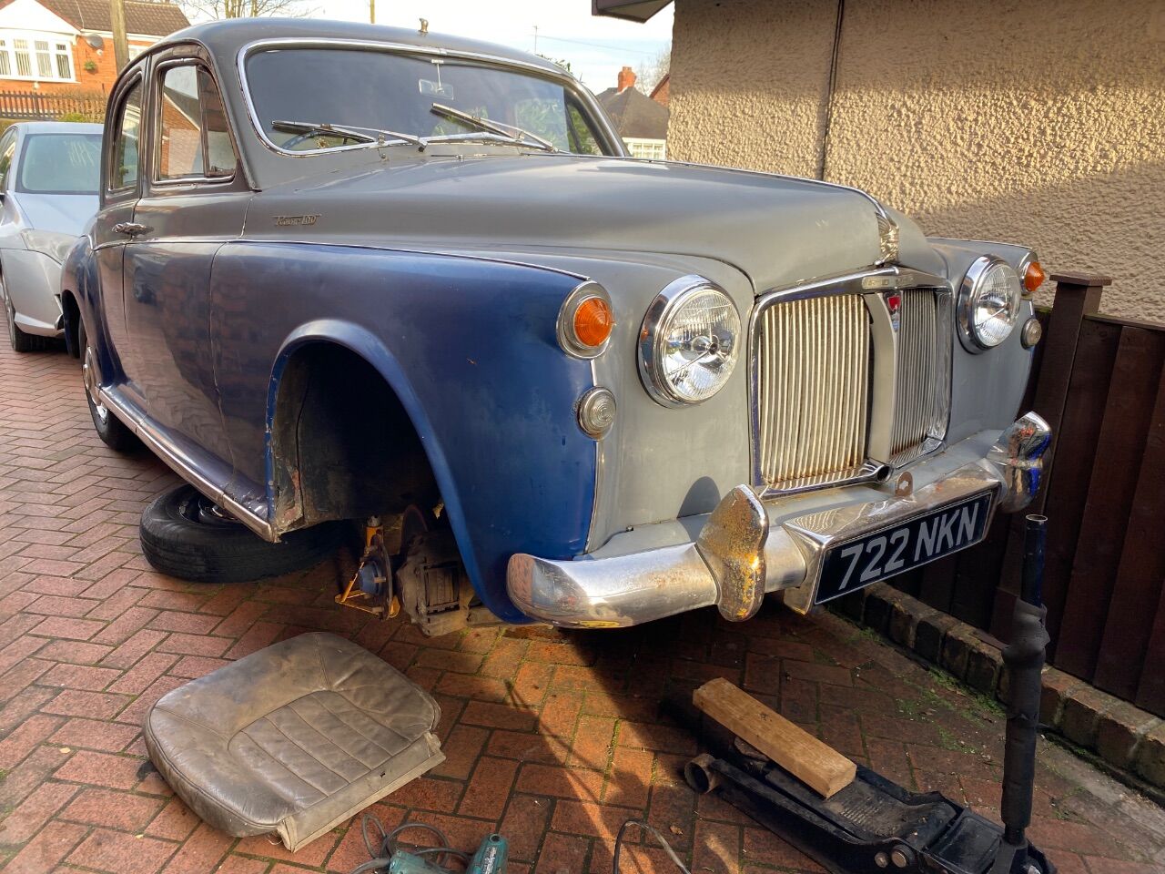

It’s not even midday and I’ve already completed another job on this old crock! The drivers side front spring pan was corroded and looked in danger of allowing the spring to burst through it, fortunately I managed to score a good spare on Sunday. The job itself didn’t look too bad other than removing 12 bolts which would presumably be seized solid. The P4 Drivers Guild have a set procedure which involves lengths of threaded bar which can be used to gently release the tension on the spring to enable it to be safely removed, the spring containing more potential energy than Hiroshima and Nagasaki combined and easily capable of slicing a man in half should they be mishandled.

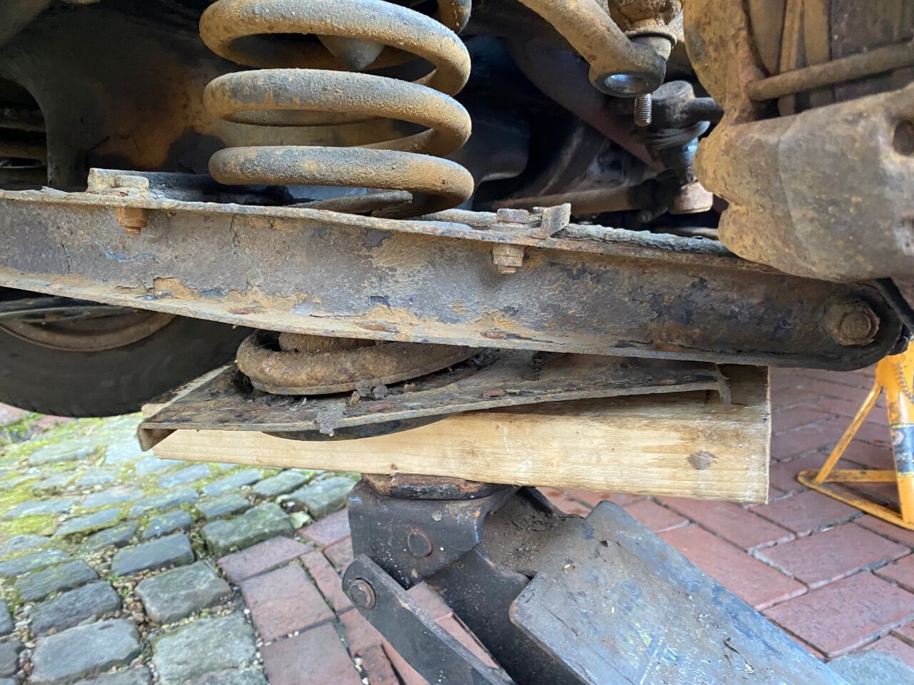

Obviously I ignored this advice and used a trolley jack under the spring to slowly lower it down to enable me to get the spring pan out, which surprisingly worked very well.

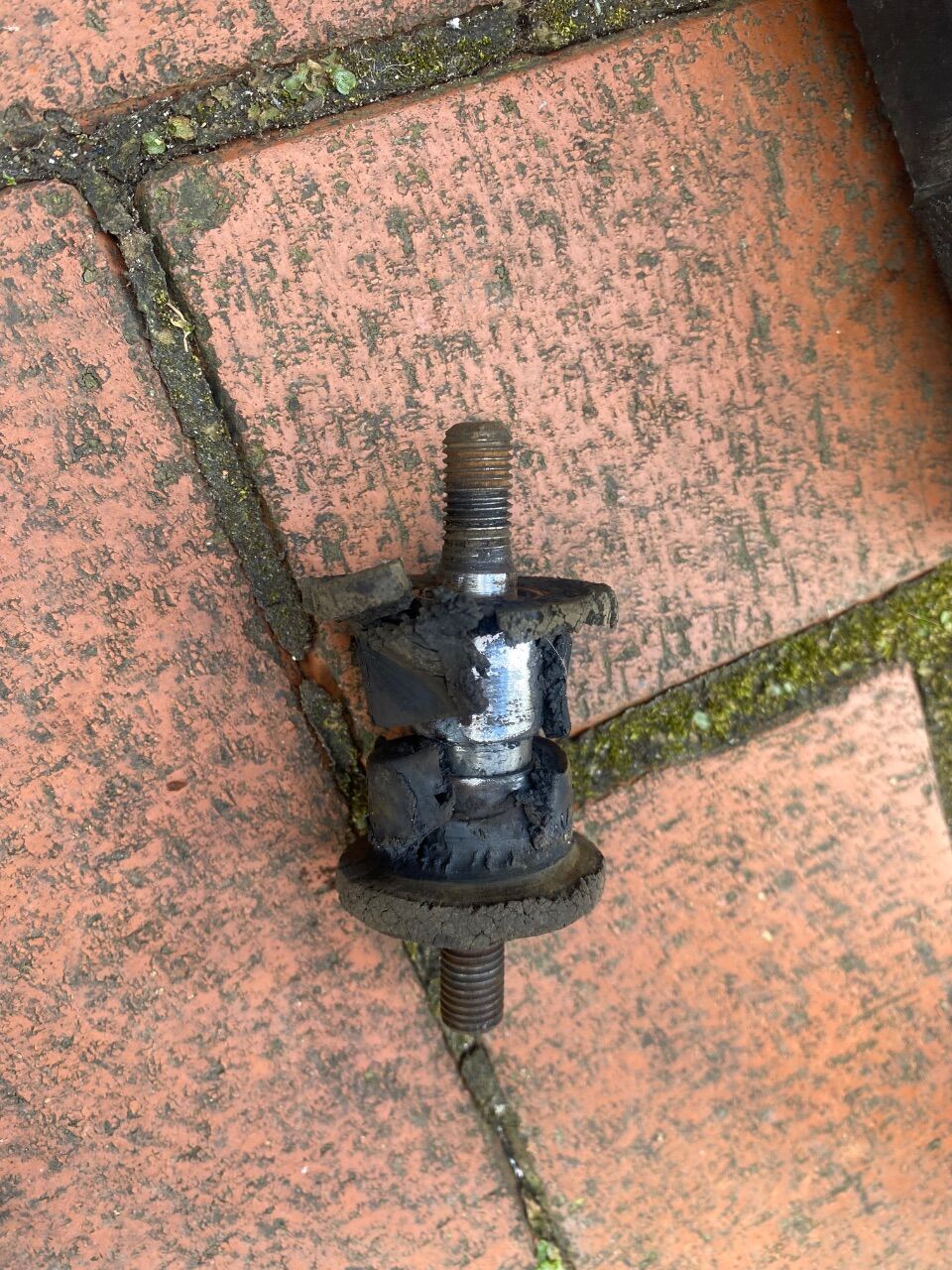

Taking the spring out revealed a couple of issues. The bump stop at the top fell off its cone and the thin spacer at the bottom of the spring had turned into bran flakes.  I’ve read that the springs on these can work harden over time and get longer giving the car a distinct nose up appearance so I might remove the spacer from the other side and see how it looks. There was no time to buy replacement parts and with the Rover being on axle stands and in the way the only option was to reassemble everything minus the bump stop and spacer

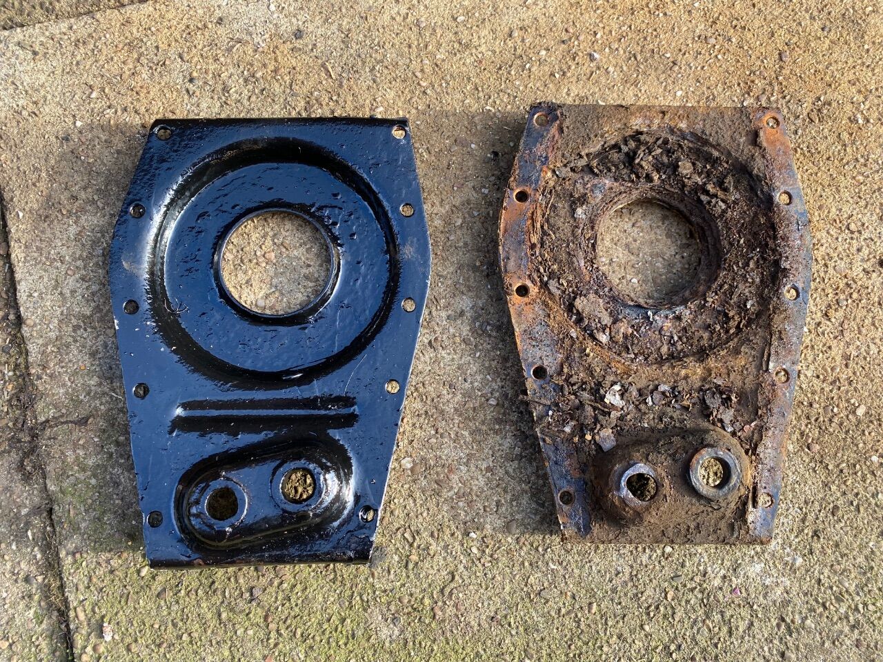

Yesterday I’d used a knot wheel on the replacement spring pan and given it a coat of black Hammerite and it was a simple job of lining everything up and jacking it into position, using some longer bolts from the random bolt box to keep everything lined up.
I’m yet to drive it but it all appears to be level and correct. I’d read that these P4s have a slightly longer spring on the drivers side to compensate for the driver which might’ve been that this spacer was. Either way I’ll have to dismantle everything to replace the bump stop mount but that can wait for another day.

No worries! They don’t seem to be a common rot spot but not unheard of.  This particular car was parked nose down on a driveway for a number of years so perhaps this caused rain water to pool inside it. I’ve seen others drill holes to let water run back out again. The other side looks fine.

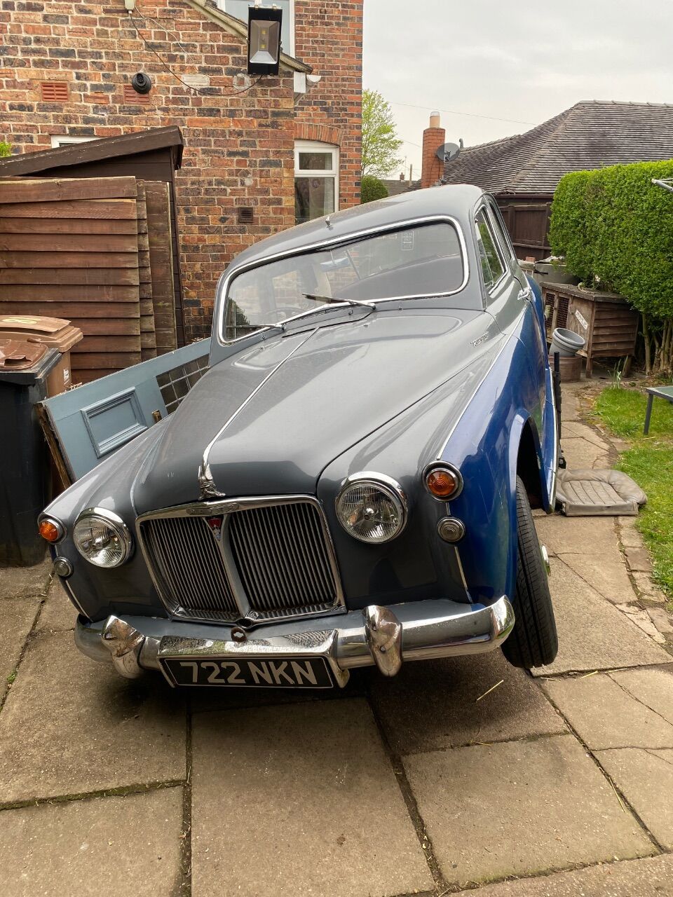

Hello everyone. I took this to work last night and it was definitely on the piss a little bit, entering roundabouts made me feel like I was going to slide out the door. A tape measure showed the OSF was approximately an inch higher than the NSF. This put me in a bit of a quandary. Do I find another spacer and reinstate it to level it up or just remove the spacer on the other side to put things on an even keel?  This P4 seemed to have suffered with work hardened front springs on the front which is a common issue apparently, this puts the nose too high in relation to the rear. The best course of action seemed to be to remove the spacer on the other side and see what happens.

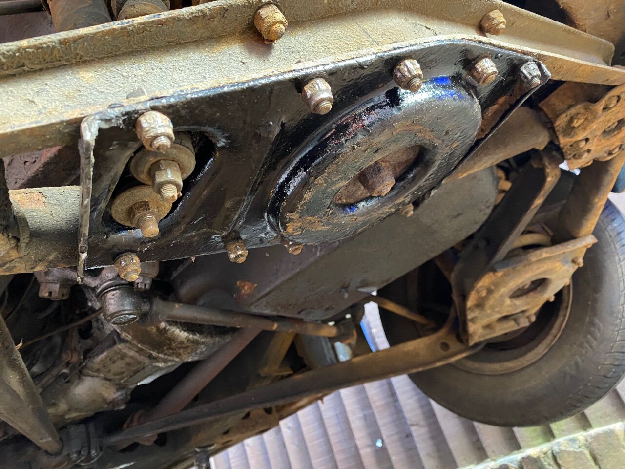

I’ve got this job down to an hour or so and the spring pan was soon out and getting cleaned up with the knot wheel. The spacer (or whatever it’s meant to be) was corroded to an almost slate like consistency. I’m not even sure they were meant to be there as the manual shows any spacers on the top of the spring not the bottom. The good news was the spring pan itself wasn’t in bad shape, along with the bump stop which looked to be fairly new .
With everything back together a test drive showed the nose was at a more acceptable angle and the Rover now seems to sit level on the road, the handling seems nicer too! Maybe the spacers were added in the dim and distant past at the same time as new rear springs to correct the ride height then? Who knows.

Springs, I think it was common to have a longer spring on the passenger side to compensate for the camber in the road. Certainly I've seen that on the Viva, rather than the other way round.

It’s sitting an inch or so too low I think although I think that’s preferable to having the nose up in the air like it was previously. The rear springs probably need replacing due to age but I think that would cost up to a grand so it’s not going to happen.
I'd love to have one of these.
I’d heard that too but apparently these are meant to have a shim on the top of the drivers spring to compensate for the driver. There were no shims present when I took the springs out though.
Over on the P4 guild FB group I’ve asked about the front suspension and I’ve been told that the corroded mess in the spring pan is the bottom of the spring mount, which is a steel dish (part 31) which is bolted via a rubber cone to the top of the lower spring mount to dampen vibrations. These often rot away though which is what the corroded mess was. The lower mounts are both intact though, albeit one is slightly nibbled by corrosion around the edge so I can only think these were spacers added by a previous owner. The front definitely sits lower than it should do by an inch or so (although it’s all now level). Maybe someone knocked something up to raise the nose up an inch back in the distant past? Who knows.

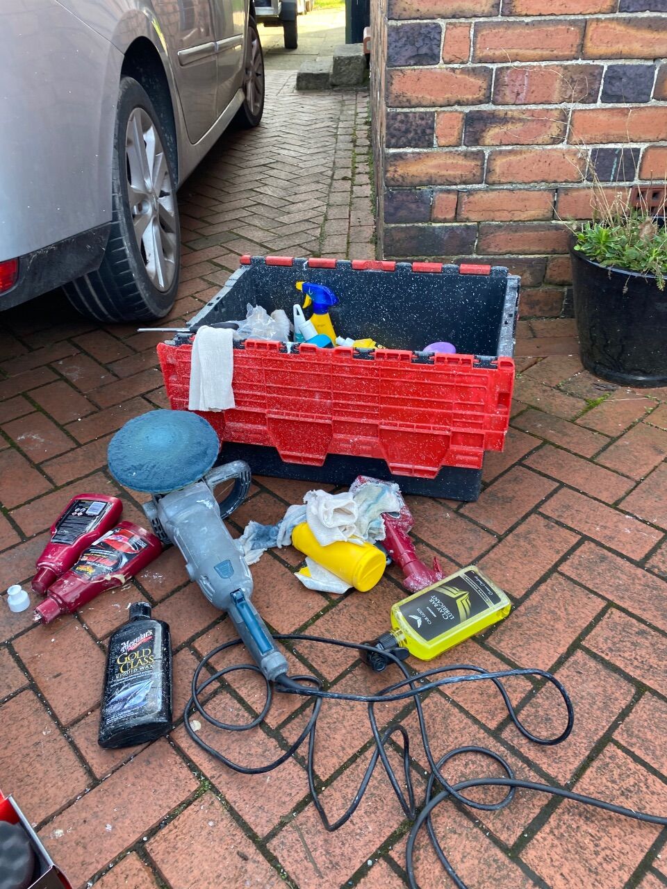

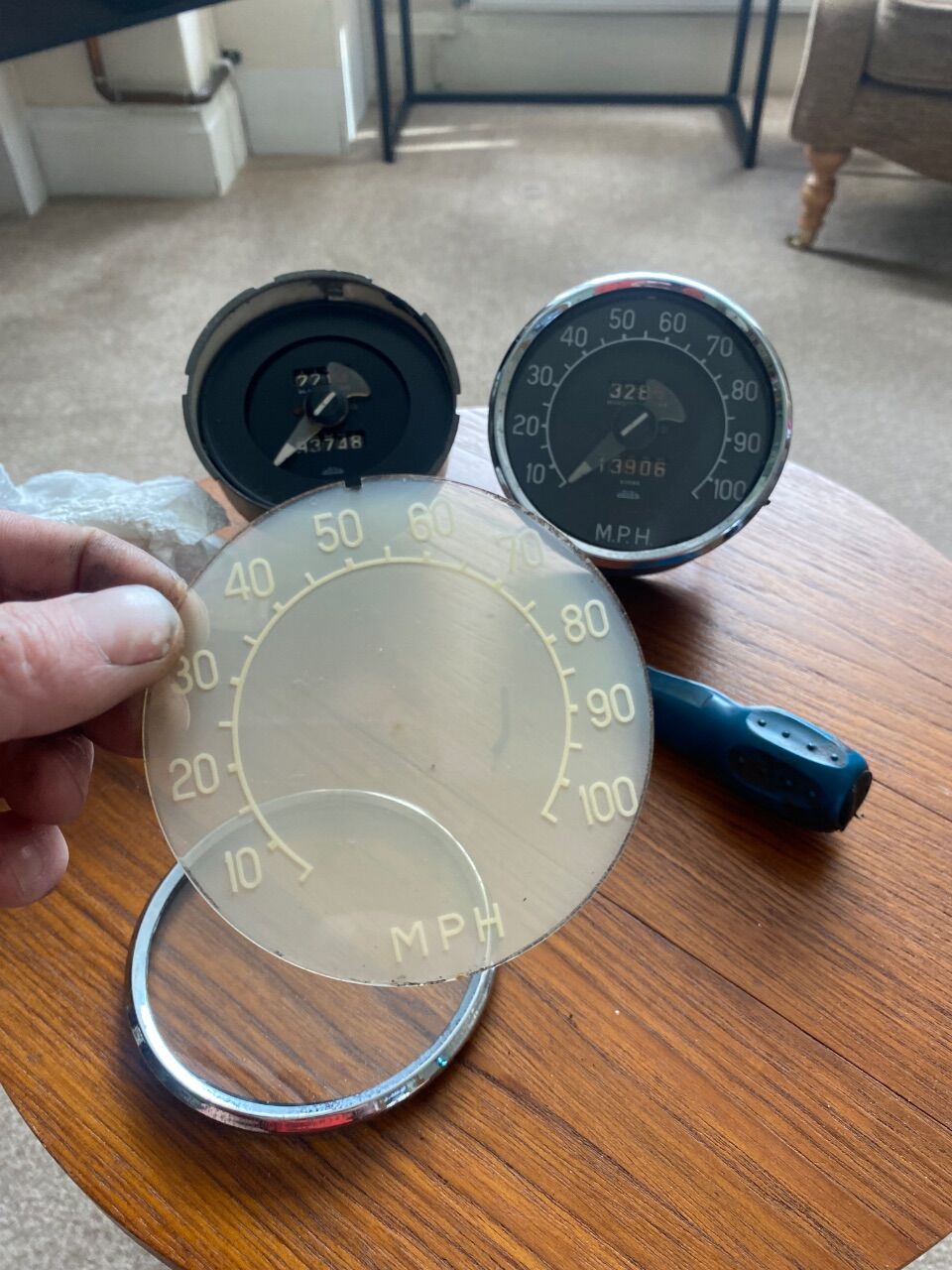

I spent most of today cutting the paint back and trying to polish it up to a reasonable finish, due to time constraints I didn’t get to do the roof but it does highlight the contrast between the tired oxidised paint and the cut and polished end result. It looks really nice…. from a few feet away. The Rover has been several different colours over the years, starting out as dark blue, then white when it was a wedding car then grey over blue, none of the paint jobs were done with much care meaning there’s white overspray on the glass, sanding marks in the doors filler in dents, wavy panels and flaking paint on some edges. It’s alright for what it is though and I can’t wait to see the rain beading off it!
Re the rear springs, I checked my parts cats yesterday and all P4 models have the same part no. spring on each side. They do vary between models, and for some you need the chassis or 'car' no. to know which one is correct. HTH

would it polish up with a headlight kit?
That's a good thought.
Or there are plenty of guys on Ebay who will supply a disc of perspex for very little ££.

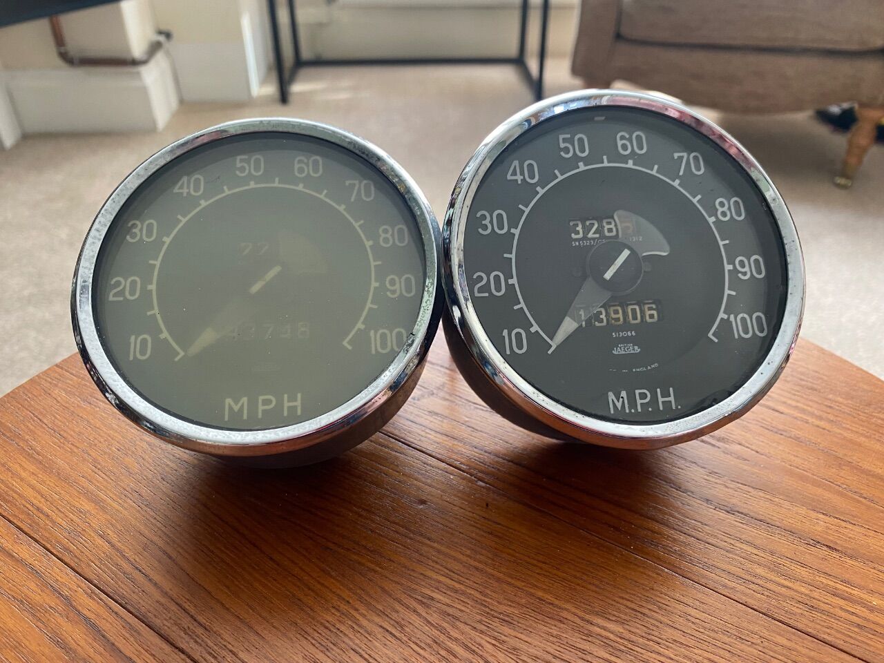

That speedo is gorgeous, in many ways 🥰
It might do but the haze doesn’t seem to be on the surface like it would be on a headlight, it’s like the Perspex has gone opaque all the way through.

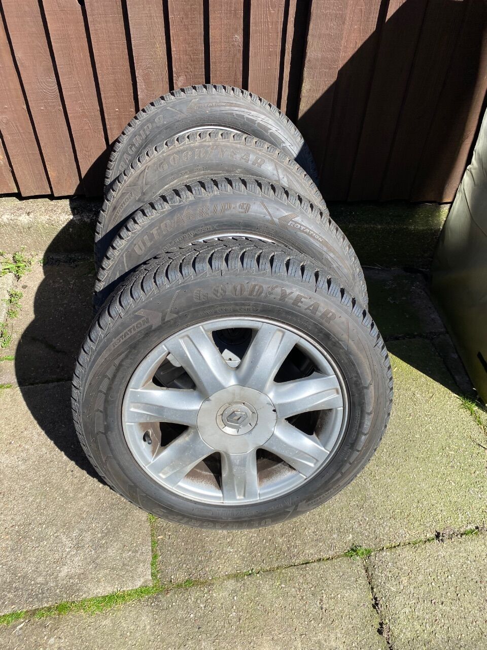

The tyres on the old ‘Goona were down to 1.6mm and needed urgent replacement. I’m thinking of moving this glorious old crock on in a few months so thought a set of used wheels would be the best bet, seeing as it’s currently sat on Juke alloys which while they fit fine just bug me a little as they’re not the proper Renault items. Tracking 5x114.3 Renault wheels down for a half decent price seems to be quite difficult until I found a set with newish tyres at a Renault breakers fairly close by on EBay. I fired off a best offer but didn’t hear anything back. In the meantime I found a set of Laguna alloys with unused tyres locally and enquired about those too, again hearing nothing back. The first guy accepted my offer so I went to collect these wheels yesterday, while I was picking those up the second guy also reappeared and a deal was done so I now have a spare set of wheels! This set of rims have all weather tyres on so might do as winter tyres, or I might clean them up and move them on. I’m not sure yet.
In the meantime I’ve got a set of Juke alloys I need to liquidate. These seem to sell individually as spares on eBay, unless anyone here fancies them?

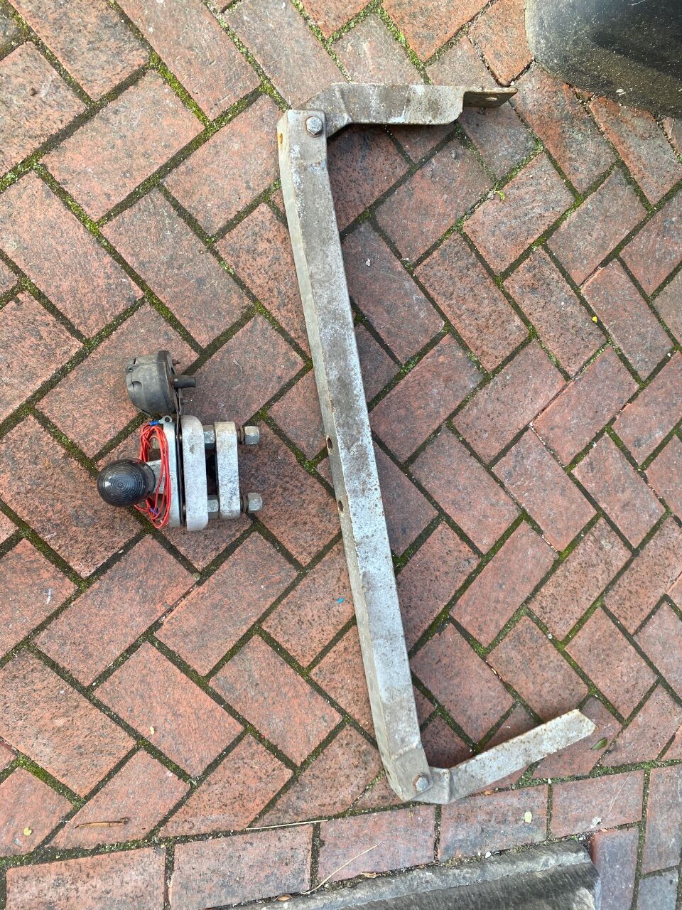

The Rover has been happily roving around and eating petrol like it’s going out of fashion. The fella across the road who has a similar 100 had a tow bar which he didn’t want but was still fitted and the other day I had a spare 30 mins to remove it. It turns out it’s not a 30 minute job and I had to be very careful not to chip his immaculate paint while I was spannering away with my head deep in his spare wheel flap. After removing the bumper first the bumper iron mounts need to be unbolted, the OS were easy to get to via a removable panel in the boot floor but the NS is behind the petrol filler pipe. I didn’t want to dismantle the pipework or remove the tank on his lovely 1962 car and was on the verge of giving up but after 3 hours or so the tow bar was off and the Rover reassembled. Phew!
Fitting it to mine was just as involved but less stressful as pulling a car to bits isn’t as nerve wracking if it’s your own. I decided to remove the filler as pipe to get access to the NS bumper mounts and found the rubber filler elbow had perished and the breather pipe had pretty much disinterested. I had noticed a distinct petrol smell when the tank was full so this was probably the source of any leaks. The bumper was soon on and a new elbow ordered from Wadhams on eBay, in a frivolous  moment I also ordered the filler pipe rubber grommet thing which cost £12 but you only live once so what the hell. Annoyingly they didn’t combine postage so I was charged £11 for a small postage bag and they haven’t replied to messages querying it. It’s my fault for not noticing at the time I guess. The main thing is I’ve now got a tow bar to play with and there’s no petrol smell anymore. Brill!
The electrics still need connecting up for the tow bar which I’ll get around to in time. I’m wondering if this P4 will be good for A framing collection missions, we will see! In the mean time there’s a small trailer full of crap for the local tip which needs dealing with.
