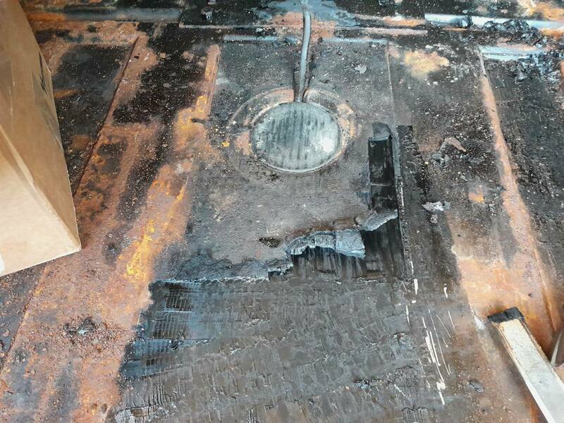

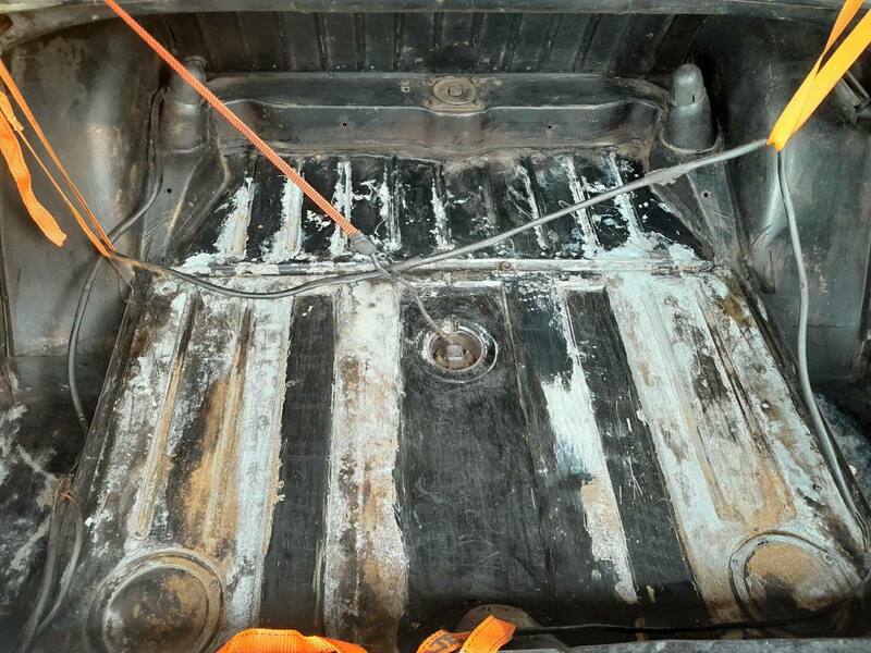

But I got to work a little on the boot floor today. This is among the most rusted parts of the car and it is probably thanks to the gasket on the boot lid being bad.
So started with this.
Started first with the fun job of removing the sound dampening mats
This was the result afterwards.
The next step was to remove the plate for the towbar
Which I'm glad I did as this was under.
The next thing was to wire wheel everything and this was the result after that
There were 4 small pin holes that appeared from this, but apart from that it is very solid in this area. The next thing is to grind down the difficult areas with the Dremel and then clean everything and then follow the instructions for what I will apply.

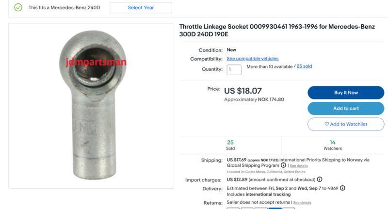

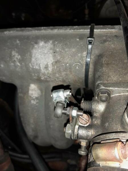

One problem that I am having a bit of trouble finding a solution to is that there are many rods on this engine and they have angel joints and they are tired. And I can't find new ones. One of these has already been changed to a plastic one but this is already bad and was the one that had fallen off.
I managed to fix this temporarily with a new ball and the hose clamp is something that others have put on.

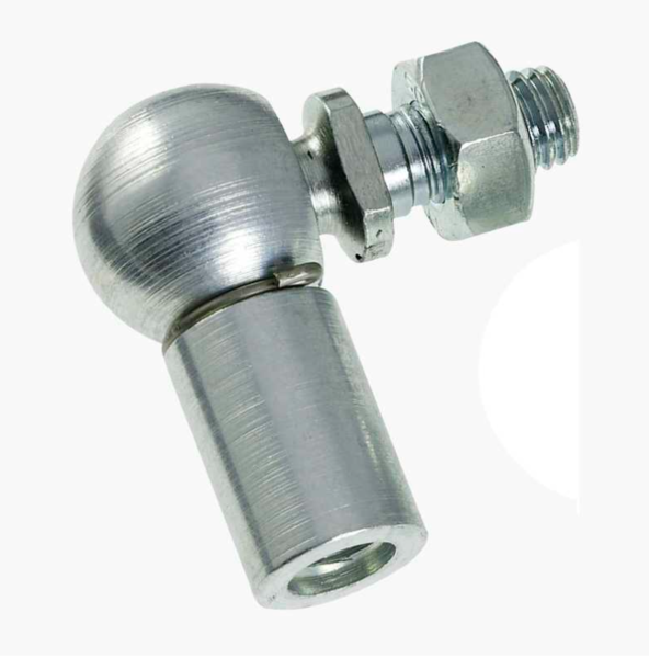

And the original angel joints looks like this.
I have tried to replace these with new universal angel joints but the problem with them is that the threaded part on the rod does not go in far enough. So it doesn't line up with the hole at the other end. A solution to this would be to cut the rods down a bit, but this is not something I want to do.
So I've been looking a lot in the last few hours but I can't find anything that I think will fit and all the universal angel joints I find are the same size and look to the ones I have which are the ones below. And both threaded parts are M5.
1711927560_Screenshot2022-08-1720_06_02.thumb.png.f160c98a74661cd8adee7bdc25ed2e3f.png
So do any of you have any ideas? Because that would be appreciated. And posts a picture below of the internal threaded part on the old and the new angel joint.
I wonder if stuff of a later mb diesel would be interchangeable to a degree? That looks very familiar to my eyes from experience owning a 1983 w123 300d. Many of the “rod” elements also had threaded bits so the length could be varied.
MB tradiationally cover their older models well so it might be a route to a solution.
It is possible that parts from newer MB could fit so that is something I will have to investigate.
And I am thinking of sending an email to several companies and a MB dealer to hear about these joints. But my hopes are not high as no one has them for sale.
Thanks for giving me this idea. I now know what to look for but hopefully at a lower price than this as I need 8 I think.
565750133_Screenshot2022-08-1720_46_57.thumb.png.9058241bd47856932c3cf07e827bbf25.png
They also come without balls, but if they are too worn, I can take the balls from the universal joints and use them, I think.
If finding that style fails, would a Rose joint do, with a bolt through, replacing the ball?
That looks a reasonably standard part.  Try a motorsport or kit car supplier - in the UK, Merlin Motorsport, Demon Tweeks,  Burton, or Car Builder Solutions.
It's possible, so I can look into that if I can't do anything else.
And I bought 2 of the original Mercedes joints from someone in Lithuania that was a little cheaper than the ones I first found, so I can check if they are the same as the ones on the car.
We use M6,  to make accelerator linkage.
But M5 female rose joints and M5 stainless threaded bar are available on ebay. You would also need 5mm bolts, plain nuts and nyloc nuts.
Original is the way to go if you can.
That's what I think too. If the ones I have found are the right ones, I just want to buy them and use them. It will be expensive but the old ones lasted 59 years so the new ones should be able to last just as long.

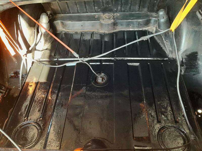

Today I treated the boot floor with POR 15 Metal Prep and this was the result.
This took much longer than what they have stated. But now it is ready for painting tomorrow.

Today was a long day working on the Mercedes. Had a lot of small spots of rust fixed in the boot area and I had the boot floor painted with Por 15 and between the coats of paint I had other things done which I post som of in a other post.
And after 3 coats of Por 15 with 4 hours between, this was the result which I am very happy with.

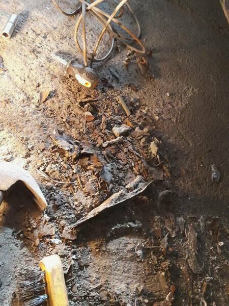

And I mustered up the courage today to examine the bottom of the passenger wing and the shelf behind which is a known rust trap on these.
And what I found was a lot of filler and a bodged rust repair.
The bottom of the archliner, which is made of steel, has rusted away and some idiot have pop riveted over a plate above both the archliner and the sill. And this was done recently as the plate was marked with the name and bar code of a Scandinavian hardware chain and I know they didn't start selling steel plates until less than 10 years ago. The back side of the plate, which was untreated steel, had also not started to rust properly yet, which was another sign that this was recent. Who does that to a car like this?
The person who did this didn't even clean the area behind the wing and all of this came out.
But the big question what kind of condition is the sill in this area and the notorious shelf?
It's not bad it could be a lot worse and it looks worse than what it is but it's pretty solid. So when the wing comes off I'm going to sand down this area and see what to do next.
And the arcliners on these are steel and pretty solid.
So after this I chose to examine the other side. Which is in fantastic original and unwelded condition.
So this is great. And one thing that was amazing all the flat head screws for the archliners came out without any problem.
So this was a productive day but I need another passenger side wing as the bottom of this one is done. So I'm looking for one of those now.
But overall I'm happy, I could have discovered far worse things on such an old and well used car.
