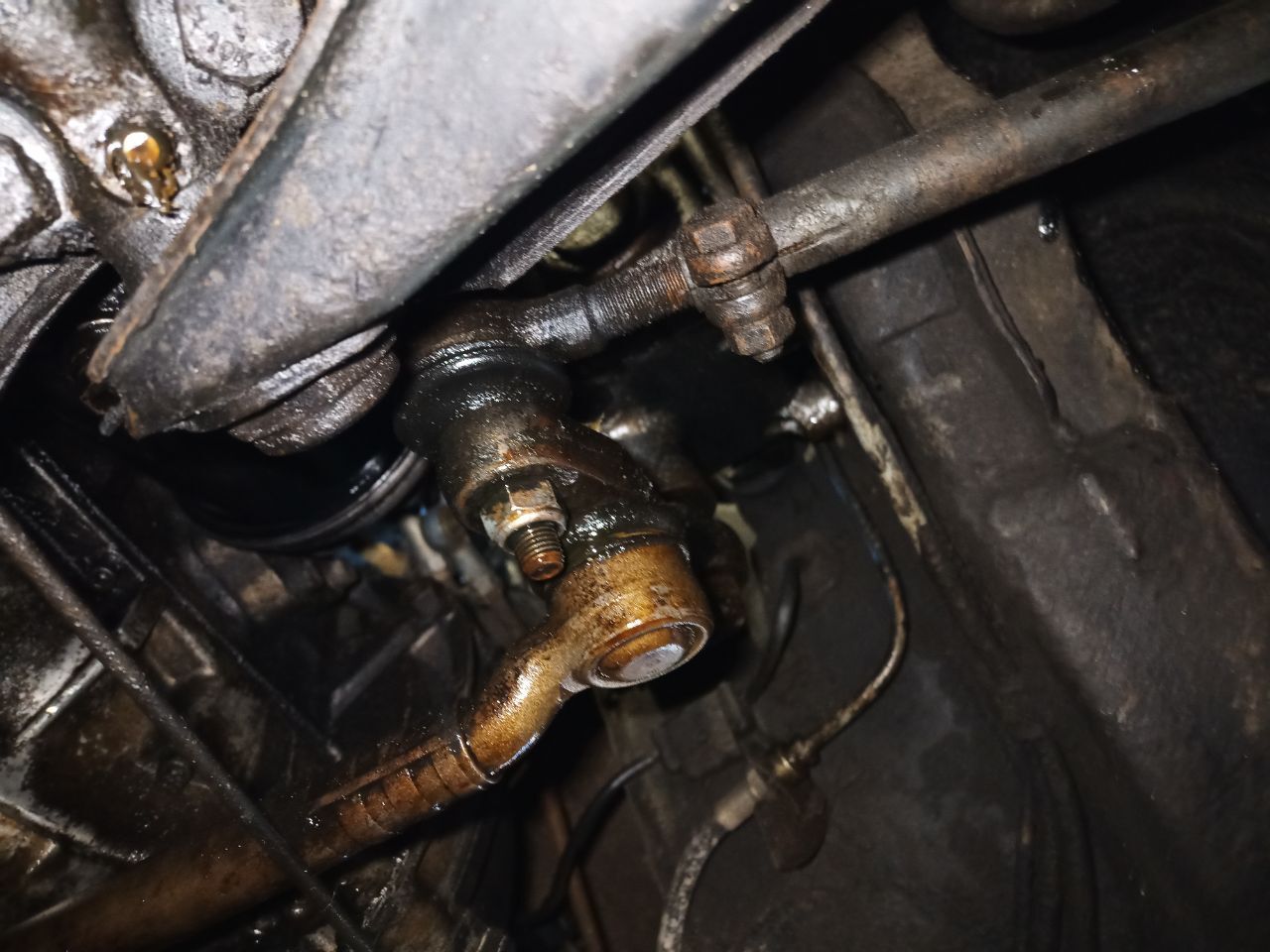

Large oil leak in front is located and it is the steering box, most of the steering components are wet with oil and dripping. New steering boxes are no longer available, so the one on the car must be taken off and new seals be installed.
Rover P4 steering boxes also develop leaks like this and mine was no exception. The P4 drivers club recommended this stuff as a replacement for the oil:
https://www.classic-spares.com/product/penrite-steering-box-lube-500ml/?gQT=1
It's a non-setting semi fluid grease that won't leak. As it was a lot easier than a box rebuild I bunged it in and never had any more problems. That was 12 years ago. I took the fill plug off a few years ago and the grease was still semi fluid so it seems to work long term.
Thanks, I will definitely try that.

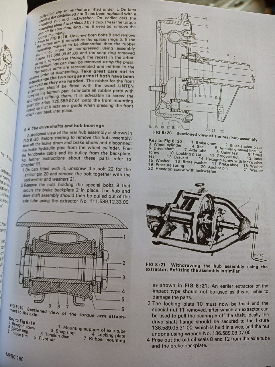

Are the rear axle seals on the Mercedes similar to my Zodiac, where you need a special puller tool to attach them from inside the axle tube with the diff removed? I overcame the problem with a sealant on the end of the halfshafts instead of just the paper gaskets which stopped the leakage of diff oil, worth a try….
  • Agree 1
I'd also check the weight of the diff- oil. Something heavier might stem this. See what the service book says and what's available. Modern oils don't sometimes suit.
Fortunately it's not that bad. The axle seals and there are 3 are accessible from the outside towards the brake.
Here are some drawings from a book I have.
Description of this and drawing of the Mercedes original extractor and this continues for one or two more pages.

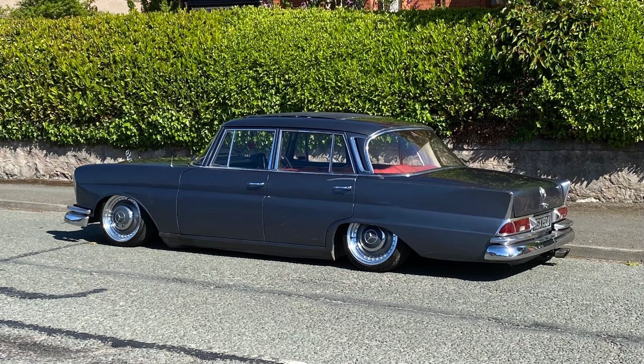

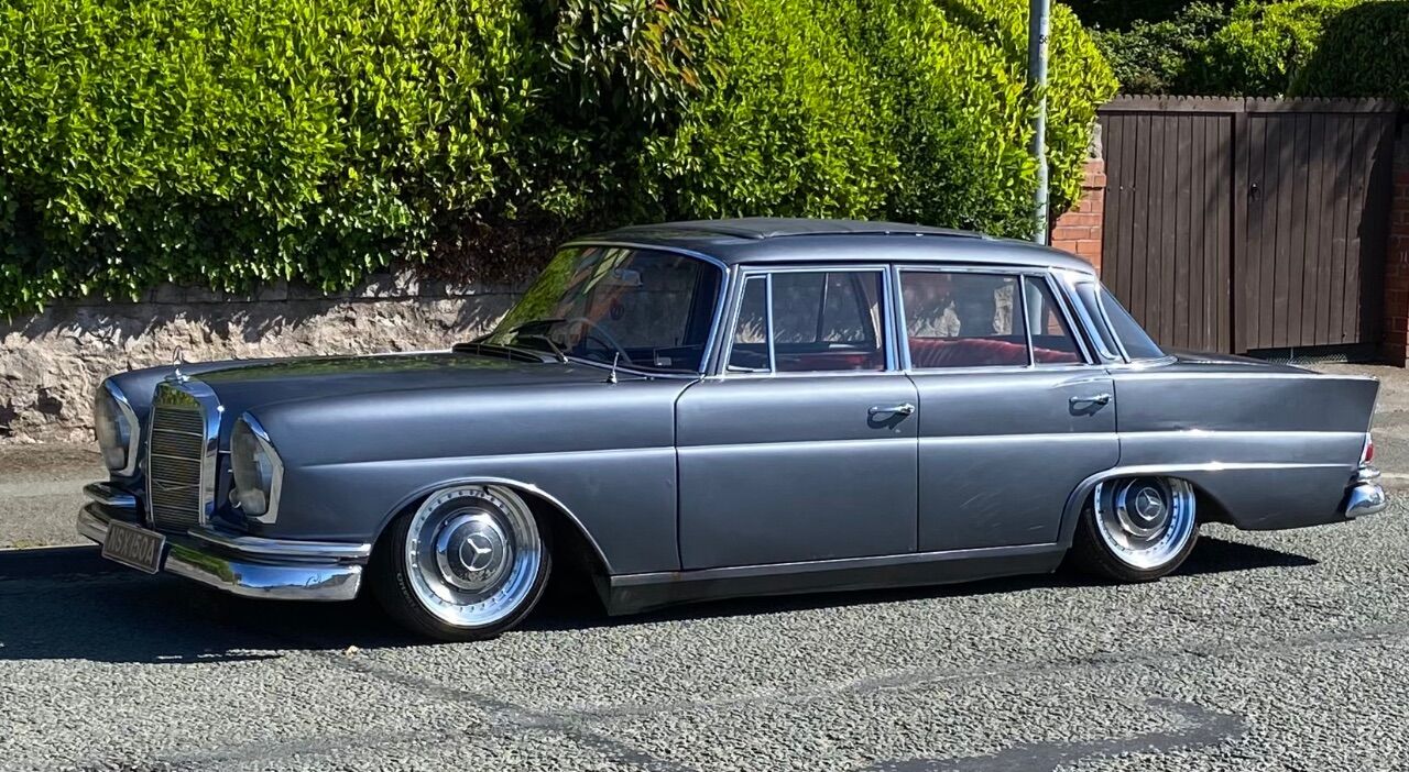

Saw this out today and thought of this thread IMG_6564.jpeg.5e8c6e80ad1394635bd27d92eec7af69.jpeg
don’t know my mercy so no idea how similar it is to yours! They’d done a lot of work on it, not sure the stanced look suits it, but I’d drive it!!
This is a W111 so it is almost the same car as my W110 only the W111 has a longer front end to fit the 6 cylinder engine and different headlights.
But can't say I like the modifications they've done to it would have been much nicer if kept original.
