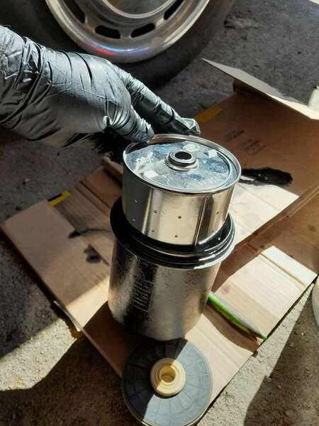

During the oil change on the engine last autumn, the pre-filter, which is before the oil filter, was quite clogged with goo, so since it has now done 100km and a lot of idling since the last oil and filter change, I did carry out a short oil / filter change now.
And I'm glad I did, the oil was very black as expected but the oil pre-filter really showed it was a good thing I did this now. I cleaned this completely in the autumn and then you could see through it, something that was no longer possible now.
And I really struggled to get this cleaned this time, next time I'll have to buy an ultra sonic cleaner if I can afford it as it's the only thing I can think of that can work as this filter is in 2 layers and is almost impossible to get cleaned in the middle.
So this was the best I could do.
The next thing was a cleaning of the oil filter housing and then a new oil filter.
Then this was  put back on the engine. And this oil filter is the most terrible oil filter I've had to change so far, it's under / behind the diesel pump in a very inaccessible place and it's a challenge not to lose the pre-filter.
The angle of the filter and the challenge of getting it in and in place mean that it is not possible to fill it with oil either, which I don't like, as it takes a few seconds before it is filled with oil and then the is engine runnig dry, but what can a do.
I'm going to do another short oil change and filter, don't know when, but hope it can take a little longer than 100 km.

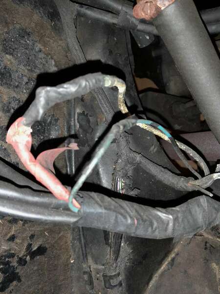

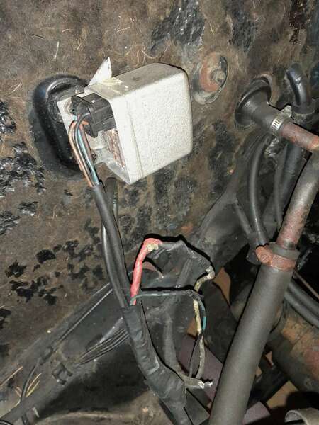

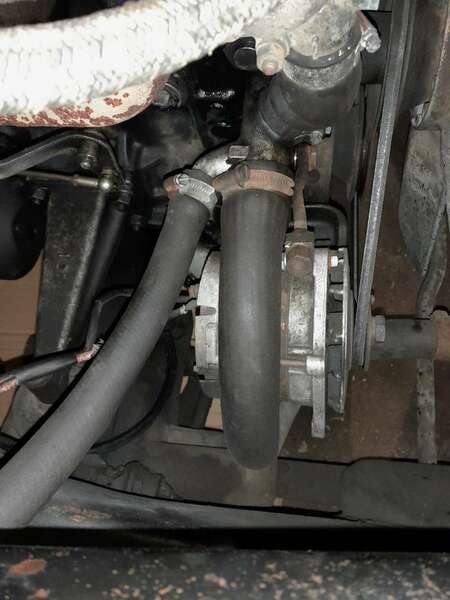

Today I also had a look at the battery problems I have now. And after the drive the battery was flat so I checked and the alternator produces over 14 volts but none of it gets to the battery. So need a little help here, what I'm thinking is that either the charging relay is faulty or there are some problems with the wiring? The charging worked in the autumn.
Alternator
This is what I believe is the charge relay. But some of the wires in the area don't look quite healthy and there are some cut wires too.
So where do you guys think I should start troubleshooting this? Or should I just replace the relay? As this is the first time I have had such a problem.
And I can add that I'm bad at wiring diagrams.
 When you drove it, the lights and electrical systems were presumably functioning?  Try to work methodically i.e. one task at a time, then check for an improvement before attacking the next task. Avoid pulling or waggling ancient wiring but I'd first of all make sure that all connections are good, including the battery terminals.  If it all looks ok after cleaning connections which looked corroded or tightened and cleaned any that were loose, maybe look at those bundled/taped wiring lumps to ensure they are still making good contact.  Also check the starter motor connections and earth cables between engine and body.  Check that the battery can hold a charge by charging it overnight and then trying to start the car. Only then would I look at replacing the relay.  Others with more experience of electrics may advise a better approach - but that's how I chase down problems with my old cars.
Where are you measuring the output voltage?
With engine running at 2000 rpm, and lights and heater fan on, measure between the battery terminals.  A good reading is between about 13.5 and 15 volts.
Higher than 15volts, possibly a bad regulator,  Lower than 13 volts, possibly a bad battery.
I would suspect the battery first.
On the drive, I didn't use anything other than turn signals and I think they worked, and since this is an old diesel, it doesn't need electricity when started and running.
I measured directly on the alternator and there I got over 14 volts, on the battery I then had 12.7 volts. It's possible I've measured something wrong, but this is always how I've measured it and it's worked. And I have always before received charging voltage on the battery during my measurements and that at idle.
12.7V is a bit low at the battery with the engine running.  14-15V would be the typical voltage to expect.  It's worth checking that the battery terminals are free of corrosion.  If the terminals are a bit crusty, they may not be able to transmit the required starting current and all you will get is a slight click when operating the starter.
