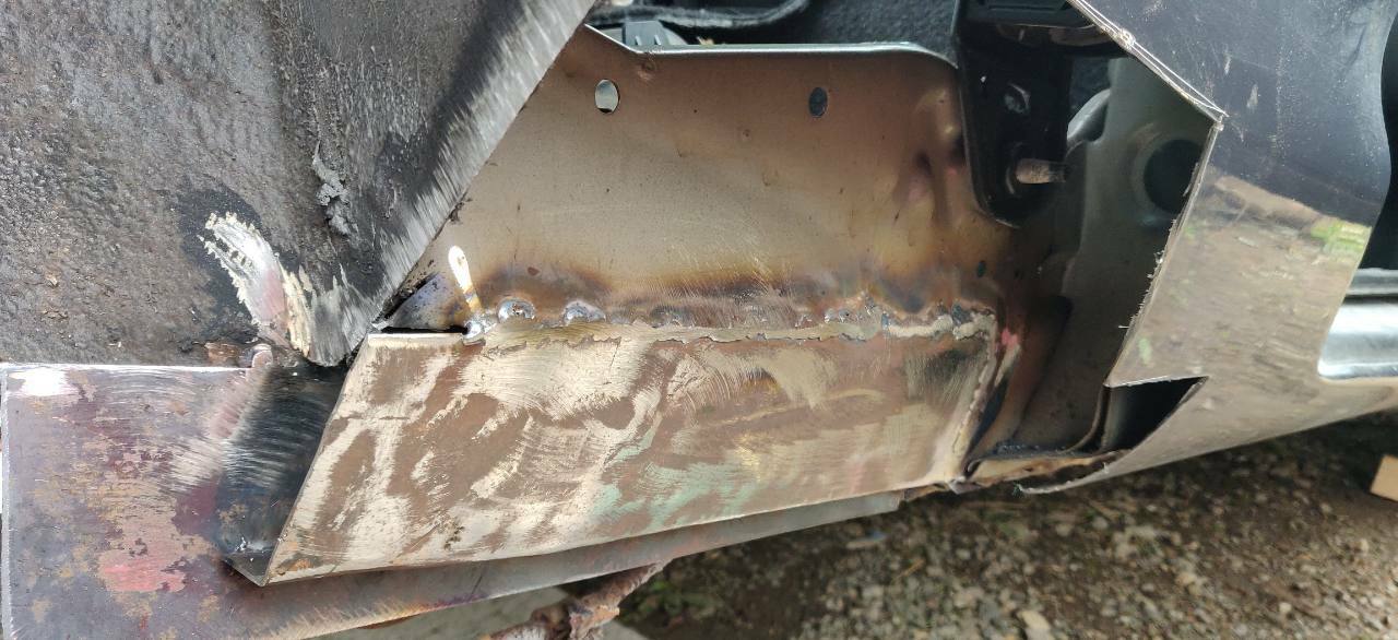

After yesterday's monsoon conditions here in North Wales today dawned bright and sunny so it was time to put my big boy pants on and start cutting holes in the Puma.
As feared the rot had got through the outer skin and into the box section underneath so all that had to be cut away too.
Llifon could then start welding metal back in.
Then a new box section in front.
Ready to be skinned once I've got some primer and cavity wax in there.
A more robust poke of the near side has revealed it to be in a similar state so that'll be getting the same treatment while we're at it.
We're falling into a good rhythm of work with me cutting and grinding and Llifon making templates and welding. Don't think we'll be able to get it all done by the time the MOT is due on 4th November but I am feeling confident we'll get it done eventually.
