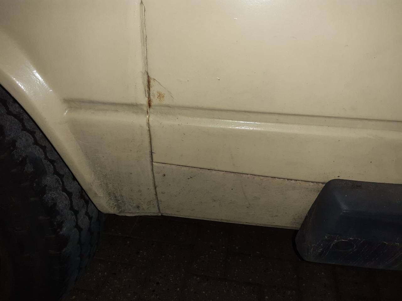

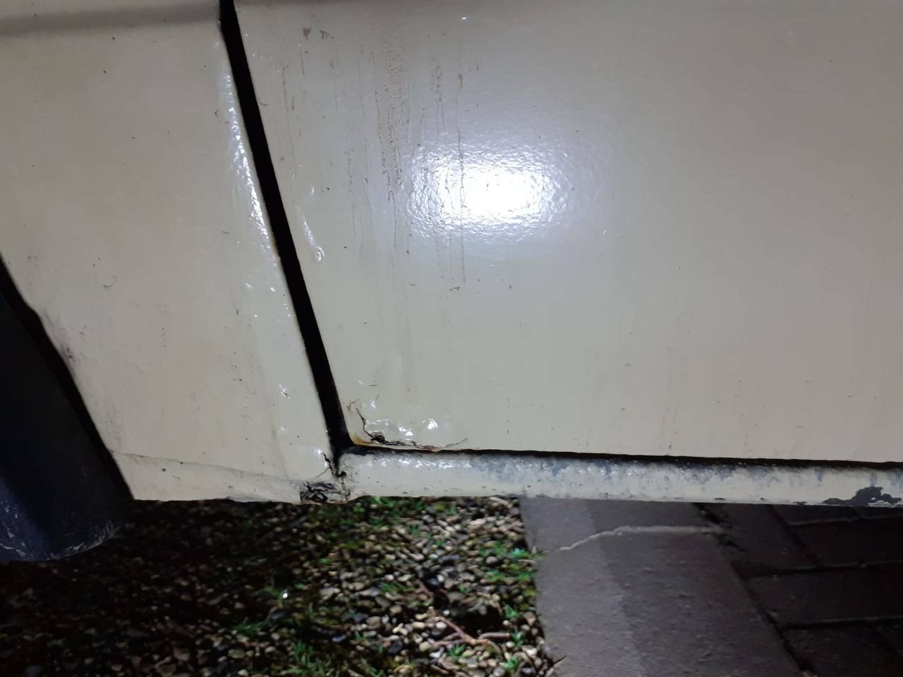

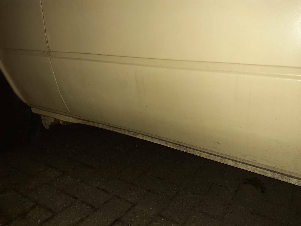

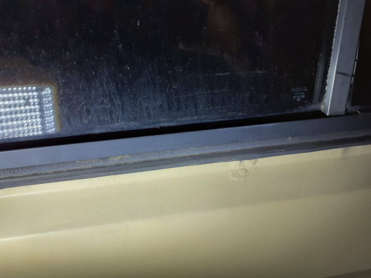

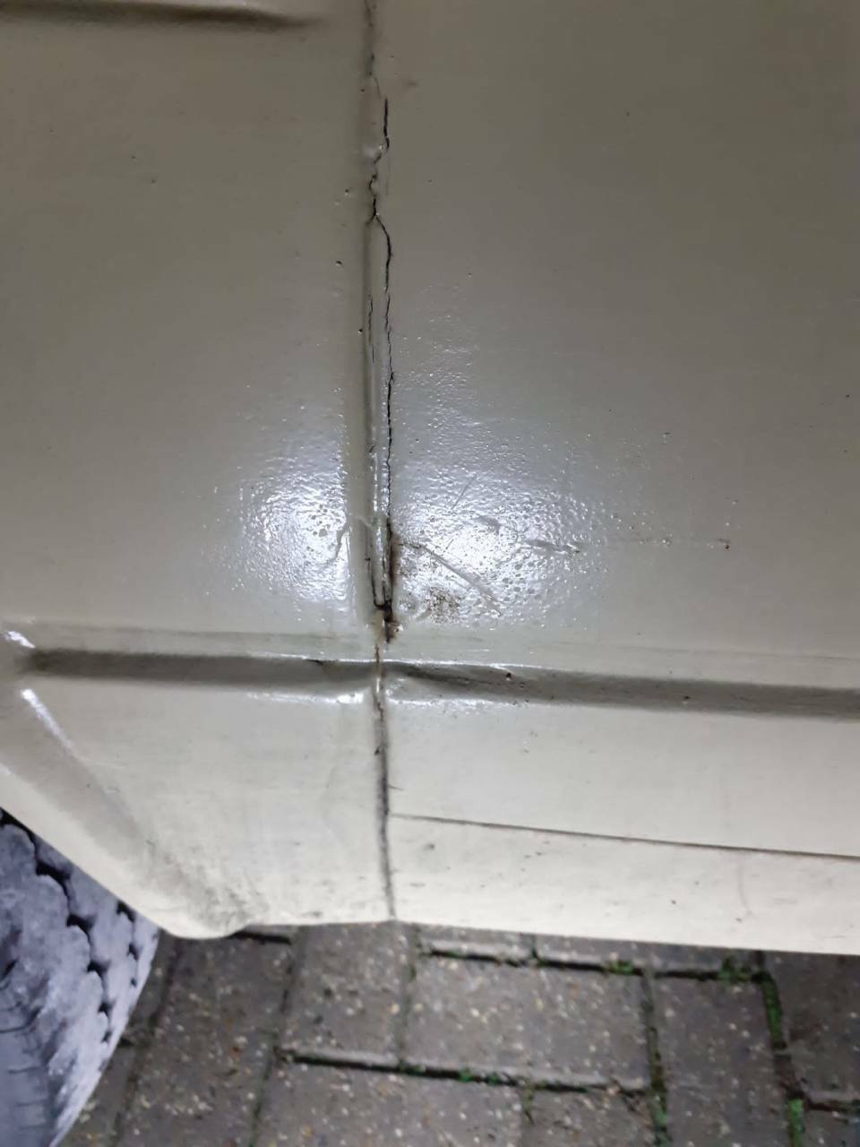

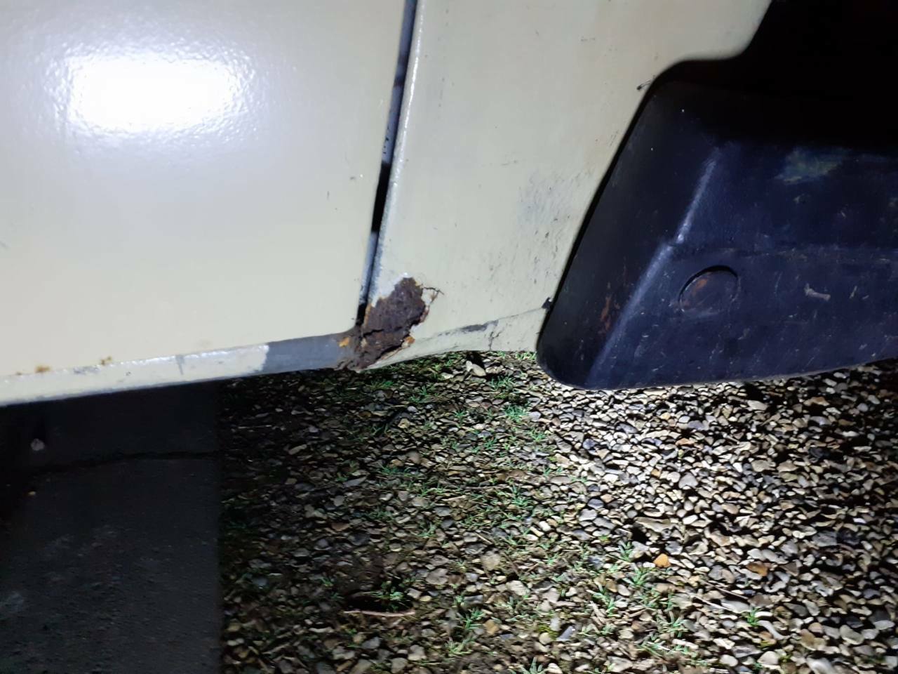

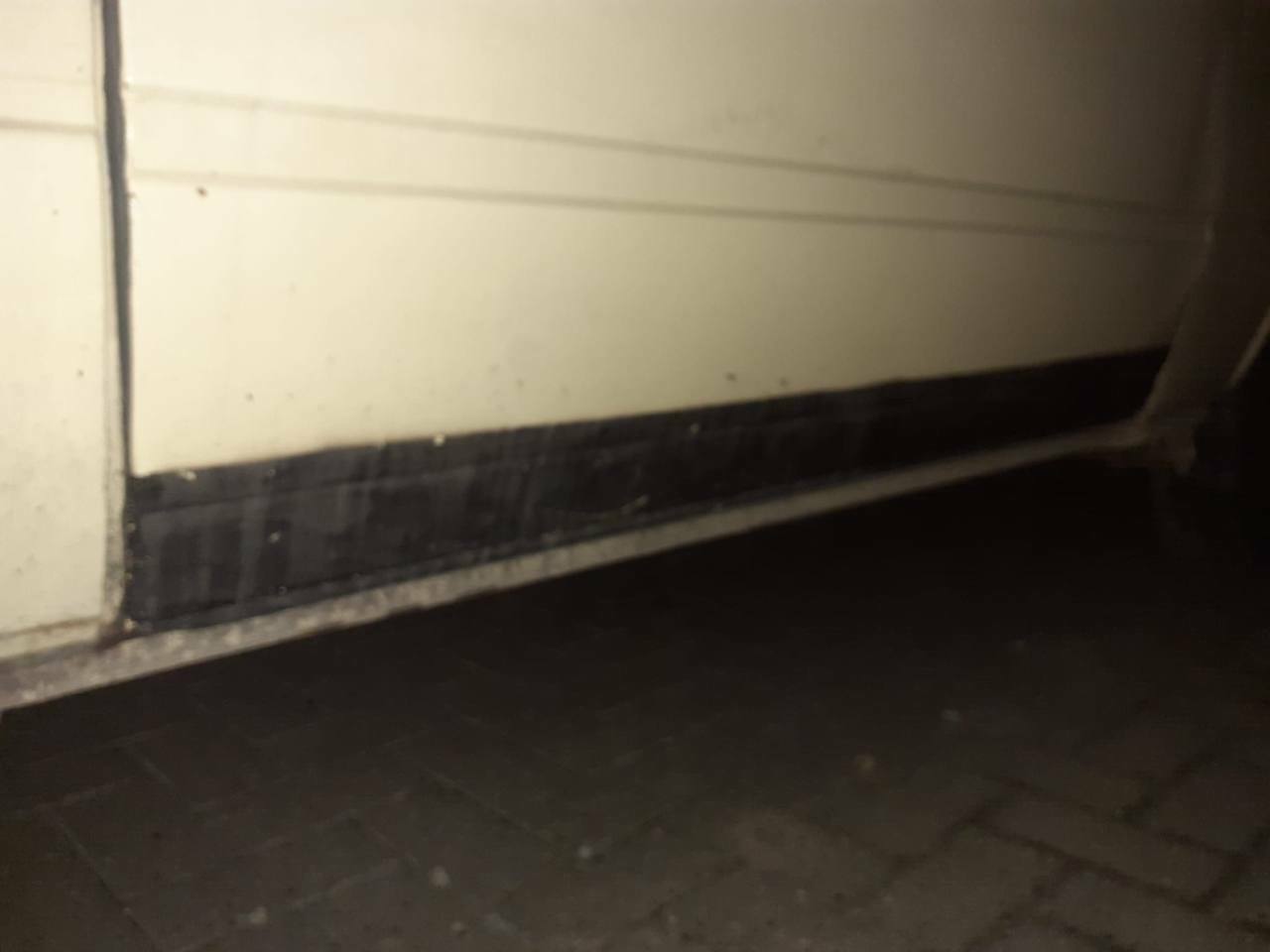

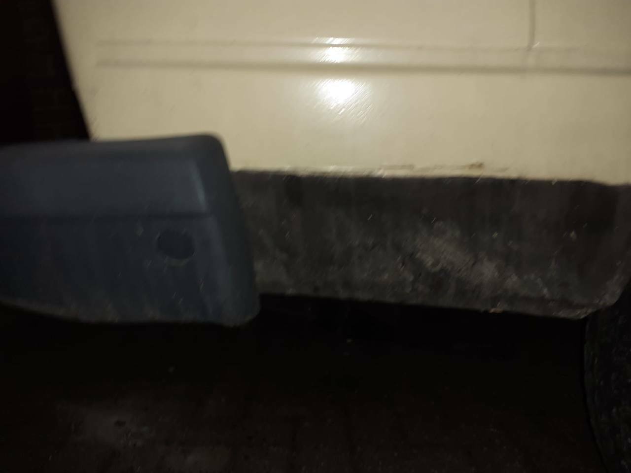

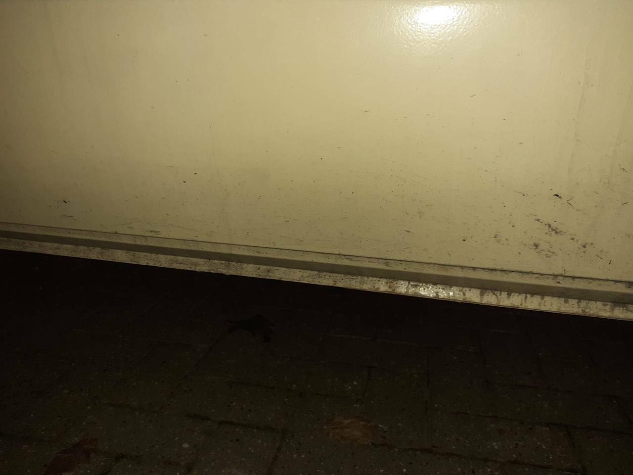

cobblers Posted March 19, 2022 Posted March 19, 2022 From the pictures, that front crash bar (birdbath) behind the bumper looks sore as fuck. It's a huge undertaking to do a nice repair on that. The rusty marks on the seat bases don't do it any favours either, as they show rot from the inner wheel arches. Seams don't look particularly bad but that flat paint hides sins. Get him to send you photos of the front steps, sliding door runner, rear outer trailing arm mounts, bottom lip of the tailgate (from the inside) and close up pictures of all the seams. That'll pretty much tell you the state of it. Fabergé Greggs and Matty 2
cobblers Posted March 19, 2022 Posted March 19, 2022 Oh and the roof, I'd need to see a picture of WTF is going on with that before paying any more than breaking money for it (which is about £1500 for the easy sellable bits if they're any good) If it's horrific you could put a poptop or a high roof back on, I suppose Fabergé Greggs 1
Fabergé Greggs Posted March 19, 2022 Author Posted March 19, 2022 VIDEO-2022-03-19-15-13-43.mp4 VIDEO-2022-03-19-15-13-44.mp4 That's all she wrote. He says that the engine conversion cost him 3k from https://www.dasauto.uk/ and the welding in 2016 cost 2k from https://www.weldwagen.co.uk/ including the sills apparently. He says the worst is the front steps and around the rear windows. Thanks for the expert eye @cobblers, appreciated! Matty 1
cobblers Posted March 19, 2022 Posted March 19, 2022 That's not great, but nowhere near as hanging as the vans plenty of people are driving around with gay abandon. The engine/box is probably the best bit, but as with any conversion it will cause confusion/grief now and again. It will need welding and tarting up every year, but they don't snap in half. As far as vans of this age go, these are well supported and drive well. What do you want it for? If you just want a camper, get a cheap Vivaro or something like that. If you want an old interesting van then it is one of those. Matty and Fabergé Greggs 2

artdjones Posted March 19, 2022 Posted March 19, 2022 I've seen a lot worse, but to get it good you'll have to have a few hundreds worth of welding/ bodywork each year. And buy a new 5 litre tin of Rustoleum. cobblers 1

Fabergé Greggs Posted March 20, 2022 Author Posted March 20, 2022 Hmm went for £3200.. what do our resident experts think @cobblers/ @artdjones ?
cobblers Posted March 20, 2022 Posted March 20, 2022 That's about its money I reckon, if its not hiding horrors. Prices have roughly doubled in the last 6 years I'd say, can't see it continuing for ever though Fabergé Greggs 1
artdjones Posted March 20, 2022 Posted March 20, 2022 I'm not an expert on them, but I've had a bit to do with a couple. I'd say reasonable. I'd want to have a good look underneath and at all the body seams before parting with the cash. The pictures give a solid enough feel, and at least it's not covered in dubber stickers, or even worse, eccentric hippy mods. cobblers and Fabergé Greggs 2
