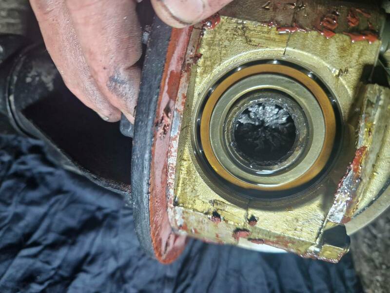

Pretty much certain I've snapped a half shaft, which they are known for in fairness. In a way im suprised it hasnt happened before given this has a bit more poke than standard and i do tend to drive it hard.
got a pal coming with a trailer. Can't face another 5 hour RAC experience ðŸ˜„

Spridget racers are always snapping their half shafts. If you can get the other end out (magnet on stick), they're changeable by the road/trackside 😀
Wheel off, drum off, couple of screws and it'll withdraw. Jack it up on that side only if you don't want to loose all your diff oil.

Already had drivers side out this morning. All OK. Other side is up against garage wall. I'll do it Tuesday night after work. Its youngests 10th birthday tomorow so can't do it then. I've stuff on this aft so it can sit and sulk a bit longer ðŸ˜„
If you ever do need to remove them, remember the twisting action on them makes them handed. I.e. once used on the left then it needs to stay on the left if you don't want it to break again.

Luckily an a fettler with an eye for detail has been before me. The drivers side had it written on the shaft in red pen. ðŸ˜„
Swiftly progressing to prop dropped and diff out. The magnet on a stick was going to work this time @SiC ðŸ˜„
20230919_203044.thumb.jpg.031430b58fdc527267145ebcbe9b4381.jpg20230919_201133.thumb.jpg.4a04c103d000fdc652df4a2839a4b2c5.jpg
Thank fuck I did. Diff can come into work for a proper blow, clean out and a turn through the parts wash. New half shaft, half shaft gaskets and diff gasket will get ordered tomorow. Then we ride again!
20230919_203248.thumb.jpg.d1a4b917e745ecea803d2b13caa16426.jpg20230919_203711.thumb.jpg.467b7dfbf32bf7cbecec3a8a09a7e6f8.jpg
While I'm here, what's the recommend on gear oil for the diff? Just incase someone knows of something more modern in makeup but still with the properties needed for this age of equipment.

  On 19/09/2023 at 20:32, SiC said:
iirc it must only be GL-4, not GL-5 in the diff
Expand
Can't be more than a litre in an a40 diff surely?
Expand
Leyland Moggy Manual says EP90 GL-4. 80w90 is also suitable if straight 90 isn't available.
