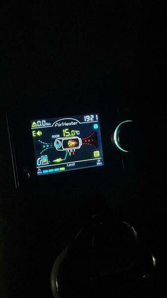

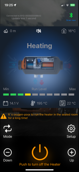

JJ0063 Posted December 15, 2023 Author Posted December 15, 2023 Took nearly 6 hours of me fucking about mounting the heater under the van, running fuel lines, mounting a fuel filter, running the exhaust out the side, drilling the cab step for fresh air inlet, drilling the rear floor for the heating ducting, wiring it in and mounting the control panel but it works! Diesel heater plumbed into the main fuel tank, it’s a Chinese one but it’s the dogs bollocks of them, it’s got the control panel, a remote and also can be app controlled (see screenshot) but is also the only Chinese one available with auto on/off. One of the chaps on the CDH Facebook group has had his set to something like 19c for about 3 months - they regulate the temp and automatically click back on if it drops by 2c. Should mean we never wake up to a cold van but also don’t cook!…. If it works Dick Cheeseburger, GrumpiusMaximus, Dave_Q and 7 others 10
