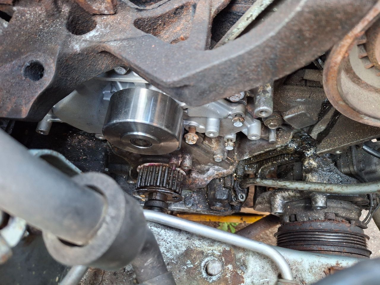

Update, I managed about 7 days commuting in the Rover and really enjoyed it before I managed to fix my Subaru get back to normality. On one occasion the 827 did get a bit hot and bothered, so before using/abusing it any further, I thought I best investigate.

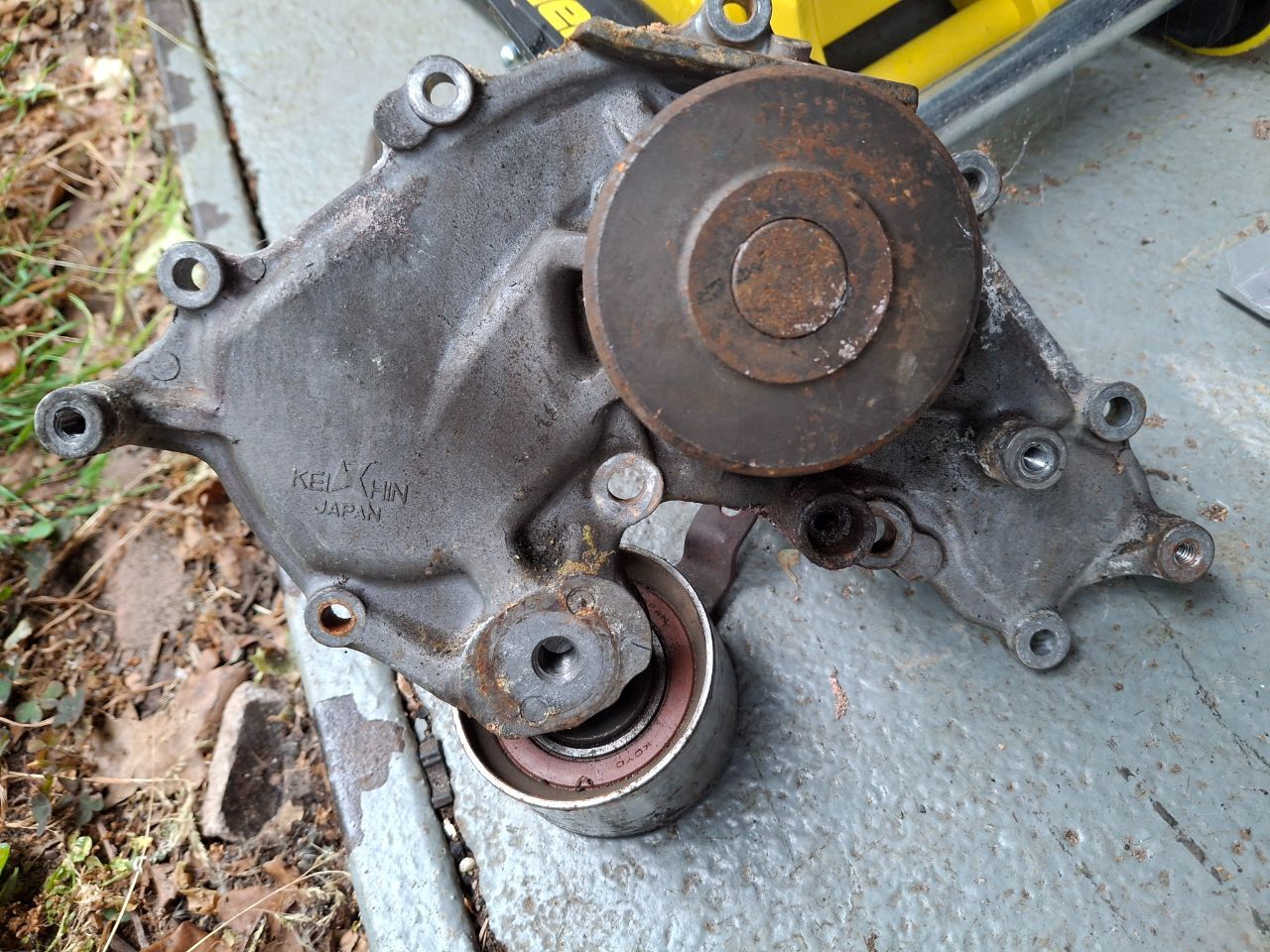

To figure out what was going on I dug out  In my Fisher Price radiator pressure test kit... I found the right connector, fitted it to the coolant reservoir,  pumped it up and waited and then eventually spotted a gentle trickle from the water pump, bugger! So that's a cambelt off job then....

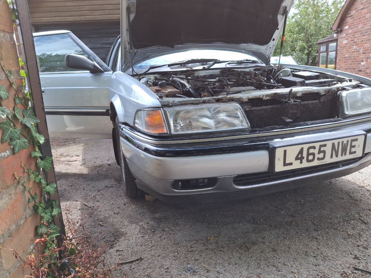

A couple of years ago I actually bought a cambelt and water pump for the car but never got around to fitting it so now would be a good time. I stripped the drive belts off and removed the alternator and free'ed off the PAS pump. Spent forever removing the upper cambelt covers and drivers side engine mount. I then pulled the starter motor to secure the flywheel so I could get the crank pulley off. The Haynes manual suggests that you can use a large screw driver to secure the flywheel, not a fucking chance that will work! I actually bought a cheap universal flywheel holding tool and adapted to the Rover to do that job, which worked.  Finally I could see the  belt and the obviously leaking water pump.
First discovery, I had failed to buy a new idler pulley and the water pump was wrong,  no chance sending that back over a year later! After much faffing on line I found Autodoc (Deutschland) had the water pump in stock and I found the pulley for sale in Chatsworth...... Chatsworth California that is! Rover 827 bits really can be hard to find. The pulley and pump  arrived late this week, so I got back on it....
Managed to confirm TDC buying putting a long screw driver down one of the spark plug holes, which happily matched the markings on the cams and pulley. Took a brave pill and released the tensioner and removed the cambelt.
Old water pump off, it was definitely leaking..
New one on...

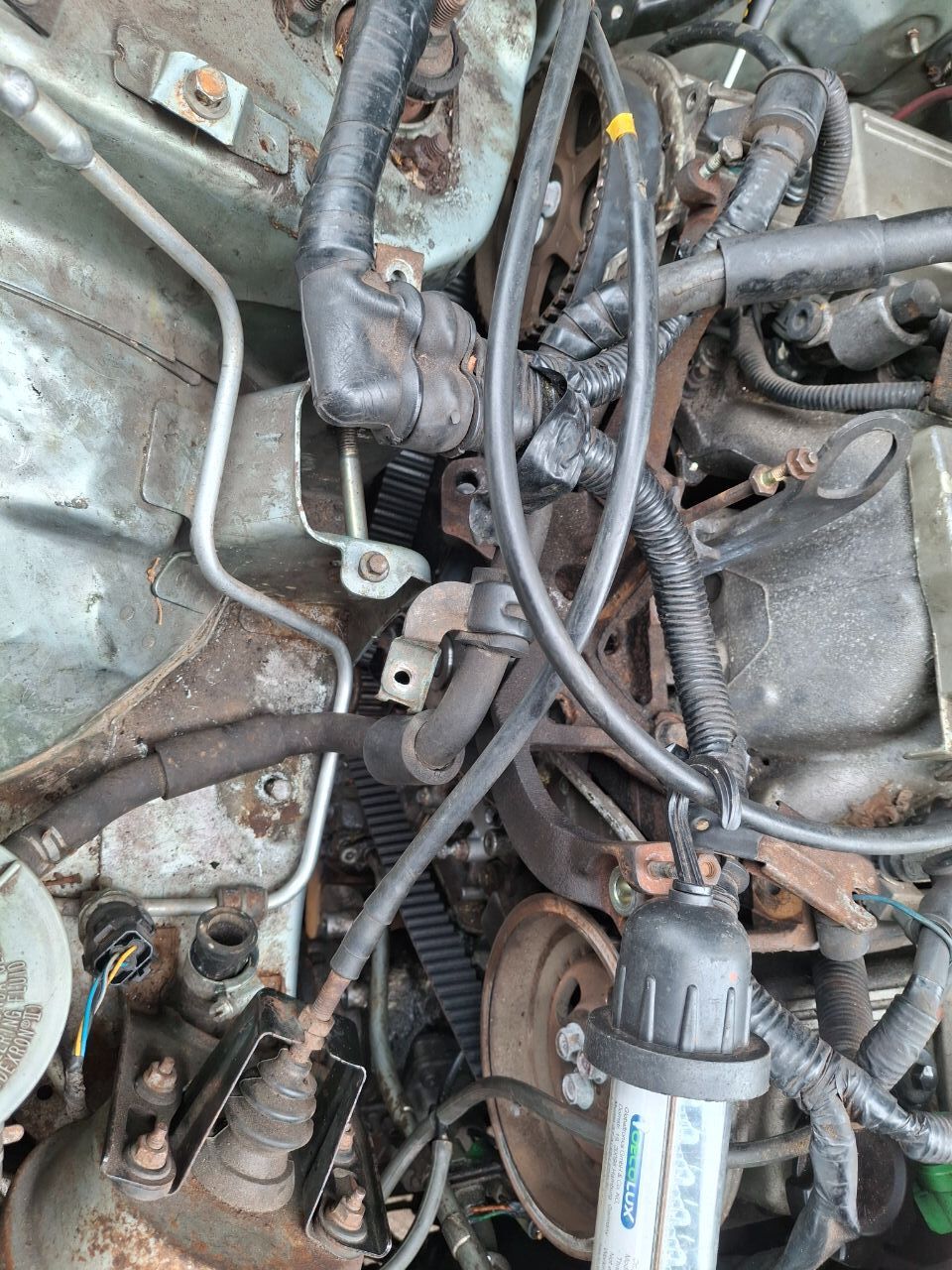

Next the bit I dont like, re fitting the pulley and belt....
The rubber band is going on slowly....
Not a brilliant picture but thats the view I get, love working on transverse engines that are butted up to the front wing.......
Having a really fun time getting everything lined up properly, I did notice that when I got the belt tight over the bottom pulley it was moving the front camshaft forward a tooth! I then tried to work with this and wind the cam shaft back the opposite way so when you took up the slack it would move back to TDC but the valve springs kept popping the cam back to into position and no I don't have any cam locking tools.....
More later......

Slight update on earlier, I have the belt on and it appears to be timed up!
I initially tried to follow the Haynes manual. But the order of putting the belt on  the various pulleys just didn't work and worse still kept moving the front camshaft.  So I went on Youtube and watched a bloke in Ohio fit a belt to a 1988 Honda Leg-end 2.7 and copied the order he used. Low and behold the belt was on properly. I whizzed it around a few times and re checked all the markings and my top dead centre finding screw driver and all was good!
After watching bits of the Grand Prix I went back out and started buttoning up the belt covers, what an utter pain in the arse they are. To finish off todays activities I have loosely fitted the power steering pump and alternator fitted some of the auxiliary belts and re fitted the crank pulley.

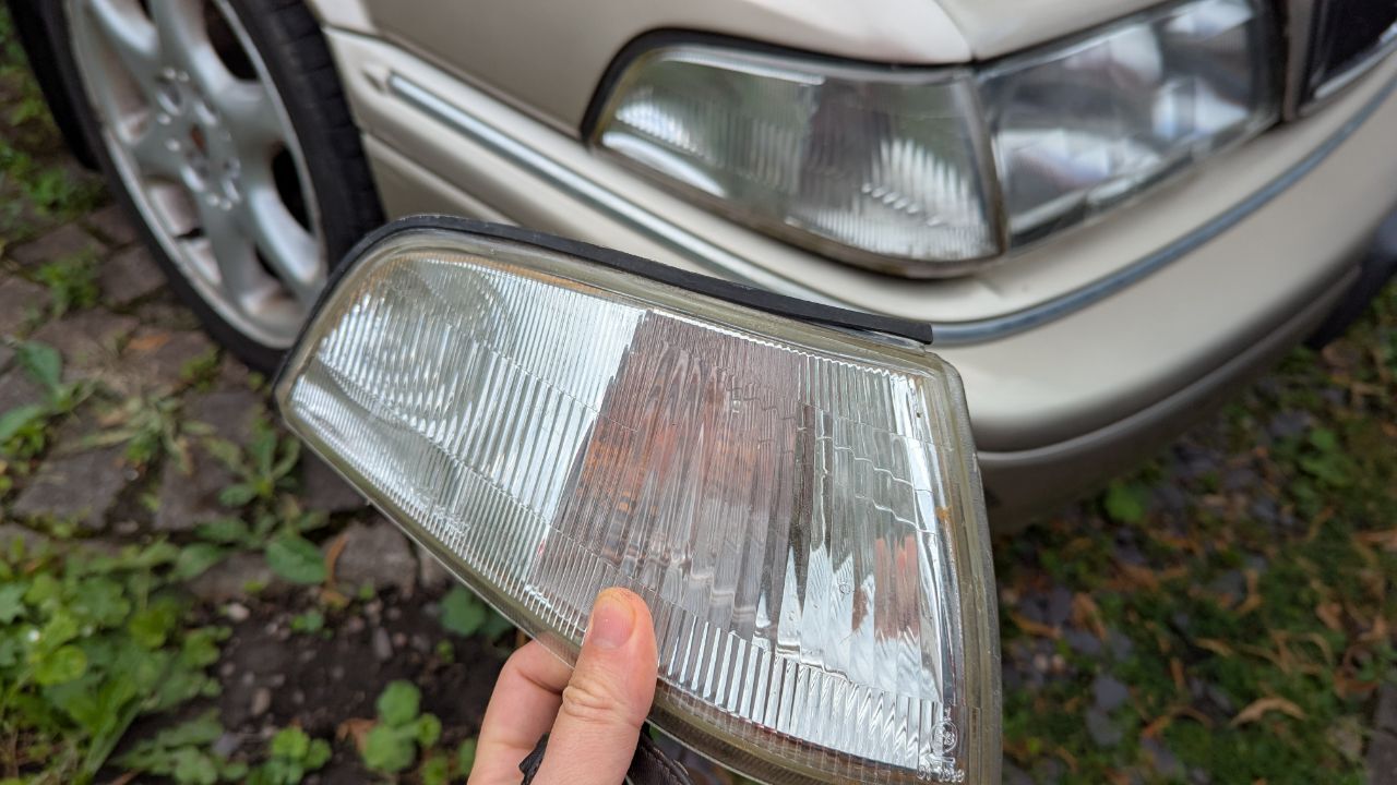

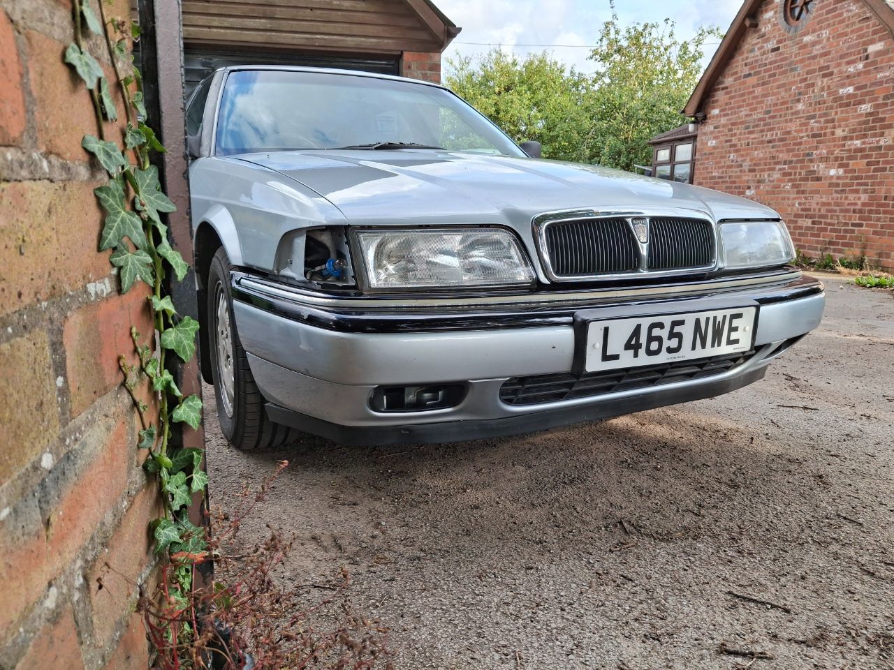

Then on a dead straight flat bit of road travelling it about 50 in traffic, the driver's front indicator lamp decided it had just had enough of life and existing as a lamp, departed company from the front of the wing and smashed itself to pieces on the road!
So no prizes for guessing what I am currently shopping for............

That's some good going. It's normally only the outer lens that falls off! 😀

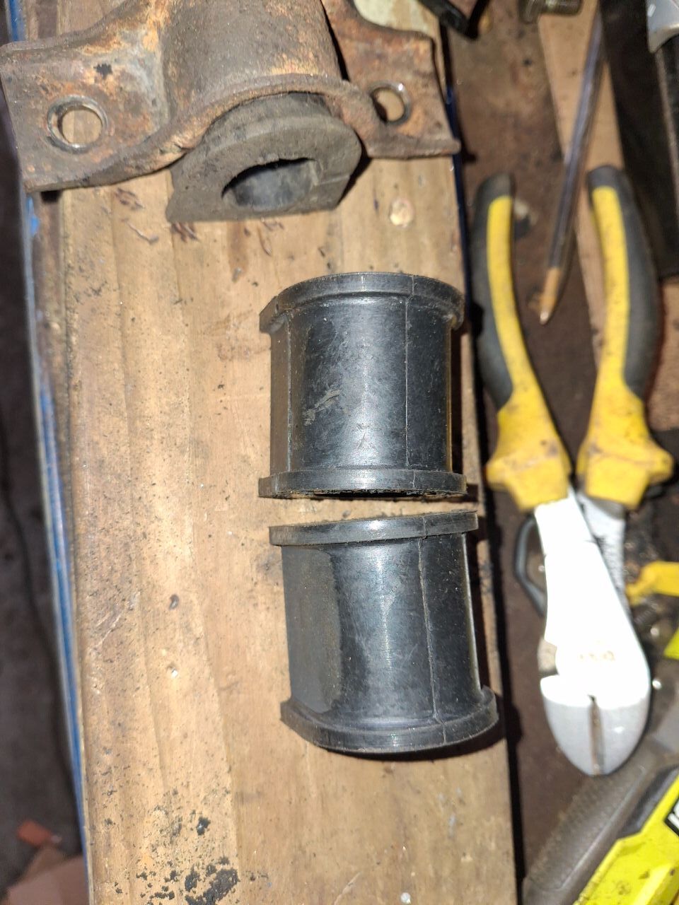

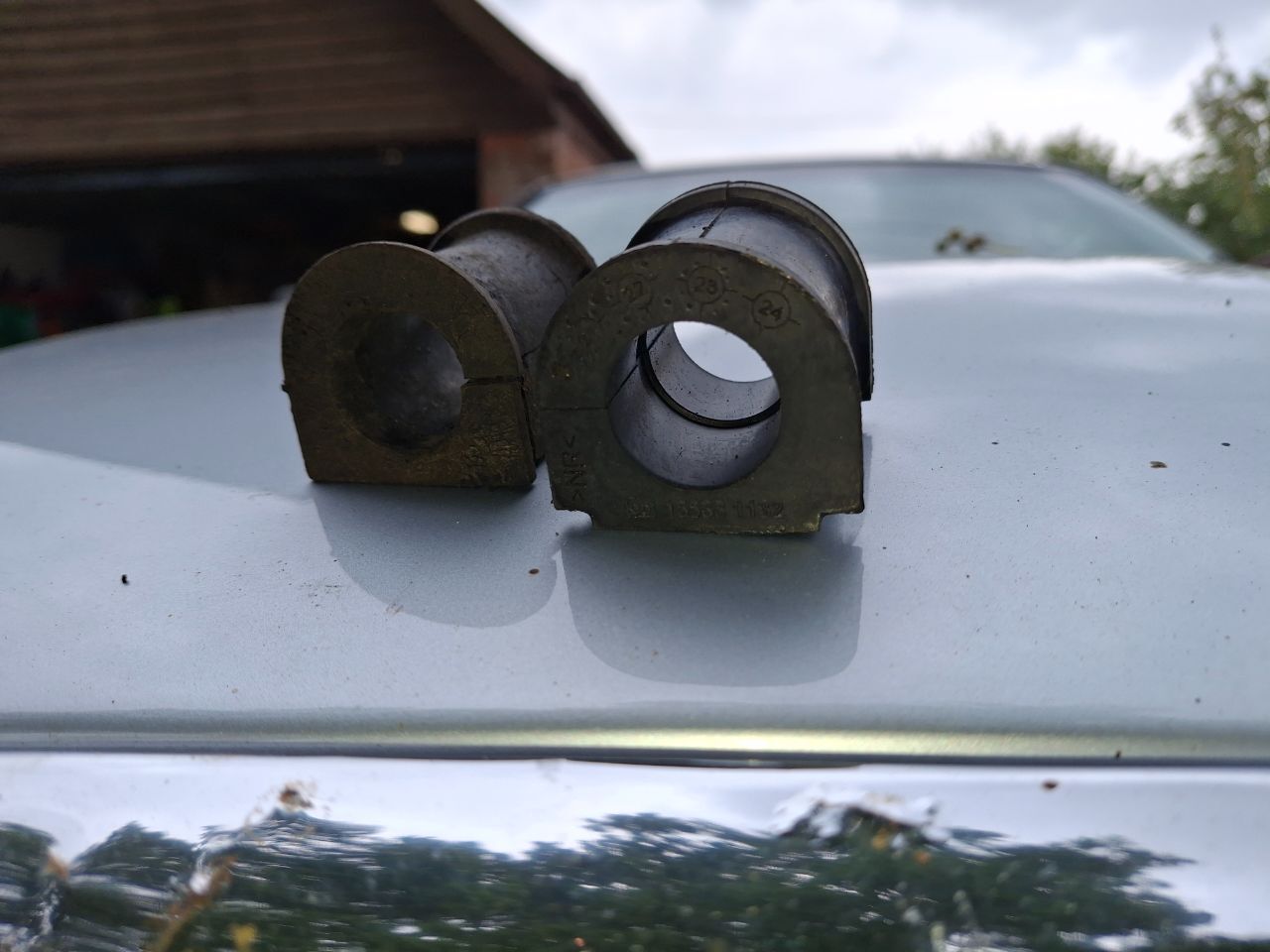

A slight update, I have been fishing about trying to get new front anti roll bar D bushes. Firstly in desperation I bought some expensive Polybushes, turns out that they are for the Vitesse model, they fit the clamp but the bar itself fits like a cock in a sock.
After yet more research I found Iveco bushes are really close dimensionally.... for any 800 pervs out there these are listed as Iveco 09380 1556 Febi 15588.
Close ish.... original on your left or the "other right" for the directionaly confused.........
I found these nearly fitted in the clamps but had to be shaved down a bit, using my finger sander (a seriously messy job!) but I got them to fit.
After much fiddling and fettling they are in place, hold the anti roll bar firmly and look like they belong, pretty happy with that.
That's all for today....

There use to be a website that gave all the exact dimensions.
Way back when I ended fitting front compliance bushes from a Pulsar/Sunny GTiR to the rear arms of an s12 Silvia.

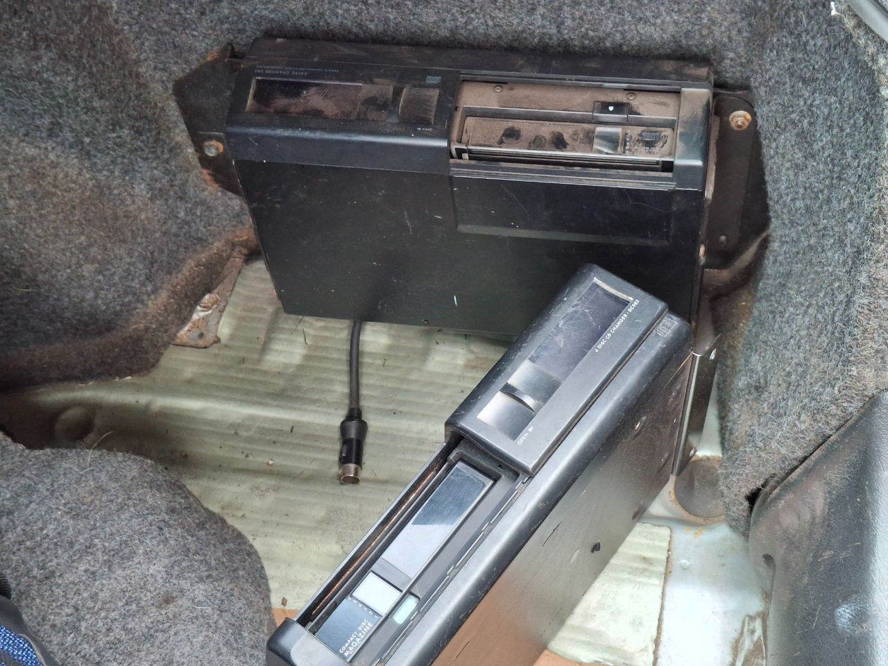

Tiny unimportant update, I have tunes! I had found the radio code previously but the tape player is wobbly an FM radio is miserable Radio 1,Radio 2, Classic FM, local radio shite.... No thank you!
But hang on doesn't this car have not one but two CD multi changers in the boot? Well yes it does..
After actually reading the handbook and finding the CD mode it turns out the grotty looking one is kaput but swapping the plug to the shiney one and..... We have tunes, err big band tunes! These are some of the CDs I found in the changer...
So that is what the Captain of a P&O ferry would listen to on the run down to the port. Not being an elderly retired sea captain I have replaced these with some Dad rock because that is how I roll. But yay I now have my own choice of music to drown out any worrying noises whilst sailing the Longship down the lanes.
