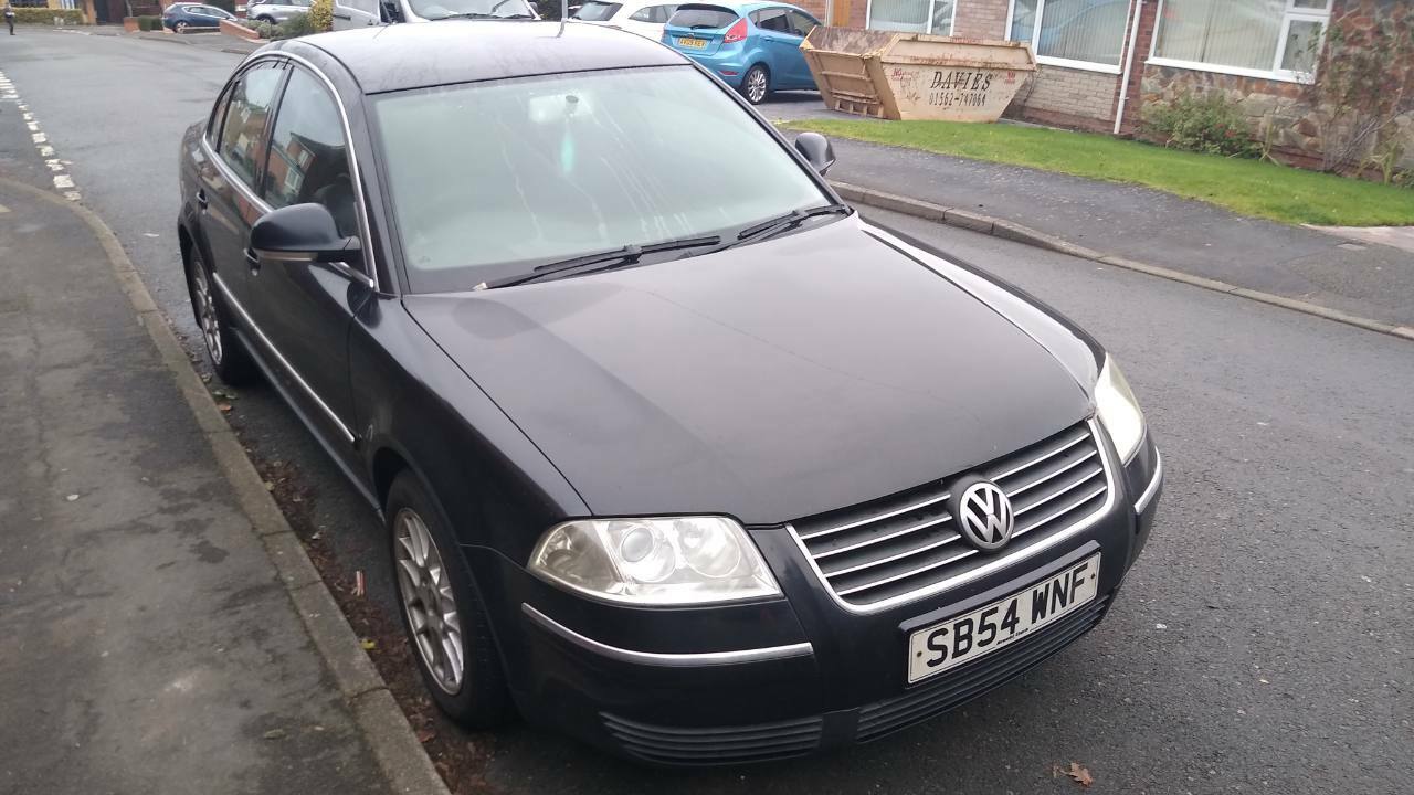

Passat. Quelle surprise.
Working -
Heated leather seats. Lovely.
Drives a treat.
Climate works - more on this shortly.
All seasons type tyres.

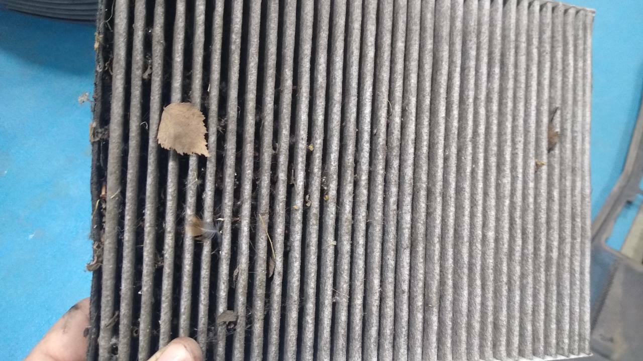

Ah. The pollen filter.

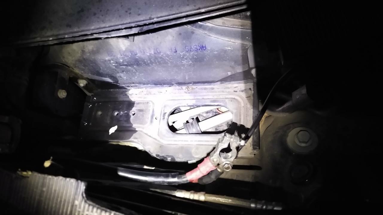

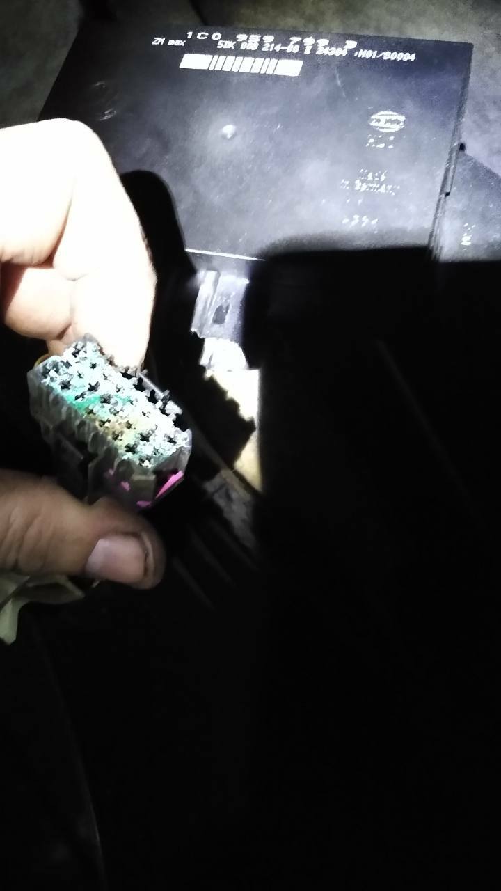

Removed nsf sill trim.
Ah.
Let me get my look of surprise.
Once more unto the breach, dear friends..
All because someone has left the shite in the scuttle to block the drains, then the run - off from filter housing. Which has dried out (as they all do).
Drains cleared.

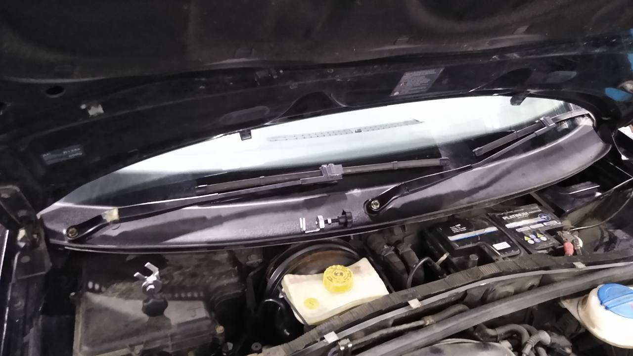

Can't remove the filter housing because overtightened wiper arms.
Three days with clamps on, soaked in Rostoff and penetrating oil.  Nowt. I suspect I'll have to drill them off.

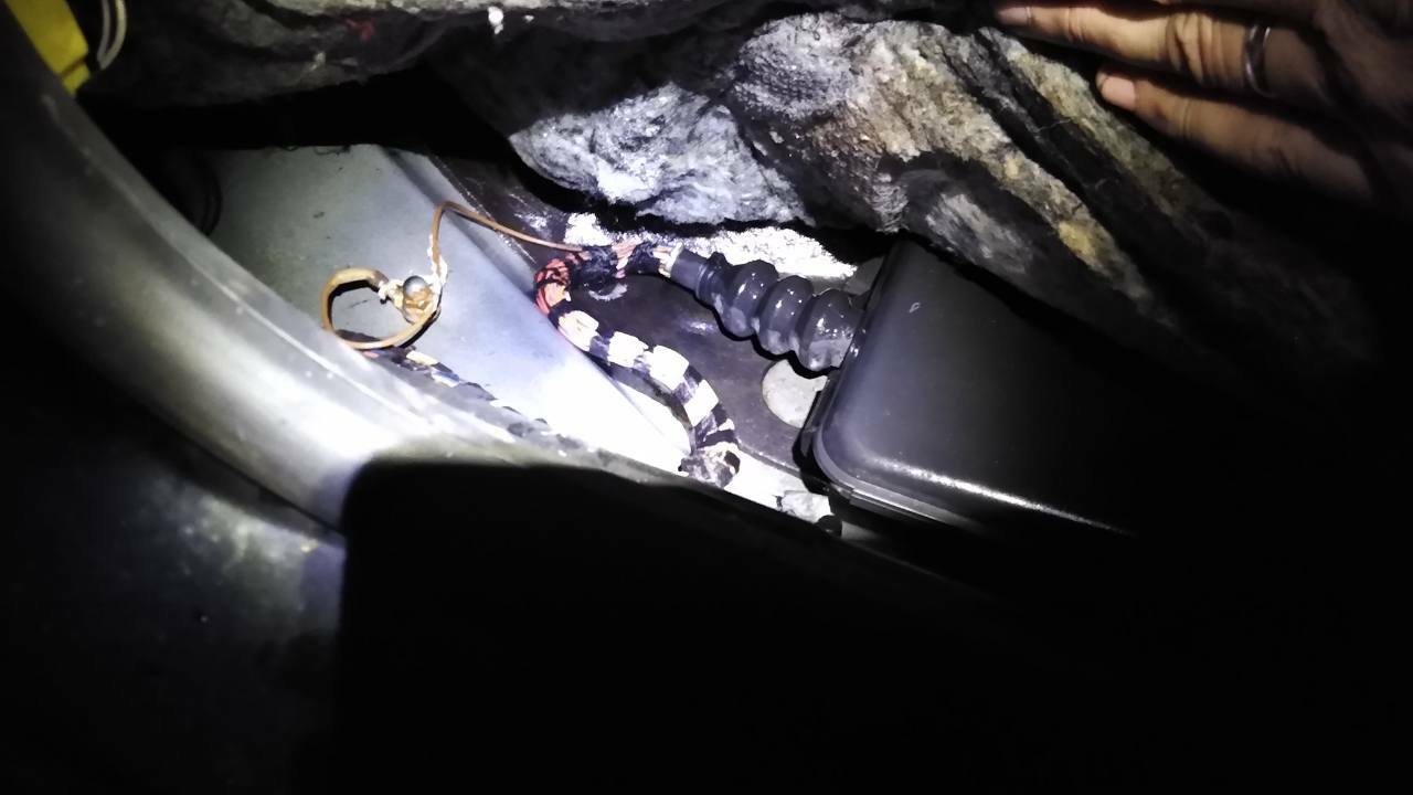

Cleaned a couple of contacts up and the PCB feeds. Needs de-pinning. Yay.
So currently drying# out with wiper arms under tension from pullers. Fully expect the screen to be broken when I look next 🤔.

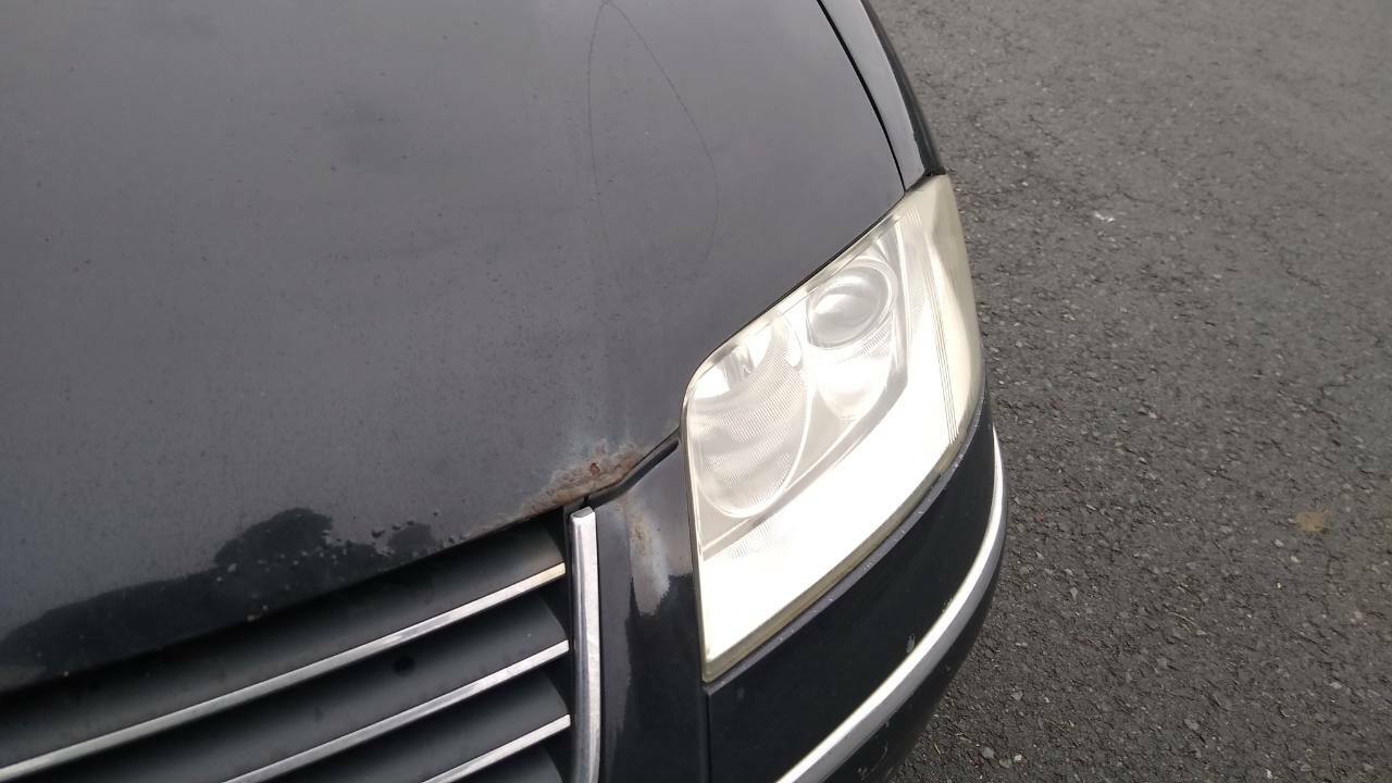

Oh yes, slightly polished headlamps- better (more to come).
Managed to get nsr door out of self imposed deadlock (CCM dried/pin cleaned). 👌

I think the CCM is past it mind. ☹️

I take it you have tried the water pump pliers and hammer trick on the arms ?
That and boiling water poured over the alloy parts has never failed me yet .
Yep. Gingerly as the lower screen breaks if you press too hard on the plastic scuttle trim, nevermind a whack.
Nope, will do when I'm back in workshop. Got an induction tool that usually does it...
Sam
Sam

I feel your pain with the cabin leak . My old one had a combo of blocked drains and the pollen filter seal wasn’t sealing anymore. That underfelt padding took what felt like a month to dry out. having flashbacks here 😂
  • 3 weeks later...
Update.
Wiper arms drilled off, pair ordered.
Seal ordered. Drains cleared, scuttle cleared. Housing reshaped slightly.
CCM dried. Wiring plug meh. Left disconnected to avoid being locked out. Again.
Engine cover repaired and refitted
