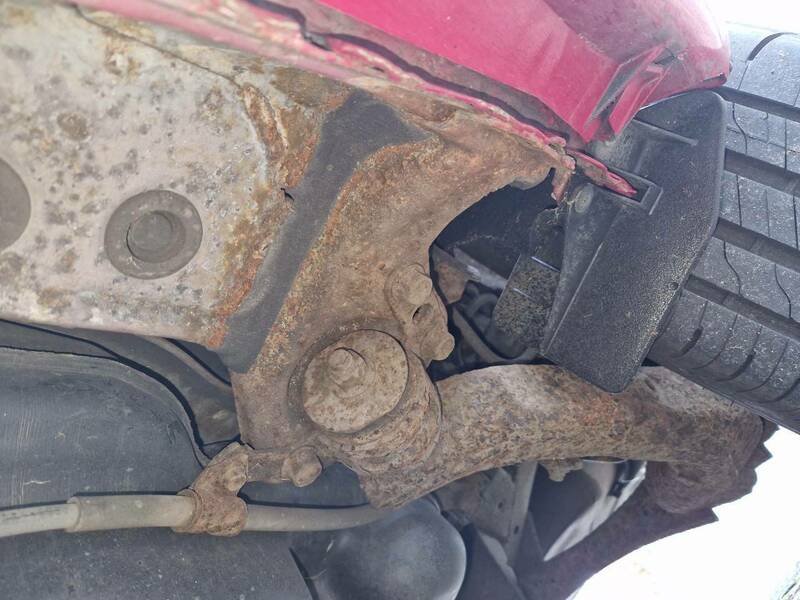

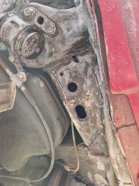

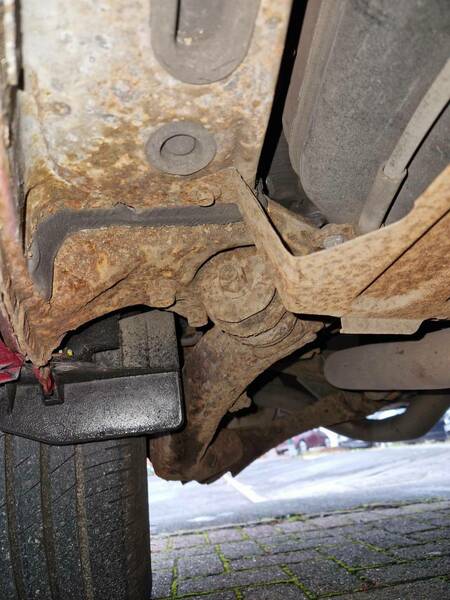

grogee Posted January 15, 2024 Author Posted January 15, 2024 Weather is still "good" (dry) so I shuffled under the Avensis to get rid of the rust I'd seen at the back of the sills. It's actually not as bad as it looks. There's a lot of 'meat' in that area so although it looked like the rust was taking a hold it's actually very sound. Did battle with the angry wire wheel, being careful to avoid delicate wires and pipes. I've done a splash of rust juice but no paint yet, that can wait for tomorrow. Got some cheapo red oxide from the cheap shop in town. I'm beginning to be won over by Lanoguard hype & marketing although actual purchasing will have to wait until #notfuckingJanuary. I think it could be good to dose the underside of the Maestro. mercedade, Back_For_More, Cluffy and 6 others 9
grogee Posted January 18, 2024 Author Posted January 18, 2024 I managed to apply one coat of red oxide primer and one of generic gloss black to the affected areas. I should have really gone and bought some more from our local Cheap Shop but I just couldn't be arsed! It's better than it was and nobody can see my shit brushwork. In my defence it is bloody perishing out there. Anyway all back together and buttoned up ready for action. The 'Revive' snake oil has arrived. My hope is that it will free up the VGT vanes without the need for any disassembly. You squirt it in the intake following a strict procedure of revs/pauses/amounts and then go for an Italian... after which it should be 'completely cured'. We'll see. Popsicle and Rust Collector 2

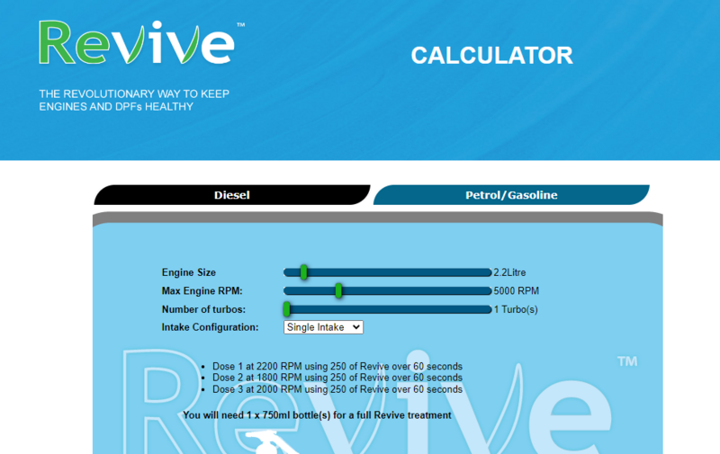

grogee Posted January 19, 2024 Author Posted January 19, 2024 Snake oil experiment: As recommended* by @RoverFolkUs, I have followed the instructions for the Revive turbo diesel turbo cleaner carbon remover snake oil. I am sceptical of course, how can something so benign be effective at clearing out crap from the VGT vanes? It's even non-toxic apparently, and looks suspiciously like piss. Weirdly I'd have more faith if it was a super-dangerous formulation supplied with breathing apparatus. For reference, Mr Muscle spray oven cleaner is extremely caustic. But remember this is going through the combustion cycle, so presumably going into the cylinders, being compressed at ~16:1, ignited and then exhausted into the manifold and turbo where it 'works its magic'. Hard to know then whether it stays in its current formulation or somehow reacts during the combustion to create a 'cleaning gas' of some sort. It has a fairly contrived application procedure, I'm not sure if this is because they want you to think there's some magic 'science' going on or if there genuinely is a reason for the different rev durations/spray application. It does say start applying to the engine stone cold. @Cluffy was at the controls on the loud pedal while I squirted the bottle. Then after this sequence is complete (including a 4-minute 'stopped engine' period) you leave the car to idle and 'wait for the smoke to clear'. There was a lot of clag. This leads me to believe the stuff does something, although I'm not sure what. And of course some of that smoke may well be steam from the Revive potion itself. After this, I buttoned up the air intake trunking and went for the prescribed Italian. I swear, this isn't in my blood. I generally pootle about at minimum revs and sometimes minimum speed. But the instructions call for 'use all the revs' during a 20 minute drive so that's exactly what I did. Could be imagining it but it did feel like it was GLF. At the top end this is a powerful engine. But alas no evidence that it's improved torque low down, at least not yet. Tomorrow I'll have another go with the actuator arm and see if it's moving freely now (it'll be smoking hot now and I don't fancy burned sausage fingers). Cluffy, grizgut, RoverFolkUs and 5 others 8
grogee Posted January 22, 2024 Author Posted January 22, 2024 And the results are in: Revive snake oil is a FAIL. Turbo actuator still stuck fast. I had a more exploratory look at things today and discovered the cat heat shield was held on by one bolt so someone's been here before trying to 'fix' it. Actually it helped me because I was able to shift it out of the way to try and lever the actuator with various tools, none of which were successful. So looks like plan B will be separate the cat from the turbo and go in for the Mr Muscle treatment through a straw. I had a quick go at shifting the turbo nuts and I got one to crack with a 3/4" ratchet so it might be doable. Of course there's one of the three nuts that's behind everything, not visible and a bit inaccessible but I might invest in a new 12mm deep hex socket for that one. It wouldn't be 'fixing' if I didn't break something, this time the vac solenoid. It had a delicate air filter jobbie that snapped off pretty readily. Luckily it was marked 'ATM' so I've wrapped a bit of cloth round the intake and secured* with a cable tie.

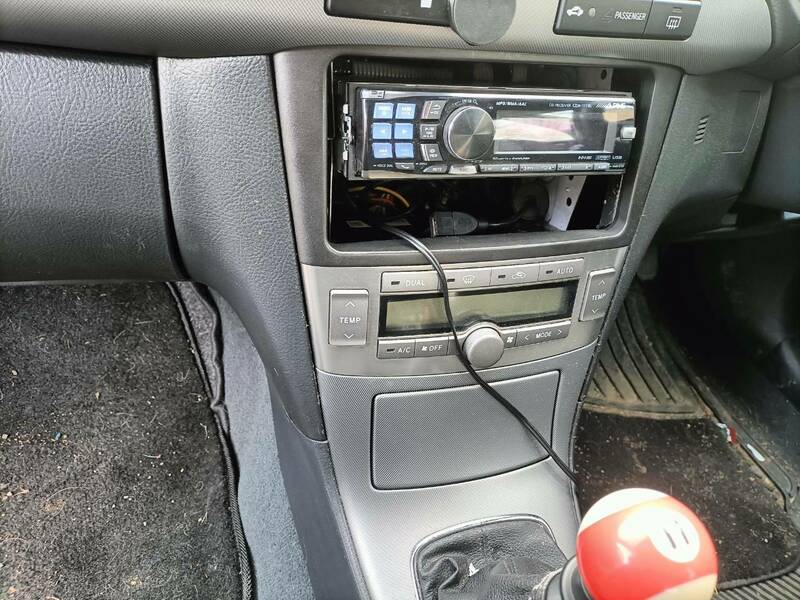

grogee Posted January 27, 2024 Author Posted January 27, 2024 Operation Upgrade Audio: The Avensis has a superficially quite-nice head unit with nav, probably quite a desirable option when new. However it has the following downsides: - Road data from 2008 (I think). You'd imagine this wouldn't matter much but it's surprising how much it's changed in 15 years - It doesn't accept postcodes (I think) - Most annoyingly, there is no aux-in or Bluetooth so I can't listen to CHOONS. Instead I'm currently making do with Van Driver AM radio (TalkSport). This makes me feel grubby. To address this mild inconvenience I'll be pulling apart most of the interior trim to install: - A Sony double din head unit with DAB and blue teeth. This uses Android/Google maps for navigation, and is therefore always up to date - Wiring for a dash cam - DAB antenna - Speaker upgrade for front doors - Possibly a little amp to drive the front speakers if I can get it to fit Interestingly* the 12v to 5v power supply usually interferes with DAB reception so I'll route the cables up different A-pillars. @philibusmo of this parish has supplied me with a cage, steering wheel adapter and various other bits I'll need to complete this. Normally I'd install an amp/sub for maximum MEGABASS but it's rare I get the opportunity to turn things up these days, plus I don't want to hurt my crap hearing any more than I need to. I may run a signal cable to the boot and do something later though. It must have hurt Toyota's sales in the market, not having phone connectivity back in 2008 - I'm pretty sure most rep cars were supplied with something back then. I expect it was addressed with the (2009?) facelift. coachie 1
Joey spud Posted January 27, 2024 Posted January 27, 2024 The tilt mechanism and then the display died on my one about a year ago so I found and very loosely fitted my faithful Alpine unit in the hole. Then for Xmas I was gifted a £22.99 Chinese double din thing again it's just wedged in the hole but for the money it's actually quite good. grogee 1
grogee Posted January 27, 2024 Author Posted January 27, 2024 2 hours ago, Joey spud said: The tilt mechanism and then the display died on my one about a year ago so I found and very loosely fitted my faithful Alpine unit in the hole. Never mind that. Please tell me how to execute POOL BALL GEARKNOB Cluffy 1
MrBiscuits Posted January 27, 2024 Posted January 27, 2024 That looks suspiciously like the nav in my old Lexus - also 2008. I thought at first mine didn't do postcodes. It did, but only if you included the space between first & last bits of the code.
grogee Posted January 27, 2024 Author Posted January 27, 2024 17 minutes ago, MrBiscuits said: That looks suspiciously like the nav in my old Lexus - also 2008. I thought at first mine didn't do postcodes. It did, but only if you included the space between first & last bits of the code. Yes I think I've read it might do postcodes but to be honest it's a bit of a paperweight without up-to-date maps. That said, the 'tilt' function is quite snazzy. Even if that were sorted, the aux-in isn't trivial (and possibly not doable with plug-in solutions, so I've read) and that doesn't necessarily solve the hands free problem, so an aftermarket Sony feels like a good idea. I've kind of resisted going to a touchscreen head unit so far but I can see the benefits and Android Auto seems like a good piece of software, so maybe it's time I stepped into the 2010s for a change.
Joey spud Posted January 27, 2024 Posted January 27, 2024 46 minutes ago, grogee said: Never mind that. Please tell me how to execute POOL BALL GEARKNOB My original knob cover was getting a bit flakey. It just unscrews and is a 12x1.25 thread. I got this one off eBay that was pre drilled I'm fairly sure it was from Jakebullet's shop. grogee 1
