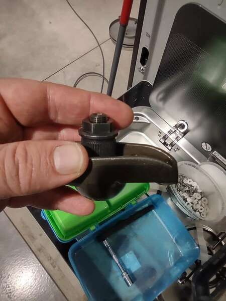

grogee Posted February 9, 2023 Author Posted February 9, 2023 Last night I was at semi-employer's garage having a look at his Mustang, which has shat a rocker again. This time, it was the collar/adjuster that had loosened itself. Managed to get myself in a pickle about how to lock these in place, but eventually settled on keeping the hex collar stationary while tightening the Allen grub screw (after setting the gap to something like book value). He's going to run it at the weekend so hopefully it'll stay attached. It does make a right old racket. Dyslexic Viking, FakeConcern and Matty 3

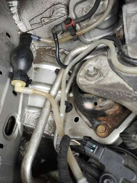

grogee Posted February 18, 2023 Author Posted February 18, 2023 Joy of joys the Espace has FTP'd again. Battery is fine this time but it just cut out as I was driving along, said 'INJECTION FAULT'. Of course being in a rush I haven't brought my coat and it's raining. Luckily I managed to coast into a layby on this single track road otherwise I'd be blocking it. Fortunately not far from home, Mrs Grogee will be picking me up shortly. AA are on their way, 11.40 apparently. Blocked fuel filter? Pump goosed?Seemed quite sudden, no warning. I'm sure HP fuel pumps are really cheap* for these. Cluffy, Sunny Jim, Dyslexic Viking and 2 others 5
grogee Posted February 18, 2023 Author Posted February 18, 2023 There's air in the fuel line. I guess that could mean failed LP pump but also HP pump and also split fuel line. Is there a non return valve in that bulb thing?
grogee Posted February 18, 2023 Author Posted February 18, 2023 Or no fuel in tank! It's on the last 'blob' but it wasn't flashing or anything. I can't remember what these do when fuel is low (in terms of a dashboard warning)
Sunny Jim Posted February 18, 2023 Posted February 18, 2023 Sacre bleu! Hope it's an easy fix. grogee 1
grogee Posted February 18, 2023 Author Posted February 18, 2023 AA man threw in a gallon of diesel just in case it was low, but no dice. He's been fiddling about with a temp bulb pump thing and now has engine cover off, presumably to diagnose HP pump. He's read codes too. So far so logical. Pretty much resigned to this getting towed to our tame mechanic Shaun for further £work. Ian_Fearn, Rust Collector, Sunny Jim and 2 others 5
grogee Posted February 18, 2023 Author Posted February 18, 2023 Blimey. He only got it going. Hats off to him though, because Rennow made it as difficult as possible. With his diagnostic equipment he was able to determine that the HP pump was just ramping up to sufficient pressure as the starter stopped turning. It's one of those starter buttons that will crank for a maximum amount of time, then turn off - you don't have control over it like with a traditional key. So he basically hotwired the starter so that it cranked long enough to get pressure out of the HP pump, then she fired. Drove straight to the garage for them to have a proper look and check it out, assuming they can do it quickly. Mrs Grogee should be able to borrow a pool car in the meantime. CaptainBoom, mercedade, Coprolalia and 5 others 8

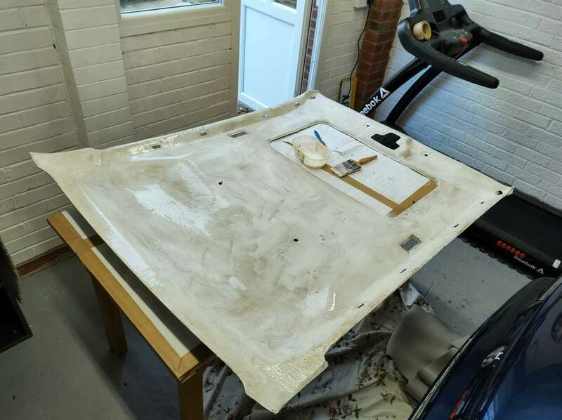

grogee Posted March 25, 2023 Author Posted March 25, 2023 Finally got round to making a start on the Maestro headliner today, ably assisted by @Cluffy. "Kevin" the bodywork man has gone onto radio silence; we've exchanged a few calls and messages but he hasn't responded to my "how's it going" that I sent on Thursday. So he's probably not even started, or potentially it's caught fire and is now ashes. Anyway that's fine, no rush as I've still got nowhere to work on cars. Step 1 for the headliner was a good hoover to get rid of the dessicated orange grot that used to be glue. Step 2 was to glue the broken bits back on. Unlike other headliner backings I've come across, this one is expanded polystyrene. This makes it fairly brittle and delicate, so we were being fairly careful not to make it worse. My theory is that by plastering it with PVA, I should end up with a smooth surface that will be happier with the trim adhesive and fabric. We weren't able to completely remove the orangey grot but I'm hoping if it's encased in PVA, that shouldn't matter. Next up will be fabric glueing, always a bit scary. In other fleet news - the Puma has gone for MoT. I told our 'friendly' tester that I thought the headlights were too high, and the handbrake was a bit shit. Sure enough, that's what it failed on. He's going to have a go at adjusting the handbrake on Monday; luckily I don't really need it in the meantime. Pretty sure it had new shoes not long ago so hopefully it'll be salvageable without major surgery. AnnoyingPentium, Dyslexic Viking, Wibble and 5 others 8
grogee Posted March 25, 2023 Author Posted March 25, 2023 Oh, and in other BL parts hoarding news - I got a pair of rear damper "bushes" (really the seat that goes between damper and body). Like many of the Maestro bits these are NLA, however one of the forum nerds (Bill) was able to get a batch made up for the forum people who wanted them, about 10 pairs at a guess. They were £30 odd but will come in handy when I change rear dampers to the Spax adjustables I've got waiting. Popsicle, Dyslexic Viking and AnnoyingPentium 3
Wibble Posted March 25, 2023 Posted March 25, 2023 Watching your headliner work with interest as the Senator’s is pinned up at the back for now. grogee 1
grogee Posted March 25, 2023 Author Posted March 25, 2023 37 minutes ago, Wibble said: Watching your headliner work with interest as the Senator’s is pinned up at the back for now. If you go back through this thread you'll see the one I did for a Saab 9000. Which, hopefully, is still in place @Soundwave?
Soundwave Posted March 25, 2023 Posted March 25, 2023 5 minutes ago, grogee said: If you go back through this thread you'll see the one I did for a Saab 9000. Which, hopefully, is still in place @Soundwave? Yep, still in place and still a constant reminder that I need to do something with the C-pillar trims, which look inadequate in comparison, grogee 1
grogee Posted March 25, 2023 Author Posted March 25, 2023 1 minute ago, Soundwave said: Yep, still in place and still a constant reminder that I need to do something with the C-pillar trims, which look inadequate in comparison, Ah yes, I didn't get that far... Rested on the laurels of my success with the headliner I'm afraid. I've probably accumulated enough off-cuts for you to do them by now, or I will have after the Maestro job - you're welcome to them. @Wibble if you're alright taking the pillar trims off then it's not too bad. Can be awkward with a saloon, so taking the passenger seat and possibly passenger door trim out can help. Don't do as I did and wait until the HOTTEST DAYS OF THE YEAR to bleddy do it or you'll burn your fingers on the roof.
Wibble Posted March 25, 2023 Posted March 25, 2023 Thanks, I’ve seen the Saab one just watching as many as possible to build up the courage!😁 The front pillar trims were removed for the screen being replaced and the fitter was surprised to find them held by metal clips rather than plastic, so fingers crossed. If I get brave enough it will be on my thread at some point but I really appreciate the tips👍 grogee 1

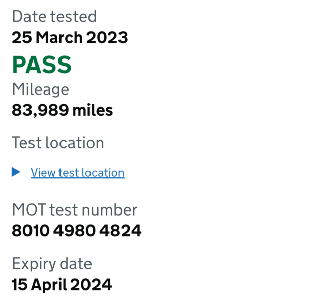

grogee Posted March 28, 2023 Author Posted March 28, 2023 The Puma is back in business. My MoT man claims to have 'fixed' the headlights and handbrake but... - Headlights were adjusted with the level adjuster set to '3'. So if I put it back to '0' they'll be too high again. I can see myself fixing this in the summer. - Handbrake was allegedly 'adjusted' but it feels exactly the same. I suspect he's just tightened the adjuster behind the handbrake lever rather than taken drums off and clicked self-adjusters out a few clicks. Again, I'll see to it in the summer. The good news is that it only came to £80, IE £30+MoT cost. Thing is about that tester, he is pretty sympathetic to the old shite I bring in, so the Maestro will be going there as soon as it's back from bodywork and I've sorted out the handbrake. And hazards. And fog lights. And exhaust... Jenson Velcro, Wibble, Dyslexic Viking and 6 others 9
