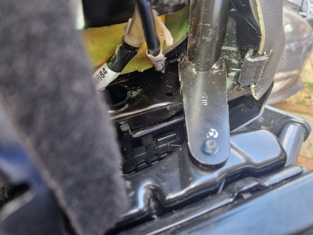

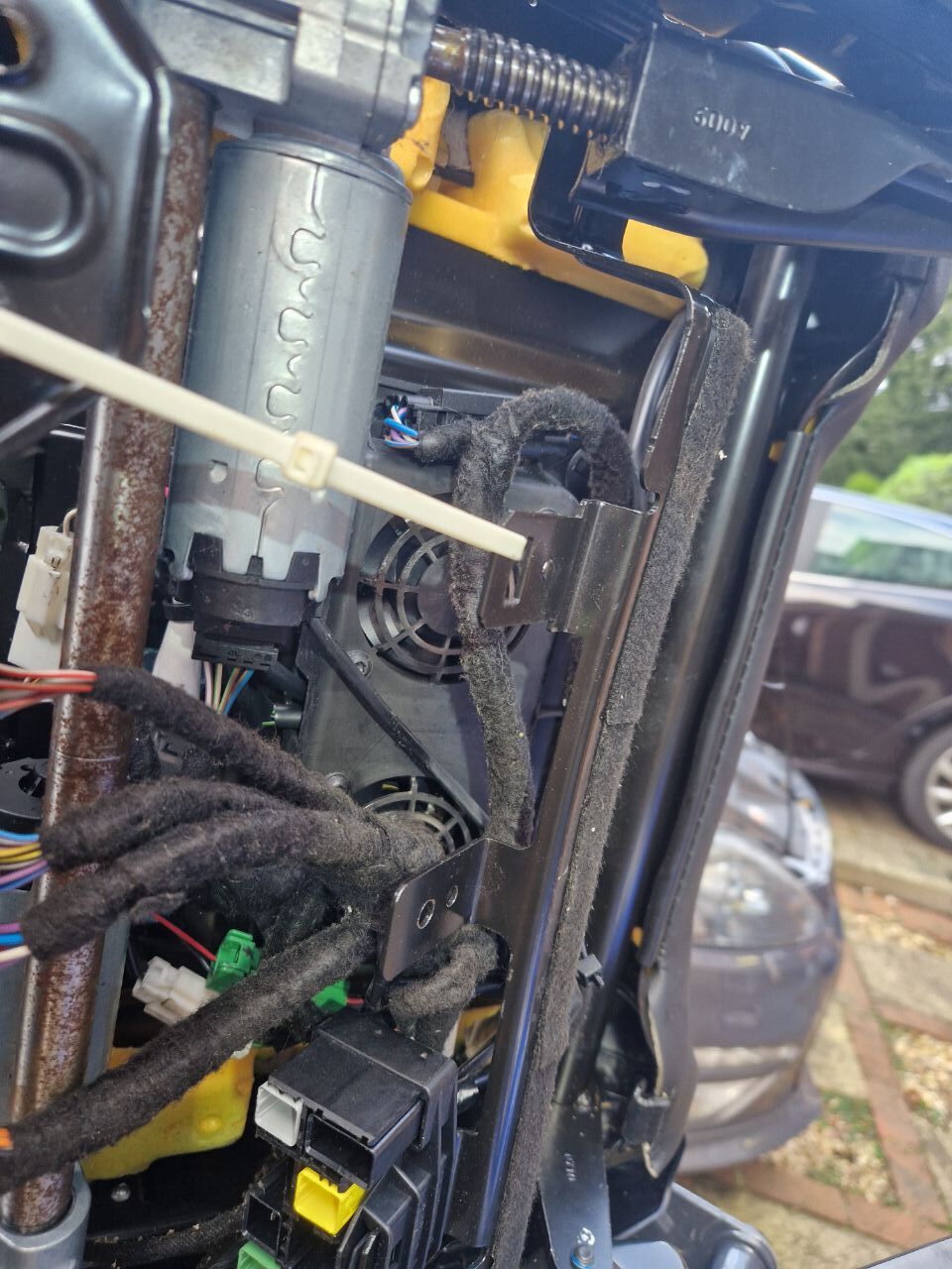

Took the driver's seat out of Monty (naming cars etc).
They have a problem where the often-used seat wears out its bushes on the linkage frame which manifests itself as a slight (but annoying) wobble when you get in and sit down. TADTS. 20251230_133503.jpg.550d2ae6f05567b5899bca83c020dcac.jpg

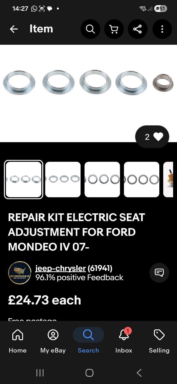

Bought a bush kit specifically for mk4 Mondeo seats, and of course it didn't fit. Fortunately I have a 16mm drill bit and once I'd removed the runners and frame from the rest of the seat I was able to enlarge the problem hole and insert the washer. The shoulder bolts then fit through this. Screenshot_20251230_142755_eBay.jpg.f1c28a56abf1d266d6731238d1d66543.jpg
I was pleasantly surprised that my Chinese 16mm drill bit was able to get through 4mm pressed steel plate.
It's then a case of fiddling the bits back together. For reasons known only to Lear, one of the seat runner allen bolts is not captive but also is shrouded so you can't get a tool onto it... Great job guys. A combination of needle nosed pliers and a cut-down Allen key sorted that out.
Quite fun looking at the seat and seeing all its workings, including the fan for bum cooling in the summer. 20251230_133507.jpg.a4aa69bbb73df25c7394110a7cfa2f31.jpg

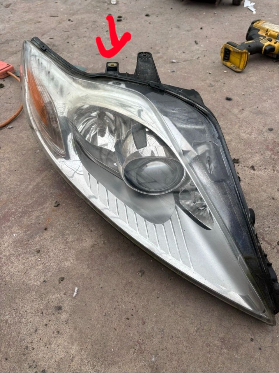

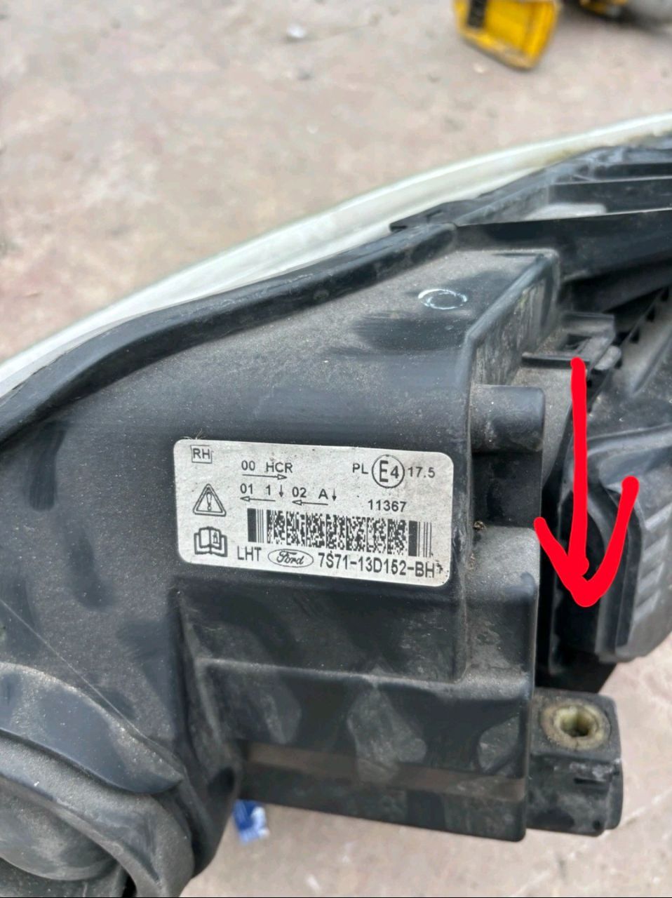

I'm a complete tool. Spent the last few days pulling my hair out, wondering why I can't adjust the low beam aim on the Mondeo.
Initially I thought it was this adjuster:
turned and turned it to no effect. Then went through the Forscan procedure thinking it would be adjusted electronically, but the procedure just prompts me to 'adjust headlamp aim using proper equipment' or some such.
Then had another look at headlamps for sale, and noticed this... Screenshot_20251231_132331_eBay.jpg.2e979060106953c8a5682429675d96d7.jpg
This adjuster, buried at the bottom of the light, does the up/down. The other one I had been turning does the left/right aim (I think), or possibly main beam adjust.
Anyway, glad I've found it. When it goes in for mot I'll get them to set it correctly with their beam checker.

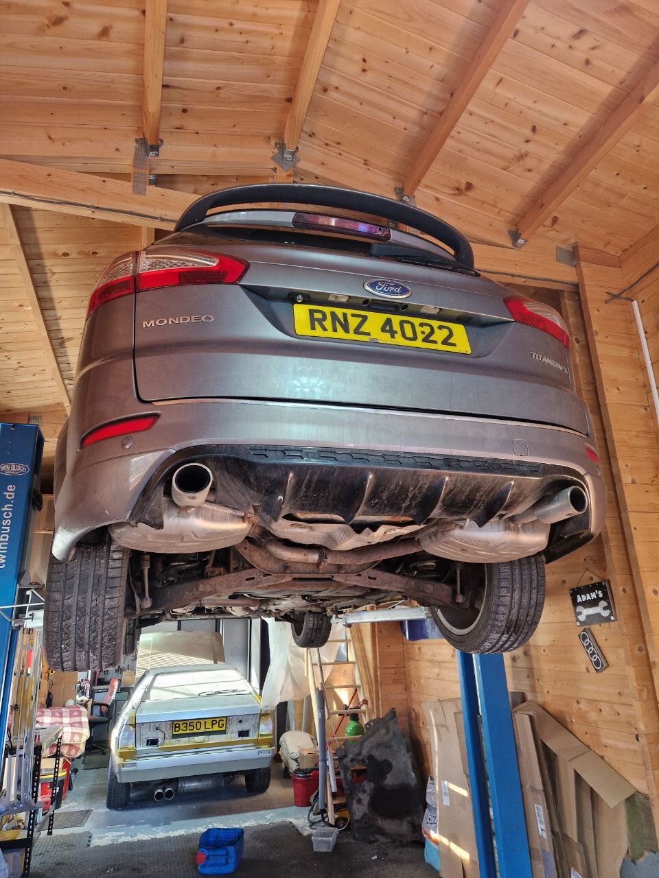

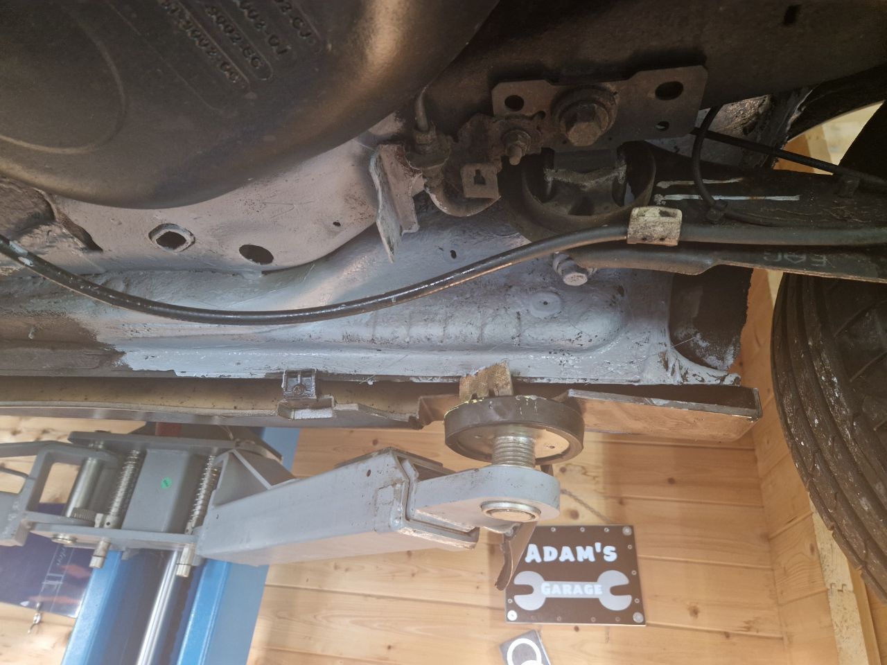

Adam's garage again, note quattro at far end. 20260110_103334.jpg.fbb4fd8586aa8ba9a433afe4f7113fe6.jpg

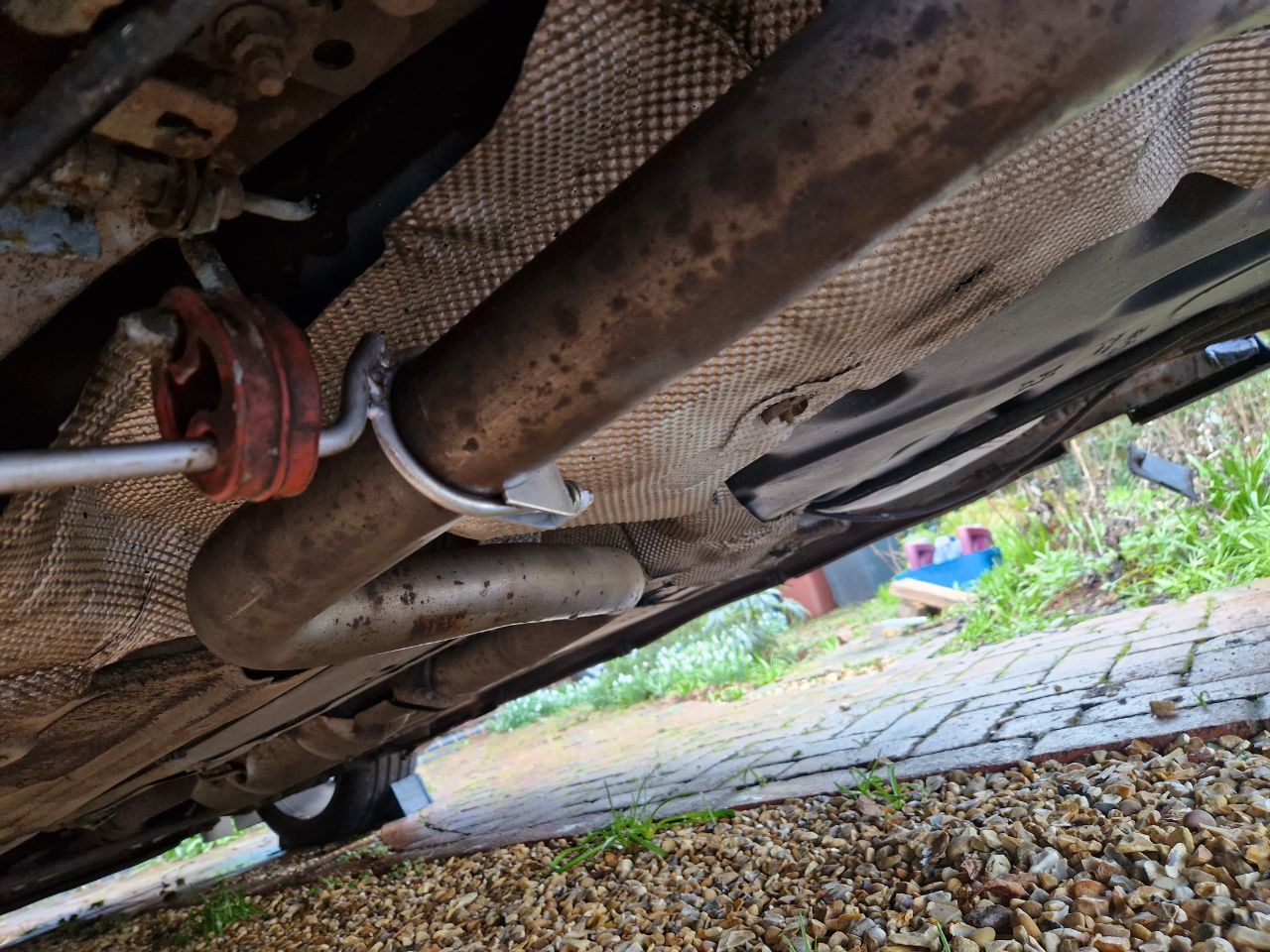

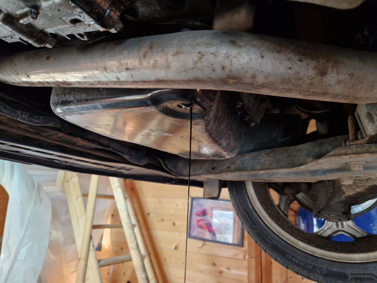

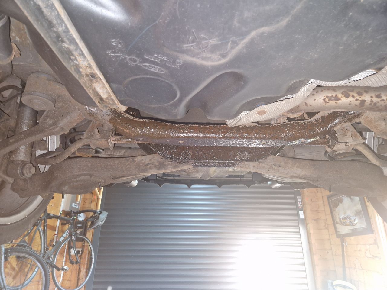

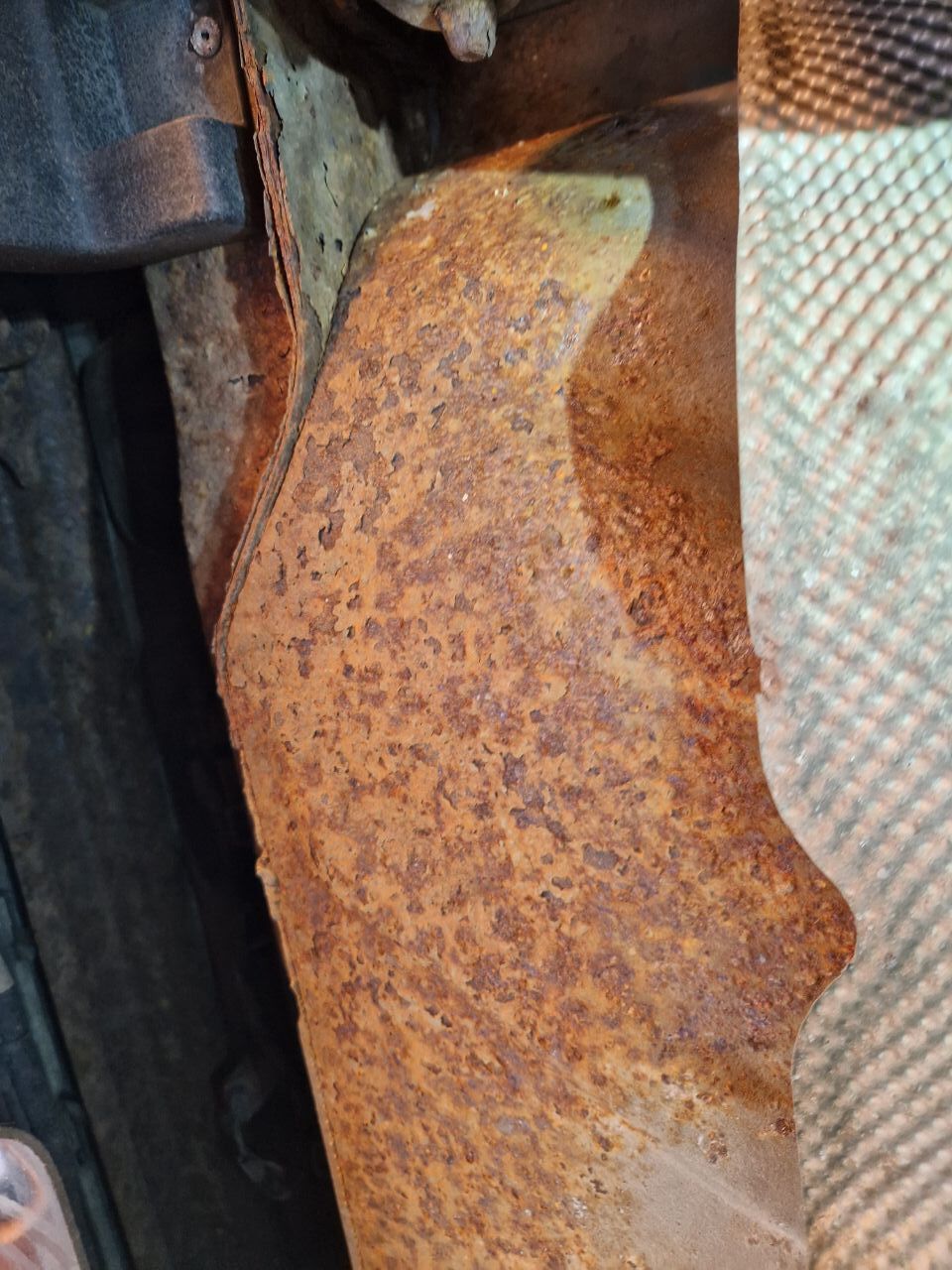

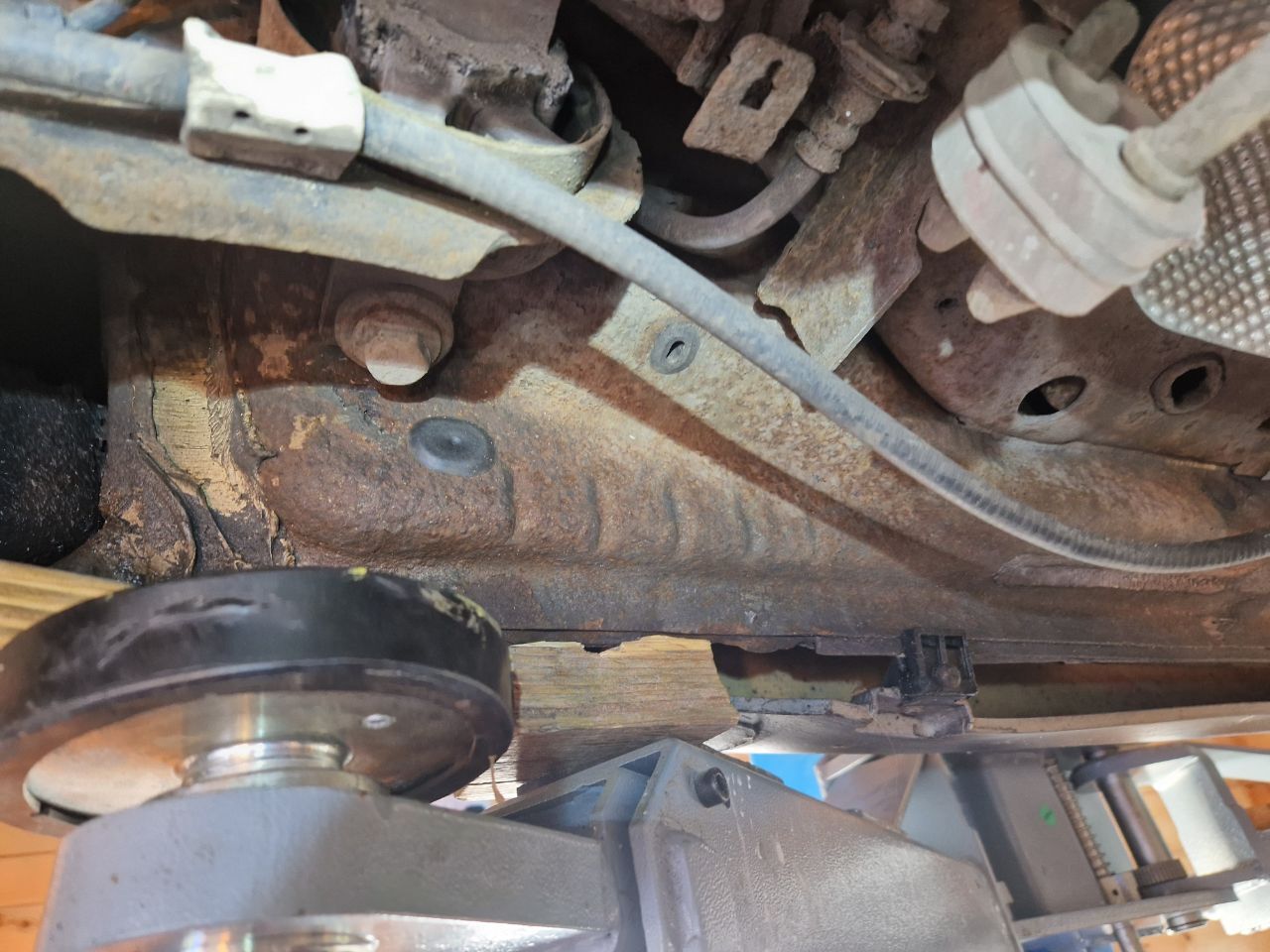

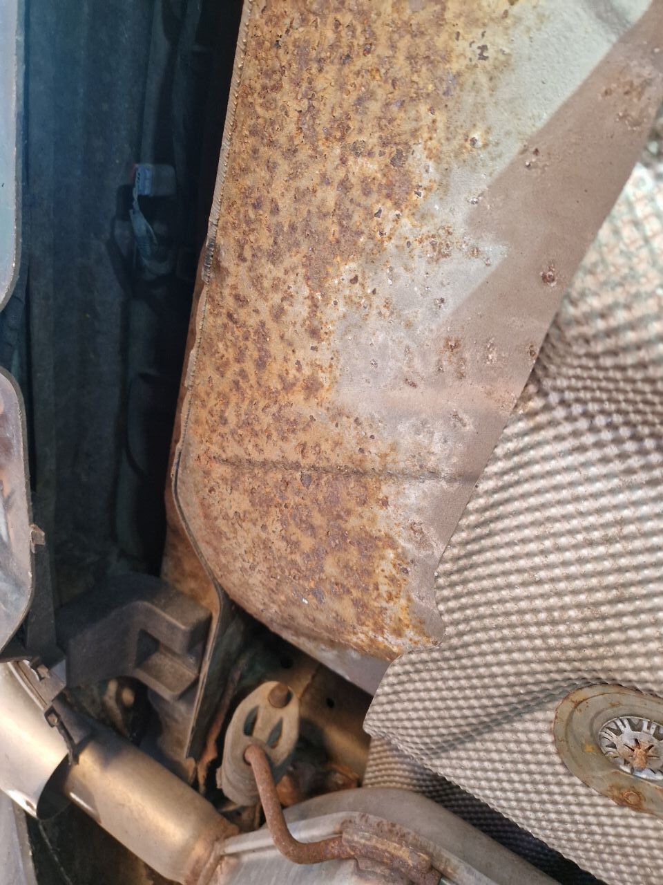

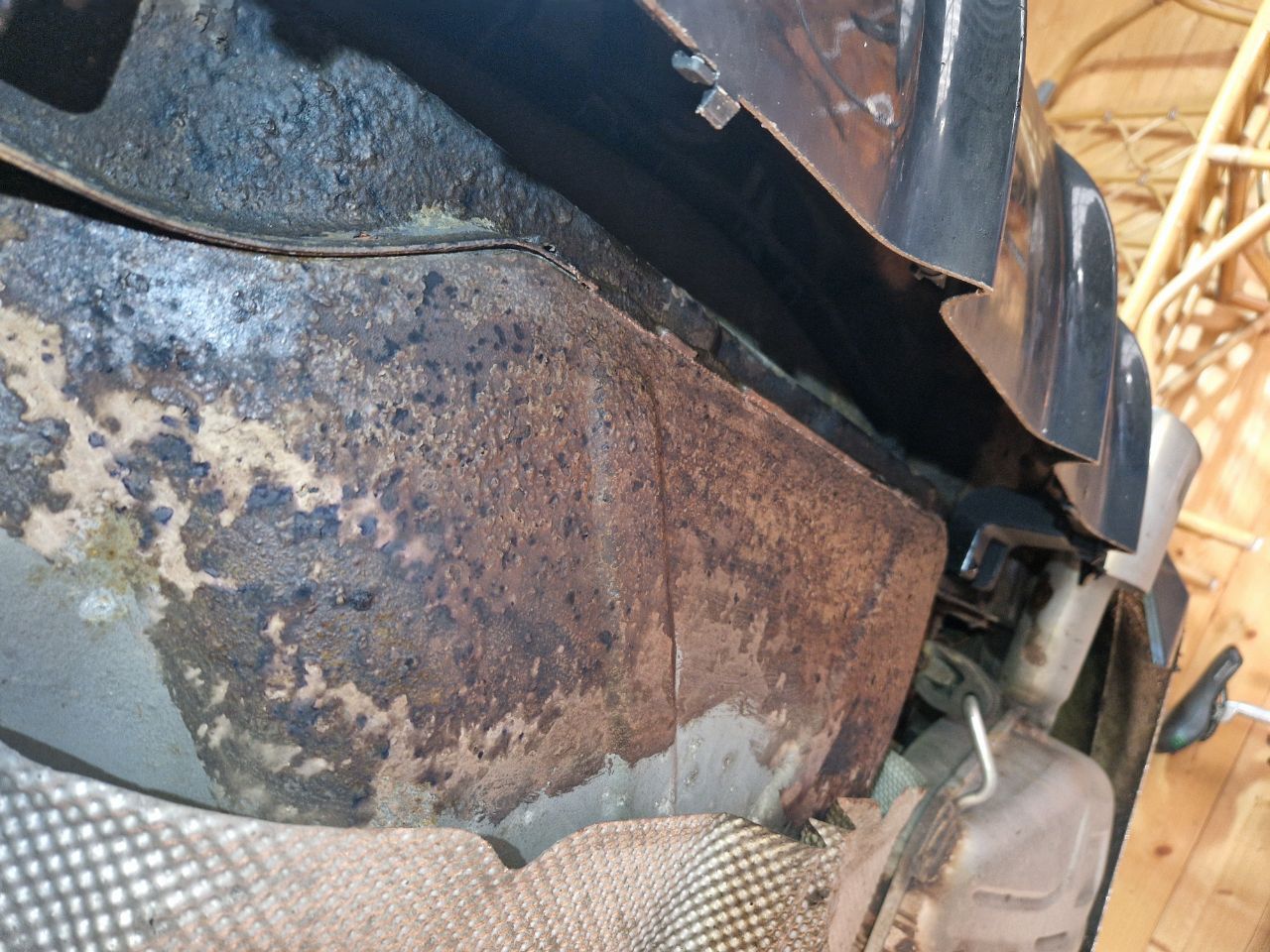

Service time for the Mondingo. And a chance to get underneath and check for rust.
Rust found:20260110_103205.jpg.936394a918f39c837bf07127b0584fb8.jpg20260110_103202.jpg.135ec825351d61271799f6cb8ca71851.jpg20260110_103115.jpg.217f19f397402530de85152273204d8f.jpg20260110_103110.jpg.807da3373d9d53b2c60755d6c6564001.jpg

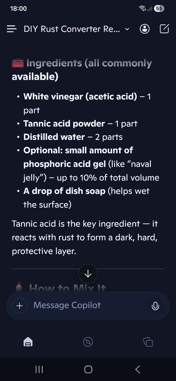

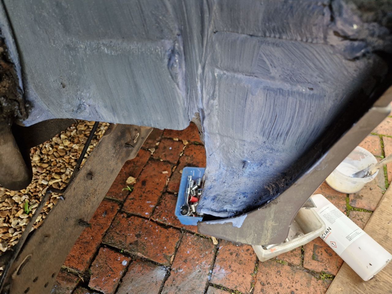

I made some rust potion in the week following this recipe provided by AI. The kitchen smelled weird afterward but it is quite effective and cheap to make. Screenshot_20260104_180010_Copilot.jpg.05971b5e5aeaf9f278146ef4d3b44ac7.jpg
I didn't have time to go full rust protect on everything but I did use the last of my Lanoguard on the rear subframe, more as an experiment than anything else. We'll see what MoT man says in the Spring. (Note cable tie on exhaust mounting - also an experiment! I will source a proper replacement soon.) 20260110_143335.jpg.6bb28a9608e097c51bc4b9869c2cd5c5.jpg
20260110_143321.jpg.66557f1828499176e74c6dd9581b979d.jpg20260110_143330.jpg.0b676b6e7b1d82f2988c04ed8dcfd901.jpg20260110_143344.jpg.b30137ce8674f597a1c99043cd5a25d3.jpgAlso did a couple of changes of the transmission fluid. Definitely worth doing, the changes are quicker and smoother and it just feels better now. The old stuff was horrible and stank of death. 20260110_111826.jpg.f2c140a6cb00297b618e0ff0c65e65d7.jpg
The Mondeo is quite wide and it was a real squeeze getting into and out of the driver's seat between the posts of the lift to start and stop the engine. Flushing the fluid is a bit tedious but not too bad, I used Foreskin to monitor transmission fluid temp then once it was above 50°C removed level plug as car was running to set the level correctly.

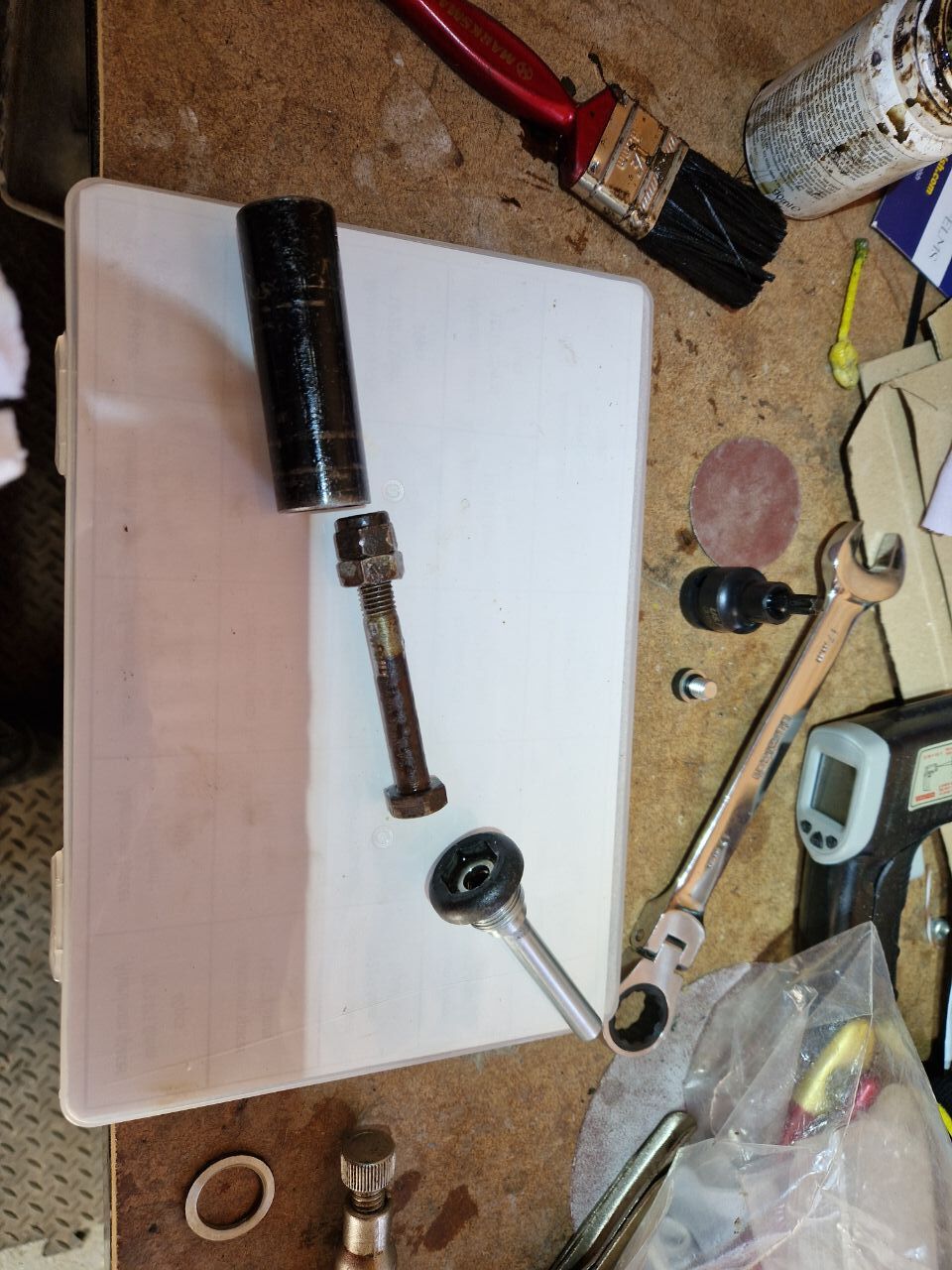

I had a total brain fart though. To get the main drain plug out of the gearbox, I needed a 17mm Allen socket/key. I'd specifically bought a set which said it had that size but when I looked at them, none of them seemed to be big enough.
So I spent ages thinking of a work around with what I had around me - a 17mm headed bolt with a couple of nuts locked together. I was convinced it wouldn't work as the plug was on super tight but this lot and the impact driver removed it, phew. 20260110_111855.jpg.440f5442a2ab8140a4e956be55756dd8.jpg
Then when I got home I realised I DID have the correct Allen bit after all, it was just that I was looking at it backwards and didn't realise how to use it - it's a 10mm shank with a 17mm head. Flippin eejit.
You're supposed to replace the drain and level plugs each time but there's really no need. I did replace the seals though - one rubber O-ring and one aluminum washer. £10 for assorted sets of both which will last me a lifetime, instead of £18 for the plug set - fuck that.

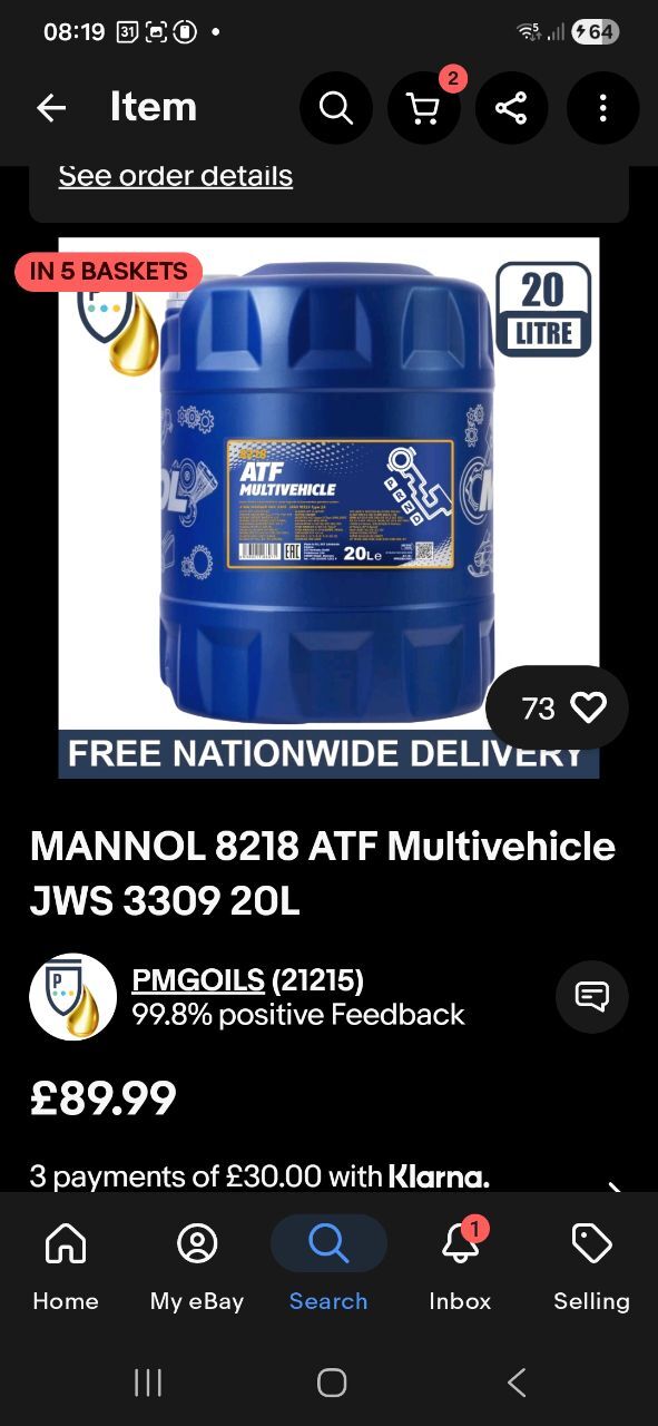

I spent the money on 20 litres of Mannol transmission fluid instead. I've still got about 12 litres left should I decide to do it again in the future. Screenshot_20260111_081912_eBay.jpg.c5c43d2a4c35dc4881b13faf7dd548cd.jpg
Anyway, oil and filter done too so OK for another 12 months hopefully. 20260110_103058.jpg.7c3757540e54dd87f3136c7dd7233878.jpg

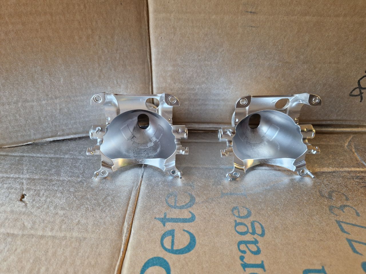

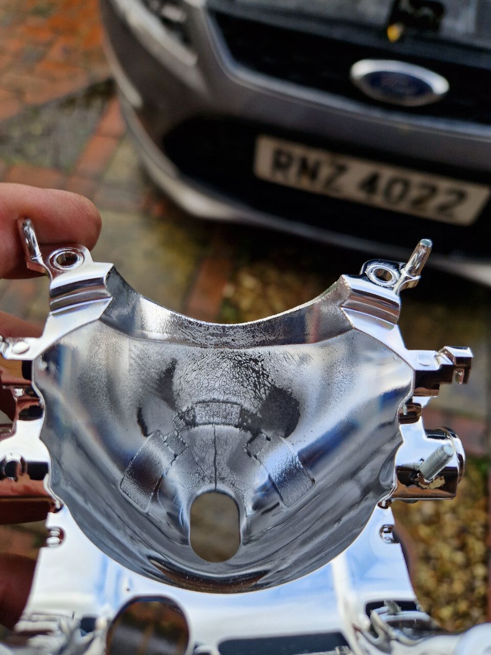

Moar headlight twatting about.

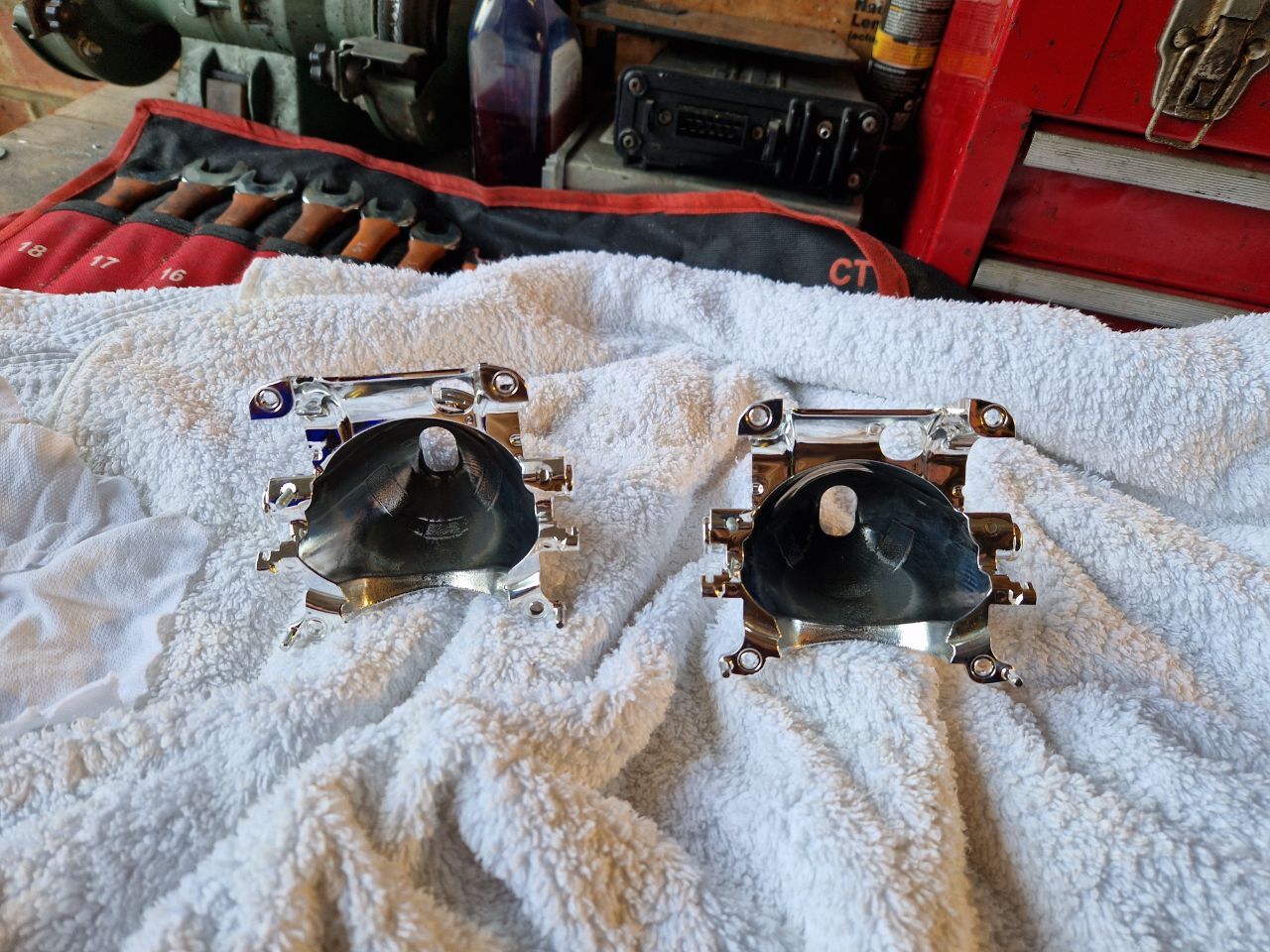

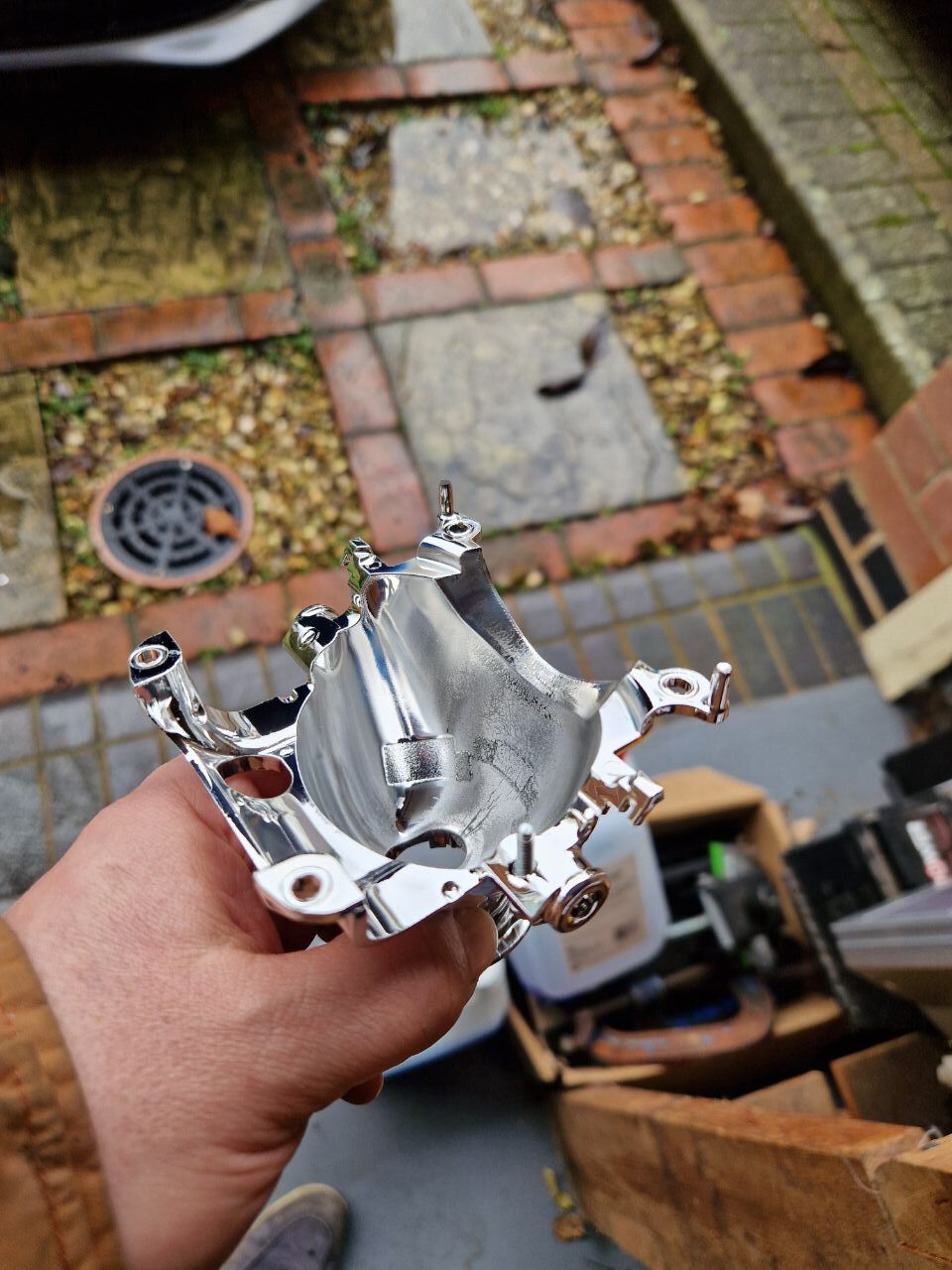

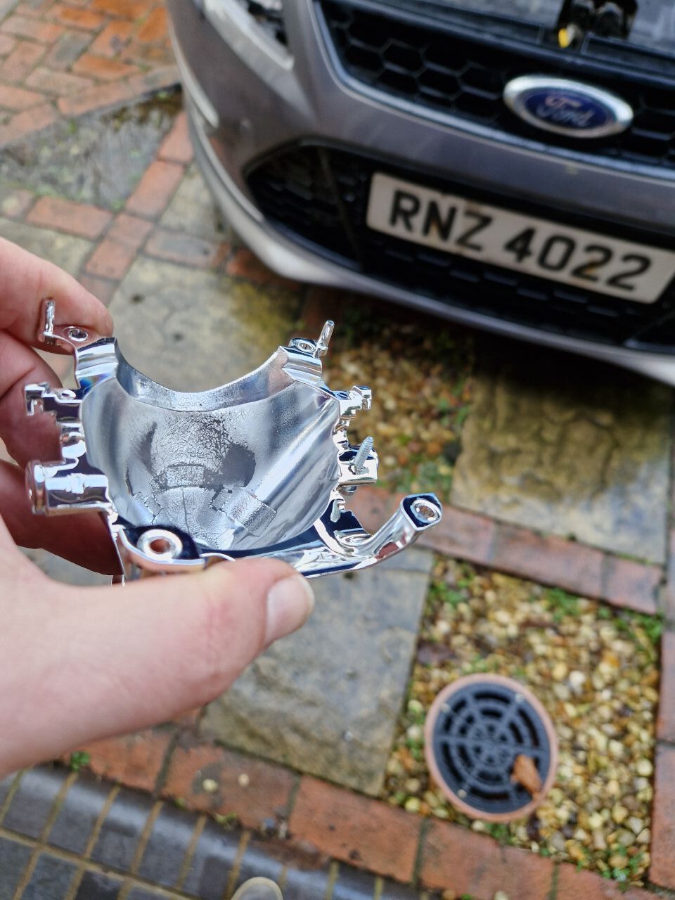

Despite cleaning the lenses, I'm still not happy with the output. There are replacement reflector and lens kits out there but they're £60ish and I've decided the main culprit is the reflectors.
Here they are before treatment. The silver paint/plating above the bulb has deteriorated, presumably from the heat over 14 years. My theory is that this top part of the reflector is the important bit for dip beam, as I think the fish eye lens inverts the beam. 20260117_112732.jpg.c3ef6516c150089a8a1afa5af7332ccc.jpg20260117_112740.jpg.8db579f5cac27a8e02f6c08772b52953.jpg20260117_113547.jpg.8f5b420f1e4f0c93b0629c8a40914c4b.jpg20260117_113552.jpg.87bdaeac9a0176ae803dc867945f2555.jpg
So rather than fix properly I'm having a go at bodging with some chrome effect paint.
Sanded the surface with 1200 grit then cleaned with alcohol, then sprayed a couple of coats on. 20260117_114815.jpg.3c83fffe3a47bd8492240485189a51d0.jpg20260117_115238.jpg.3b36953a33ff2aa0c245fedc3ef0b7c3.jpg
Repeated the process then bolted the lights back together but disaster struck.
As I was fitting the assembly back into the light, I heard a horrible crunching noise... The lens bit had been forced into the plastic chrome 'ring' bit of the main body of the headlight and snapped bits of it off.
To compound matters, my pound shop superglue tube failed and spilled superglue all over my hands. It was awkward sticking the bits back as there's no access through the clear front plastic cover.
Made the best of a bad job and refitted to car. Haven't tested yet but we'll see if there's any difference next time I drive at night.
Bit confused as to why it crumbled, the other side went together without drama. Plastic shifted due to heat maybe?

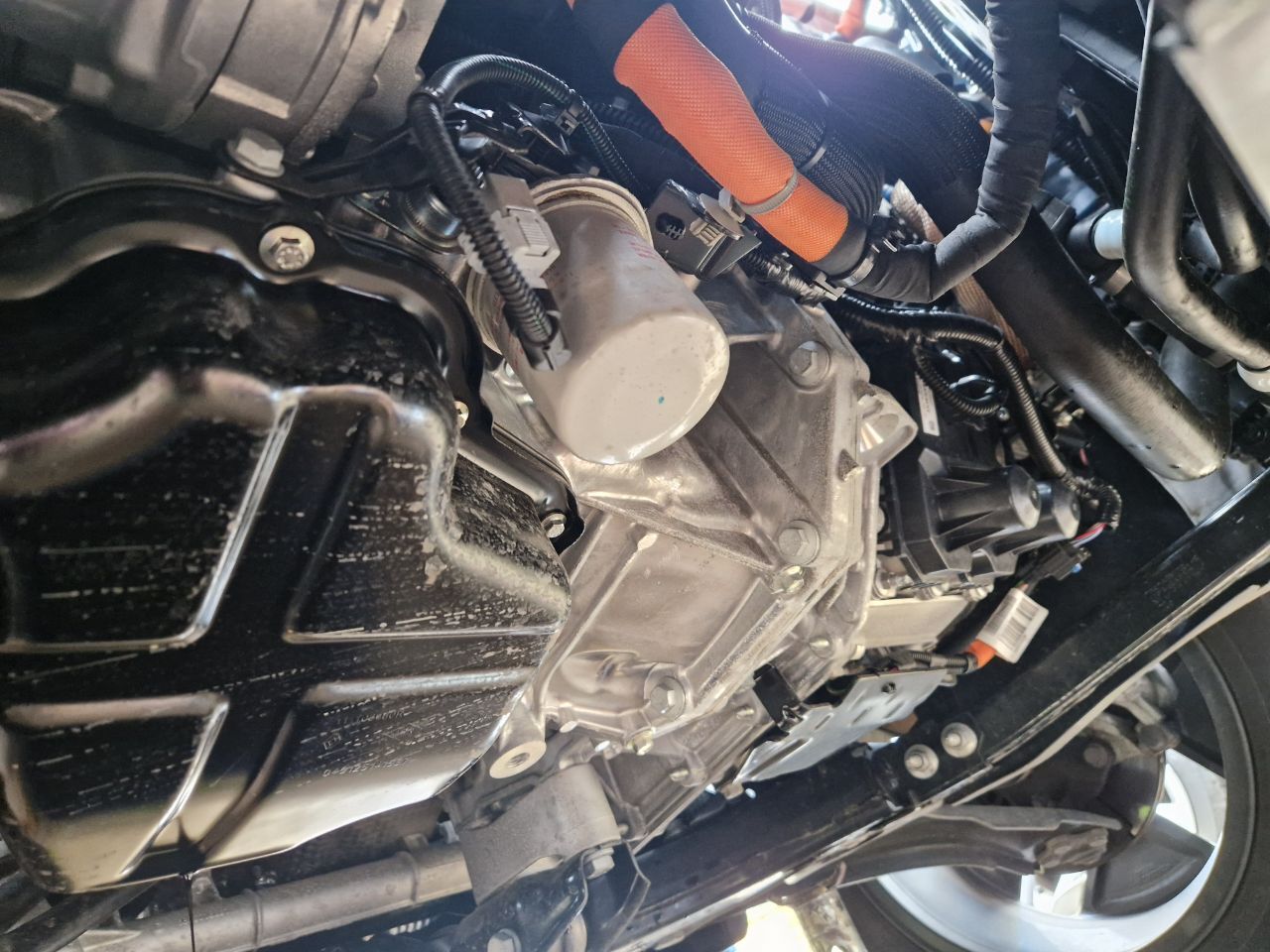

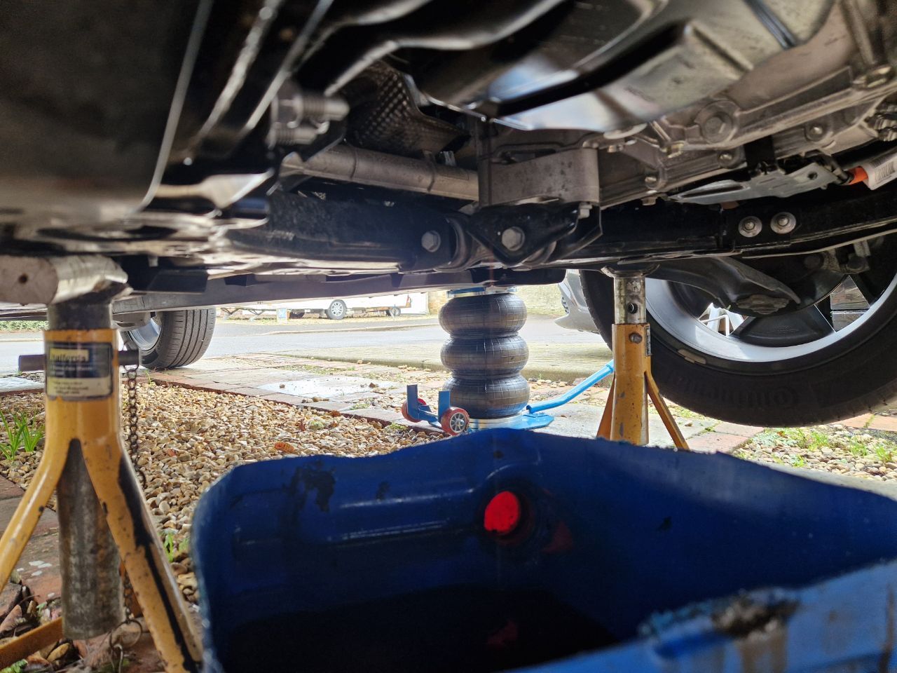

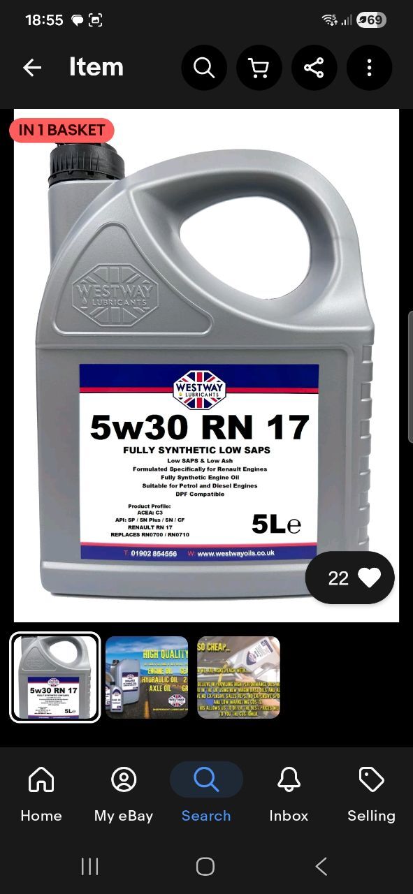

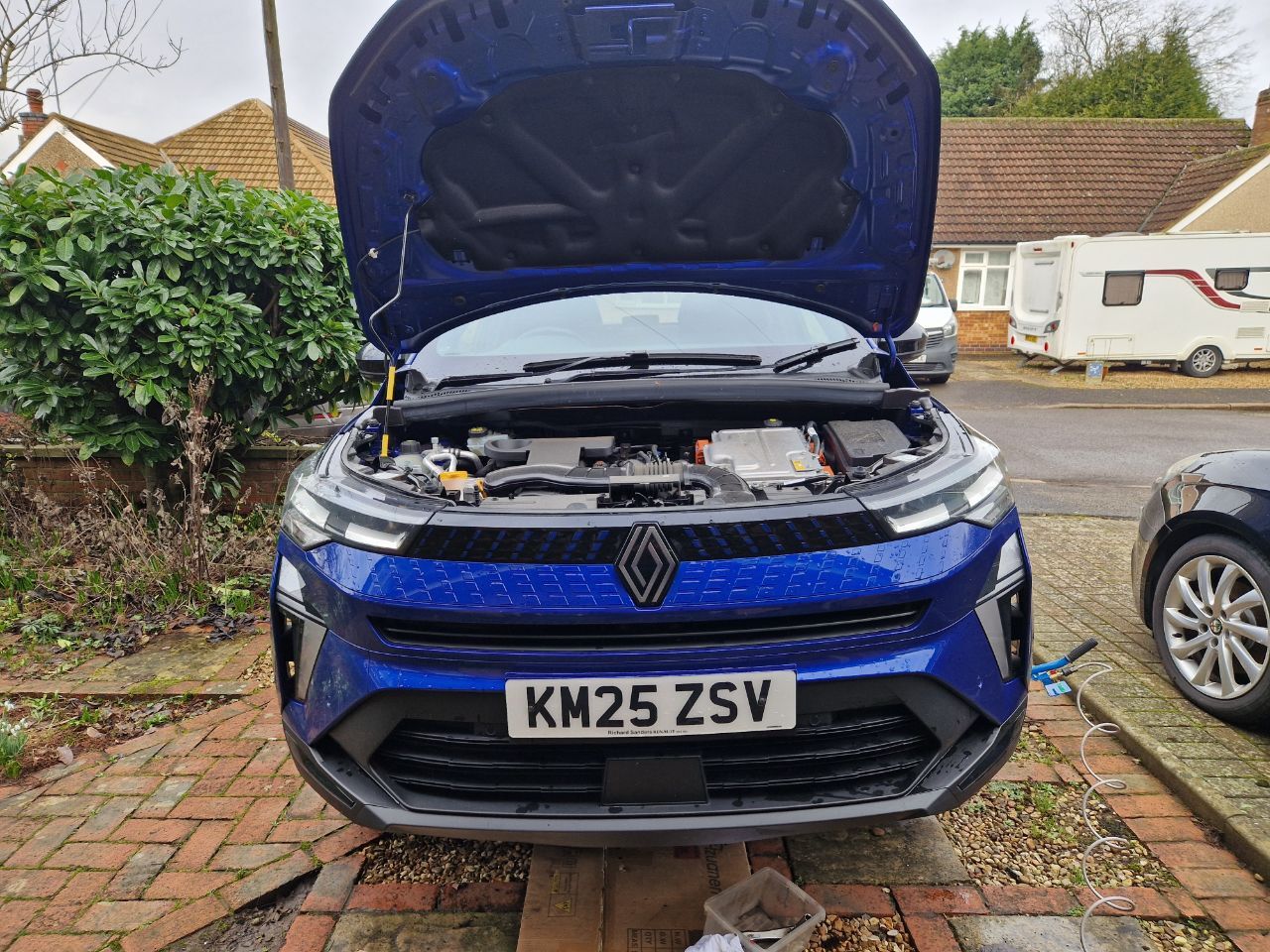

Today I changed the oil on the nu_Mrs Grogee's Rennow Captur.
It's done 6000ish miles since new, and the service schedule says it isn't due until second service at 2 years/24k. Which is mental.
It's only 3.5 ish litres as well. No chance I'm leaving it in there for that time. I bought the oil, £30 for 5 litres and it's the proper spec. But fuck paying Elf £60 for the same stuff. Screenshot_20260208_185508_eBay.jpg.de09f3620a2513dedc3475cdb59b9b1e.jpg
In the olden days cars would have a service after run-in to get rid of all the swarf and shit, I still think this is a good idea.

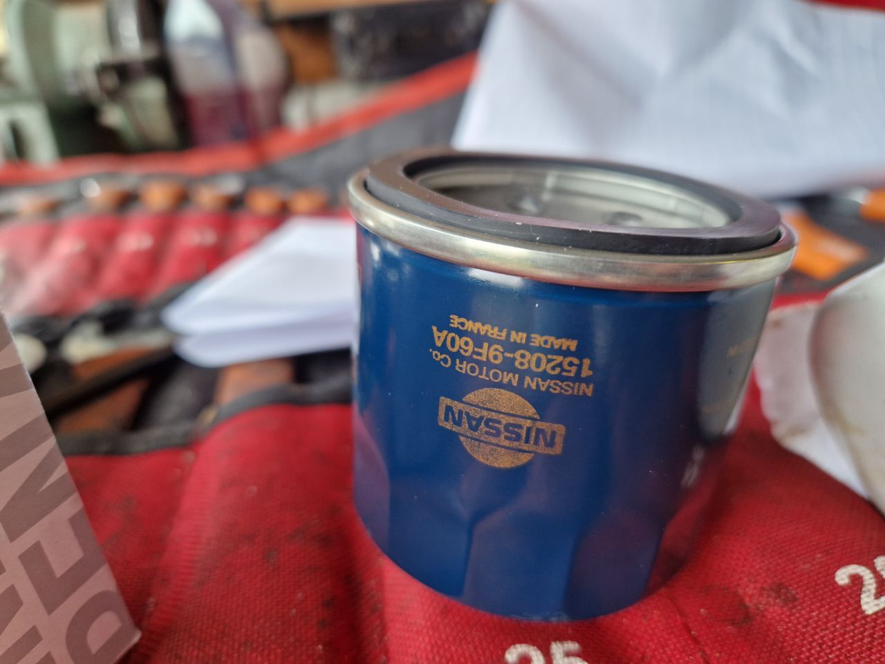

Someone on here told me Purflux was the OEM supplier of the oil filter. Wrong! 20260208_113347.jpg.612a2cf65ecaf72ca77fe1130164ad61.jpg
New filter came from the dealer and was expensive, but I mainly just wanted to ensure it was the correct part. 20260208_113355.jpg.28ce26b0ce7c2d001401f1eba2591149.jpg
Anyway, 20 minutes to do oil and filter, and 45 minutes fucking about with the undertray. Which is some sort of fibre-plastic bullshit that you're supposed to peel back but that was impractical on my drive. It's held in by about 10 bolts and 3 clips but is sandwiched between various bits of bumper and aero trim.
To be fair it's partly my fault for trying to put one of the clips in the bolt holes when I was refitting it but fuxache just use one or the other, not a mixture you twats.
Also my fault: dropping my ratchet in the old oil. Other than that, plain sailing.
  • grogee changed the title to Grogee's spannering (Maestro & Mondeo IV). CAPTUR: BONUS OIL CHANGE
Seems odd self servicing a year old car that’s under manufacturers warranty, I guess you’ve bought outright rather than a PCP or lease deal? I’ve only just moved to Indy servicing on the wife’s Captur last year as its warranty expired.
curious about the air jack, I’ve always been cautious of them, is it any good?
OE filter fitted.
They will never know :)
Belt and braces really. She bought it outright. I'm anticipating it staying around for some time/its lifetime so I'm just making sure it doesn't shit itself later on. It will still get the scheduled services and they'll never know I've been there.
The air jack is OK, not perfect. It's quite large as you can see so not as able to get in tight spots. The open and close valves are easy to mix up if you're not careful. I haven't tried it on my Mondeo yet which is really low, I fear it may not be able to get under without driving onto some sleepers or similar.

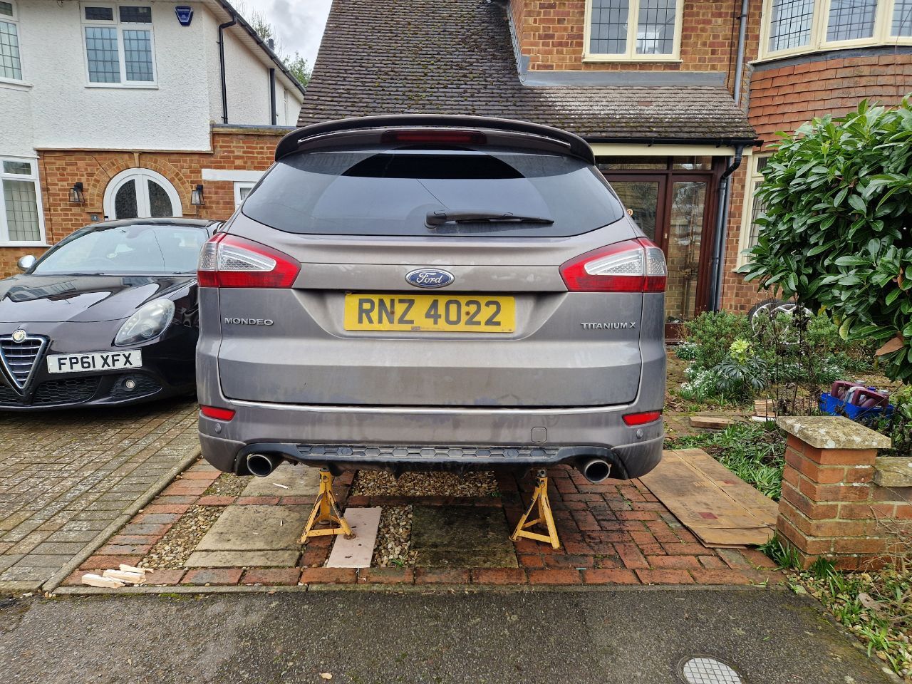

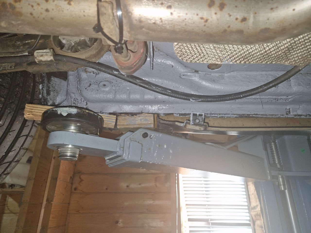

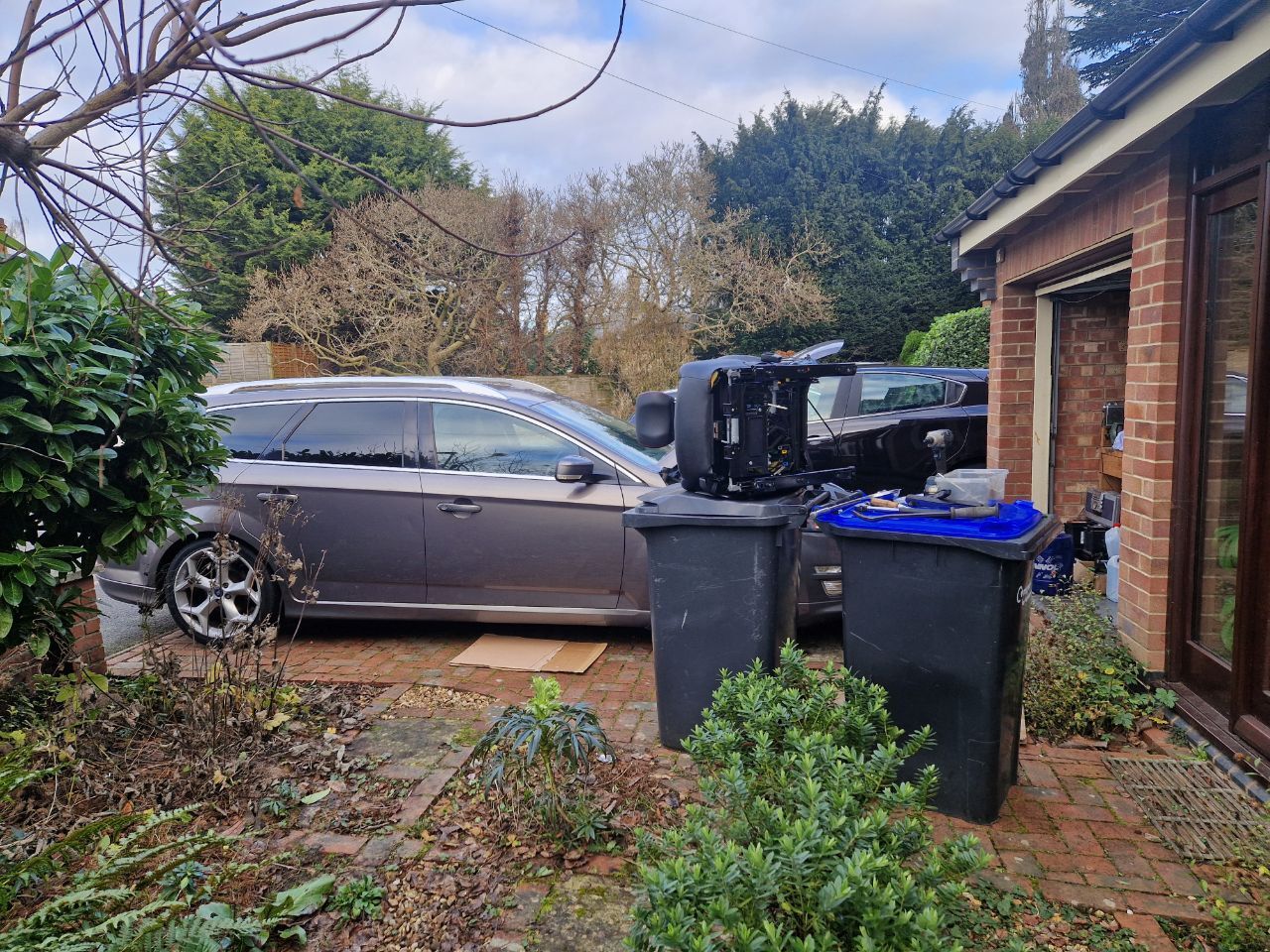

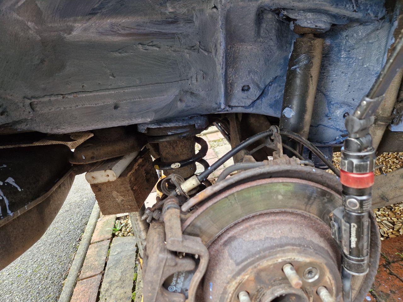

Well I needn't have worried about jacking up the Mondeo. My air jack fitted in nicely with room for a safety block of wood. 20260221_144204.jpg.26621d9aa9ed5aadab13aaee7e17a885.jpg

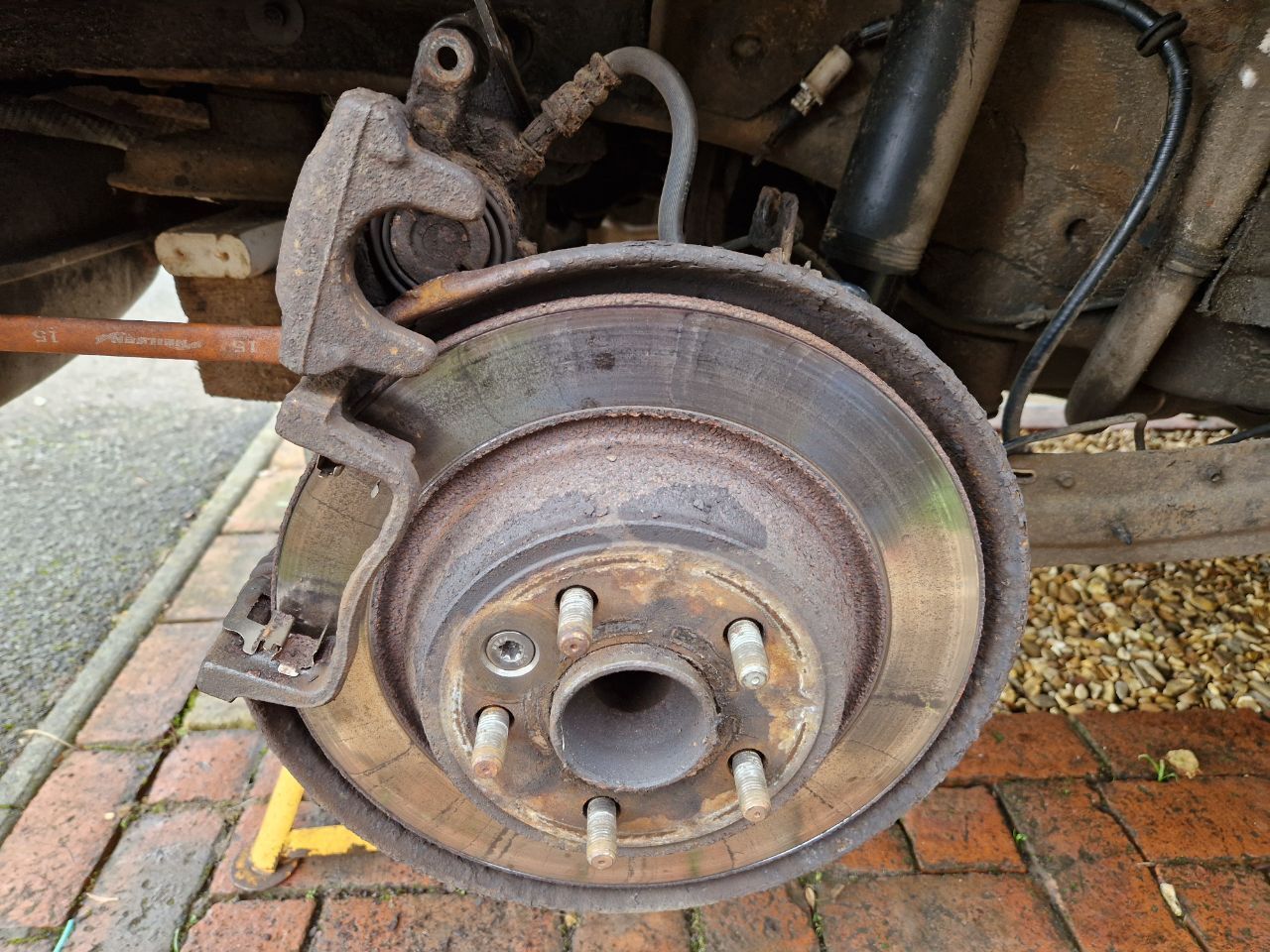

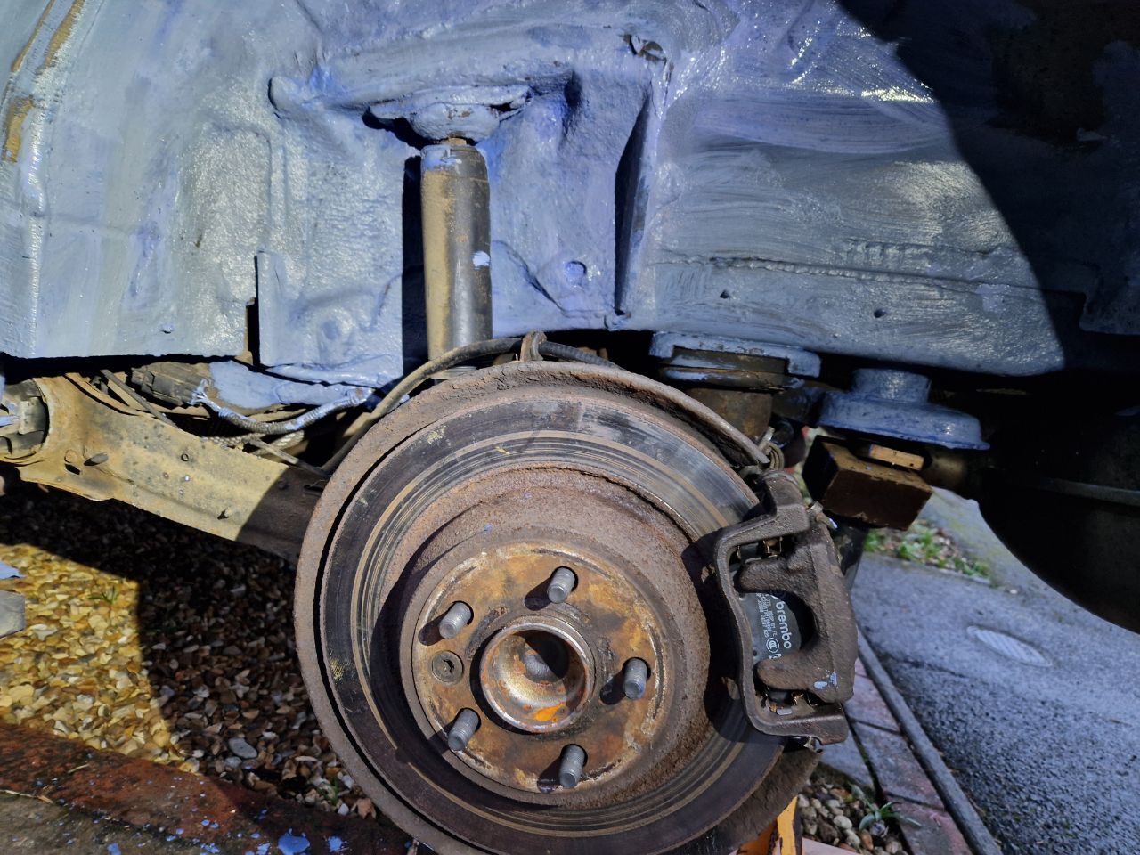

Today's job was rear brake pads. They were an advisory on last mot so I treated it to some Brembos. 20260221_151231.jpg.d177bd9db4fd864b9491547a47ee035c.jpg
I remember doing rear pads on the Avensis that is now @dollywobbler's.
They probably took about an hour including taking the caliper brackets off and cleaning them up.

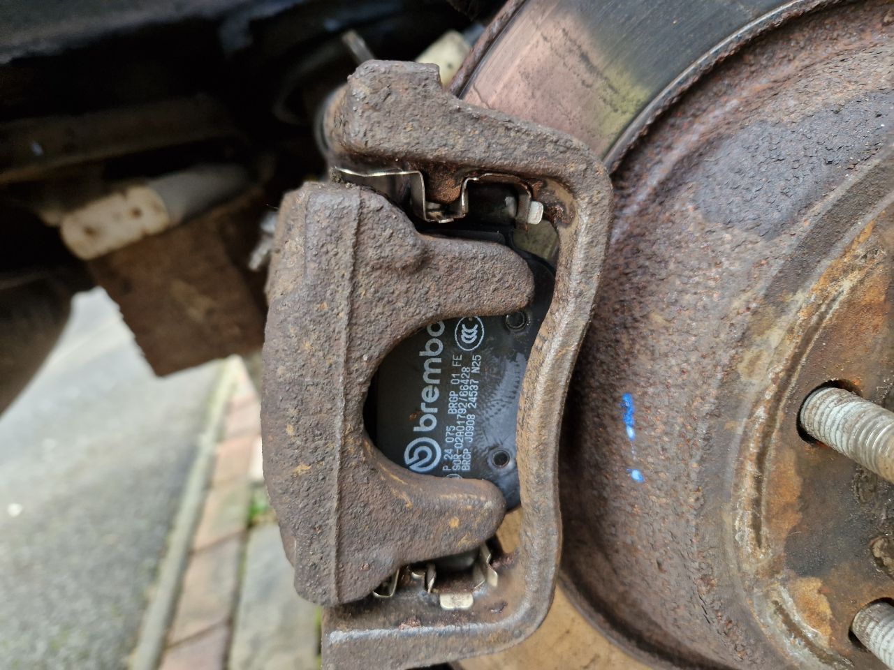

This won't be news to Mondeo owners but they are a bit of a cunt on this car. I'm sure they are easy enough when the car is new but mine is 14 years old now and is as crusty as you'd expect at the back.
In fact that was another advisory item: 'corrosion inner rear wheel arch' although it didn't seem worth mentioning to me. All the same, I wanted to get behind those stupid wheel arch liners which are made from soggy cloth, instead of proper plastic items you get on proper cars. 20260221_172202.jpg.4748d1b3265fd73d0e105cadfcda15ea.jpg20260221_172212.jpg.853a2854d3513f9394524e0ff34b82f6.jpg
Anyway access to each and every bolt for this job is poor for one reason or another, and the bolt heads were all crusted over so I had to spend a while wire wheeling them.
While I was there I pulled about 900ml of old brake fluid out. It was a bit of a gamble because the bleed nipples looked quite far gone, but I doused them in WD then did the old 'tighten first then loosen a fraction' back and forth a few times.

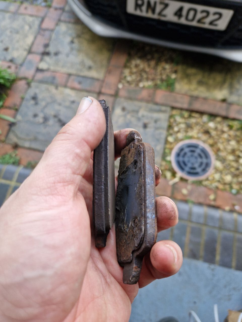

Offside sliders were fine but nearside wasn't, stuck fast. At this point any sensible person goes and buys a caliper bracket from a motor factors, but this is me, plus my car was immobile and there's nowhere in walking distance.
Sliders responded well to a good clean up with wire wheel and a fresh smear of silicone grease.
Of course it rained because this is Britain and we can't have nice things. I ignored it and carried on.
It's got those calipers that need winding back, for which you require about eight hands. I used one of the caliper mounts to hold it still while I worked the tool, which helps. Still a fiddly fucker though because my caliper turning tool has lost one of the pegs that turns the adapter. I really need to weld another one back in. Maybe tomorrow.
It's all back together and I've splashed a load of Vactan in the rear arches. From what I've read, this is supposed to be a one-coat wonder, ie paint and forget, but it feels just like every other rust converter I've used - Shirley it needs some paint over the top of it?
Jobs for near future - handbrake cables both sides. Hopefully mot man will turn a blind eye to the fraying.
At least it's a manual handbrake, and not French-electric.

headlight reflectors: is that a chrome finish? That’ll help. But the projector lenses ‘burn’ and discolour over yrs and the lens themselves are a part of the kits you can buy and make the biggest difference.
subframe rust is common. Oh so common. My front one is pretty good and not a concern, the rear has heavy surface. I’ve decided to renew my rear springs and rear spring cups/arms. In doing so, this replaces 66% of the areas that seem to flag as a corrosion to subframe risk and also gives you brand new adjustable camber bolts to get the alignment dialled in. So something to consider at a later date maybe?
In addition, mine has identical rust on the rear boot floor/wheel well but made worse by my rear heat shield having been removed/binned when the exhaust system was replaced. Many yrs/miles later, i’m now casually looking for a replacement to save half of my spare wheel well surface finish from getting worse.

Thanks for advice @Con2K. I do have a set of lenses and reflectors from CHY-NAH but they went to my Dad's house instead of here, so I haven't fitted them yet.

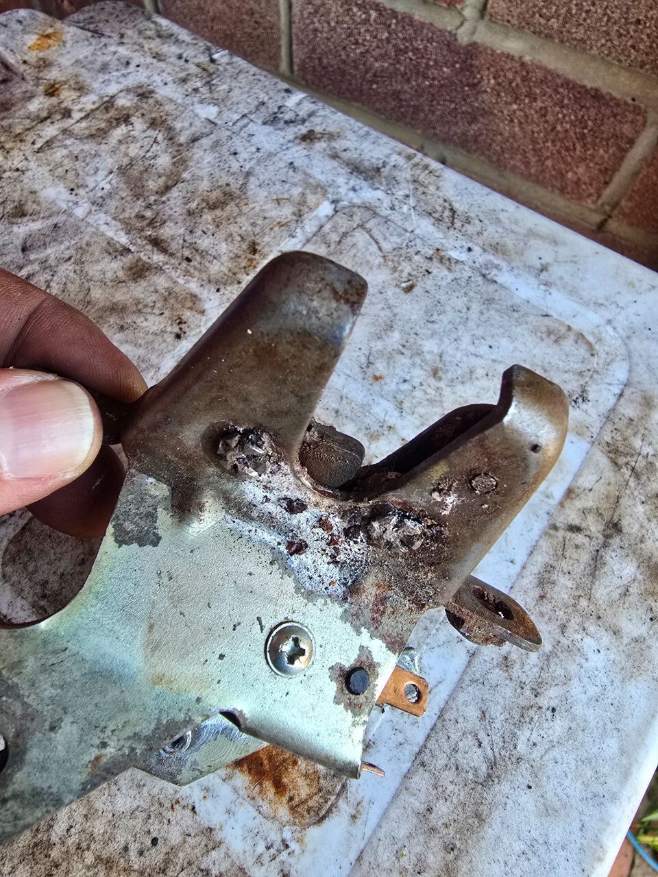

Did a little bit to the Maestro, despite the perishing cold. It's sunny, but not warm.
I don't have masses of time so nothing earth shattering but I did want to get around to fixing the self-opening boot latch.
It's a bit weird as I couldn't get it to pop open with force once I'd latched it shut, but after most journeys the bootlid would be unlatched by the time I got home. I'm guessing some combination of vibration or twisting released it somehow.
I managed to score a NOS one which was a bit of a result, so I set about fitting it. It's noticeable that the old one felt very slack and seemed to have a lot of play. 20260314_165507.jpg.655ba6ea07d10b2a15abbedcd9f0b20f.jpg20260314_165516.jpg.fe16681df062f3ba8bb1d9061ac9e6f7.jpg
Fiddly but not too hard. Seems to work OK but I haven't been for a drive yet.
Instead I jacked it up so that I can get underneath and have a thorough inspection of the underside, with Vactan in hand. 20260314_165522.jpg.23a5ef3d634f9b88e556f55ee8eb84c2.jpg
I also wanted to remove the rear bumper which I bonked last weekend to try and straighten it out. Some plastic surgery will be necessary here, so I've asked for advice on Ask a Shiter pages. 20260314_165545.jpg.546364d845a8a939318786793a13dc5b.jpg20260314_165537.jpg.7188a6ba0da776116f50d163f3ced648.jpg
  • grogee changed the title to Grogee's spannering (Maestro & Mondeo IV). BUMPER WEEKEND
I’ve used builders Gripfil to build strength around plastic parts like that. Does take a day or so to harden, but it’s fixed quite a few bike panels and the top of a caravan gas fire last year.

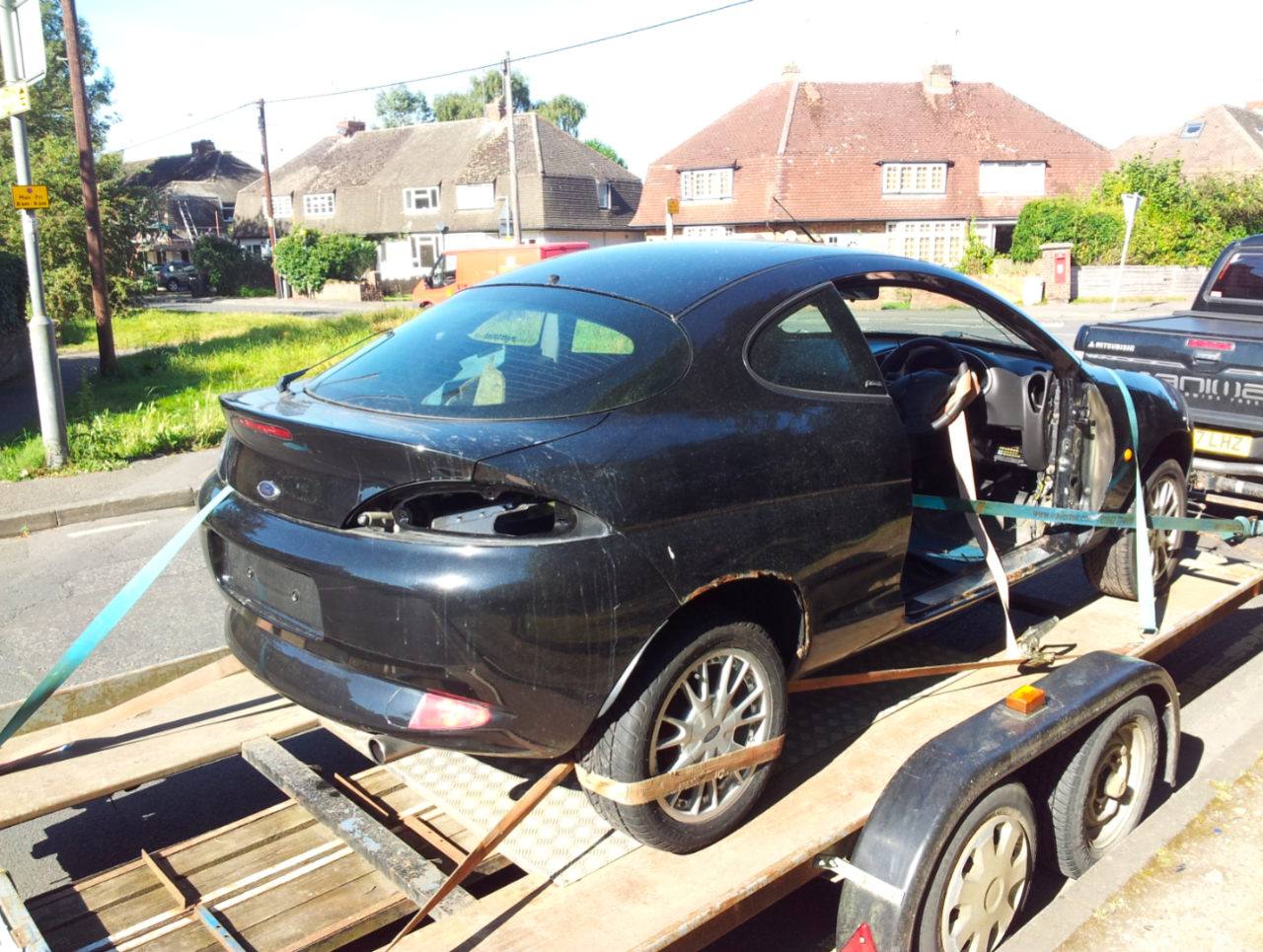

On 22/02/2026 at 16:44, beko1987 said:
I remember on my puma breaking it for spares after the rear arches fell out, pulling the carpet out and finding MASSIVE rust scabs all over the floorpan 😥
Its why my heart sank when I found no boot corners in my qq, had massive flashbacks but luckily the qq was non structural and totally hidden behind the bumper so I could fibreglass it 👌
After the Puma I got my first ZX and that's how I found autoshite back in  2012
