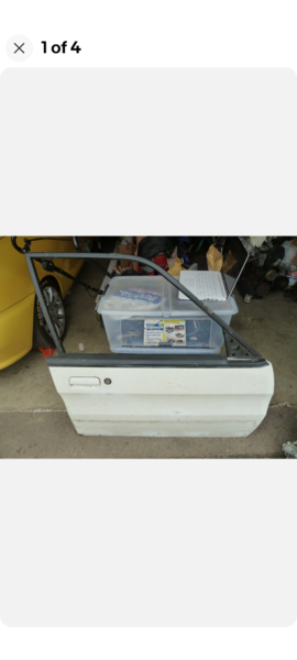

grogee Posted October 5, 2022 Author Posted October 5, 2022 I bought a door. Pricey, but it is in the "right" colour which saves a bit of faff. I don't know what the going rate is but I have to compare to wrong colour + £spraying. Unfortunately it's in Lincs. My stepmum is nearby but we're not due to see her for a few months. Luckily the seller will hang onto it until then. Got a load more bits coming, I think I'll pull headliner out now. The hole in the roof is now sealed with bathroom sealant + duct tape, which as we all know are the most waterproof substances known to man. Underside much improved as well; two coats of zinc primer after the wire wheel and rust converter. Popsicle, Dyslexic Viking, FakeConcern and 1 other 4

Noel Tidybeard Posted October 5, 2022 Posted October 5, 2022 12 hours ago, grogee said: please note a montego door (pictured) is everso slightly different to an maestro door speaker size door moulding below window is held on with pips which are part of door pressing and not present on an maestro rear doors have 3 different window profiles montego loon montego estate maestro plus the above moulding shenanigans Tenmil Socket and grogee 1 1
High Jetter Posted October 5, 2022 Posted October 5, 2022 29 minutes ago, Noel Tidybeard said: please note a montego door (pictured) is everso slightly different to an maestro door speaker size door moulding below window is held on with pips which are part of door pressing and not present on an maestro rear doors have 3 different window profiles montego loon montego estate maestro plus the above moulding shenanigans Anarok! Moar detail needed. grogee and Noel Tidybeard 2
grogee Posted October 6, 2022 Author Posted October 6, 2022 9 hours ago, Noel Tidybeard said: please note a montego door (pictured) is everso slightly different to an maestro door speaker size door moulding below window is held on with pips which are part of door pressing and not present on an maestro rear doors have 3 different window profiles montego loon montego estate maestro plus the above moulding shenanigans Right you are. She be reet. I'll bodge out the speaker hole on passenger door to accommodate a pair of matching speakers as my OCD can't deal with an unmatched pair. The door moulding shouldn't matter if they look the same externally. I also want more anorak detail including the names of the fitters on the Cowley line and what they ate in the canteen.
Noel Tidybeard Posted October 6, 2022 Posted October 6, 2022 1 hour ago, grogee said: Right you are. She be reet. I'll bodge out the speaker hole on passenger door to accommodate a pair of matching speakers as my OCD can't deal with an unmatched pair. The door moulding shouldn't matter if they look the same externally. I also want more anorak detail including the names of the fitters on the Cowley line and what they ate in the canteen. the maestro doesn't have the door moulding just a simple widow rubber maestro had 10cm speakers montego 13cm Derek, Bill, Dave & Colin and it was egg & chips cos it was Thursday! 🤪🤣 grogee 1
grogee Posted October 6, 2022 Author Posted October 6, 2022 6 hours ago, Noel Tidybeard said: the maestro doesn't have the door moulding just a simple widow rubber maestro had 10cm speakers montego 13cm Derek, Bill, Dave & Colin and it was egg & chips cos it was Thursday! 🤪🤣 Right so can I remove the simple window rubber from the existing Maestro door, and replace the Montego moulding with it???

Noel Tidybeard Posted October 6, 2022 Posted October 6, 2022 if you take this bit off you will find metal "pips" along here but the maestro rubber should fit grogee 1
