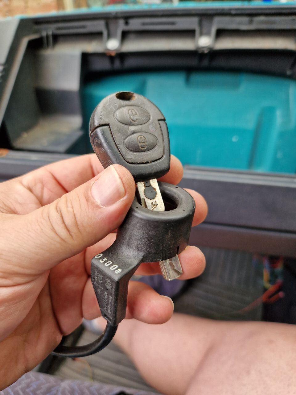

grogee Posted June 7 Author Posted June 7 Skoda investigating. Pulled out the glovebox to see if it was indeed the immobiliser I'd spotted while faffing away earlier to find a switched +12v for the stereo. Indeed it was, tucked behind the dash held on by self tappers. Initially I began testing the wires to find a feed for the spoof immobiliser signal box I've got ordered. But had a head scratching moment when I couldn't find an earth for it... WTF? Then found the smoking gun! An earth ring terminal floating around in mid air, not attached to anything. When I'd reattached the dash last time, I didn't hook this into the dashboard mounting screw. For proof of concept I hooked it directly to battery -ve then started the car... IT LIVES!!! I didn't like the original earth point which showed too much resistance to ground in my opinion, so I tapped another one off the cigarette lighter and attached it to the original earth ring terminal. I just need to re-heat shrink some of the wiring I'd been testing last week, then we're back to normal. Works can continue, eg stereo improvements and engine steady. Dave_Q, Surface Rust, wesacosa and 28 others 14 17
IronStar Posted June 7 Posted June 7 I love how it’s not just an immobilizer chip but a whole bloody key! 😆 Great work on sorting it out! grogee, LightBulbFun, AnnoyingPentium and 4 others 1 6
