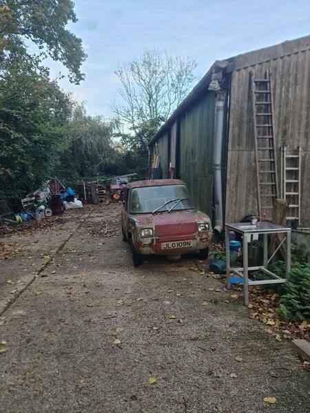

Have you seen this photo of it in happier times?
Oooh! very much looking forward to seeing more on this!
I do like an Enfield 8000 :) (and any sort Shite electric vehicle in general to be fair!)
3 hours ago, Dick Longbridge said:
Wow, another one! Great to see and kudos for biting the bullet with it.
Yup and here's another as well that @Will on Syrossent me a while back :)

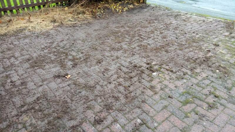

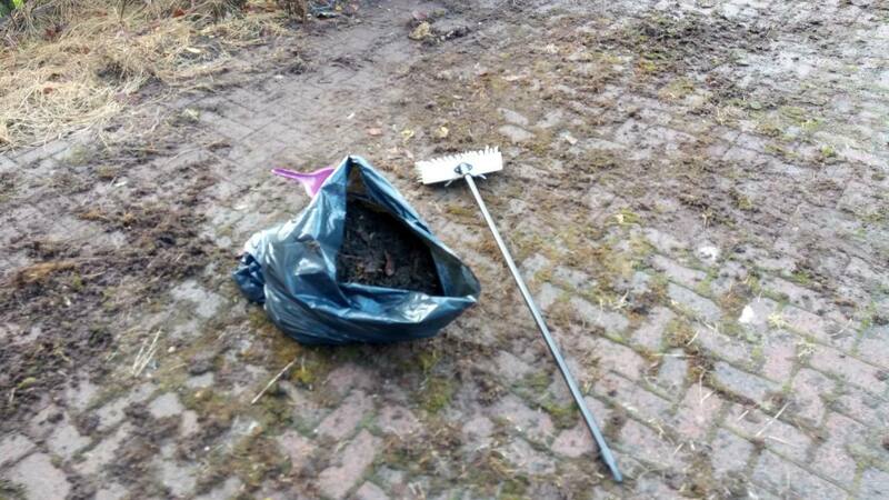

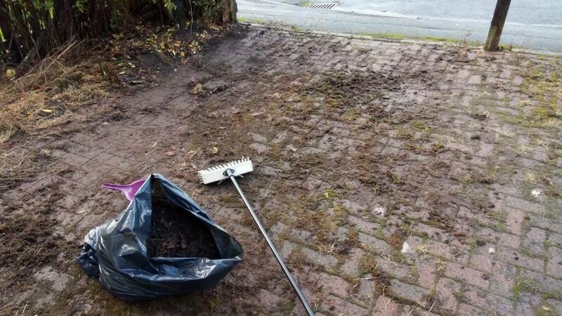

Two bin liners full of dirt and detritus from the wind and rain, as well as its necessary to go over the drive again with the non-toxic weedkiller stuff I got from QVC a while back. Either way, she'll be here by about 11am and there is, in effect, my workspace for the next few months. The other side where there is still moss is technically that of my upstairs neighbour, and as a courtesy and to complete the task I will go over that as well.  At least it isn't all of a sudden "OMG! SLIPPY!" like it was last night when I almost fell on my rear whilst holding my next door neighbour's cat to take him home. That would not have ended well for me. At all. *ahem*
Anyway, the next post will be of the car herself. :)

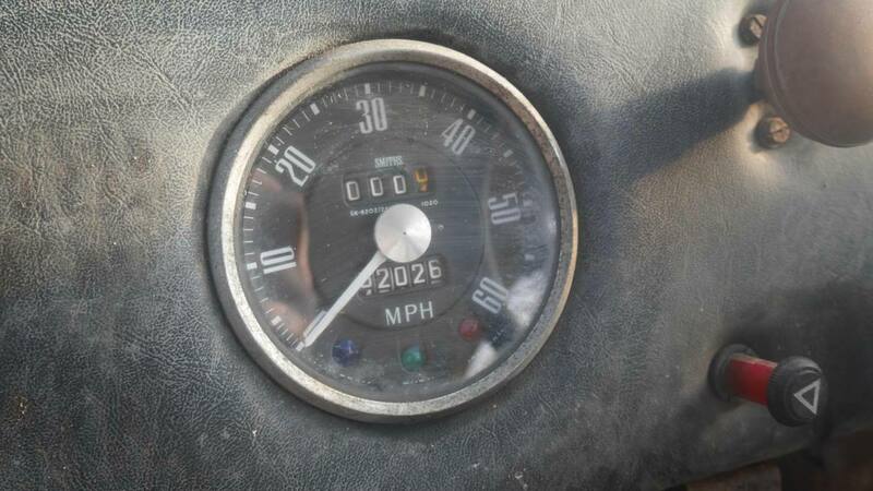

The car is here, arrived at 10:55 or so. Hopefully my mobile recorded the car being moved on to my drive...I'll find out later. I'm having a much needed orange juice break after hefting in all the interior items (including the motor, which the courier helped me with getting on to the drive...and after he went I rotated the motor full boost vertical and edged it inside bit by bit. It's now in horizontal flight in the lobby.  Most of the window glass is present, sans one half of the driver side window and I've wrapped the loose windows in much bubblewrap and placed out of harms way.  I even managed to get the keys out of the ignition and open the passenger door.
Once I've made the windscreen cover (because I cannot be any more paranoid about that windscreen being damaged than I am now), I'll go and borrow the tarpaulins that my neighbour kindly offered.
Photos and video(s) to follow...

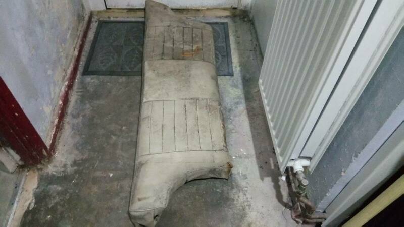

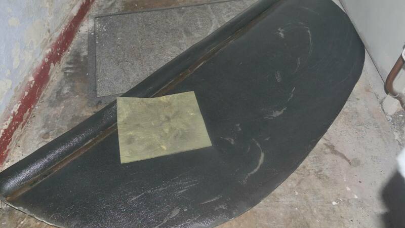

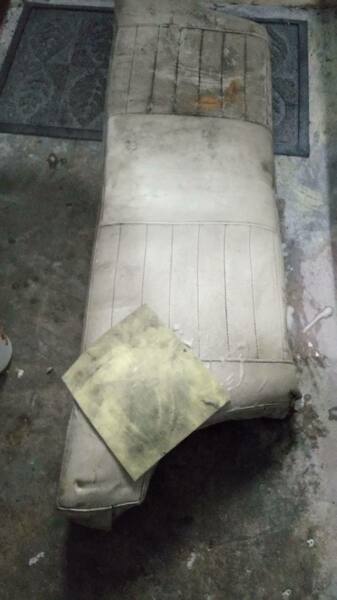

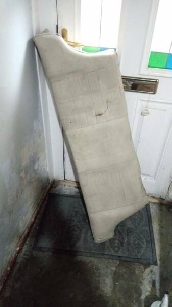

I was saving these photos for a bigger post, but this is supposed to be a moment to moment thread so here goes:-

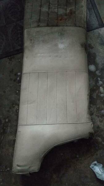

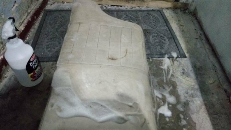

Before any cleaning of the bench seat:-

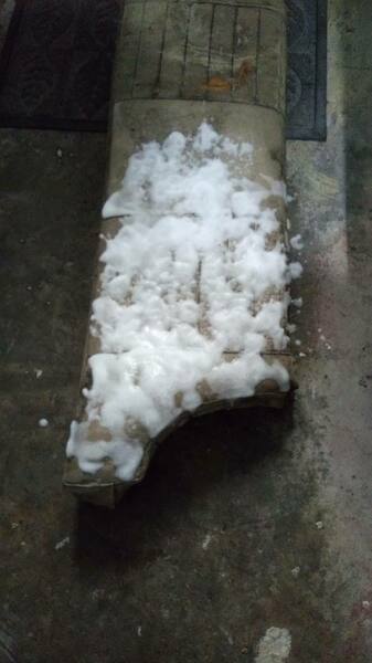

Demon upholstery cleaner sprayed on, then rubbed in.
First pass complete and that was a brand new clean sponge microfibre cloth:-
Second pass complete and comparison:-
Upper section with foam applied, rubbed in, and being washed off:-
First stage of cleaning completed:-
This really signifies what this restoration is going to be. Mostly general DIY, cleaning, and elbow grease with some real engineering later on. All of the interior is in a poor state (dare I say shocking? :P ) and all will need a further clean and pieces of new leather that are easily obtainable and cheap. There's an independent fabric shop in the town I live, a specialist leatherworker, and plenty of farms that sell leather to the public.  The foam will no doubt need a deep clean/replacement, however I'm looking to save as much material as possible both for originality and keeping down the costs. I also noted that the leather went from feeling like it would crack and fall to pieces at the slightest touch to being flexible again. I have some leather upholstery wipes somewhere in my flat, so once I've gone over this again with the detailing brushes that arrived this afternoon, it should look even better!
Also, the Demon cleaner only cost £5 at Halfords in July. B&M now have it for £1.50, but I'd think that would only be in bigger stores and whilst stocks lasted. For a cheap potion it does quite nicely and the linen smell isn't powerful once it's washed off with a damp cloth.

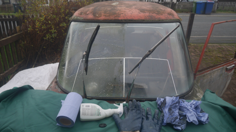

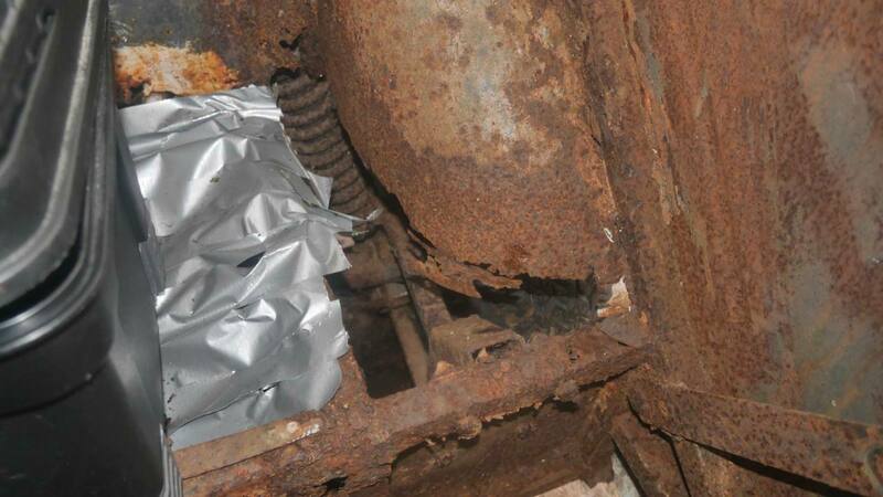

With the wind and rain having largely subsided yesterday, I got to make a start with the rust treatment when it was fairly dry and not blowing a gale.  I found an old bottle of Baufix oil spray stuff that allegedly is a rust remover and to be fair, it done well for just a few moments of soaking in and the plastic straw having long since disappeared. Right now, I only have mini brushes and bigger brushes for my drill (which I'll try out later on today - that being Tuesday the 9th) and my home prepared citric acid solution (which will be 1 part citric acid, 5 parts hot water in a spray bottle). I did record a video and that will be forthcoming when I've recorded more footage later.
The Bilt Hamber Deox-gel is the product I want and that will be bought but not right now, as money had to be redirected elsewhere as per usual. Also, the more I work on the car? The more I think of cutting the bad metal out and completely building anew piece by piece. *breathes* Less speed, more haste!
I did get to chat with Jonny Smith at The Late Brake Show tour in Manchester on Saturday, which was extremely helpful and informative. I even got a fist bump for my endeavours and that kind of real world validation goes a long way! :)
Anyway, I noticed that the tea shelf (as Furious Driving calls it) is held in place only by friction. I was able to safely remove it and I'll be able to clean the vinyl (could be leather, doesn't feel like leather right now though) in the warmth. It did allow me to take a couple of photos of the electronics...firstly, behind the steering wheel:-

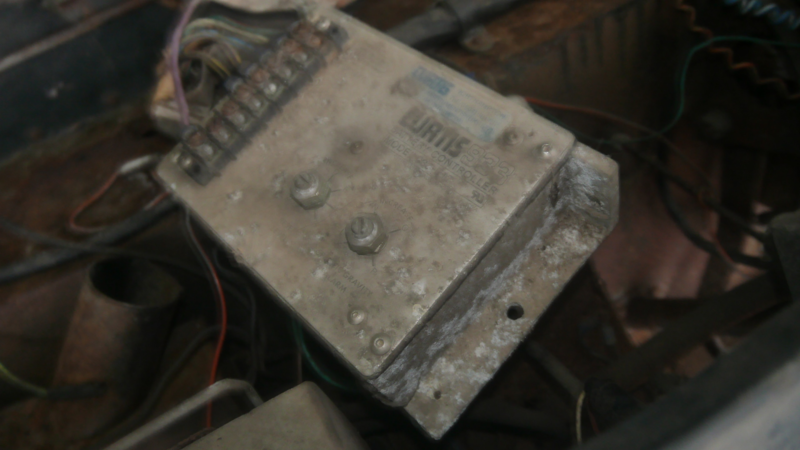

And the Curtis 933 battery controller, the manual of which was chuffing easy to find and despite typos is very straightforward and informative. :)

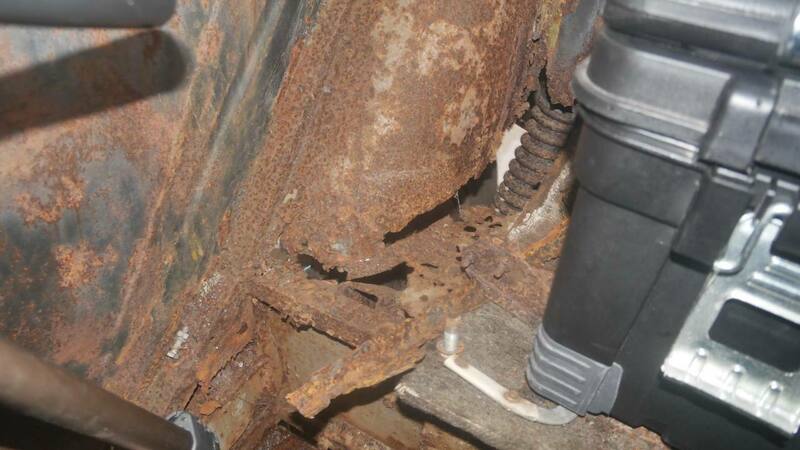

As for the metal work, it may be a better idea to use rust restorer on both sides and give it a coating of primer. Especially as by the end of the session, it had started to rain again.

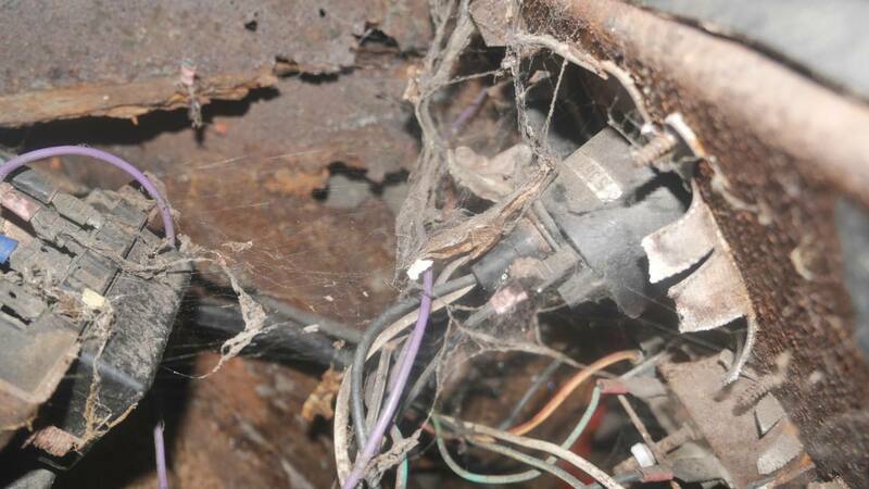

I have successfully removed the Curtis 933 controller and the DC-DC converter that I seriously doubt is standard. Another detail is what I thought was the watt hours meter is actually a kilowatt hours used meter- I didn't see the full display until this morning.  The last total then was 5,562kwh consumed and the odometer tells me the car has done 32,026 miles. Little details that matter. As do the many photos I taken of the wiring which I'm all for completely replacing wholesale. Grumpy Pigeon is grumpy!

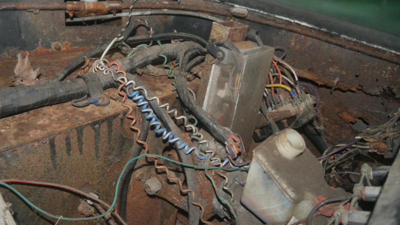

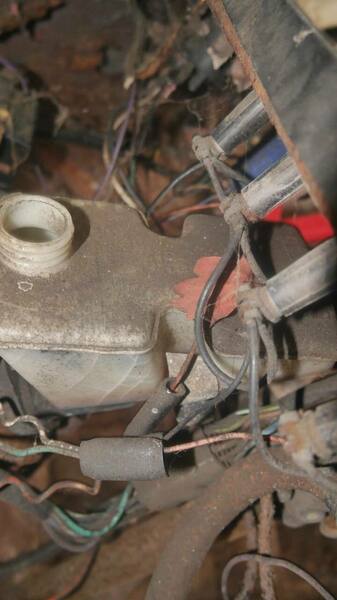

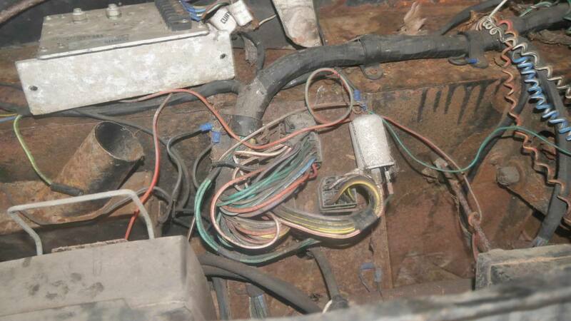

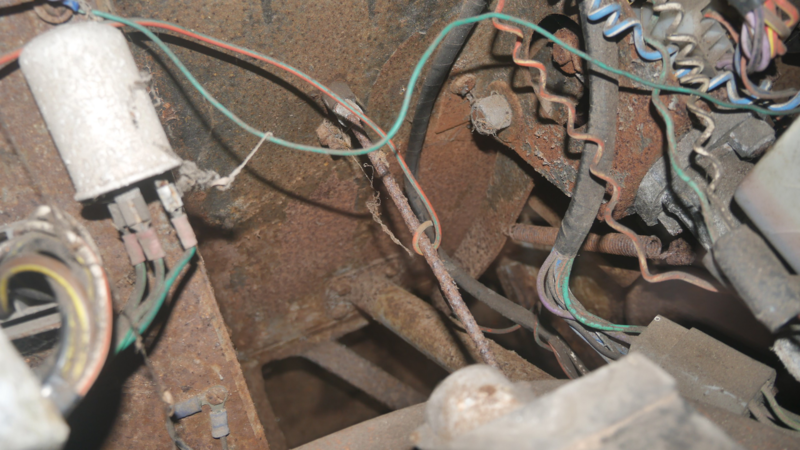

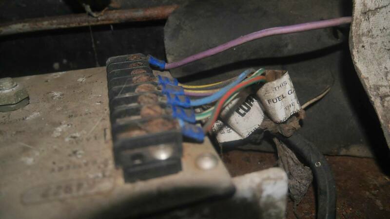

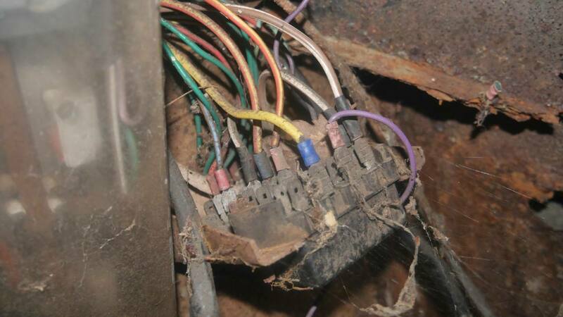

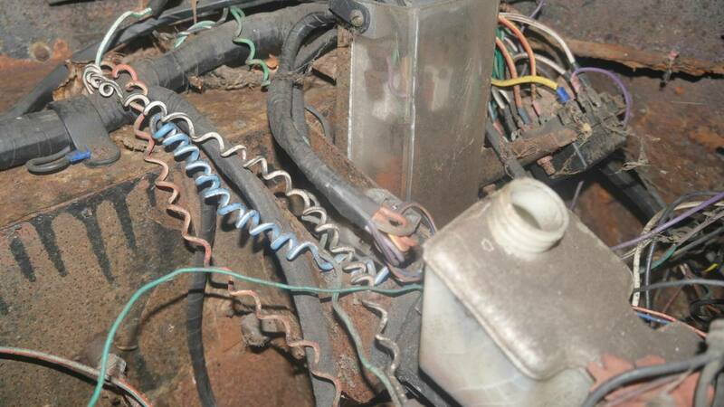

The wiring loom. The screws in the clips had rusted and with the slightest of messing around the clips came off with without any persuasion. I've sprayed some of that multi-purpose spray where the plugs are as they were difficult to pull out otherwise.
The curly wiring is for the light bulbs behind the dash, the wiring in the background is for the instrumentation such as the charge meter, and the fibreglass hinged lid IIRC contains the accelerator microswitches. I have the wiring diagrams as all good E8000 owners should have downloaded, it occurs to print them off so I can translate it to the real world and memorise it properly.  I've just noticed that the cracking can clearly be seen in the brake fluid reservoir. An additional image
Speaking of the heater, the black with white cross wire goes to the heating element in the windscreen and the metal pipe running through the middle of the photo is connected to the windscreen wash pump and spray jets. The piping as far as I can tell should run underneath the bottom rubber lip of the windscreen, the pump and piping will be removed and replaced outright (just moving about the wiring and the piping was flaking off from its holding position).
It occurs that whilst removing the dashboard etc is required, I may be better off approaching this with the panels removed and the front battery compartment also potentially being removed just to gain access. I'd go from underneath but that requires the passenger side to be strong enough to support being jacked up and that won't happen for a little while yet. There is a mild panic and worry, however I realise that if worse comes to worse then I'll just have to rebuild with new metal and replace the old in sections. Ways and means and all that.
P1070969-lo.thumb.JPG.d35df152afffa04efdc8c42e388832dc.JPGP1070970-lo.thumb.JPG.bb43915ccc6955d53611c8894bff8250.JPG
So yes, this could be just as it was or it has degraded even further. Having just this moment checked my video footage it seems to be just as it was or with minimal degradation given the circumstances. That toolbox is plenty heavy too, not exactly the weight of an adult admittedly but it the car didn't just deteriorate instantly. The car does take my weight when I'm sat in the middle in between where the seats would be...understandably I still worry.
Here's the safety close-up of the Curtis controller whilst it was attached:-
P1070963-lo.thumb.JPG.1f5872e65a33d6c3af74ebbb224574c6.JPGP1070962-lo.thumb.JPG.3bdedf0783a8439cbf0ba342b54b0e38.JPG
All the screws are rusted as can be, yet they came out willingly with the exception of the last two that had rusted beyond help. As the wiring will only be replaced anyway, I pulled off the last two with pliers. It didn't take much either as the copper essentially turned to dust. My logic for keeping the wiring intact is to be able to copy it like-for-like with new wiring without having to just rely on the wiring diagrams.
On the right is a strong and daunting reminder of the wiring work ahead. Yuk!
Above left: Behind the steering wheel, the cobwebs have been since removed. Above right: clearer view of where the lights behind the dashboard go. Detritus since removed. :)

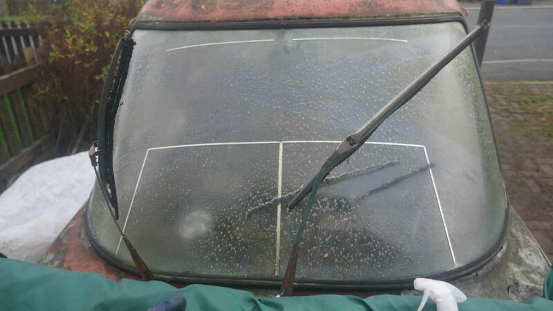

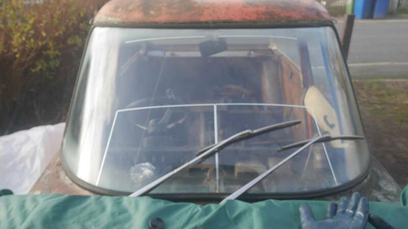

After I finished for the day with cleaning the inside steel that I could get to, I decided to give the old girl's windscreen a good clean. :)P1080008.thumb.JPG.dadbf8d7acb74ed82ccacd49f150636b.JPG
And whilst I cleaned the inside of the windscreen for the sake of completeness, I also gave the speedometer cover a quick clean :) (having a senior moment, can't remember if its glass or plastic!)
