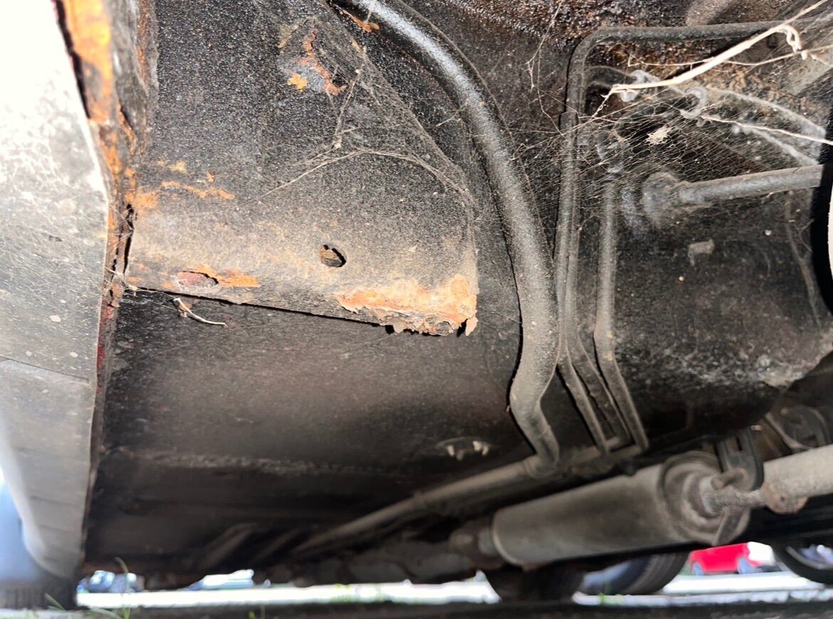

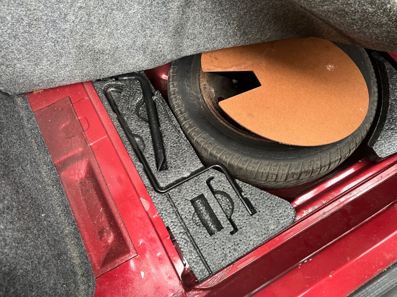

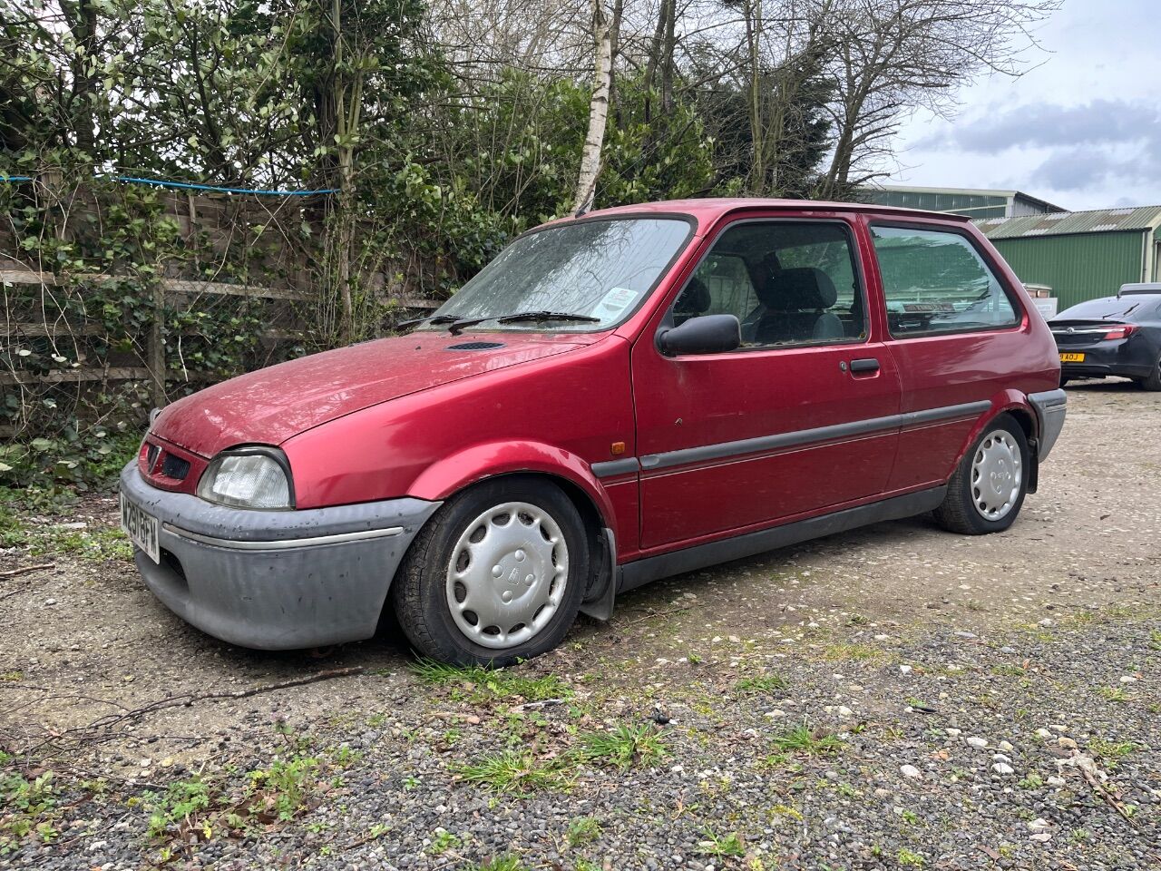

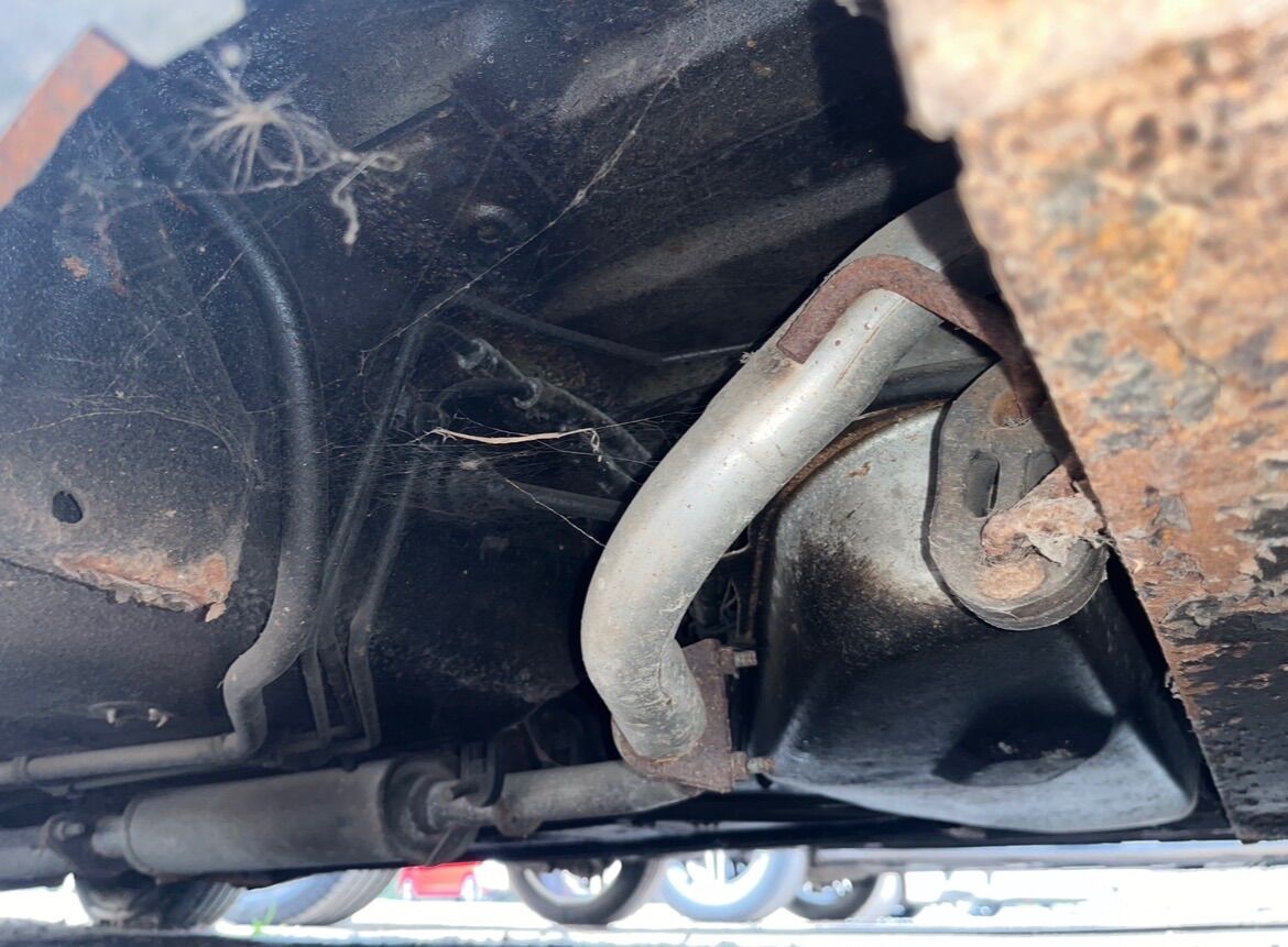

Big update, I’ve only gone and got it! The Metro/100 is confirmed. I was incredible lucky and I’m very grateful that I got given this car by my boss. He gave me the keys and I’m now waiting on the paperwork and some other bits. Overall I’ll be honest it’s not that bad I was expecting worse underneath but the rust only seems to be at the rear arches and sills. There’s other mechanical jobs that need doing. Headgasket for one and Suspension etc but that’s all doable.  I’ll probably do this alongside my Triumph. It’ll more thank likely be a shorter and simpler project to get back on the road which is nice. It does turn over and fire up but does die after a couple seconds so that needs investigating first before anything. Oh and also a good wash! IMG_0377.jpeg.598b1e21e0ec6c00701d16d7a4ca7771.jpegIMG_0374.jpeg.c09bb0a709ecb81e14e7c098a06105eb.jpegIMG_0376.jpeg.e35b63aca399bf16bfeb059ff32ff0a4.jpegIMG_0375.jpeg.ece112f60571b794ca07f8332f378342.jpegIMG_0369.jpeg.356374f1fb12e815684544ac2d620512.jpegIMG_0366.jpeg.0997d903812a784413efcc55b8533d43.jpegIMG_0390.jpeg.209bb389127cf3b53c780cc541340334.jpegIMG_0354.jpeg.6c593deb51dc822d317c03353a794841.jpegIMG_0385.jpeg.7e79b2c40b5480cd8ce1cd8e171831f9.jpegIMG_0386.jpeg.1e4b94f17edbd88fa9381367bd4ddbe3.jpegIMG_0387.jpeg.b7ad569e4e31612f39ccd6d89f4bbf52.jpegIMG_0391.jpeg.bb125cd18e01cf6d12a7aa9f580d85aa.jpegIMG_0388.jpeg.1384a5b6f5ae9f340e3e8fe6b80a00bf.jpegIMG_0389.jpeg.e27041ffc6f14c114c30dd61840f2d7b.jpeg

The way it sits suggests inflation is needed

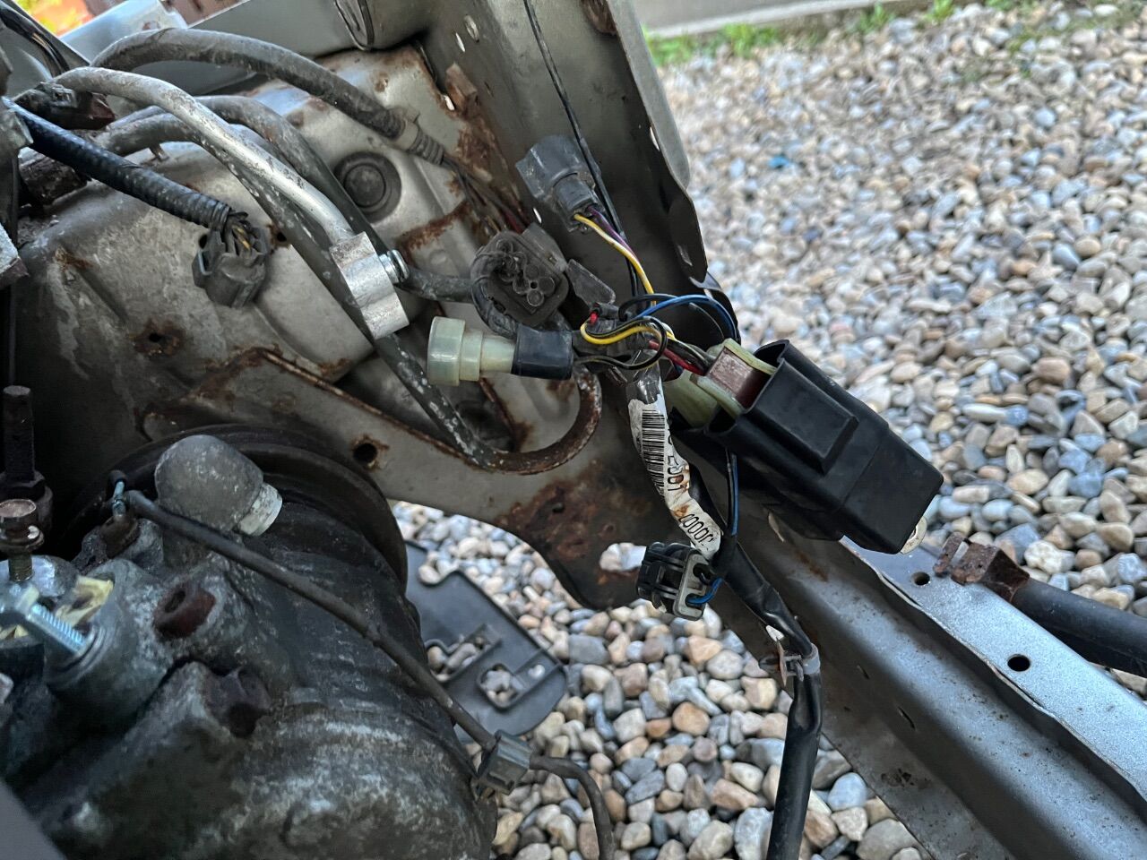

Hi Guys another Update on the Honda, Ive been buy gathering bits for the Engine bay, I got myself some Wrinkle Paint, New Dome Nuts, Washers and Gaskets for the Rocker Cover as it was in Major need of a Refurbish. I got some paint stripper, removed the old paint, sanded it down, degreased and painted. Im honestly shocked how well it came out considering ive never used the stuff before.
I do plan on getting other parts sorted in the engine bay, ideally new Bolts, Brackets need to be painted, Ideally i want to repaint the slam panel and front section behind the bumper and get a new Radiator and Condenser at some point.
I really want to try and transform this engine bay the best i can. Ideally id love to remove the engine and paint the block but its a lot of work.

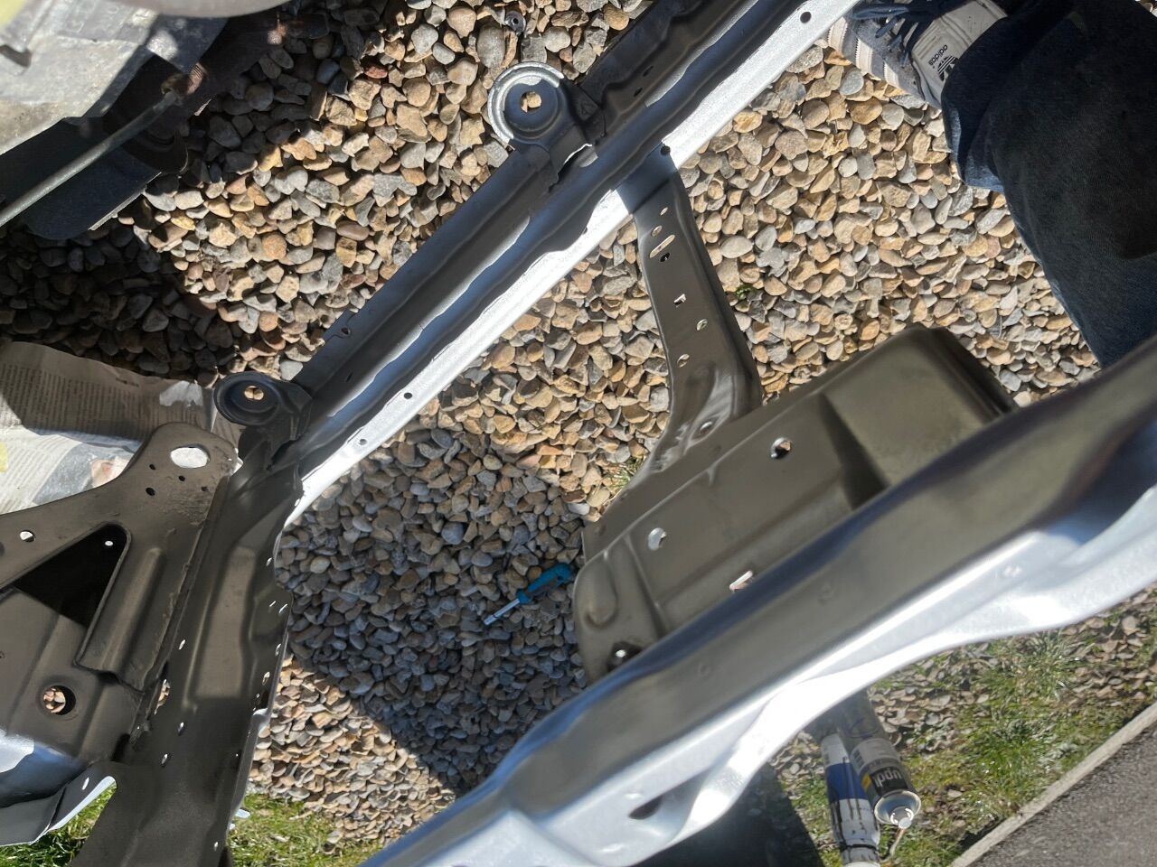

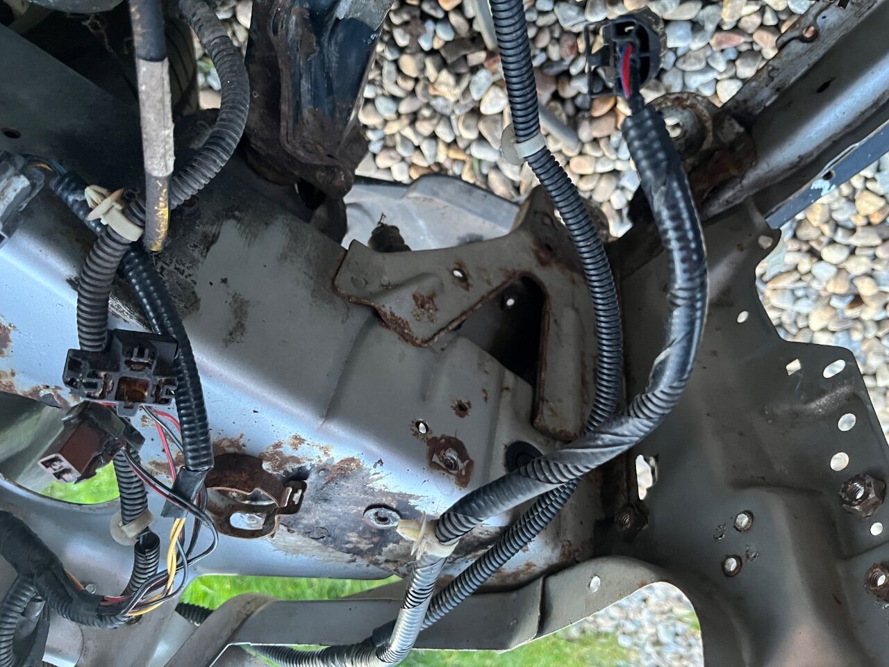

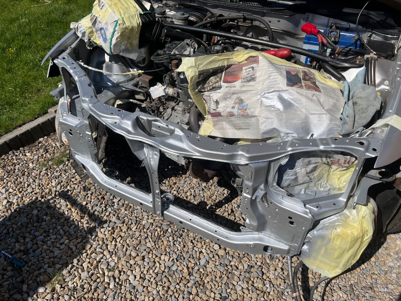

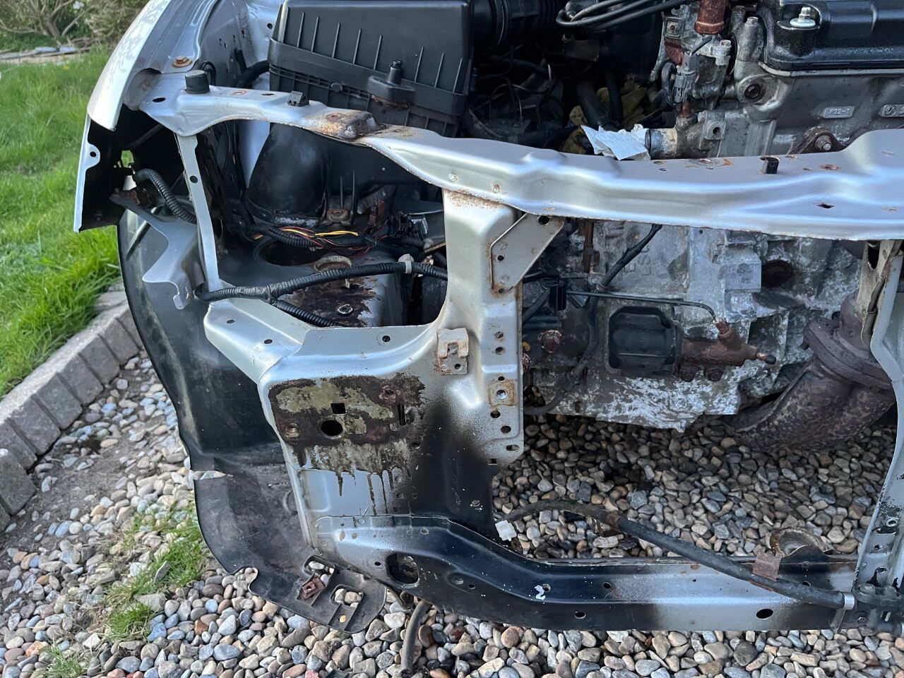

Hello guys new Civic update, ive been busy after work and whenever i get chance, stripping down the front end of the Civic to get it all refurbished. I’m painting the front slam panel and crash bar alongside fitting new stainless bolts and a new radiator and condenser. Really looking forward as this will improve the front end dramatically. Still however I would love to get the engine all painted too but maybe that’s for another day

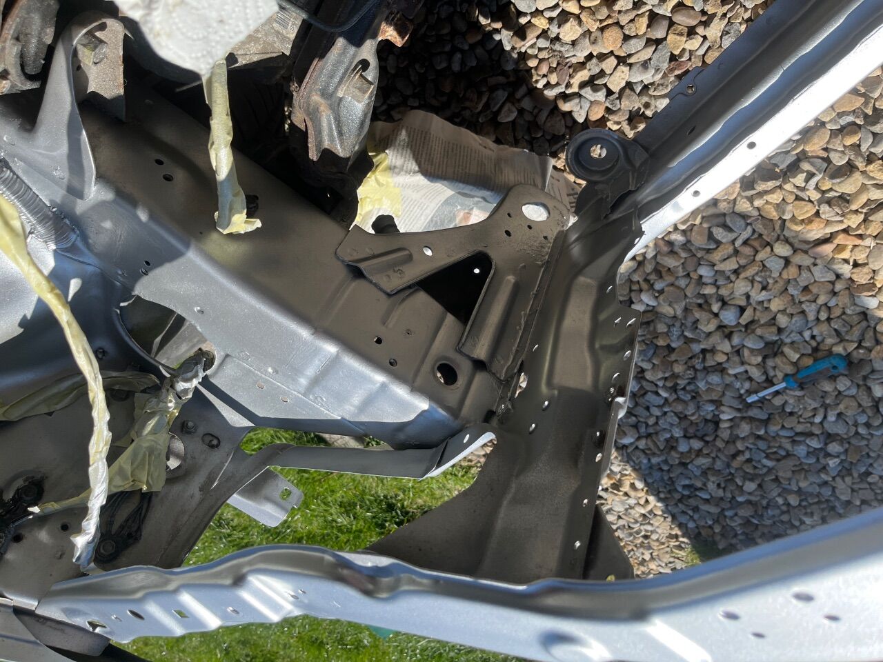

No ideas why some of the photos decided to be upside down but anyways, the front end is all fully painted and put back together now. Here’s some photos of the work carried out. All the rust was stripped back and hydrate 80 applied followed by some grey primer then base then lacquer. New Radiator and Condenser installed alongside new stainless steel bolts and refurbished brackets. Even did the bonnet latch! Extremely happy with this. Just need to slowly but surely do other things under the bonnet to make it even tidier. I’d love to remove the engine to paint the block but that’s for the future I think. I don’t think this car will ever truly be finished, there’s always something to make better on it but that’s all apart of the fun!
