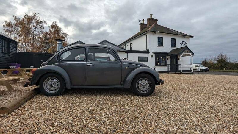

The Beetle had a good run out with a few friends to the new Caffeine and Machine venue near Millbrook proving ground. It's new alternator and properly tensioned auxiliary belt behaved properly and I enjoyed having Bluetooth audio. It's properly cold when it's -1C and you have no heater though.
Nice!  That’s about 10 minutes from my house!
Looking at your picture here…
You’ve got a hose missing from the air filter, next to the red one in the middle.
There’s a colossal sender next to the oil pressure switch below the distributor, what’s it for?
Keep an eye on gaps in the engine tinware especially above the silencer.  The engine bay should be completely sealed so the fan draws in cool air from the slots below the rear window and on the engine lid, not pulling in warm air over the exhaust.
I don’t have much experience with Mexican Beetles but the German ones had alternators from about 1974, does your engine number say it’s original to the car?
As for performance, lots of the piston & cylinder rebuild kits were low compression so they’d be suitable for camper vans too.  That means about 45bhp instead of the throbbing 50😀. Possible that your engine has had this at some point.
I’ve found that a decent 1500 or 1600 is quick enough for anything other than long hills at 50+ mph when they struggle.  My last Beetle had a carefully built 1641cc kit with two twin Webers and nice breathing on the heads.  It did 0-60 in under 10 seconds which is fairly speedy in an ancient car.

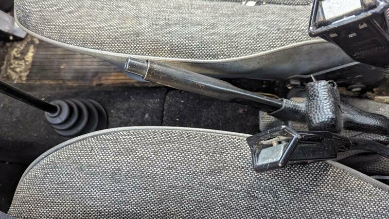

First off I sorted the handbrake lever. The handbrake was working but the button was stuck so it wasn't holding the handbrake. I stripped the handbrake down and found the handbrake lever itself had bent and wasn't holding the button and rod in place inside the lever. A quick clamp in the vice and I have a handbrake!

IMG_2692.thumb.jpeg.ffc4e691721524cc8f046946a6a7cfd0.jpegAlso note the missing Z-bar. That hole should support the end of a torsion-spring, a bit like an anti-roll bar but in fact the exact opposite, as it stiffens the rear up without making it resist roll.
Why did the lever bend? Just not man enough and it'll do it again or side impacted somehow?
Does it need strengthening at all?
Not seen it happen on the 2 I had years ago -  colour me intrigued
I didn't even know that was a thing! Not sure why it would be missing but given the age of the car anything could have happened to it.
The metal folding/pressing in the handle had spread out so the rod for the button was free to slip past the hook if acts on. I'm guessing sideways force probably caused it to spread. I clamped it up with some grips and it doesn't slip out now

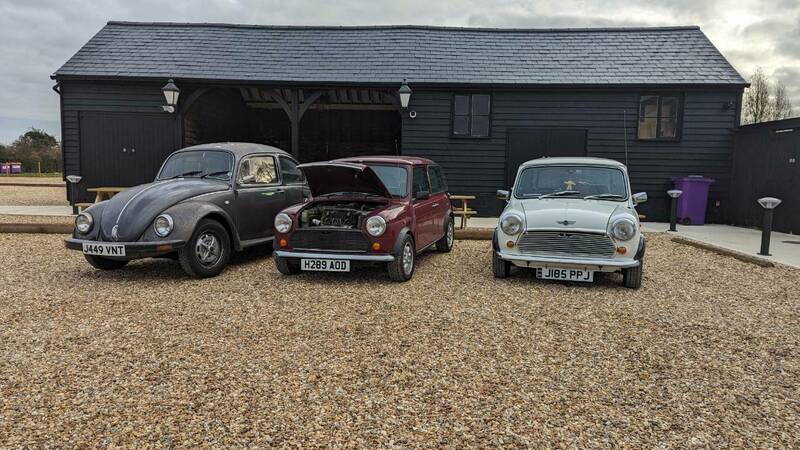

Took the Beetle to a breakfast meet. Parked next to its great-great-grandson. It's nice to have a handbrake!
