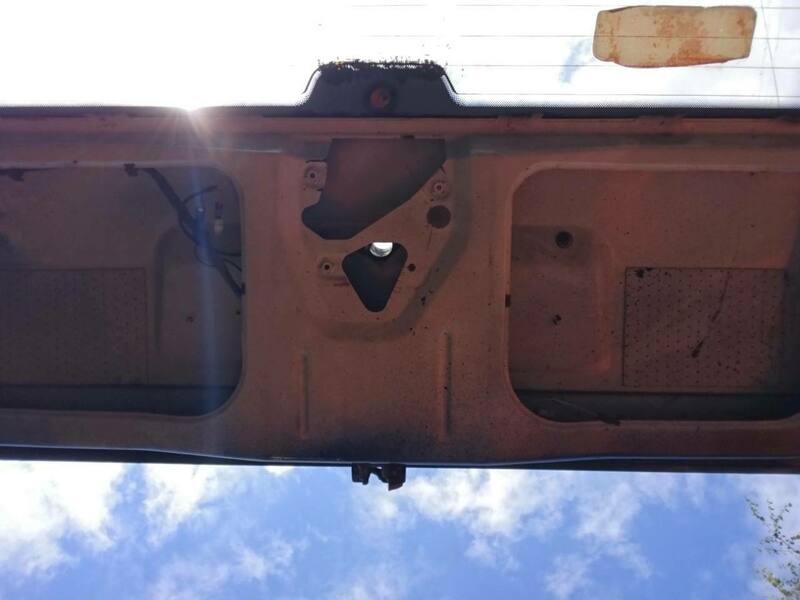

Working from home has its advantages for a lunchtime tinkering. A replacement boot lock has been fitted! I suspect the original is seized as the key design is the same as the one for the doors. Not sure though, BL did like to use multiple keys. Regardless I'm not too worried about a different key for the boot.
No rear speakers here thank you very much. Oh and a Cork shoved in a hole instead of a rear wiper motor.
