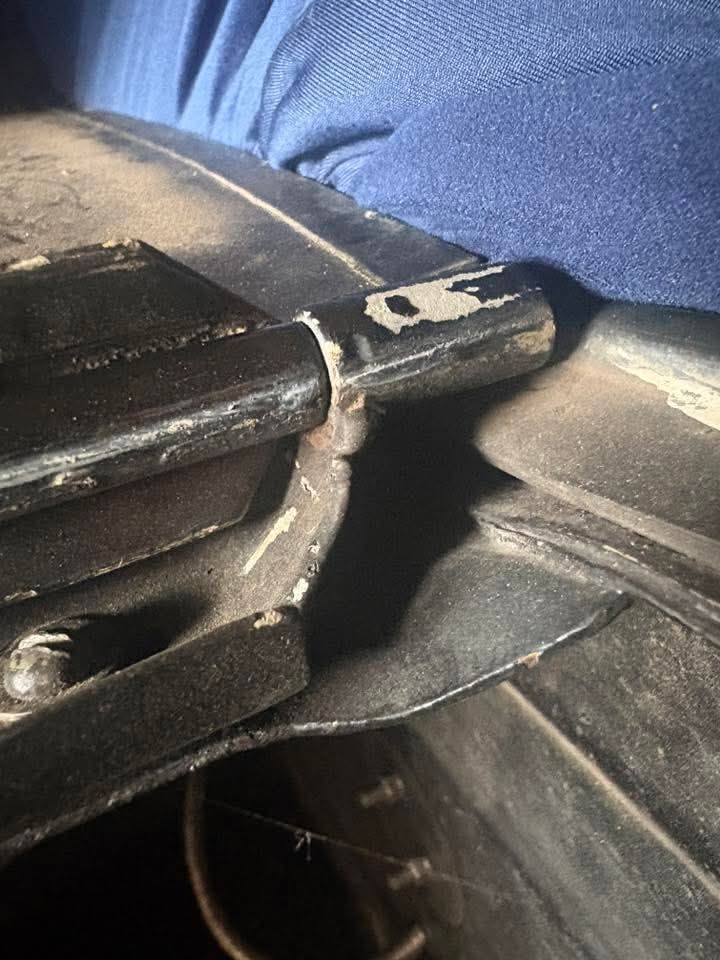

Next up I needed to repair the radiator stay. Apparently the bonnet is meant to slide into a loop at the rear and rest in a channel on the front. The front channel is there.
But the rear has snapped off

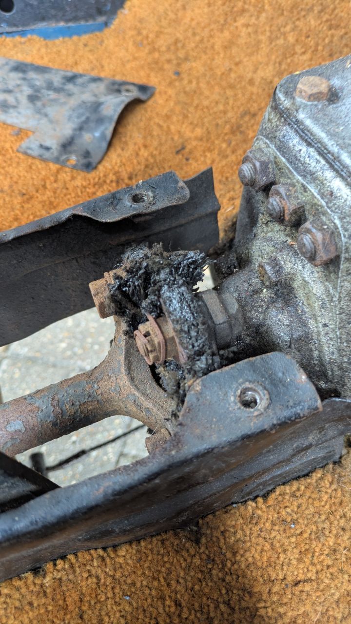

My propshaft fabric doughnut is disintegrating...
It should not be splaying like it is and it's vibrating the propshaft and it's striking the prop tunnel.
I have made the choice to change to a later hardy Spicer driveshaft rather than replace the doughnut. The doughnut is available but a hardy Spicer will have more longevity and is an upgrade on the doughnut.

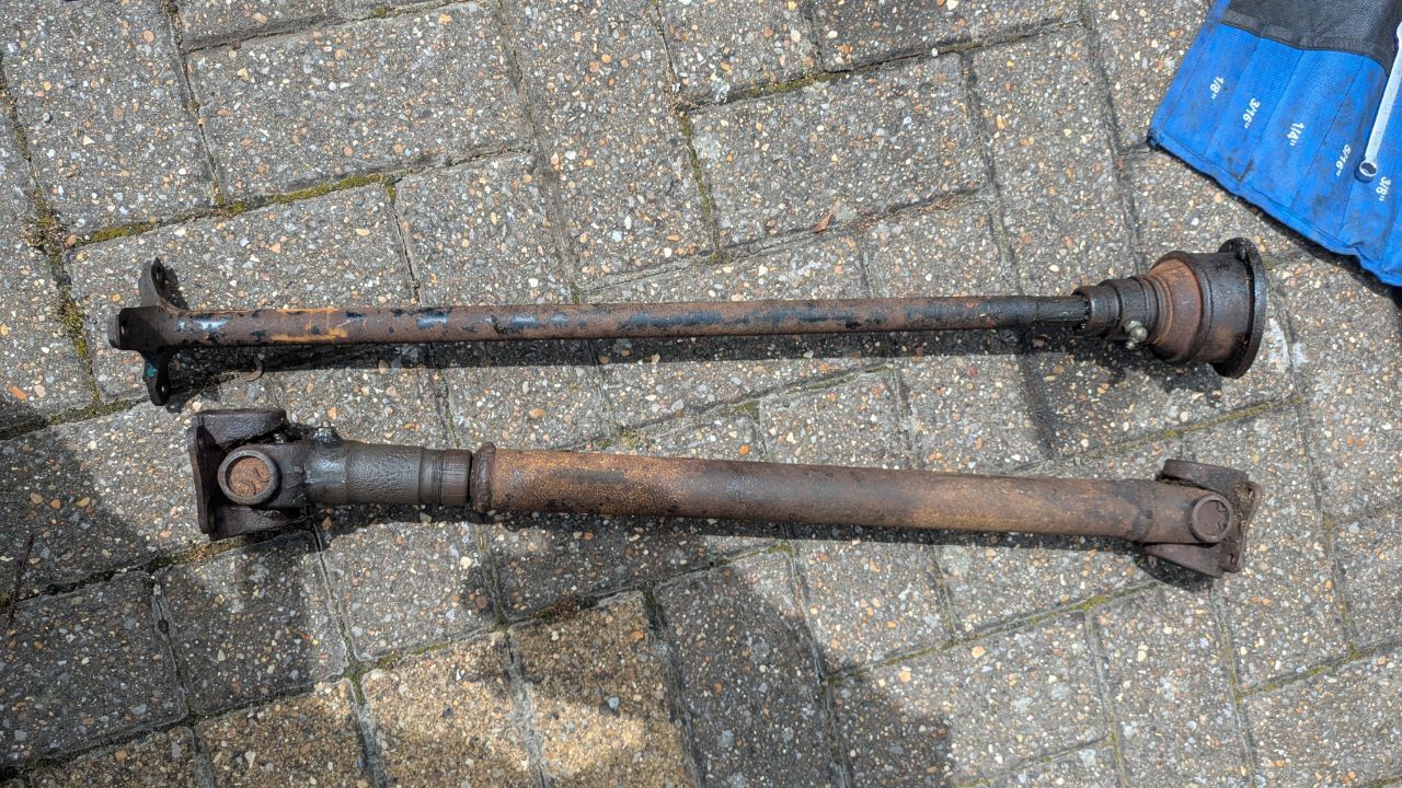

My propshaft coupling was well and truly buggered when I took off the inspection cover.
When I took it off it was basically in pieces. Well past it's best before.
I then proceeded to remove the prop as I am swapping to a later propshaft with hardy Spicer joints.
And put with the old flanges as there's a different shape and bolt count
Old one
And the new one in it's place
And new prop in place! I had fabricate some D-head bolts by grinding down some M13 bolts.
Apparently it's normal that when this upgrade is done the prop clashes with the handbrake but it seems I have a pre adjusted handbrake cable and had no clashing. It's tight but no clashing.

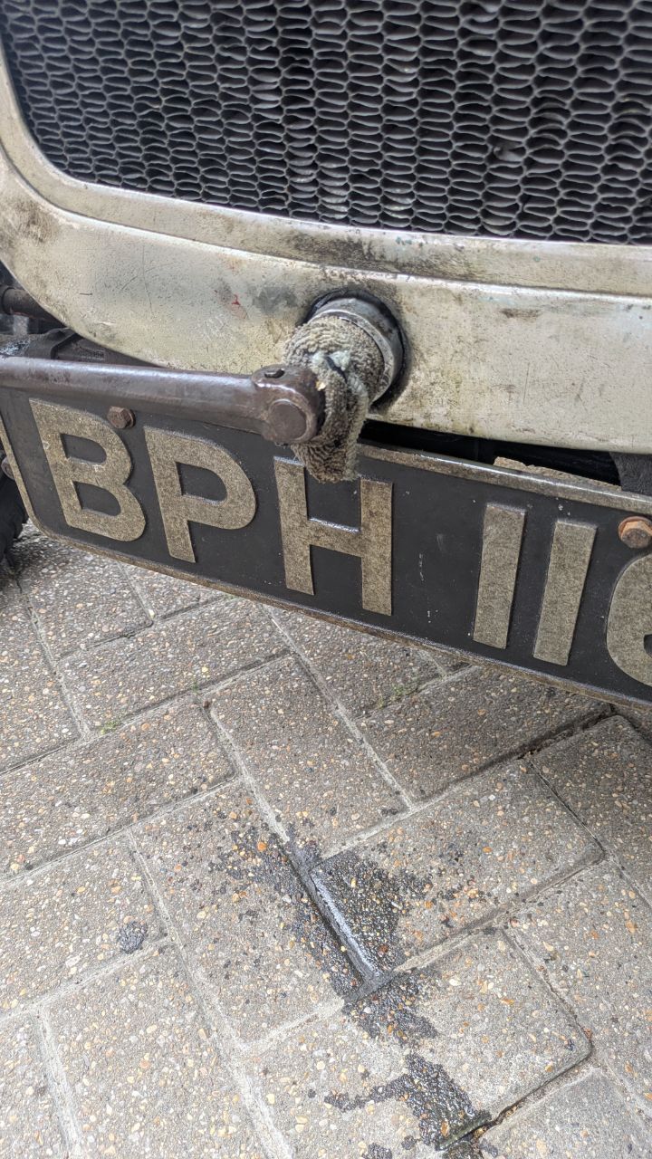

It also leaks out the starting handle hole so I solved* that by jamming a cloth in the hole and tying it in place 😅

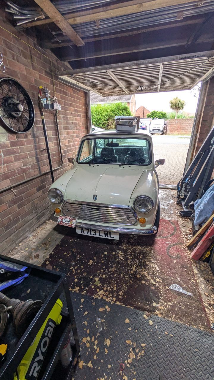

Time for a post mortem on the Mini from Poland.
First up a little switch around. The usual garage occupant has been evicted and replaced with the patient

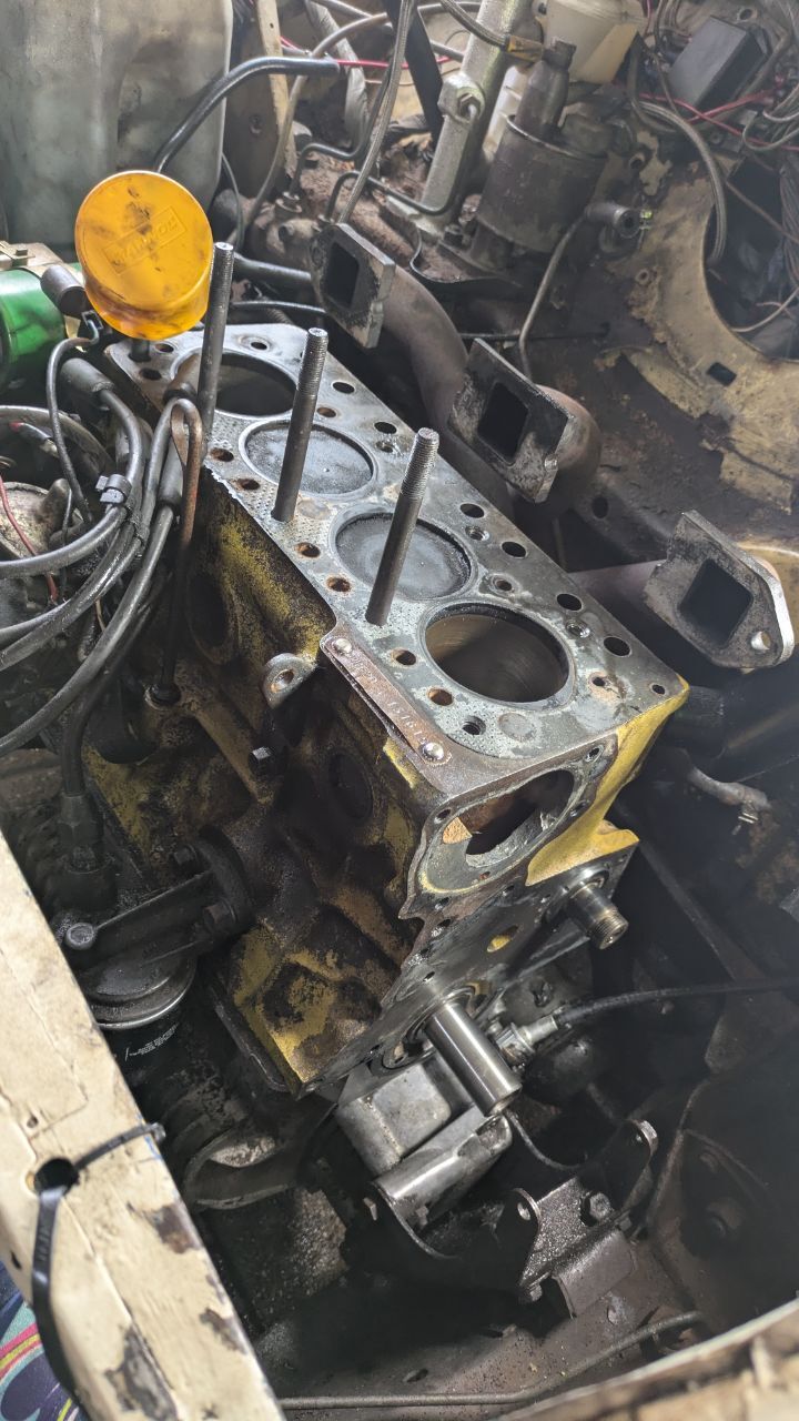

I am stripping off the head for a skim, the rad for replacement with a thicker alloy unit, and replacing the timing cover which is hosing oil out of it and then being sucked directly into the rad, another reason for replacement.
First up rad out. Water pump too as it's in the way. Managed to get the pulley off with a pry bar.
Then off with his head (and the timing cover)!
Head is showing blowing between 2 and 3 so definitely needs a skim.

This evening I cracked on with the Mini. Got the timing gear reassembled.
And the cover for my new timing case installed.
Final steps were alternator and water pump back in then this part of the engine was reassembled.

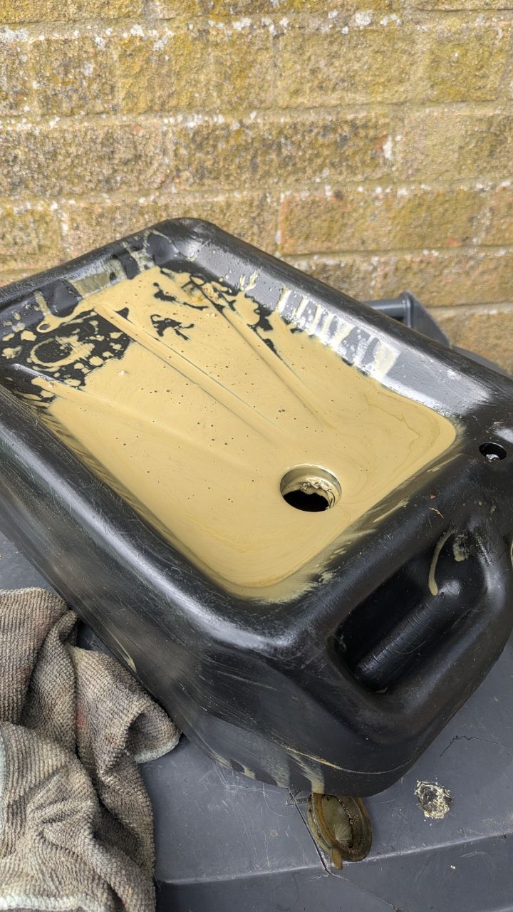

Blocked fuel line again. This time I came prepared with this safe* open jerry can and fuel line running out the window
