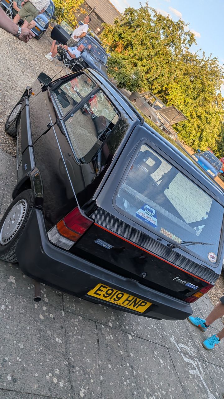

I was at a show on Sunday and was reminded of you, @Tommyboy12 by this little gem.
I stood there for a good 5 minutes thinking "there's a turbo, and an intercooler crammed in there, blowing through the SU carb?!"
Madness.

Ooof. Its got the bagsport fabrications side manifold by the looks of it. Side mounted turbo over the flywheel housing. Ive been contemplating converting to this setup as it offers better, more modern turbos plus I might want to be a total chav and have a screamer pipe out the bonnet...
I love the fact it looks completely standard on the outside apart from the wheels.
