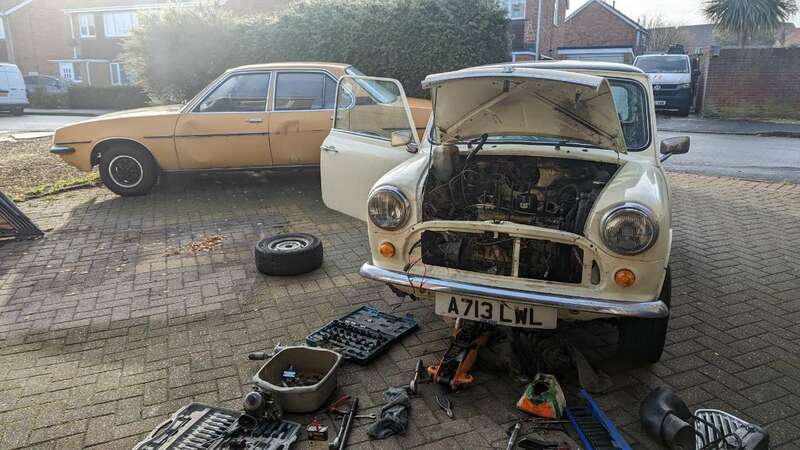

Started my festive break by completely ignoring my new steed and fixing a multitude of sins on my white Mini that were leftover from the NC500 in October. I've not touched a single car for maintenance since then which is depressing...

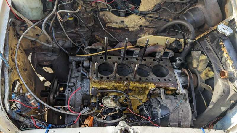

Included in today's agenda was a headgasket change (the one I fitted in Scotland was kinked and had corrosion so was only ever a stop gap), a new manifold gasket that I failed to replace in Scotland despite it separating into multiple pieces, a new primary gear oil seal and clutch plate to replace the clutch that was ruined by a failed oil seal, a new oil pressure relief plunger and spring, a fuel pump blanking plate to remove the obsolete and non-functional mechanical fuel pump, and I also melted some metal together to take out the slack in the clutch arm and replaced the clevis pins with an aim to have a pedal that does more than nothing until the last 1cm of travel.
Back together now and running again but alas my work is not done. While I took the slack out of the clutch mechanism I apparently took so much slack out that now my clutch is permanently disengaged and the car won't move... I have to shorten the plunger rod for the slave cylinder a little to make up for all the slack I took out elsewhere. Productive day though!

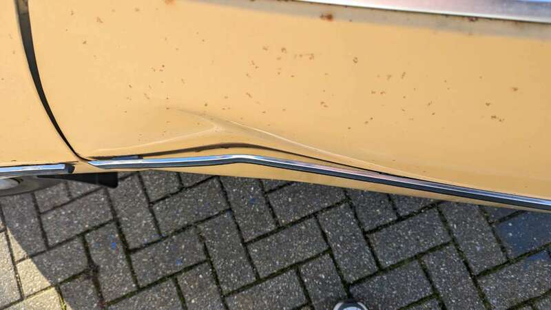

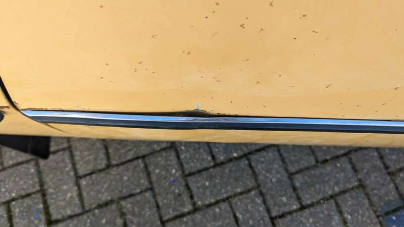

So today I've spent the morning working on the Cavalier trying to remove most of the door damage. They were never going to be perfect as there's creasing in the swage line but they're a lot straighter than they were. I am quite impressed at the thickness of steel used in them. They certainly took some welly to get them moving.
Waay better with the dents pushed out.
Should be not to bad to sort the remains of the dents now? As the doors look soild.
It needs a more professional hand than me with a couple of blocks of wood and a crowbar but the doors are very solid still yes. They should respond well to some proper panel beating.
Those doors look 78.5693% better than beforer. Huge improvement!

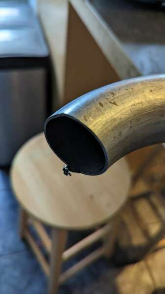

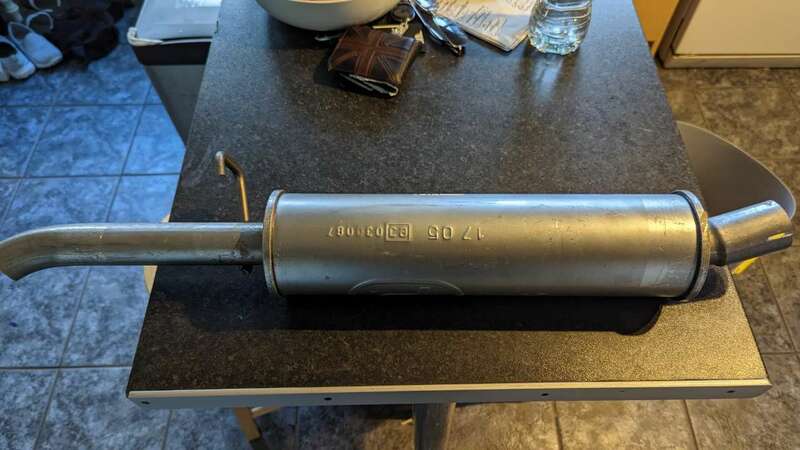

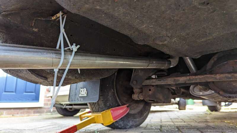

Since acquiring the Cavalier I have learnt that parts are a bit thin on the ground. Not surprising and I have certainly had to deal with that before with other cars. One challenge has been the exhaust section that is currently straight piped. Don't get me wrong. I like a fruity exhaust but I don't think it's really needed here.
I have been back and forward with a Polish exhaust company to check dimensions but it seems the Opel Ascona B exhaust should fit. As such this has turned up from Poland. Build quality is top notch.

Exhaust looks correct.  Only reason I stuck the straight bit of pipe on was that it did a great job of filling the cabin up with fumes without it!  I think the pipe actually made it louder rather than quieter...seem to remember the bit I stuck on there was stainless though so probably worth keeping around. Might Be Useful One Day...which is why I still had it.

Bigg Red for the brakes. The exhaust isn't really a problem but I thought I would be worthwhile fitting the real deal. It was only £32 delivered!

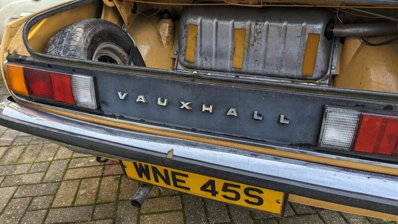

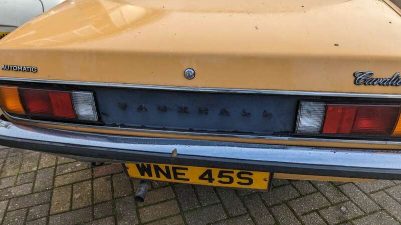

Absolutely baltic weather round here today but decided to do some car stuff. I poked the Cavalier for a bit. Fitted the boot badges now I had some clips turn up for them.

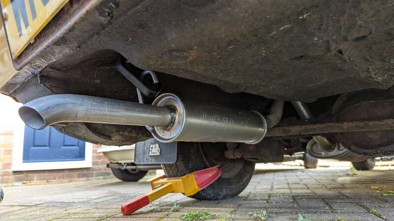

Fitted the exhaust. Turns out the hangers for the mid-section weren't attached so it's sitting a bit low. I have ordered some new hangers (they're doughnut shaped) as the ones fitted are very perished.

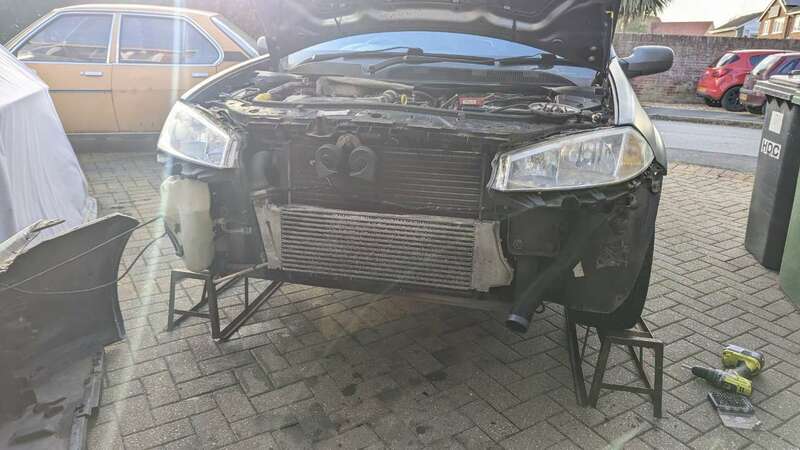

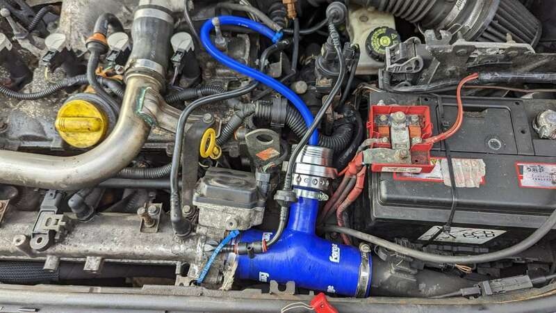

I have also continued my trackcarification of the Mégane. I previously fitted a stupid big intercooler. Now I've fitted a blow off valve. I also cleaned the disgusting k&n filter that was already fitted. It was black and oily and full of dust and crud. Now it's red again and coated in air filter oil. I know they just suck up hot air but the original intake is missing and for the track I would rather have the sound of the inlet 😅
I still have a set of cup pack suspension with lowering springs to fit and an exhaust. I'll get round to it at some point.

I did manage to finish off the exhaust this morning. All mounted with new mounts.

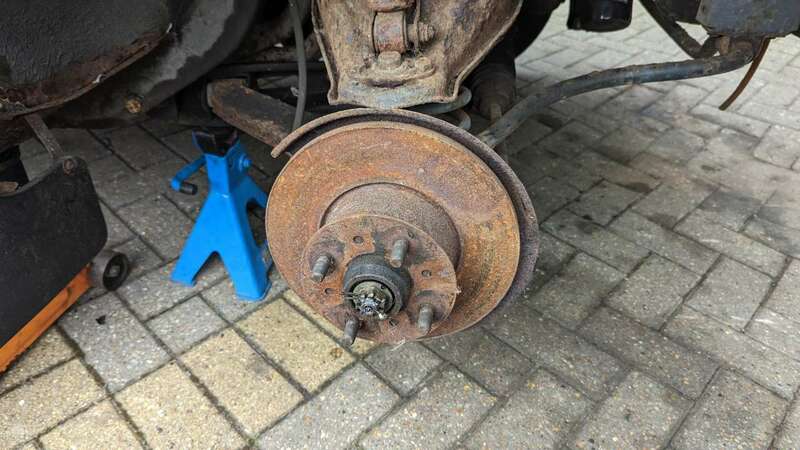

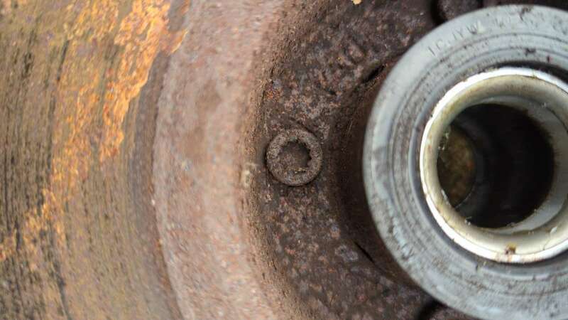

I tried to make a start on the brakes but it turns out the discs are held to the hub with spline bits. Which I don't have the correct size for. They're also guaranteed to strip when I do get the right size bit. Not looking forward to that job.
