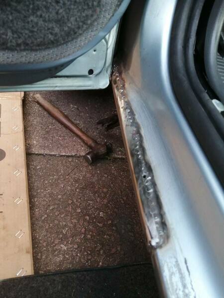

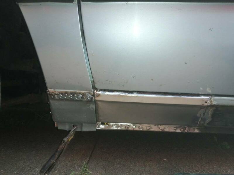

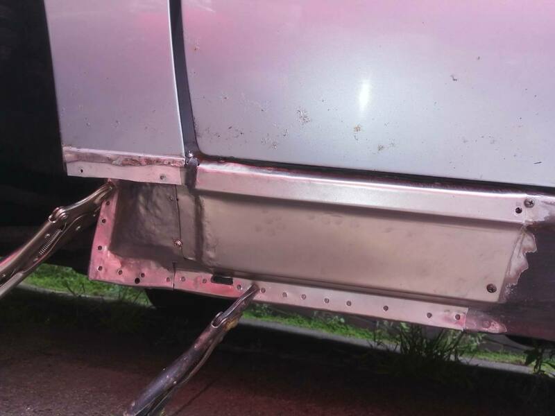

Dobloseven Posted September 5, 2021 Author Posted September 5, 2021 Welding pretty much finished today, at least that corner anyway. Just need to dress welds, most will be hiddeen behind trims. Then prime and seam seal. The joint on the sill will be blended in with filler where it is on show. Probably use stonechip and finish in satin black so it looks as original as possible. The bottom of the wing is now bolted on since I took the photo. Have managed to keep the repairs below the paint line so far. The closing piece for the sill end which hopefully will never be seen again, hidden behind the wheel arch liner, took longer than all the other repair pieces put together. Please, no Father Ted references! Trouble is I haven't done anything like this for over 8 years, and by the time I'd got the knack again, the job was done. rm36house, JeeExEll, Dr_Slow and 9 others 12

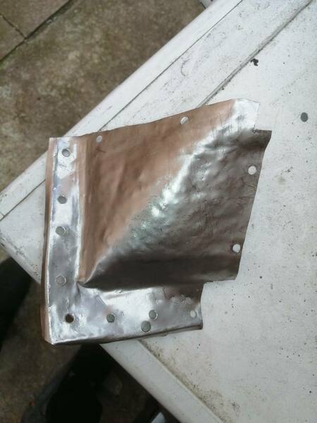

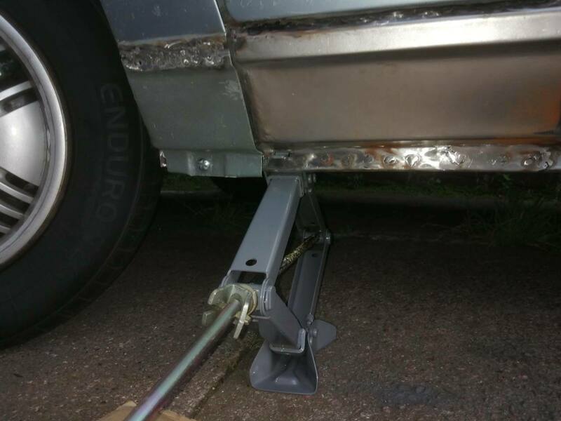

Dobloseven Posted September 5, 2021 Author Posted September 5, 2021 Here's another photo I forgot. Piece was still being beaten into submission, hence the clamps and screws. First thoughts were to make it in one piece, but glad I didn't attempt it. Minimad5, tooSavvy, Shite Ron and 5 others 8

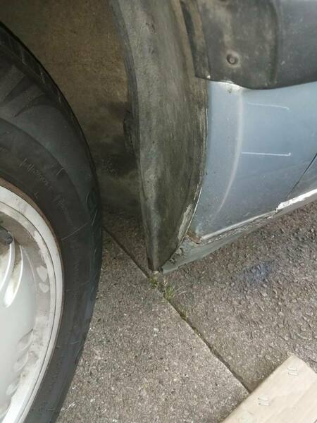

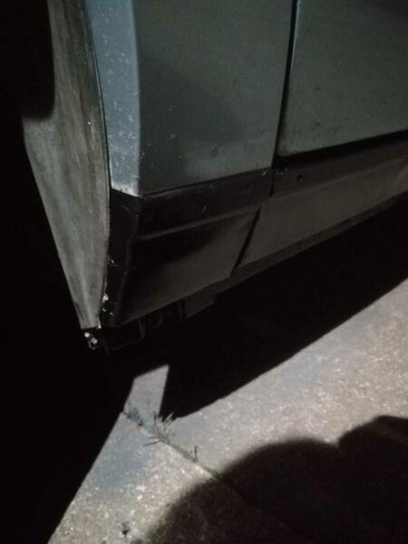

Dobloseven Posted September 6, 2021 Author Posted September 6, 2021 Only a small amount of progress tonight. Finished dressing the welds. Drilled holes in the new metal for the sill finisher trim. Test fitted the wheel arch liner and checked the jack would fit in the slot I'd had to remake in the sill repair. It's only a location, the weight is taken by a thick metal jacking point fixed to a big box section. Didn't want to get it all painted and then have to start drilling and modifying bits to suit. Shite Ron, Zelandeth, Minimad5 and 10 others 13
Dobloseven Posted September 6, 2021 Author Posted September 6, 2021 Also, while I'm repairing that side sill, thought I'd check the rear part. It's covered by a black plastic cover and I was concerned it might be rusting away out of sight. Drilled out a couple of pop rivets and pulled it away and felt behind. All seemed amazingly sound so one job less. JeeExEll, Shite Ron, St.Jude and 1 other 4

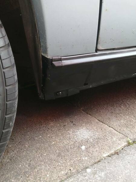

Dobloseven Posted September 7, 2021 Author Posted September 7, 2021 9Well, it's taken me just over a fortnight,though I did have five days away in the caravan, but seem to be on the home straight. Just got the trim to fit, which will cover a multitude of sins. Probably leave the other side for now. Can see a few flakes of rust behind the wheel arch liner and the sill trim but nowhere near as bad as this side was. Was a bit more involved than I first thought,with four layers of metal, if you count the wing bottom, to line up. Can perhaps see now why it had been crudely bodged up with what appeared to be bathroom sealant. Anyway it's metal again now, thank goodness. Tickman, BlankFrank, Kringle and 18 others 21

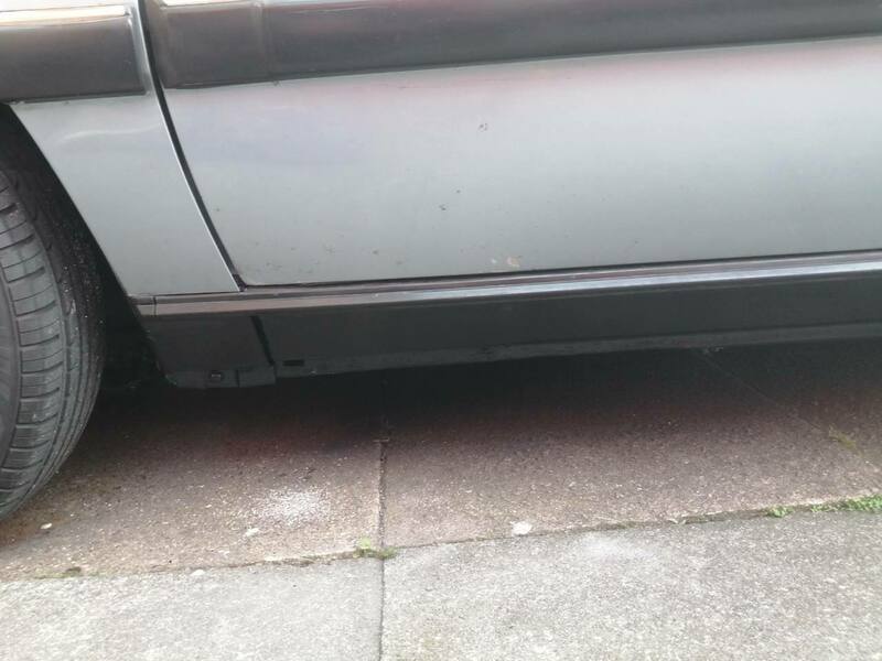

Dobloseven Posted September 9, 2021 Author Posted September 9, 2021 Well, refitted the sill trim, so that's it for now. Didn't get some of the angles and radii quite right, but it's as good as it's going to be. Going to do the timing belt next, but will post in the Ask a Shiter section as I might need a bit of advice. Justwatching, tooSavvy, Low Horatio gearbox and 14 others 17

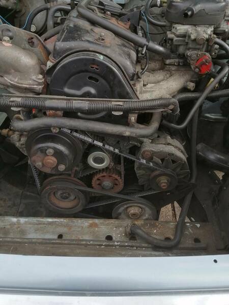

Dobloseven Posted September 10, 2021 Author Posted September 10, 2021 Well, haven't had much advice yet, so thought I'd just follow my nose and get on with the timing belt. Got the radiator out, which gives a lot more room to work and get the Dewalt impact wrench in for the crankshaft pulley. The timing belt was quite loose and the power steering belt along with the alternator belt were badly cracked so I've ordered replacements. The tensioner in the kit is completely different to the other so will go to parts place tomorrow to see whats what. A tentative feel of the old one doesn't show any roughness or play, so might well be ok. Worryingly, while the radiator was out, I thought I'd flush out the cooling system and found the long hose from the overflow container completely blocked. Would have made refilling the system impossible. Flushed the radiator and blew through the core with compressed air to improve airflow. All in all, a day of mixed success. Will hopefully put a photo up tomorrow of the naked engine front. Low Horatio gearbox and Justwatching 2
Dobloseven Posted September 11, 2021 Author Posted September 11, 2021 All done. Parts place had the alternator cum waterpump belt in stock and picked up power steering one from a local bearing type place. Took belt kit with "wrong tensioner" back and turns out that the original type has been superseded. Fitted ok once I knew what was what. Had a lot of trouble filling and bleeding the cleaned out cooling system, think I've got all the air out now, but keep checking the level. Low Horatio gearbox, Tickman, Minimad5 and 6 others 9

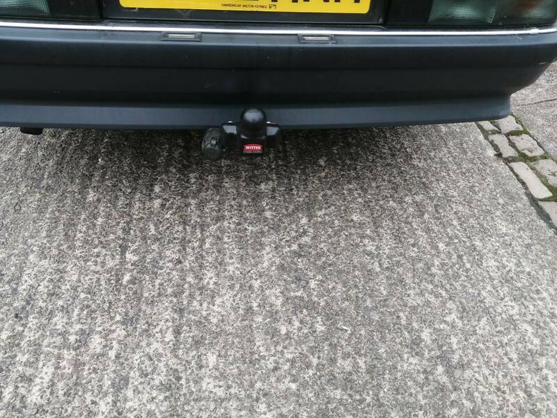

Dobloseven Posted October 4, 2021 Author Posted October 4, 2021 Haven't done a lot since I got back on Thursday. Had an infected tooth on holiday and had it out today. It stopped me feeling like doing much. Boot is slowly filling up with parts that need fitting. Have however tested the towing electrics. All is good. Have found an unused towball and cover in the shed. Just need a numberplate and it's ready for towing the trailer tent I'm buying. Squirrel2, tooSavvy, St.Jude and 2 others 5
