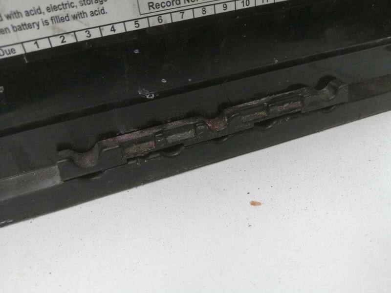

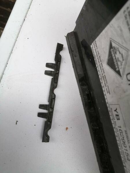

Dobloseven Posted November 7, 2021 Author Share Posted November 7, 2021 Further to changing the battery, I wasn't very happy with how it fitted in the battery tray. The lip on the bottom was too high to fit under the ledge on the tray, so it was only held down by the clamp on the front edge with the bolt only just long enough. Started to make a metal bracket to hold the back edge down. Checked it against the old battery for size and noticed part of the lip would unclip making it lower and a good fit in the tray. The new battery was the same, in fact I read somewhere that Halfords batteries are made by Yuasa. Now it's nice and secure, so another small victory in my journey to keep it in service and improve it. Tickman and RobT 2 Link to comment Share on other sites More sharing options...
Dobloseven Posted November 7, 2021 Author Share Posted November 7, 2021 Missed some pictures! Never come across this before. grogee and St.Jude 2 Link to comment Share on other sites More sharing options...

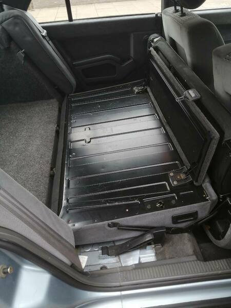

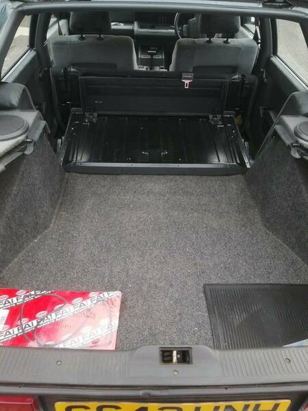

Dobloseven Posted April 8, 2022 Author Share Posted April 8, 2022 Not much happened on the 25 front lately. Use it at least once a week, usually on Friday. Did find out rear seat can do this, though. Load space is 5 1/2 feet long. Trouble is, front seats can't then go all the way back, which isn't ideal if you're tall. OK for moving something big for a short distance though,I suppose. Justwatching, JMotor, fairkens and 5 others 8 Link to comment Share on other sites More sharing options...

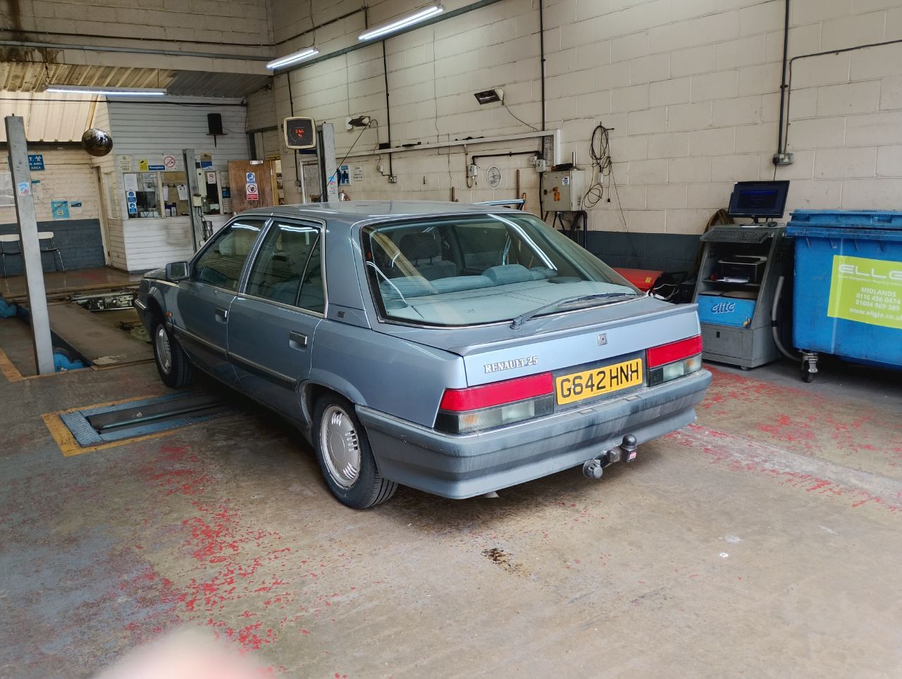

Dobloseven Posted August 12, 2022 Author Share Posted August 12, 2022 Passed Mot with no advisories this morning. Though tester popped an exhaust rubber back on out the goodness of his heart. Done about 1400 miles since I bought it a year or so ago. There was a technical hitch with the emissions machine which held things up a bit. Suggested holding a canary close to the exhaust and if it was conscious after10 seconds, pass it. DVee8, Broadsword, Lacquer Peel and 16 others 18 1 Link to comment Share on other sites More sharing options...

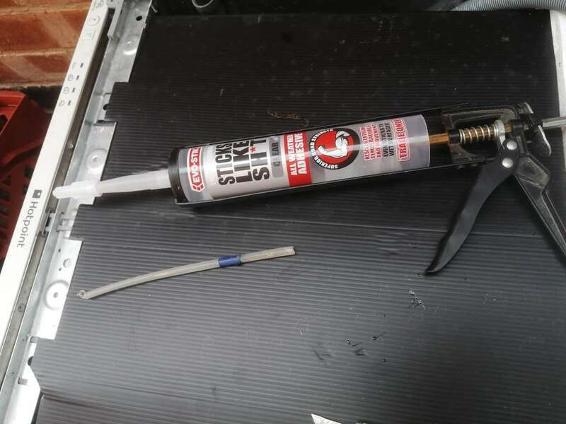

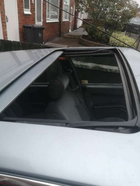

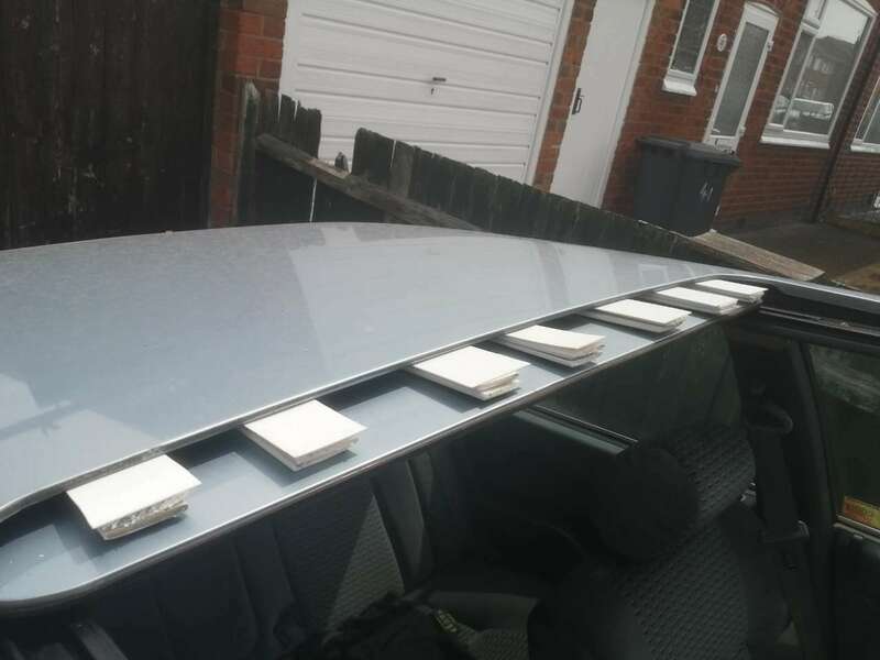

Dobloseven Posted June 18, 2023 Author Share Posted June 18, 2023 Fired up by the "Living with faults" thread, I decided to tackle the sunroof. For a while now,it's only been able to retract a couple of inches. Worked out a piece of corrugated material stuck to the underside of the roof had come unstuck and dropped down, impeding the roofs movement. By sliding some thin strips of plastic between the sunroof and the corrugated stuff, I could get the roof to slide all the way back. Worked out if I could get some adhesive in the gap between the roof and the "stuff", I could then slide more, thicker, strips to press the two together till it set. Got a tube of" Sticks like Shit "from Screwfix. Put a thin tube over the nozzle, with a ring of tape to show how far to insert it into the roof space to get a bead of sealant in the right place and gave it a go. Been waiting for a decent day where its not too hot or likely to rain, as the roof has to be left open for a while to hold the glued surfaces together. Seemed to work ok, but don't think I got enough glue in one area because it dropped a bit, though not enough to stop the roof. Had another go and hoping it'll work. Difficult to gauge how much glue you're applying as you're working blind. Be nice if I can use the sunroof again as there's no aircon. Looking at the original sales brochure, it was an option on even the top models. Probably wouldn't be working after 34 years anyway! goosey, Chuck Buckles, Macscrooge and 7 others 10 Link to comment Share on other sites More sharing options...
Zelandeth Posted June 19, 2023 Share Posted June 19, 2023 On 6/18/2023 at 4:28 PM, Dobloseven said: Fired up by the "Living with faults" thread, I decided to tackle the sunroof. For a while now,it's only been able to retract a couple of inches. Worked out a piece of corrugated material stuck to the underside of the roof had come unstuck and dropped down, impeding the roofs movement. By sliding some thin strips of plastic between the sunroof and the corrugated stuff, I could get the roof to slide all the way back. Worked out if I could get some adhesive in the gap between the roof and the "stuff", I could then slide more, thicker, strips to press the two together till it set. Got a tube of" Sticks like Shit "from Screwfix. Put a thin tube over the nozzle, with a ring of tape to show how far to insert it into the roof space to get a bead of sealant in the right place and gave it a go. Been waiting for a decent day where its not too hot or likely to rain, as the roof has to be left open for a while to hold the glued surfaces together. Seemed to work ok, but don't think I got enough glue in one area because it dropped a bit, though not enough to stop the roof. Had another go and hoping it'll work. Difficult to gauge how much glue you're applying as you're working blind. Be nice if I can use the sunroof again as there's no aircon. Looking at the original sales brochure, it was an option on even the top models. Probably wouldn't be working after 34 years anyway! Lucky git... I'm still summoning the enthusiasm to extract my washer bottle to extinguish my low screen wash light (no strainer in mine). Treat the sunroof with suspicion. I found the hard way that there are several bits of plastic in the mechanism which have turned a bit brittle with age. Exactly which ones I don't know yet as that will have to wait until I have the time and patience to get the whole assembly out of the car. Which is going to have to wait as I've got a Rover with a blown head gasket and a van with brake issues which are proving a hassle to resolve to get it MOTd, so this is a ways down the priority list just now... Link to comment Share on other sites More sharing options...
Asimo Posted June 19, 2023 Share Posted June 19, 2023 "plastic gauze filter... - ... blocked with algae" A trip through the dishwasher sorts that out. Link to comment Share on other sites More sharing options...

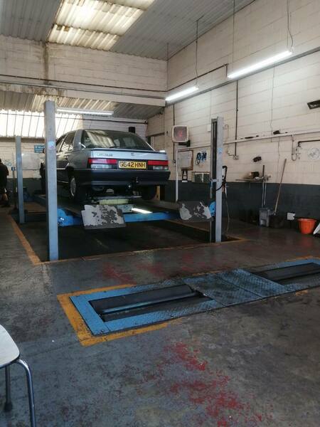

Dobloseven Posted August 11, 2023 Author Share Posted August 11, 2023 Mot today. Passed with no advisories. Mind, only done just over 600 miles since last year. A bit sad because found out the old boy who tested it last year has died. Been going to the same place for getting on for 20 years, so get to know people. Good for someone independent to give it a good going over. More than happy to pay the 40 quid. In fact I don't really know how they make much out of it. They reckon because of the area they're in, even a fiver more would mean losing business. mk2_craig, Macscrooge, Burnside and 3 others 6 Link to comment Share on other sites More sharing options...
