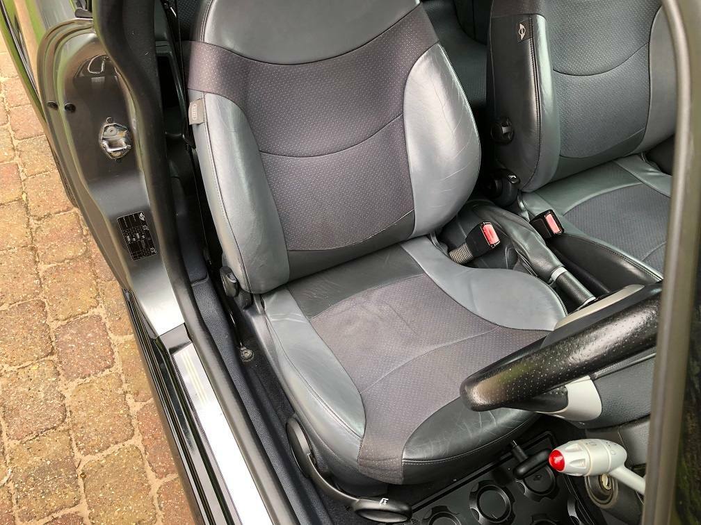

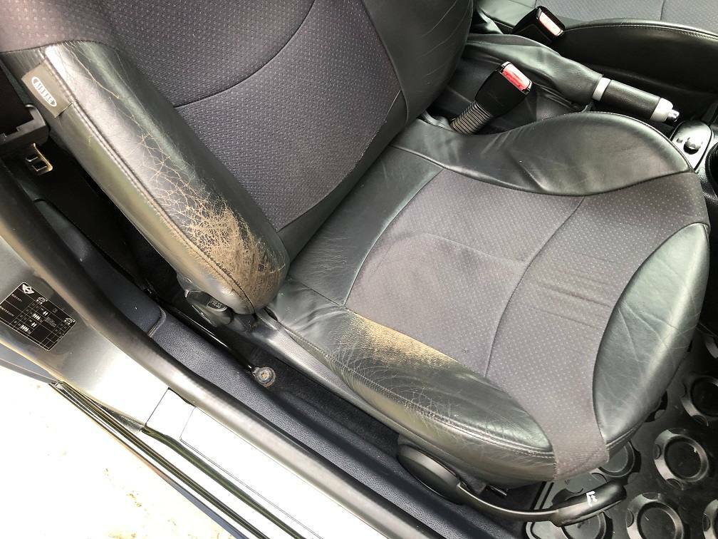

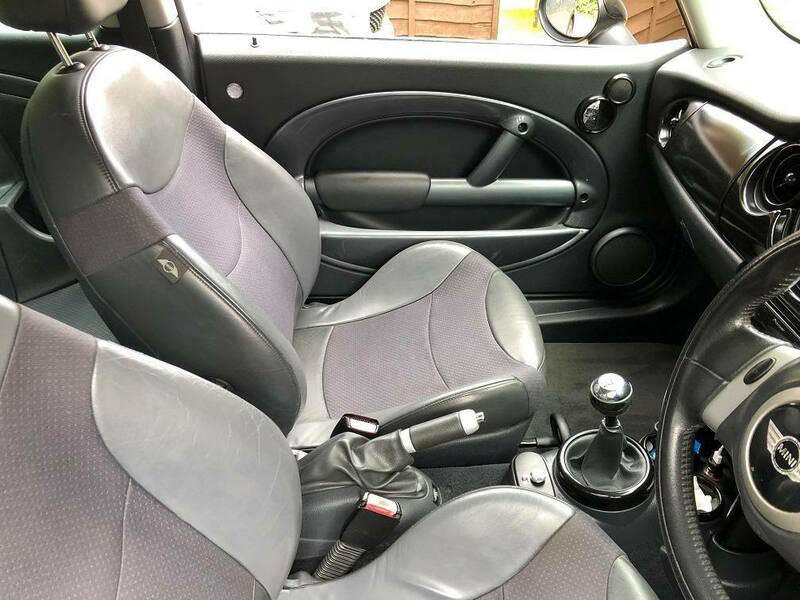

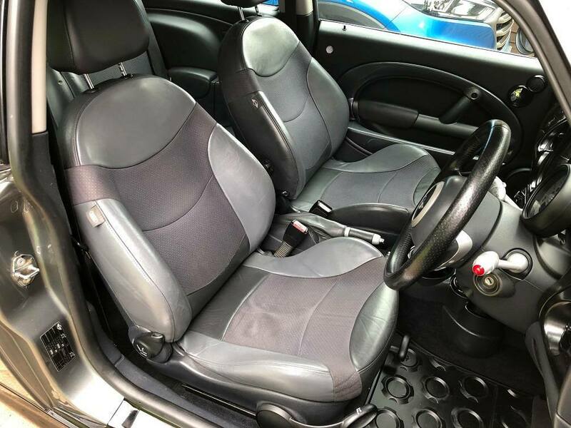

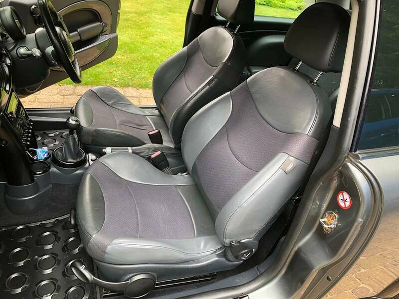

Peter C Posted July 24, 2021 Author Posted July 24, 2021 The Cooper's interior is fairly tidy but the driver's seat bolster was very worn. I bought a bottle of dark grey leather dye from Amazon for less than £8. I treated the worn bolster and whilst it looked much better, the dark grey was clearly not as dark as the original seat colour. Undeterred, I proceed to dye both front seats and I am really pleased with the results. The job took 2.5 hours and wasn't particularly difficult. mercedade, rainagain, tooSavvy and 2 others 5

junkyarddog Posted July 24, 2021 Posted July 24, 2021 Nice work on the seats,they look excellent. Peter C 1

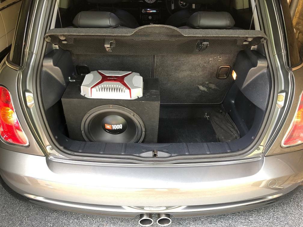

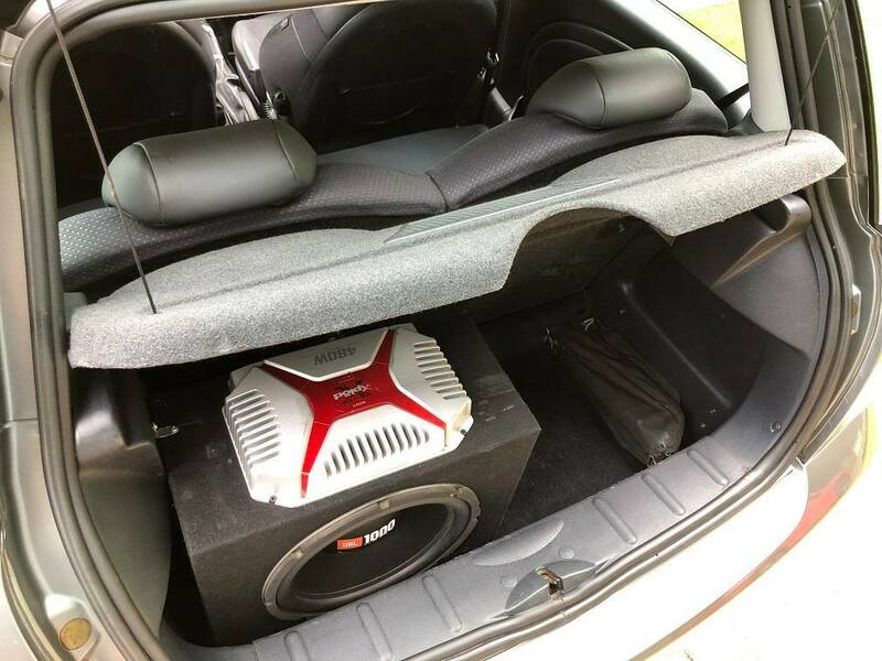

Peter C Posted August 5, 2021 Author Posted August 5, 2021 Good news first, I bought a little Matchbox model of a grey 2003 R53 Cooper S. Jim advised me that he removed a sub and amp from the boot, installed by a previous owner, which he very kindly offered to send me. When the ICE arrived, I re-installed all necessary cabling and plugged in the amp and sub and... not a sausage, it didn't work. I removed the amp and sub from my W124 and fitted them instead and bingo, we have music. A lot of music! The Pioneer head unit is decent and the speakers must have been upgraded at some point because together with my amp and sub, the system sounds superb. And I still have half a boot left. I know someone who is willing to take a look at the defective amp, it might be fixable. The bad news is that replacement of the rocker cover gasket has not solved the oil leak problem. I'm still seeing a fair amount of oil dripping from behind the engine onto my garage (carpeted) floor (now protected with cardboard). Looks like the oil filter housing or associated pipework is leaking, quite badly. However, by stuffing a rag into a duct that extends between the engine bay and the bulkhead space through which air enters the cabin, I've managed to reduce the smelly air problem by 99%. The other bad news is that the power steering has started to creak. It only does it when the engine is hot but regardless whether the engine is running or not. The steering rack fan is working ok. I wonder whether I have sprayed water (whilst pressure washing the underside of the engine) onto something and washed out a lubricant. I need to investigate further.... Vince70, HMC and privatewire 3

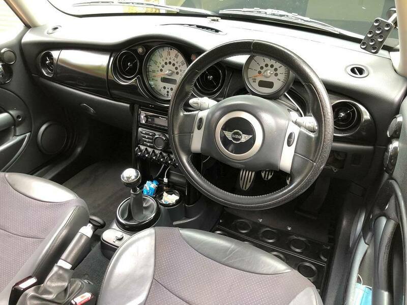

Peter C Posted August 15, 2021 Author Posted August 15, 2021 Although my Cooper's interior is not in bad condition, one of the previous owners evidently had a dog and it left a lasting stench. @SiC would NOT have bought this car! I've already given the interior a good clean, twice but the smell was still there. I leave the windows open whilst the Cooper is parked up and just stepping into the garage was enough to smell mutt. I gave the interior a third clean today but this time I removed the rear seats and stripped the boot trim from the backrests, which were covered in dog hair. I hoovered and wiped every surface, hard and soft, twice. I used up 500ml of disinfectant and the job took almost four hours. First impressions are good, I can no longer smell mutt and the interior gleams. Bit of research revealed that baking soda absorbs smells. I've left a container of the stuff inside the car and I'm looking forward to giving the interior a good sniff in a couple of days. Jim Bell, privatewire and Rusty_Rocket 3
SiC Posted August 15, 2021 Posted August 15, 2021 Is the black around the dials stock or has someone sprayed it? The silver plastic in mine is on good condition but does look a bit fisher price nowadays. Jealous of the climate control! Apart from my classics (which I tend to drive with the window open anyway), it's been a long while since I've owned a car without it. 🤣
Peter C Posted August 15, 2021 Author Posted August 15, 2021 Just now, SiC said: Is the black around the dials stock or has someone sprayed it? The silver plastic in mine is on good condition but does look a bit fisher price nowadays. There's a receipt in the service history for £1,650, which relates to colour coding of the wheels, spraying of the outside trim gloss black and ditto the interior panels. It looks ok for now but I may change it to dark grey. loserone 1

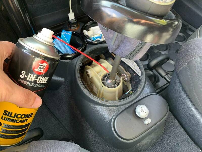

Peter C Posted September 11, 2021 Author Posted September 11, 2021 I think I might have an engine oil leak. I drove the Cooper during the week and amongst many rattles and squeaks, the gear stick was squeaking when changing into 1st and 2nd gears. The gaiter comes off easily to enable access to the base of the gear stick. I sprayed some 3 in 1 oil, let's see if that helps with the noise. And the squeaking steering has come back to play. Research on the internet revealed that the strut top mounts might be the cause of the squeaks. I've given both strut tops a squirt of 3 in 1 oil, let's see if it helps. The good news is that the strut top mounts are all solid, with no evidence of any cracks. Jim Bell and beko1987 2

Peter C Posted September 12, 2021 Author Posted September 12, 2021 16 hours ago, djoptix said: You should sell it on (to me). No chance. Despite it's faults, I still love it. I drove the Cooper to London and back yesterday evening. Both the steering and gear shift were silent. Perhaps my simple fix did the trick. 15 hours ago, Rusty_Rocket said: I think when it comes to oil leaks on these, one should maybe spend the day doing every seal and gasket (bar the crank end, flywheel side) and be done with it! That's my plan anyway. I know you did the cam cover; that leak pattern looks like it's coming from the entire width of the engine- maybe the sump gasket? Only other things I can think of is, oil filter housing, oil cooler and crank sensor O ring. That's pretty much the plan, however I need to find time to take the Cooper off the road. At the moment I still make regular use of it and I enjoy driving it too much to hide it away in the garage for any length of time. I am pretty sure that the oil filter housing gasket is the main culprit of the oil leak. After pressure cleaning the engine when I first bought the Cooper, I quickly saw oil accumulate along the rear of the engine, way above sump gasket level.

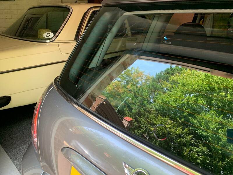

Peter C Posted September 12, 2021 Author Posted September 12, 2021 Today I removed the non-functioning rear wiper and fitted a delete pad. The plastic rear wiper is one of very few design details that I don’t like about R50s. The rear end looks better and cleaner without the wiper. Rusty_Rocket and DVee8 2
