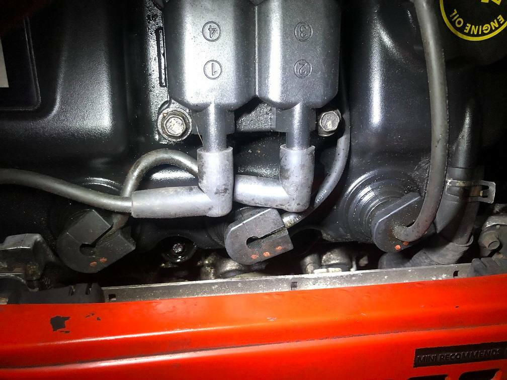

Peter C Posted July 19, 2021 Posted July 19, 2021 I bought a lovely Mini Cooper S from @Sunny Jim which my wife and I collected yesterday. See here: The Cooper made the 250 mile 4.5 hour journey to Buckinghamshire (from North Wales!) under its own steam but all was not well under the bonnet. The fresh air vents were providing anything but fresh air, I was choking on oily fumes. I stopped on route and wiped a lot of oil from the rocker cover and gently kept going, keeping the engine revs below 3k. Before you read any further, I have absolutely no qualms about the car or the deal I made with @Sunny Jim I bought an 18 year old car with 120k, sold as seen, of course there will be problems! I investigated further this morning. There was oil all over the front of the engine and on top of the exhaust manifold shield. I went to remove plug lead No 2 and it came off in two pieces, the metal connector has split from the cable. Next I removed the sparkplugs. Plugs 1 and 4 were a little moist but plugs 2 and 3 were sinking in engine oil. The rocker cover gasket and plug well seals were obviously knackered, a typical R50/53 fault. To get the rocket cover off... All this had to be removed. It's by no means a difficult job but it was time consuming. There is a bit more space under the bonnet of my W123 & W124! I've bought a new set of leads £18 and I'm picking up the gasket set tomorrow morning (£40). Hopefully the whole lot will go back together without any issues. Look at this engine, it's hard to believe that it's done 120k miles in 18 years. Everything under the rocker cover looks mint! In other news, to replace a blown brake light bulb I had to remove the entire light unit. How stupid. Modern* cars ehh? The annoying rattle from the tailgate was silenced with a 4 inch length of insulation tape, wrapped around the lock catch. I do like a clean exhaust pipe. Or two. Out came the Brasso and I am pleased with the shine. And finally, I've noticed that the small lights in the front bumper flick on randomly. According to the experts on a Facebook group, the presence of LED bulbs is upsetting the system. Floatylight, Rusty_Rocket, 155V6 and 17 others 20

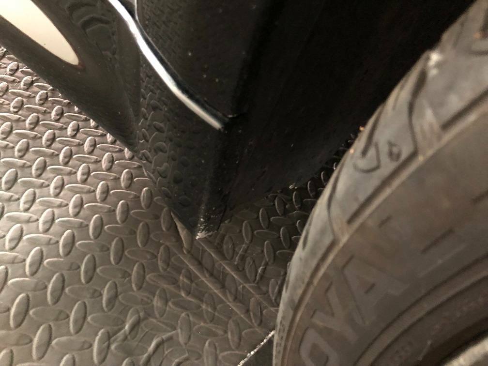

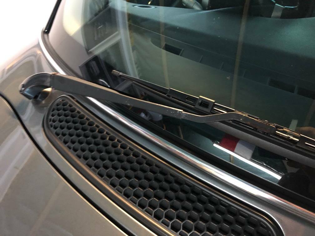

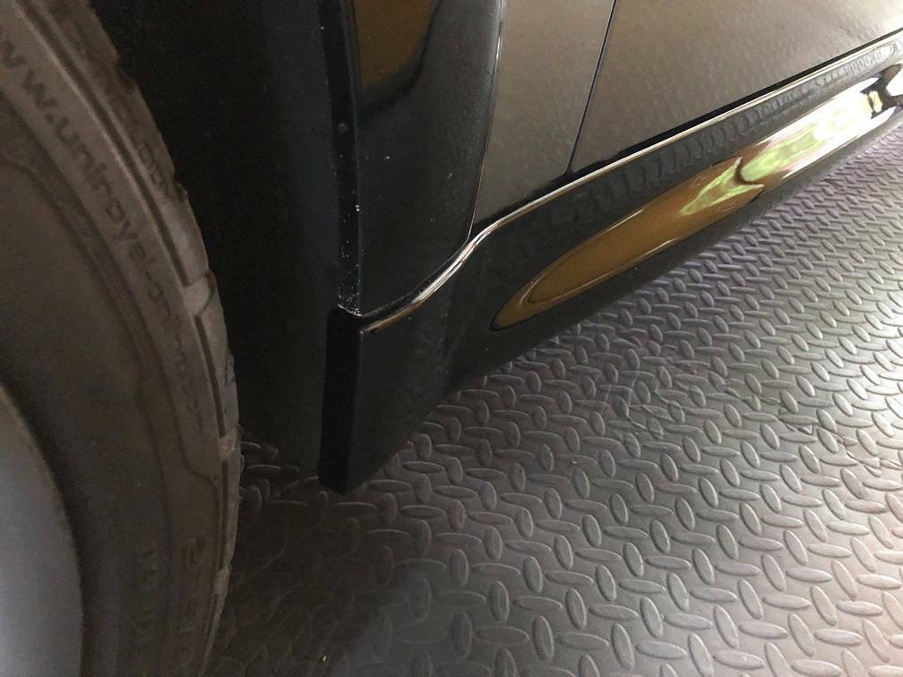

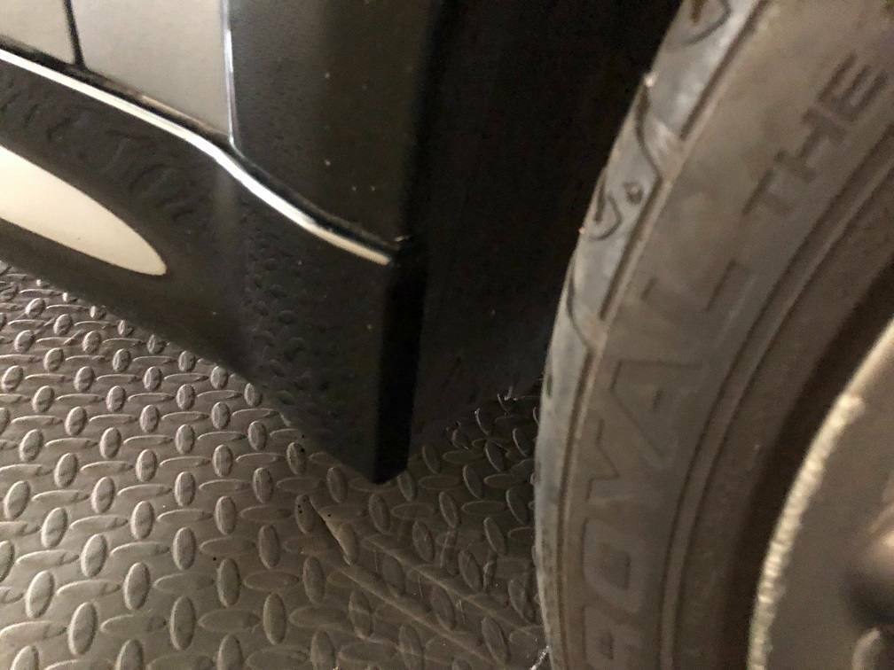

Peter C Posted July 20, 2021 Author Posted July 20, 2021 I got the rocker cover gasket set from ECP. Even with a discount, it cost £40. Why so much? Good news is that the gasket and seals fit, I reassembled the rocker cover, ignition system and intercooler and the engine started first time. Win. The strip down and re-assembly process took about 6 hours, which is not bad considering I've never worked on a Bini before. Next I tackled some cosmetics. The windscreen wiper arms were manky, some of the paint had worn and there was localised corrosion. A quick rub down and squirt of black gloss... And job done. The front ends of the sills were looking scabby, with part missing gloss black paint. Another quick rub down, bit of masking tape and squirt of black gloss and job done. I like the floor mats but the fabric on the driver's side mat was knackered. Rather than buying a new set, I fashioned a repair by cutting up a rear footwell mat that I removed from my wife's old (leased) 4 series BMW coupe. Looks a lot better and cost £0.00. Tomorrow I will give the interior a good clean. I have ordered a replacement Cooper S badge for the boot lid. It should be with me by Friday. Finally, I was pleased that my ladder fits in the boot, which is great, as I may wish to use the Cooper S for work on occasion. More tomorrow. The Moog, Royale80, Jim Bell and 24 others 27

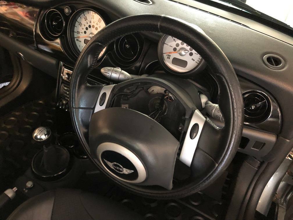

Peter C Posted July 21, 2021 Author Posted July 21, 2021 Bit of an easy day today, I cleaned the interior and adjusted the slightly offset (to the right) steering wheel by resetting it one spline to the left. Then came out the Autoglym this happened. One clean and shiny Mini Cooper. dave j, DVee8, Pat Earrings and 16 others 18 1

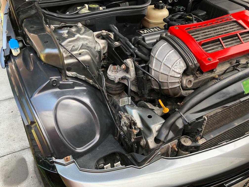

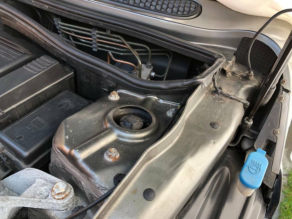

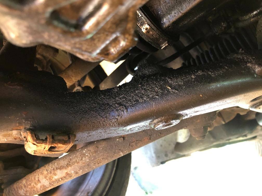

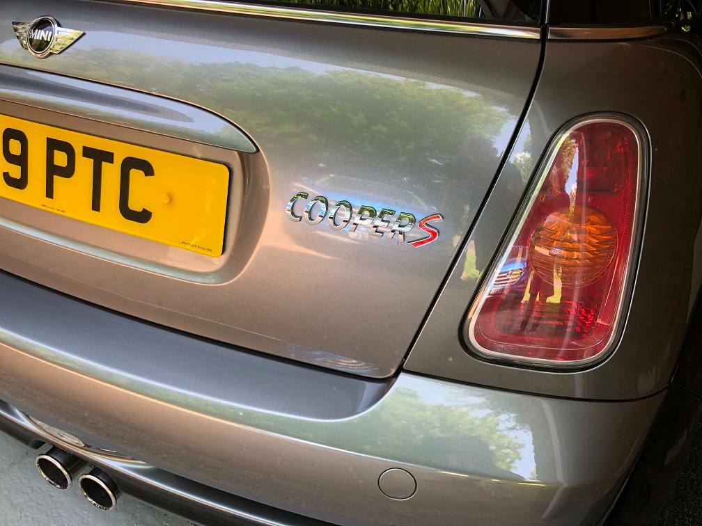

Peter C Posted July 22, 2021 Author Posted July 22, 2021 I was conscious that the engine oil leak has caused oil to spill down the front and rear of the engine and onto surrounding elements. Before I got my pressure washer out, I drove the Cooper onto ramps and had a good look underneath. EVERYTHING was covered with engine oil. The rocker cover gasket must have been leaking for quite some time to cause this much mess. Ten minutes later, I had most of the crud off and the underside was looking better. It was a hot and sunny day and before starting on the engine bay clean, I created a funky tent outside my garage. Considering how much of a mess I was making, I did not want to undertake this job in my pristine garages. The engine bay was dusty and dirty and the plastic bulkhead linings and PAS reservoir and coolant header tank were covered in oil. I wasn't going for concours quality, just a freshen up. An hour later, the engine bay was clean. The Cooper will be another garaged dry weather use only kind of car, so keeping the engine bay clean shouldn't be a problem. And the replacement Cooper S badge arrived and was promptly stuck on. I'm driving the Cooper to London this evening to see my parents. WCPGW? 155V6, rainagain, privatewire and 6 others 9

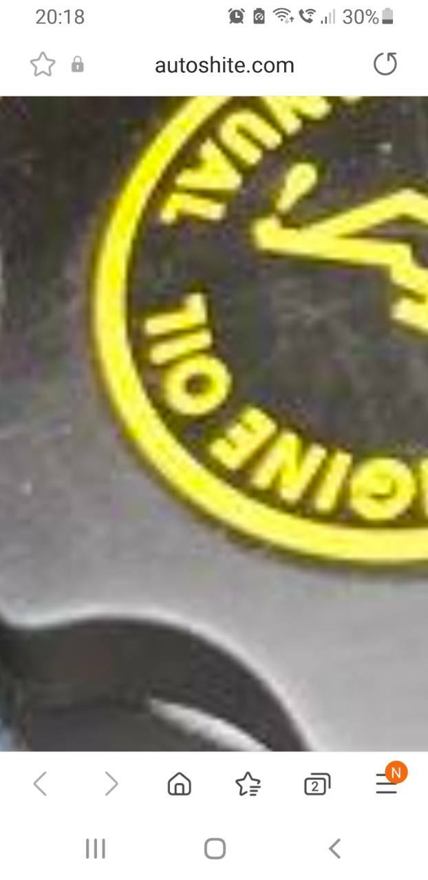

Noel Tidybeard Posted July 22, 2021 Posted July 22, 2021 your 710 cap is upside-down 😁 Wack, inconsistant, Matty and 1 other 4
Peter C Posted July 22, 2021 Author Posted July 22, 2021 2 hours ago, Noel Tidybeard said: your 710 cap is upside-down 😁 What’s a 710 cap? Isaac Hunt 1
Agila Posted July 22, 2021 Posted July 22, 2021 2 minutes ago, Peter C said: What’s a 710 cap? Old joke. Oil cap upside down makes it look like 710. timolloyd, Wack and Peter C 1 2
Peter C Posted July 22, 2021 Author Posted July 22, 2021 1 hour ago, stuboy said: isnt the S a little too high? Hope not!
Tickman Posted July 23, 2021 Posted July 23, 2021 15 hours ago, stuboy said: isnt the S a little too high? They appear to put them at a funky* angle
Ghosty Posted July 23, 2021 Posted July 23, 2021 13 hours ago, Peter C said: Hope not! Definitely wrong am afraid.
Peter C Posted July 23, 2021 Author Posted July 23, 2021 Yep, the S part of the boot lid badge was not on properly. I stuck it on as per the template without checking if it's right. Now corrected. I took the Cooper to west London and back last night, approx 60 miles. It drove great but whenever I stopped, the same oily smell was coming through the dash vents. Today I spent more time cleaning up the engine bay. I removed the exhaust manifold upper heat shield and found it to be coated with oil along its underside and where it abuts the cylinder head. The lower shield was even worse, in places it had approx 2mm of oily deposits. Also, pipework that extends towards the oil filter housing was also filthy. Another hour, a few squirts of Jizer and half a pack of wipes later, everything looked a lot cleaner. I removed the cabin filter and thought it might be best to get a new one. The old one smelt bad and was no doubt contributing to the problem. That's as far as I'm going with this issue now. I will let whatever oily deposits are left on concealed parts of the engine and ancillaries to dry up and all being well the problem will go away. Whilst the exhaust is well concealed behind the rear bumper, I thought it would be a good idea to give it a clean. Twiggy, privatewire, RayMK and 6 others 8 1
Liggle Posted July 23, 2021 Posted July 23, 2021 The oil filter housing gasket is very common, so could contribute to what's collecting underneath. It sits lower than the manifold heatshield though so doesn't explain it collecting there. Peter C 1
red5 Posted July 23, 2021 Posted July 23, 2021 You wait till the shitty cap goes, or the aux/blower belt snaps. Approx .5 seconds later it looks like a wounded Lanc running for the coast. That exhaust heatshield is basically a large hotplate. Peter C and Wack 2
Peter C Posted July 24, 2021 Author Posted July 24, 2021 8 hours ago, Liggle said: The oil filter housing gasket is very common, so could contribute to what's collecting underneath. It sits lower than the manifold heatshield though so doesn't explain it collecting there. Oil on the exhaust heat shields most likely dribbled down from the leaking rocker cover gasket. Is it possible to renew the oil filter housing gasket with the engine in situ? It looks a bit tight.
Liggle Posted July 24, 2021 Posted July 24, 2021 Yeah it's possible, I did mine at the same time as the exhaust manifold and it was fine for access, would be fiddly with manifold in place though! Peter C 1
