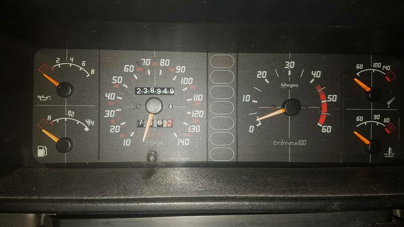

mat_the_cat Posted March 22, 2022 Share Posted March 22, 2022 The oil gauge is a level indication only, and operates when the ignition is first turned on. The rest of the time it does absolutely nothing! Only the top spec models got the pressure gauge. Rust Collector 1 Link to comment Share on other sites More sharing options...

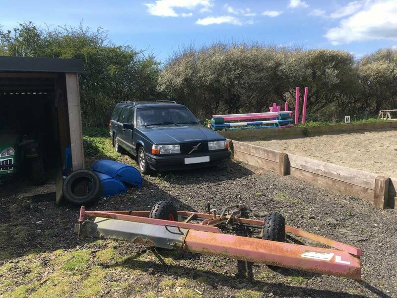

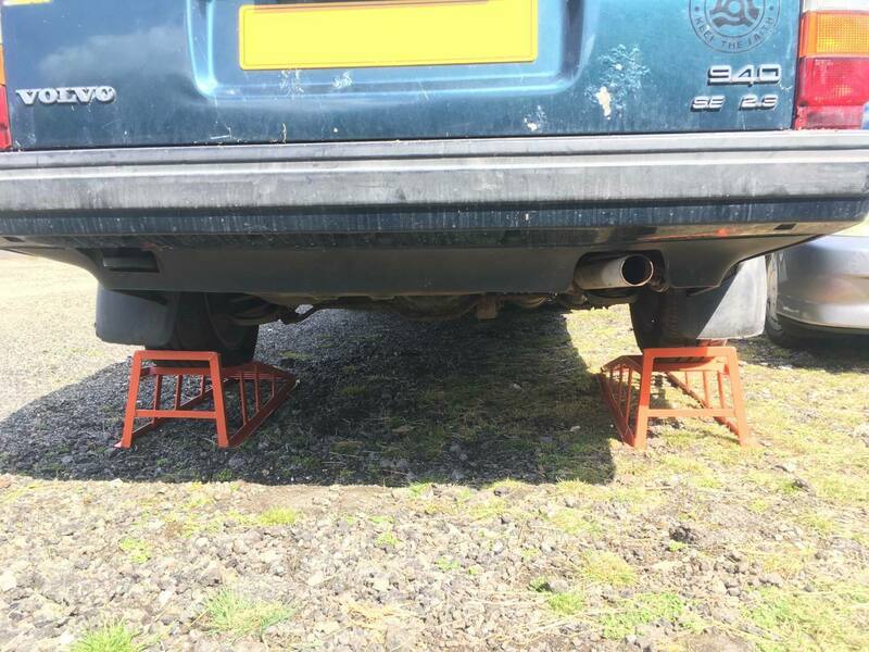

Rust Collector Posted April 1, 2022 Author Share Posted April 1, 2022 Time for a small but tedious job that I've been putting off for a bit. A while back the Volvo refused to start. A brief diagnostics session showed that she had a spark, the timing was correct, but the fuel pressure was very low. You could hear a noise from the tank when you clicked the key to the on position, so I started off by swapping out the fuel filter. This didn't solve anything sadly. A cheapo chinesium fuel pump was obtained and fitted, and she came back to life again. The only problem was that the universal pump was a crap fit, and the inlet sat marginally higher than the original pump - I didn't fancy taking the risk and getting stranded, so a bank breaking £25 was spent on the correct fuel pump via Autodoc. I then let the pump sit in the garage for a few weeks/months as is standard operating procedure. Last night I was looking for a job to do that wouldn't be wildly taxing, cost anything, and would help me get some space cleared up at the stables. Volvo fuel pump it is then. This had the added bonus of meaning that I could put the trim back in and make it look like slightly less of a shit tip: Plus refitting the access panel would hopefully keep the rodent visitors out... whilst disconnecting the battery I get my regular reminder that I need to pull my finger out and do some welding on this car soon I took the fuel cap off just in case there was a pressure difference between the tank and the atmosphere in the vague hope it would make pulling the sender out easier. Whilst doing this I noticed something blindingly obvious that I hadn't worked out before: For some reason I thought that red thing was some kind of removable thingamabob for doing something I hadn't needed to do yet. Turns out I was just being thick. Time to remove the sender then, not a massively difficult job just awkward as it is fitted at an angle in relation to the tank floor and the sender has a bend in it also. I find that pulling it as far out as it will go in a straight line towards the rear of the car, then rotating it anti-clockwise and coming out diagonally at the rear right hand side of the hatch is the easiest method. I built a work bench a while back with the intent of bringing it up to the stables. Unfortunately, it is currently screwed to my fence as a makeshift spur whilst I wait for the place down the road from me to get some concrete spurs back in stock. Best look for a makeshift bench then. Splendid. With the pumps out you can see the size difference, between the cheapo universal and the Ridex pump which appears to be a cheapo universal inside of a plastic housing to bulk it up. The silver pump is the original that I pulled out of the tank first time around. It does still pump if you give it 12v, but it can't seem to sustain the pressure needed for the car to run. Happily it transpires that the Ridex uses the same electrical connector as the chinesium unit, so no wiring shenanigans required. You will notice that the new strainer was too large, so I had to re-use the old one when reassembling the sender unit The most enjoyable* part of this job is putting the whole unit back in the tank. I'm assuming it's because of this plastic baffle thing: The whole assembly sits with the pump end sat canted down and to the right. It's also sprung, presumably to provide a tight fit to the bottom of the tank whilst allowing you to wrangle it in. I've not yet found a knack for getting the unit back in place that doesn't involve a long time spent swearing and scuffing knuckles as you try to blindly slot the end in to place whilst it tries to snag on literally anything it can in order to stop you from seating it. It eventually goes in when you find the magic spot, in a kind of 'what was all the fuss about' way. So, all back together then with the original clips I could find and some new ones to replace the ones that inevitably went missing: Wiring back where it possibly belongs: Mouse resistant hatch installed: And the most satisfying bit, all the trim back in the boot to leave me with a car that looks a bit less like a total shitter: I'm pleased to report that with the battery back on her, she starts and runs with no issues at all. So that's one ballache job off the list. Time for a reward then - I got to enjoy the cosy, warm feeling of 90's dash illumination in the dark whilst letting her run up to temp. Remaining work to be done on the Volvo is swap out the p/s pump, find the hose that's causing a whistle in the engine bay, replace the straight through exhaust with the stock one that's in my garage, and then a bit of welding just for balance! Next car I'd like to work on though is the Zastava, I really need to weld the floor up and put the interior back in as it's been cluttering my garage for way too long now! That could be something I tackle this weekend if all goes well and I'm not given a list of other jobs to sort around the house and garden. beko1987, chodweaver, Shep Shepherd and 9 others 12 Link to comment Share on other sites More sharing options...

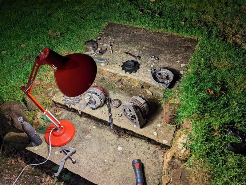

Rust Collector Posted April 7, 2022 Author Share Posted April 7, 2022 Another long post again I'm afraid - I find it hard to get in front of my PC to write stuff up as it happens! Seeing as I've got a million and one jobs on at the moment I thought I best do some tinkering over the weekend. Priorities were to remove the starter from the BX (this did not get done), find the source of the screaming/whistling noise that the Volvo has when cold (this may have been found) and replace the O rings in the coolant system on the Shogun Sport so that I don't have to borrow my Mum's L200 for towing anymore (half done). The main thing that I got done was procrastination, as for whatever reason when I set out with a task to complete, every other job that I've also got to sort becomes far more appealing. For example, one of the water troughs had been turned off for years as 'it needs a new float valve' according to mother. After taking this diagnosis at face value, this sounded like an excellent way to waste time. Sadly, it turned out that the float arm just needed bending, but it still meant I could waste time watching a trough fill. The upshot is that my mum doesn't have to drag a hose over to this now to fill it, the downside is I had to find something else to do to avoid doing anything 'proper'. Never fear, whilst fitting a latch to the gate recently (it had previously been tied shut with a chain and a lead rope added for maximum security) I noticed that the sign on the gate had gone limp. That seemed like a worthy time waste. Sadly it only took a bit of drilling and 2 rivets to sort. Cheap brownie points I guess if nothing else. Next on the list of things I can do instead of doing what I set out to do originally then; Lawn tractor drive belt time. The old belt was shagged and I overheated the tractor last time I used it. I bought a belt that should* have been the right size, replaced it, and it wasn't tight enough to work. I bought 2 different sized belts to hedge my bets a few months back, and put them somewhere safe... Wish I hadn't of done that! After about 20 minutes of searching, it turned out I'd put them in the logical* place that I would look for them next time. The fitting of a drive belt to this tractor is great fun* as the easiest method to get the belt over the bottom pulley is to start underneath at the rear and disconnect the driveshaft from the gearbox at the back axle. I hate spiders, so I did not enjoy shoving my hands blindly in here. I did have some help at least: I did eventually get it down the driveshaft and then fed around the cooling fan. The first belt was too short to get on the adjuster however. What is it that they say about a 50/50? I couldn't be bothered to feed it back the way it came, so I sacrificed the fiver it cost me and cut the belt off. Belt number 2 was then fed in from the back, and whilst longer than belt number 1 it was still pretty tight. Fortunately I had the belt fitting tool with me and with a turn of the fan she was on. Beautiful. Time to chuck the battery in that I had on charge then. Then it was time to snap the key The key snapped because part of the original key is also snapped in the barrel, which luckily means I can use the other spare key from my tool bag Occasionally a relay would tick, but there was no real sign of life on the dash despite there being 12v present at all the positive feeds on the loom. Some head scratching later and a wiggle of the battery leads confirmed that I just needed to fit a battery screw. Ignore the creeping green death, I'm sure that's fine*. All dash lights are present now, but the engine still wouldn't crank. I'm fairly sure it's a problem with the interlock handle/switch thing, but with daylight fading alternative measures were taken. This got her turning over, and she's spluttering out smoke like she usually does on a cold start, but she wouldn't fire. I reckon a bit of easy start will get her going, but that's as far as I got as a new job was added to the list. The horses were low on hay, and it had been floated that I'd be sent to pick up some bales. Luckily it was able to be delivered in which saved me going out, but seeing as I hadn't put bales on the healing trailer mk2 yet I thought it would be as good a time as any to try her out for size seeing as I had a yard full of bail to put in the barn. 4 bales is plenty I think! Paltry in comparison to the efforts of the chap who dropped them off, and had managed to get 11 on his Ifor. It will get us out of a stitch if he can't deliver though. I'll order some 10m straps so that I don't have to double up, and I'll then use my shorter straps to get some side to side action going on. I went for a drive around the tracks to see how the load behaved, it was interesting to see that the bales almost behave like a live load as they are all independent of one another despite being strapped down. It towed well all the same, so that's reassuring for the future. With that all out the way, shall we do some actual car stuff then? 😅 Oh, go on then... The Volvo was first up in line for some attention. I'd like to start using it again now the fuel pump is sorted, but one of the things putting me off is the shrieking noise it makes currently. It's hard to pick up on the video, but it's absolutely piercing. I reckoned it was probably the suspect looking emissions recirculation thingy on the left of the block there, expertly repaired by the last owner with tape. Removing it made no difference though. Next suspect was the p/s pump. I took the drive belts off one at a time, running the car inbetween, but this still made no difference. The noise was still there, and to my ear it's coming from the driver's side of the block. There's no moving parts there once the drive belt is off, and no air hoses there with the emissions thing removed, so I suspect I have an exhaust leak from the manifold or downpipe. The noise gets much better once the block is warm, so presumably as everything expands the leak seals up somewhat. I have some exhaust work scheduled on this, so I'll get the shop vac on the exhaust and have a leak finding session at the same time I fit the stock exhaust back on. Last night's vehicular entertainment was in the form of dismantling part of the cooling system on my Shogun Sport. I half heartedly started taking the plenum off a couple of weeks back, then other bits got in the way and it got put on the back burner. Let's pick up where I left her then... Urgh. I bloody hate the plenum on this. This coolant pipe here under the intake was the target: A blood offering was made to the car gods using the nearest bracket, and after much cursing the top half of the plenum was out Much better. Then it was just a case of fighting that coolant pipe out. The retaining bracket is bolted to the head just in front of the firewall, which is great* for access. I wasn't leaving without it though, and eventually she came out. I'll try not to think too much about how grim it is inside the coolant system... Lovely stuff. I'll be cleaning the pipe up to make sure it doesn't have any pinholes in it, then cleaning the receiving ends up. I've got some new o rings on order, hopefully this will sort my random coolant leak out as it's supposedly a common fault on these. If this doesn't solve my problem, I think I may have to start dicking around with an endoscope or something to try and figure out where this leak is. That's for another day however. Small amount of progress procrastination achieved on the BX also; I have worked my way through the existing radio wiring mess and installed the loom and cage for the Saisho. I would have taken pictures once in, but a) my phone went flat and b) the lcd display on the unit is buggered 😒 I should really clean the inside of the BX at some point, it is properly grim. The dog has contributed on the BX also, there was a rabbit underneath it at the weekend and in frustration at not being able to get to the rabbit he has started pulling the mud flaps off the car... Cheers Vito, that's just what the crusty sills needed! Another small diversion recently presented itself when my partner sent me this picture the other day (don't get excited) A drive to Brighton to change the wheel for her ensued, I left her on the spare for a day but it's not great so tonight I'll be putting the summer wheels on - this in itself will be a bit of a dicking around session as 2 of the better summer tyres I have for her car aren't on wheels, so I need to take the 2 most shagged tyres off the summer set and put the 2 decent ones on using the manual wheel destroyer tyre changer in the garage. I would like to swap the Insight back on to its summer tyres also, not sure if I'll have the time/motivation for that tonight though as I don't have a spare set of wheels for it currently so it means removing/refitting tyres from each rim. I'd prefer to tackle that once I've got a spare set of steelies to mount the winters on so that it's all done in one go. I promise I'll do some work on one of the interesting cars soon! 😅 wesacosa, juular, Dyslexic Viking and 7 others 10 Link to comment Share on other sites More sharing options...

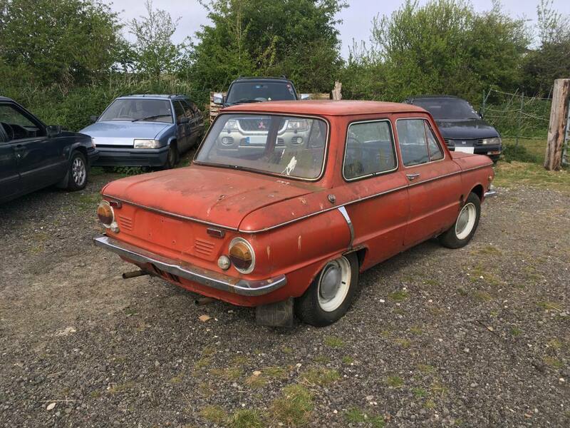

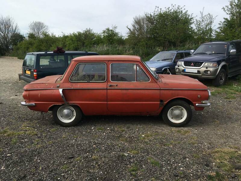

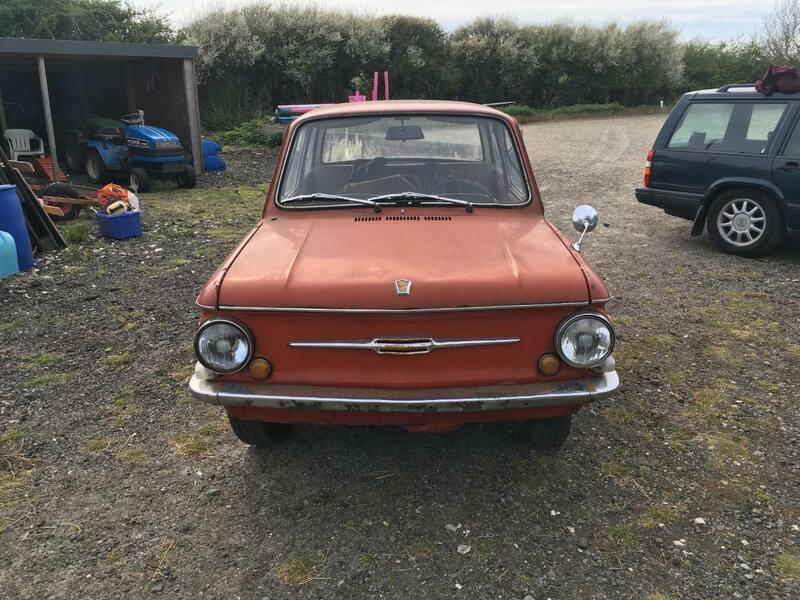

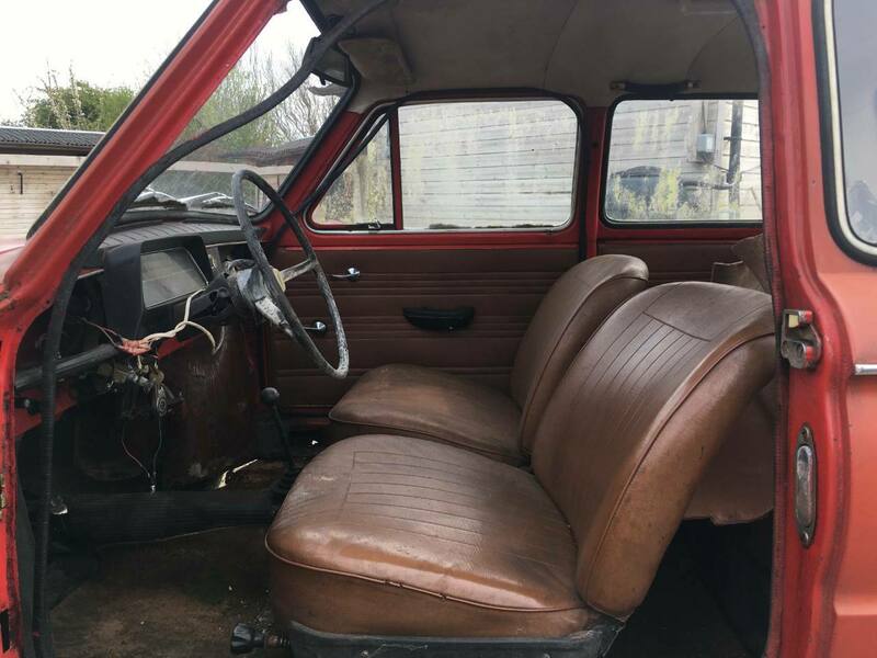

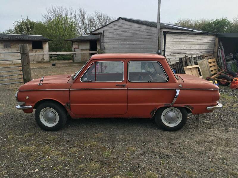

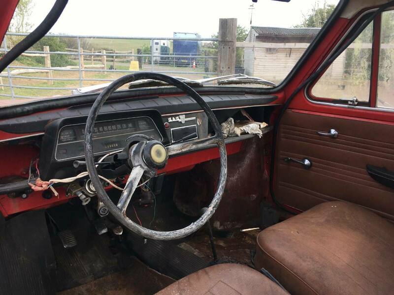

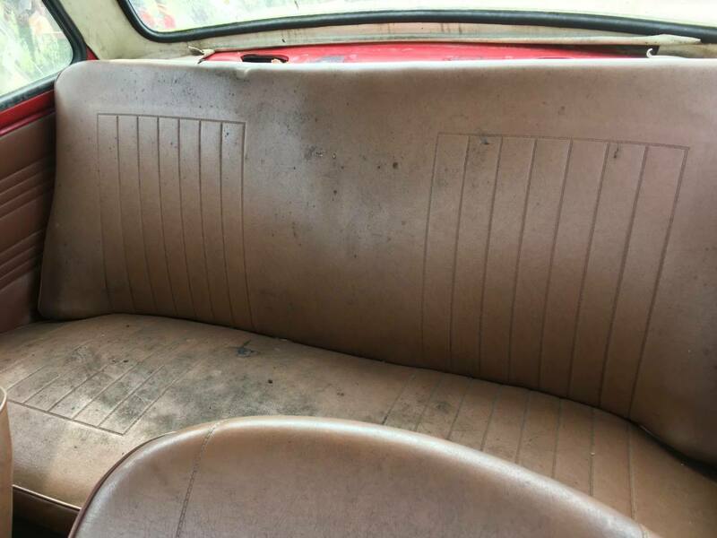

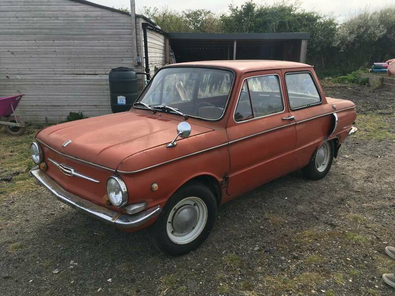

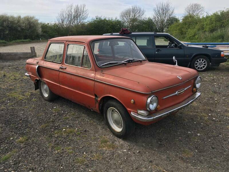

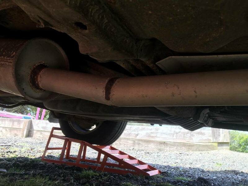

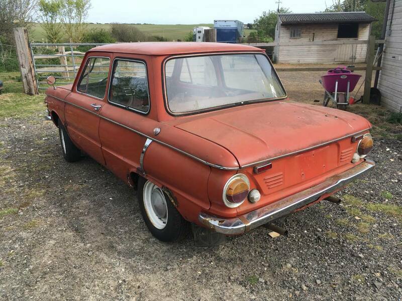

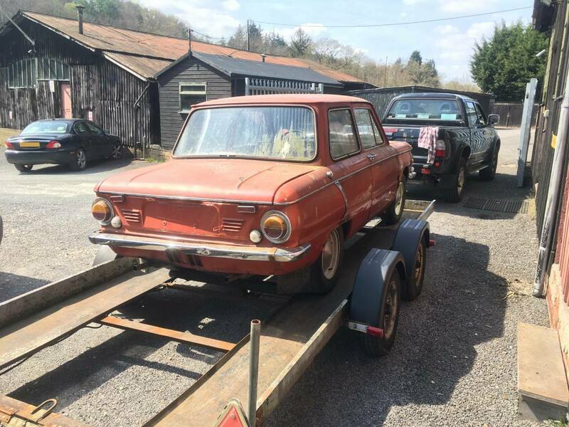

Rust Collector Posted April 25, 2022 Author Share Posted April 25, 2022 The problem with getting things done, is it drastically reduces the amount of computer time I have... Apologies once again, as I've got quite a lot to post in order to get caught up! First off, last weekend I took some photos of the ZAZ to document the condition she was in once she landed. Here she is in all her glory: A few goodies were stashed in the front: The big silver tube is the cabin heater, which appears to burn petrol using a glow plug. I'm sure this is totally safe* however I think it's best left unplugged for now. The brake master cylinder is seized but happily it appears to be the same generic FIAT unit that my Zastava also uses which is readily available from ebay etcetera. The motor is pretty cool; it's my first air cooled car, first rear engine car, and first V4 all in one! I reckon the exhaust will sound pretty interesting. The last bit of weirdness to point out in this installment is the wheel PCD and centre bore... The drums protrude through the wheel, and there is a flange round the edge that the wheel bolts to. From technical drawings I've looked at, this flange is square... the obvious choice of shape for a rotating component! To do list for the ZAZ currently is to sort out the ignition wiring so that we can crank the starter (currently this is achieved by shorting the red wire poking out the rear grille), sort out the steering wheel so that I don't get tetanus, replace the brake master cylinder and see if the wheel cylinders are fucked. If they are, the rears are ok as they look like they've been knicked from the FIAT parts bin, but the front drum has twin leading shoes and the cylinders look like proprietary parts - I may need some help from the hive mind on those, I'm hoping someone may know of a car with a similar setup that I can rob parts from. Worst case scenario parts can be ordered from Russia, but they're not cheap and I'm assuming that could be a slightly awkward process currently. Seeing as my mum and her horsey friends will be mostly enjoying seeing the ZAZ whilst they use the sand school, my brother and I gave the car a wash to make it slightly less unsightly. If you stand a distance and squint, it's kind of alright... Whilst we had the cleaning kit out, I gave the seat a rub with some vinyl cleaner - I think it needs a bit more than my half hearted effort, but it took the grime off at least so it feels less disgusting to sit inside. I also had to have a play with the dual action paint destroyer to see if I could do anything about the cloudiness. I mean the paint is absolutely fucked, no two ways about it, but shiny and fucked would be better at least... Errr... Tests inconclusive. We hand balled it back behind the stables to let it get dirty again, and then there was nothing* left for me to do but to finally sort the welding out on the Zastava unfortunately. Lots of photos of the progress on that to come next! LightBulbFun, juular, mat_the_cat and 16 others 19 Link to comment Share on other sites More sharing options...
