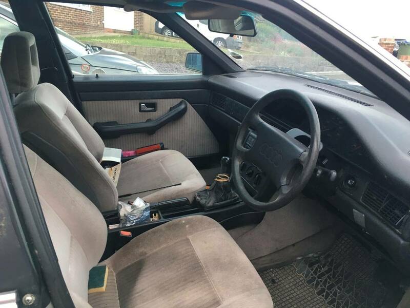

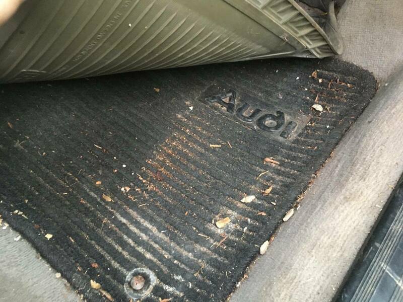

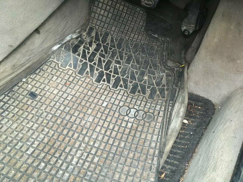

The interior is a bit grim, and will need some attention from the Bissell.

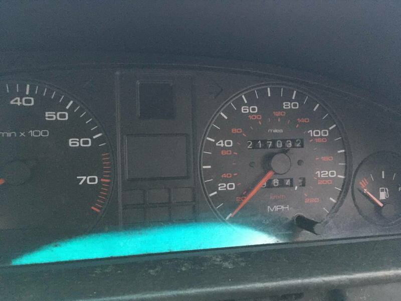

High mileage club
Doubled up with a rubber for extra protection:

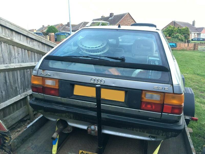

At this point the car was still lodged firmly on the trailer. This was not ideal, as I do not like drawing attention to my shite collection at the house, lest the other locals pick up their pitchforks and torches. You can see the haul in the boot here, and the problem I was having trying to go backwards off the trailer.

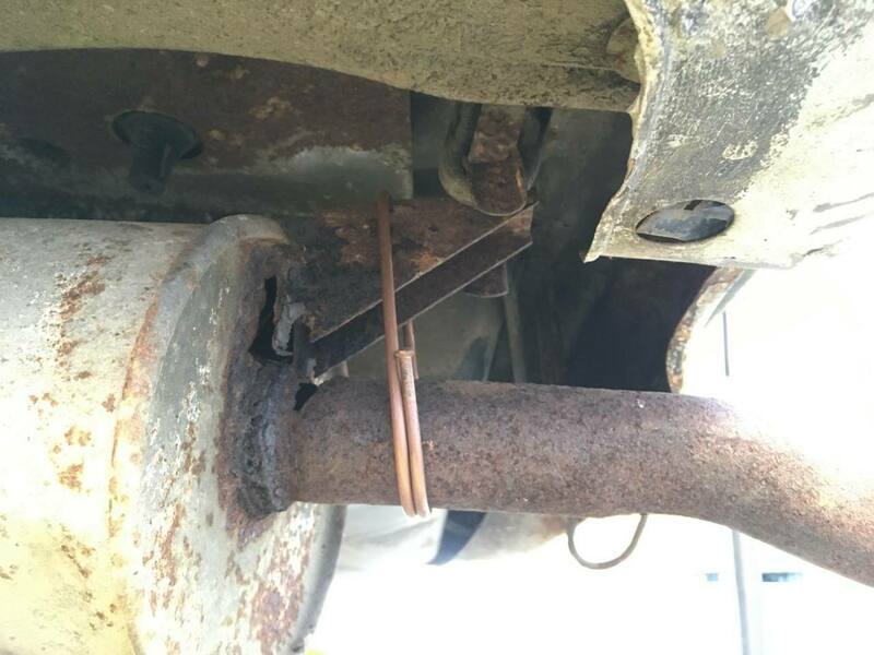

Ah yes. Exhaust fell off in transit. That will give you a bad time that. For full fuckery mode, it was caught on both sides of the trailer chassis. No choice but to remove the ramps and climb in, against my better judgement.
In the absence of exhaust hangers, a ratchet strap was run through the cabin and under the car. It worked, which was a result.
I then ordered some high quality* older VW style rubber hangers from Amazon. Once they landed I set about reattaching the back box to the mid section. The back box was pretty fucked so I had to improvise on that too...
At this point it was together enough to survive cranking it off the trailer on the starter.

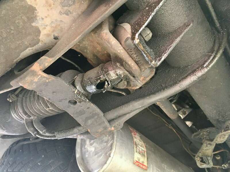

When I drove the BX up the lawn I raised the suspension to the second highest setting to clear a drain cover in the middle of the front garden. As I got to the top of the lawn, there was a loud bang and a cloud of something spraying out the side of the car. Then the arse end hit the deck. Oh dear...
RIP HIGH PRESSURE PIPE U IZ WIV DA ANGLES NOW

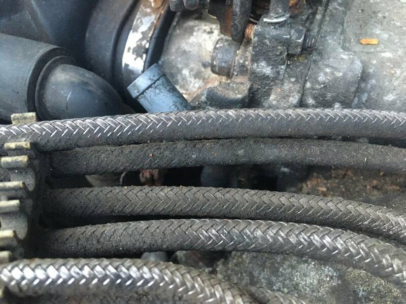

On thing that I noticed when trying to start the car previously was that the throttle pedal would stick. Best check the throttle then...
Lovely stuff. I removed the throttle body, and five pounds worth of carb cleaner later it was back on looking like this:
It was still pretty sticky though. I'd love to get it back off the car and put it through the parts cleaner/dishwasher. Whilst staring at it in frustration, I had a memory of something I had been given years ago.
Why, hello there! I had a spare throttle body from an early Golf GTi that I was storing at work 'just in case'. I was convinced it would work...
They're the same, but different... Oh well. I looked at swapping bits around but it looked like a good way to destroy two hard to replace components. The original TB went back on.

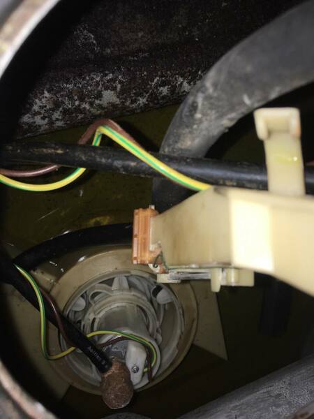

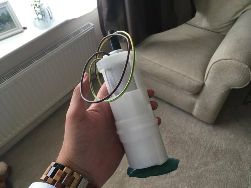

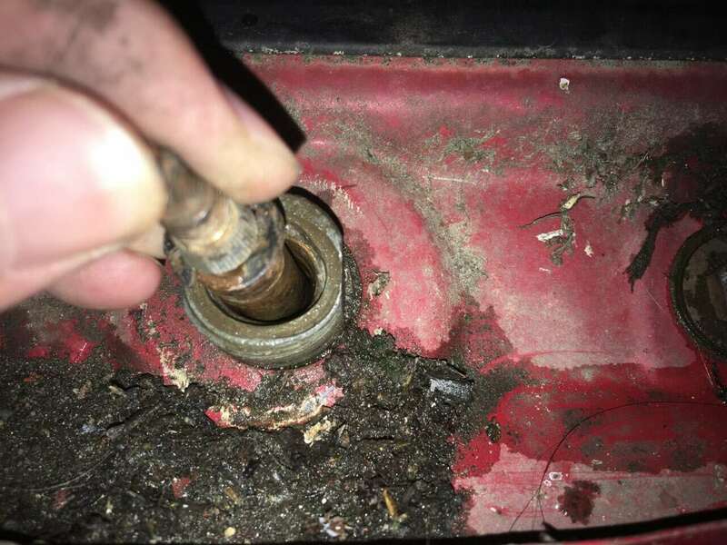

Further investigations revealed that there was no sound of the fuel pump running. This meant emptying the boot:
The last owner really liked ropes it seems. Probably best not to ask what a man who lives in the woods does with a cavernous estate car and about 30 lengths of rope.
Beneath the rope there was some kind of car interior and rodent soup
Delicious. I wasn't fucking around with that, and the boot well is a plastic tub bonded in to the metal chassis, so I just drilled a hole in the lowest point to drain it. We will never be able to get to concourse standard now...
In to the tank we go then
I did try directly powering the pump, but it was totally fucking fucked, big time.
Haynes says to use 'the special Audi tool' to release the locking ring.
Ah, yes, the special Audi tool!
And we are there!
This thing was fun*
Those rubber tubes are all that hold it together, it is very flimsy. I managed to make it fall apart in the tank and got to enjoy* fishing it all out.

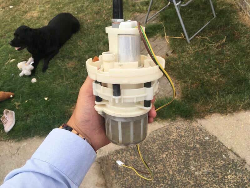

Getting the pump out was the last thing I did before going on holiday. Once I back I looked around for a replacement pump. Secondhand ones were silly money and a new Pierburg one was about £250-300! I elected to go for a high quality* Ridex pump through Autodoc instead, to the tune of about £60.
The cradle was different, but it was removable and the pump itself fitted fine in the original cradle. Top tip, don’t fit it in the cradle before putting it in the tank, you’ll fight it for ages with everything falling apart constantly.
After a long time fighting, it was finally all in place. It’s definitely one of the most frustrating jobs I’ve done in recent memory. With your arm in the tank you can’t see what you’re doing, trying to assemble the cradle by feel and then insert the pump was just an absolute shit show.
Turning the car on produced reassuring fuel pump noises. I cranked her over, and she spluttered to life. The reva then ran away, then she nearly stalled, then ran away, then nearly stalled…

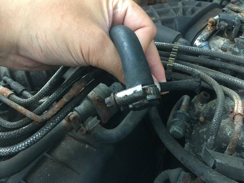

I fired her up again, and now she ran steady but idled at 2500rpm and the alternator belt was squealing like mad.
Adjusting the alternator was quite easy once I got my head around where the adjuster was, access is from underneath and it has one of those toothed nuts for tensioning. Thankfully* I’d removed everything above the alternator before I realised this. 2 spanners on it and we were sorted.
Starting her up, she now ran up and then immediately stalled… turns out the idiot who left the vacuum hoses off also disconnected the idle control valve plug when examining the alternator, and didn’t reconnect it.
With the plug reconnected, I was back to starting and idling at 2500rpm. I removed the ICV and cleaned it but it still idled at 2500rpm. I removed it and on inspection I could see that the valve didn’t close fully and had some play in it too.
To test if air flowing through this circuit was causing the high idle, I 3d printed some plugs to blank the hoses. I thought this was very clever, however my mate pointed out that I could have just cable tied glove fingers over the hoses 😅
Success:
It starts and briefly idled at about 1250rpm. It then stalls shortly after, as I’m assuming that the ICV should take over. I’ll get a new valve ordered, and go from there.

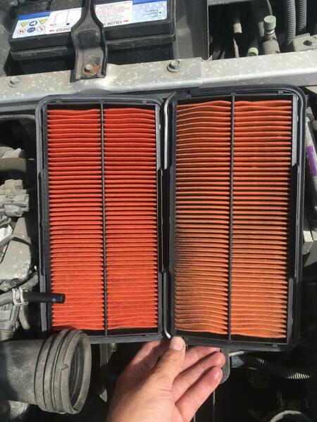

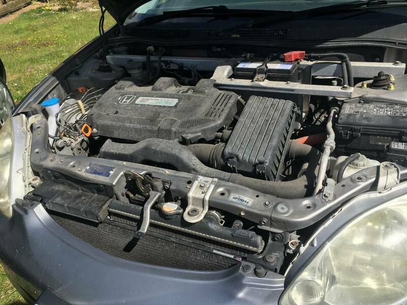

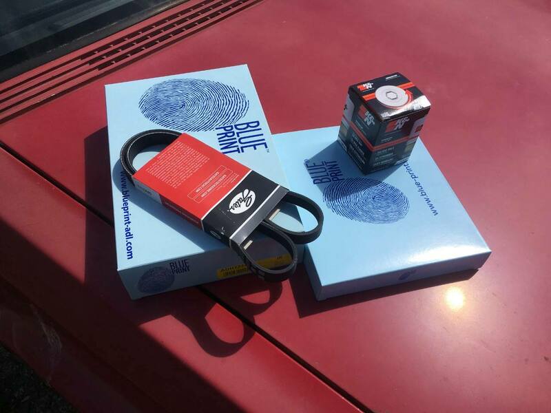

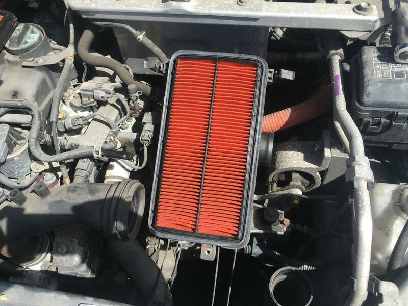

Air filter first:

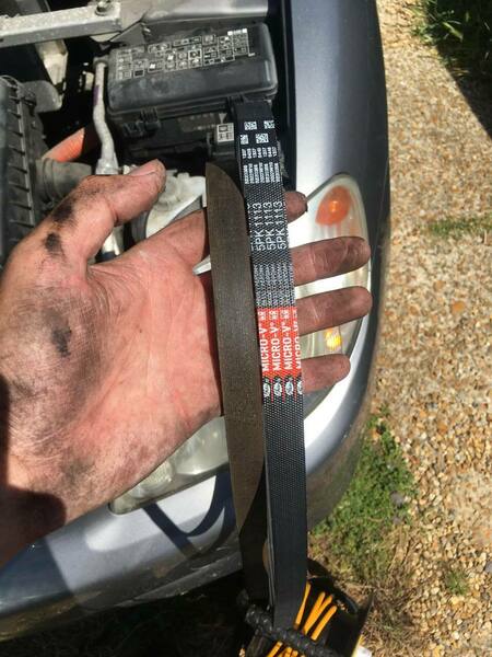

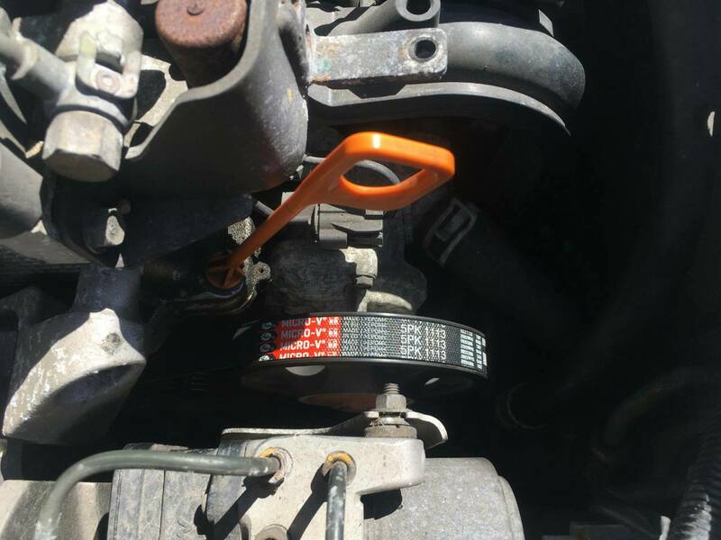

Aux belt:
The tensioner on this was a ball ache to access from above, but we got there slowly.
Dress up plastic back on:

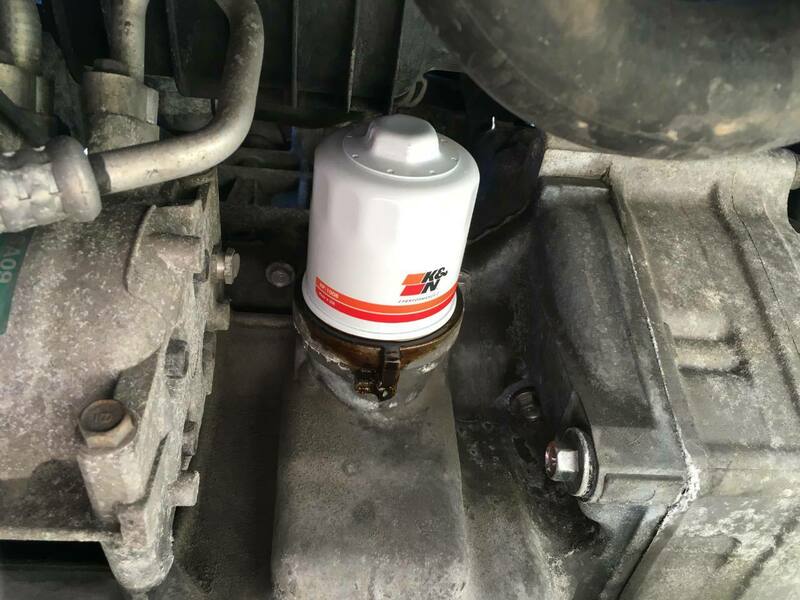

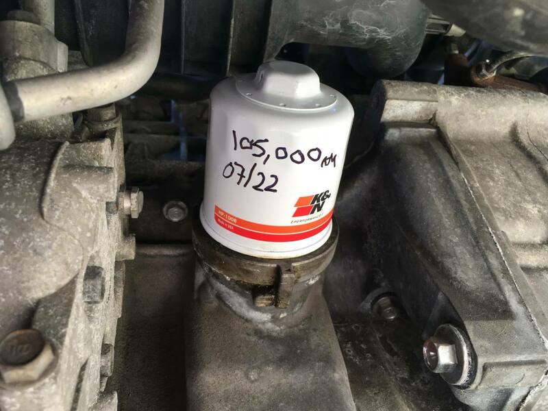

Best go underneath now for the oil and filer. 0W20 for this motor apparently!
Be sure to write the date and mileage upside down in a place that you'll never see it again.

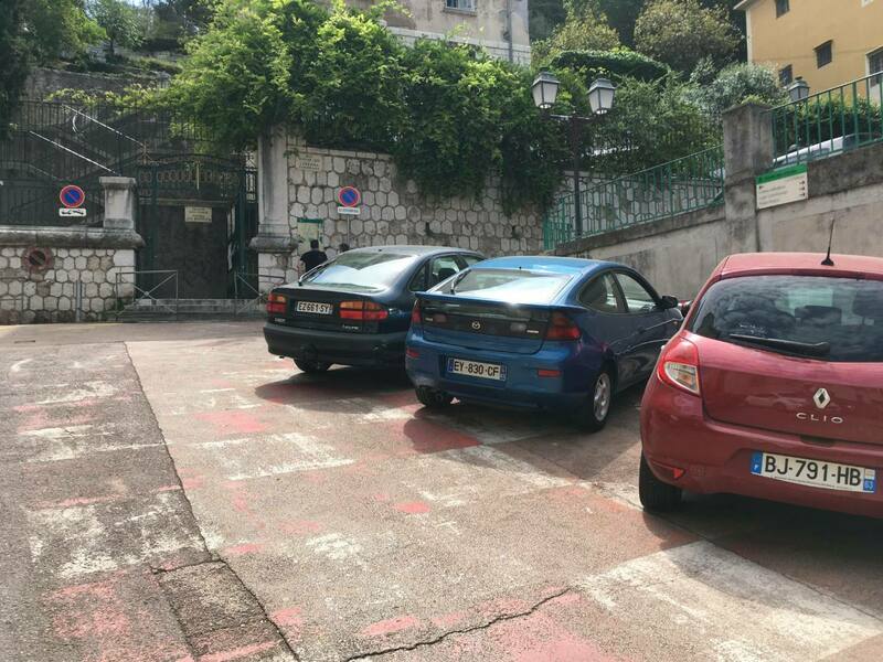

I was excited about the 323 coupe, and as it pulled forward I was treated to the additional excitement of a Laguna:

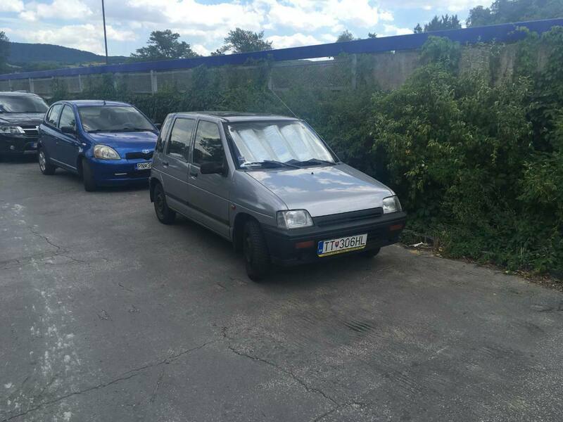

Mirror spot Daewoo:

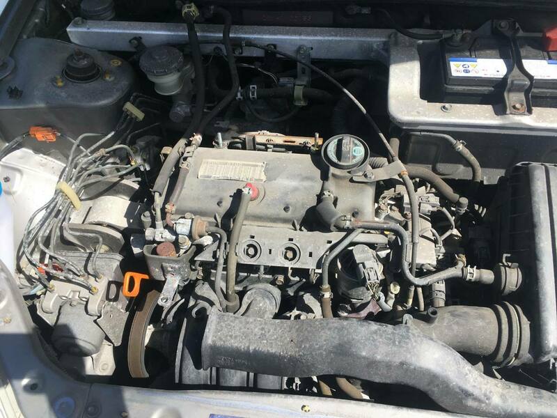

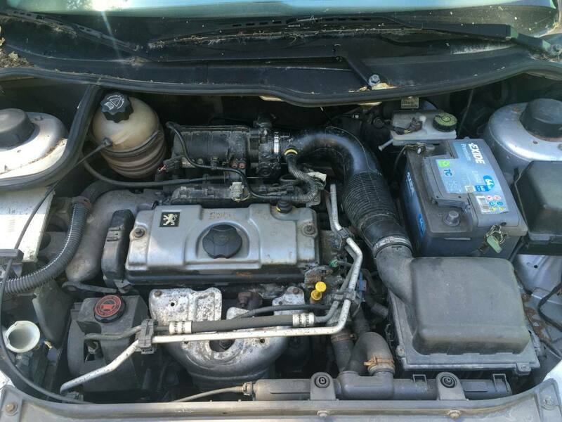

Mother-in-law asked me to start up her spare car and check it over. Start by trying to get in the wrong side:
Check for TK and EK, presumably ANPR is not a thing here:
Full service mystery:
The fluids are where they should be, and it started first time.

It possibly* wasn't what she had in mind. I'm lucky that she's quite calm with the cars, but I'm not sure that she's sold on this one as a family wagon. I think I was colouring outside the lines a bit on this one... In its favour though; it's economical on diesel, the cabin is large enough that you can have a rear facing baby seat in the back without impeding the movement of the front seats, the boot is big enough for the dogs plus a pram and bags etc... if it was 1988 again then it probably wouldn't be a bad choice!
She was pleased with the dryer though, so that's one good decision I made today.

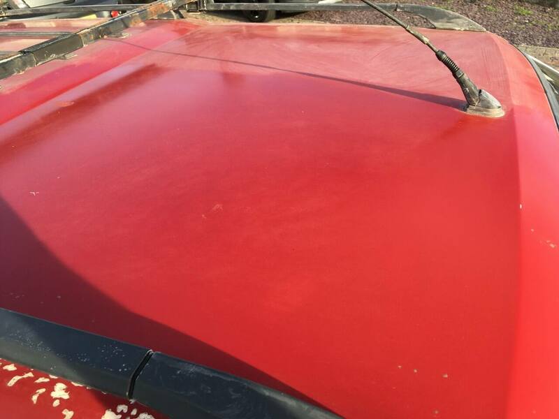

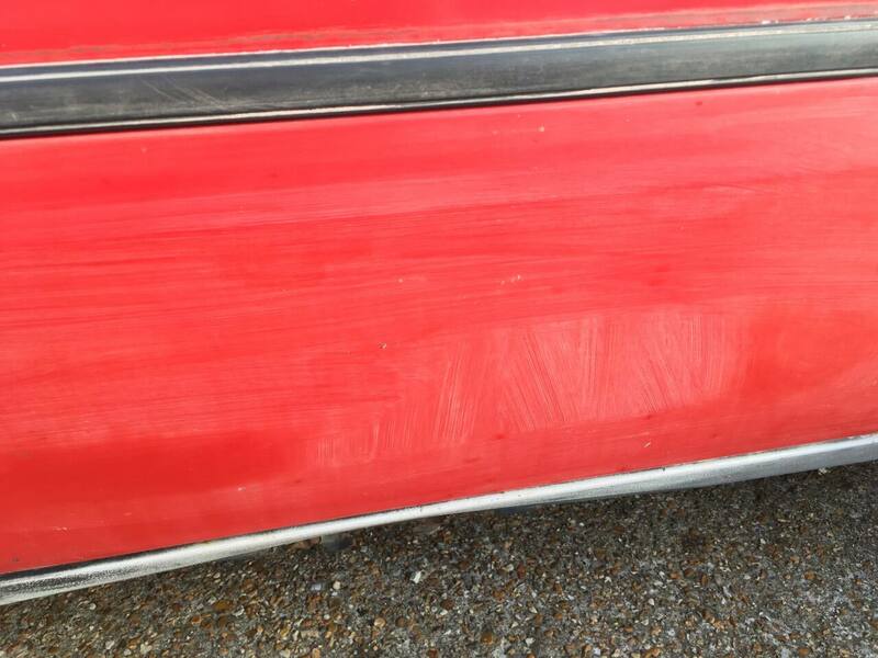

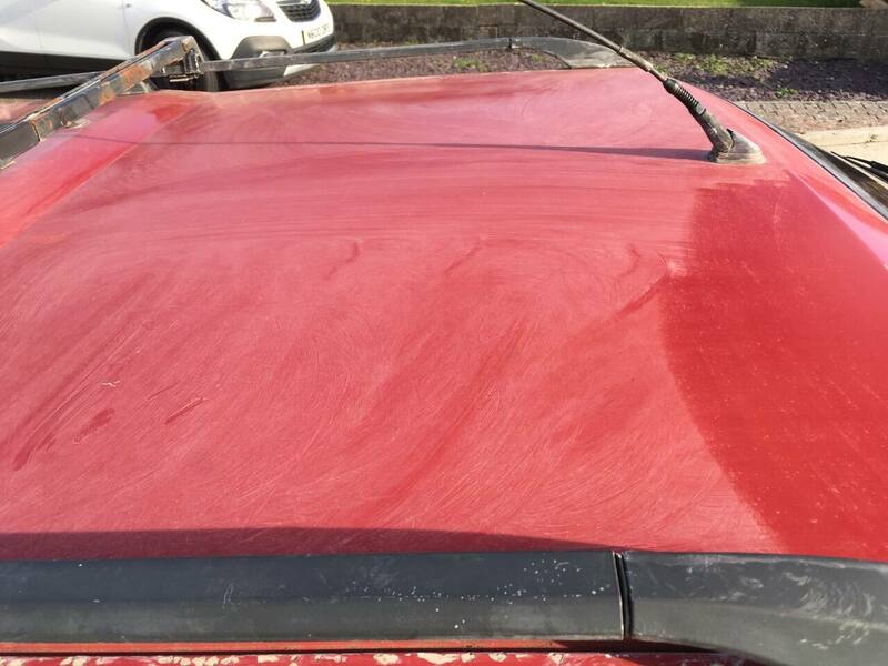

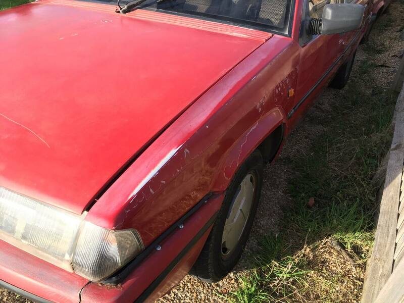

I had a better chance to look over the car once we were home. I knew the bodywork was fucked, but the previous owner kindly polished the car before I collected it and left most of the polish on:
A microfibre cloth took most of it off, but some needs more effort on it and also all the plastics have been polished too - any tips for getting polish residue out of black plastic greatly appreciated.
looks better* with the residue mostly removed at any rate
There’s an impressive level of random damage and bodged repairs to the bodywork:
I had a bash at setting the park position of the wiper, then realised that part of the mechanism is flapping in the breeze. I will probably borrow* a mechanism from another BX for now.

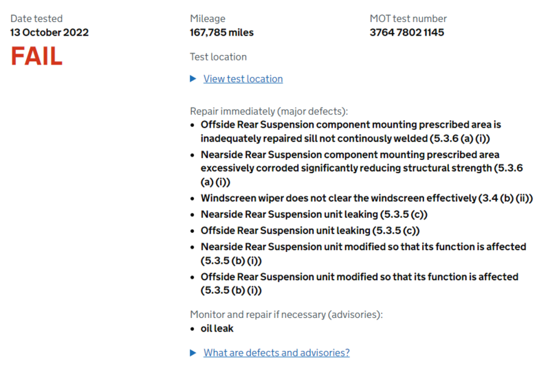

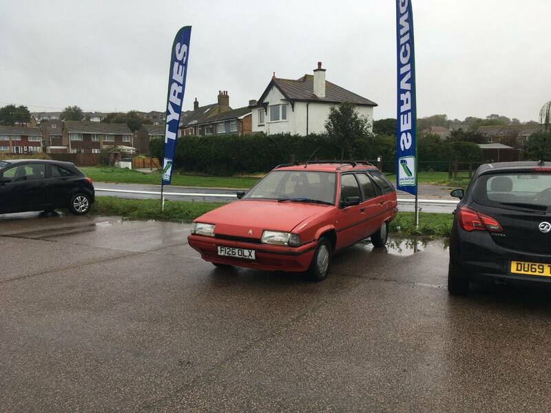

As mentioned in the news 24 thread, I took BX 3 in for MOT:
BX 3 did not pass
Not to worry, I put it in early we are expecting our baby at the end of the month. Lots of time for MOT work…

Next up was the suspension. By ‘modified suspension’ the tester meant bent brackets and torn boots.
Someone has jacked the car up from there by the looks of it, and bent that brace upwards. It’s been snagging the boot and torn a hole over time.
Best take the boot and rod out then. I was glad to find you can do this whilst leaving the hydraulic cylinder in place. You may wonder why I’ve included a picture of a clip, but the information I saw online without pictures made a fuss about the pins and I’d imagined something hideous…
Luckily the car is equipped with a work bench
I used the usual fine adjustment tools to open up the clearance between the brace and moving parts
I’m sure that’s back to original factory specs now, how could it not be! Putting everything back was fairly painless, and look at all that delicious clearance.
More of the same on the other side:

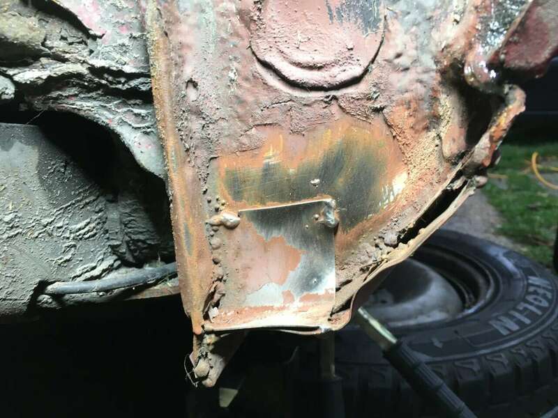

That’s a bit shit that… ideally needs cutting out and starting again but at the time I was still trying to rush it through a ticket so I just cracked on and put a seam in anywhere that I possible could, then chucked some paint over it. No pics as I did this in the rain after work on one of the nights we had a big thunder storm. If I remember tomorrow I’ll take some and add them back here.
I then started to look at the other side:
Mmm, crusty. But wait, there’s more!
This is what I planned to take out as an offering to the man from the ministry:
Again, you could go further up the sill but I was on a deadline. I’ll go back in later for the wheel arch and door pillar.

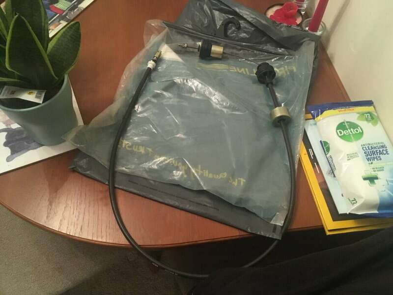

As a reward for my laziness the clutch cable on BX 3 snapped as I pulled in to the petrol station to chuck some diesel in the car. Bollocks.
After a bit of flapping initially thinking something had properly broken, I realised I could just commit gearbox abuse and drive home without a clutch.
I then realised it wasn’t too hard to drive the BX without the clutch so I turned back to the shops and got my beers.
Sadly this did fuck my retest window, but what can you do.
I ordered a cable and set to work. I believe that whoever did the welding has also been in here, chewing up the bolts and fitting the wrong clutch cable…
Once the new cable was here, the fun* could begin
This would work, if I knew where the cable should go
I did not know where the cable should go, and where it went was not right. I got to take it all out and do it again which was lucky as I’d really enjoyed it the first time.
*scene missing*
After lots of swearing it was finally in…
for anyone wondering, this is the access from above:
Can’t see where the cable goes? How about now:
Maybe now?
At any rate, I put all the air intake gubbins back and I’m pleased to say that BX 3 now starts and drives again. The clutch biting point is now much better and you can select reverse without hearing the gearbox having the life ground out of it.

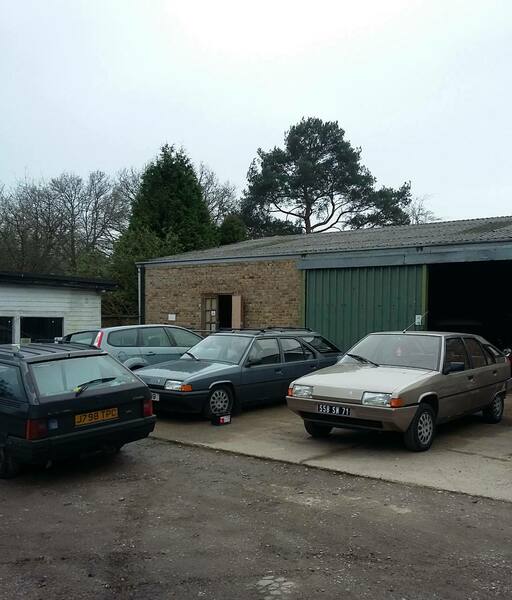

Allow me to introduce BX 4 then:
It’s a 1989 1.4E Leader. From chatting to the couple selling it, it was their father/father in law who owned it from new. He hung the keys up in 2019 as he decided he was too old to drive it - at 96!! Sadly he has since passed away, and so the car needed rehoming and recommissioning.
Partner approval was given, a deal was struck and a deposit has been placed. This one is going to be landing with me sometime in the next month or two as the couple selling it live up North, and they want to sort the plate retention before letting the car go. This works for me as it means I can have a driveway reshuffle in the meantime and do some fleet rationalisation too.
In the not too distant future, expect to see BX 3 being made available (I suspect most likely by roffle due to the incredibly scruffy condition) and the ZX diesel estate having the rear beam replaced and being made available too. Here’s the ZX in better days:
BX 4 will become available once recommissioned too, as in all honesty it’s not quite my thing and it’s too nice to sit up at the farm filling up with nests!
