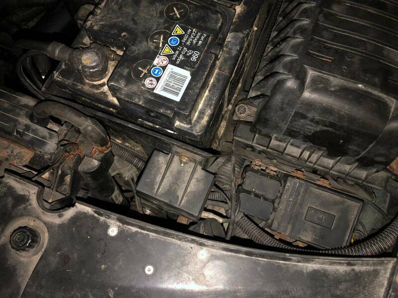

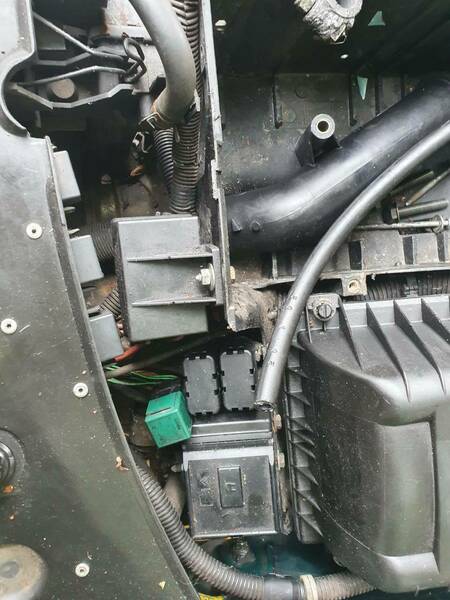

Glad the suspension is behaving.  There should be a fuel primer somewhere which should help the starting if you have an air leak.  Its either a button on the fuel filter housing for a bosch pump or a bulb near the front of the engine on a Lucas pump.  If the glow plugs are also buggered the good news is they are cheap and easy to replace.  The XMs are also prone to and sensitive to injector leak off pipes failing so another possible source of air in fuel/starting woes
Also there is no stability light, its ABS. main culprit is the relay as it hangs in the air in front of the battery tray and is exposed to damp and dirt.  If its not the relay but an actual fault with part of the system the light should blink when you turn the ignition on, before staying on.  If it doesn't blink its a fault with the system powering up (so likely relay or ECU)  I have all the diagrams for relay pins and ECU pins somewhere if you need to do some diagnostics

access is ok to the glow plugs once you take the inlet manifold off, which is 4 bolts , a jubilee clip and an R-clip.  I think one was a bit fiddly but I have fists of ham and I managed to do it without drama.  They are also the nice fat glow plugs that don't tend to stick and snap.  The glow plug relay can also give problems so worth ruling that in or out too.  I am not sure if the leak offs piss fuel or just get a bit porus and let air in but once the manifold is off you get a good look at them too.  Its also wise to check around the back of the cam cover gasket at that time too as its a big leak path given how canted back the engine is

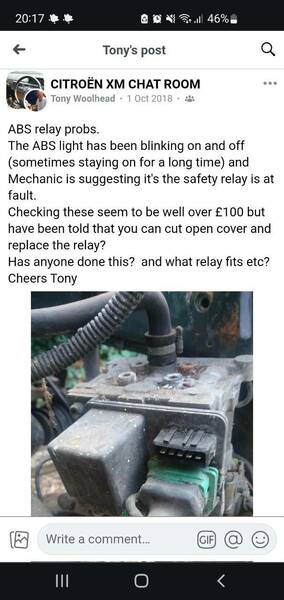

For the ABS module I am taking a leap of faith that you have a later Teves unit and not a Bendix unit. If its a Bendix ignore everything I say next as I have no idea about that system......

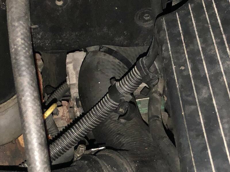

The blinking of the ABS light is quite subtle, it just does it at first key on and then stays on.  The relay is a green relay hanging in space
think its used on other Citroens of the era but its a 4 pin plus one small pin for the light so a normal automotive relay won't work, but a more readily available BMW one is a straight swap if its dead, but its often the pins and connector and not the relay itself.  On the Teves system the EcU provides the earth on the switch for the relay , which in turn activates the relay to send power to the main circuits of the ECU and to turn off the light. Problem on mine is that its not commanding that earth to swich the relay

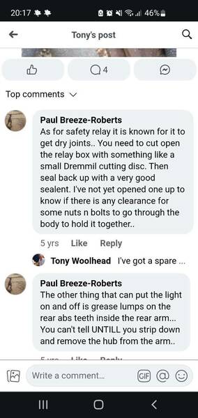

if you are not sure what abs you have, I'm pretty sure* the Bendix relay is different colour and or/location but if its not then peer down at the ABS pump. if its in front of and below the battery tray and has the ECU attached to it then its a Teves.  The Bendix ECU is remote I think but not sure where
It's under and in front of the battery tray.......

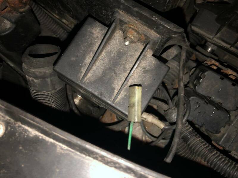

I think I may have a bentdick as I’m missing a relay:

This is my ABS pump. Possibly.
ZOOM AND UN-ENHANCE

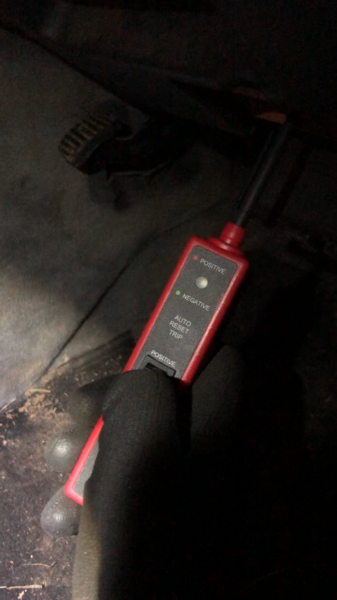

You were right about the diagnostics though. When I turn the ignition on, a relay clicks twice, then the ABS light blinks once and stays on.
I did some Googling on my dog walk and I’m about 3% more informed on the matter than I was before I left. I’ll try and lookup the codes, and what system I have.
I think 95/96 was the changeover to Teves so could potentially be either. I think when I took the photo of my green relay I had fished it out a bit as it was probably dangling under those relay boxes so worth a look under there.
As I say the sure fire way to check is to see if the ecu is mounted directly to the abs pump
That doesn't sound pleasant
5 minutes ago, wesacosa said:
Bendix
Yep, that’s me there. The big green plug was what I plugged back in. It didn’t click in place, and it felt loose, which is always good.
Is that the type with unobtanium sensors or have I lucked out?
I think the Bendix ones are the difficult ones to get but not sure if there's another to use or not. One for the XM forum I'd say.

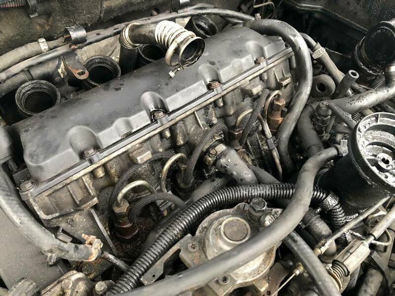

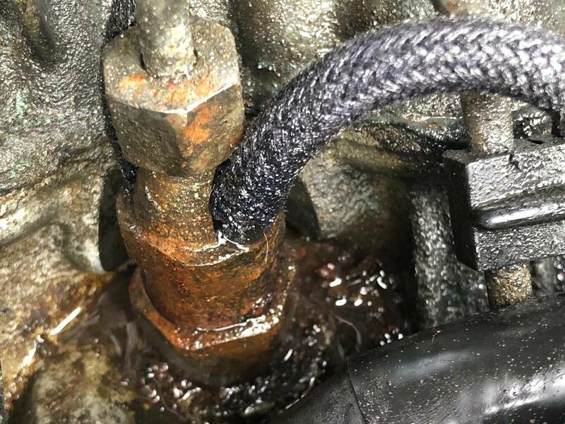

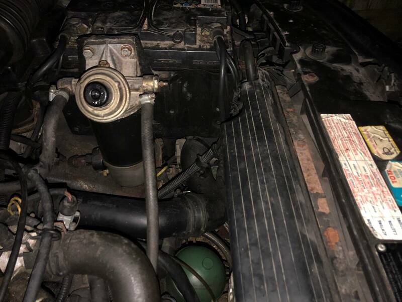

The hunt for diesel leaks continues:
The spill off pipes weren't looking good so they got replaced.
Air is still leaking in so we are getting closer and closer to the inevitable replacement of the pump.
I did check the glow plugs, and found that they all appear to be working, as is the relay.

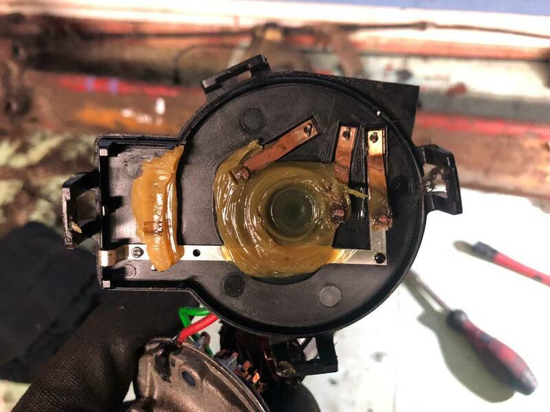

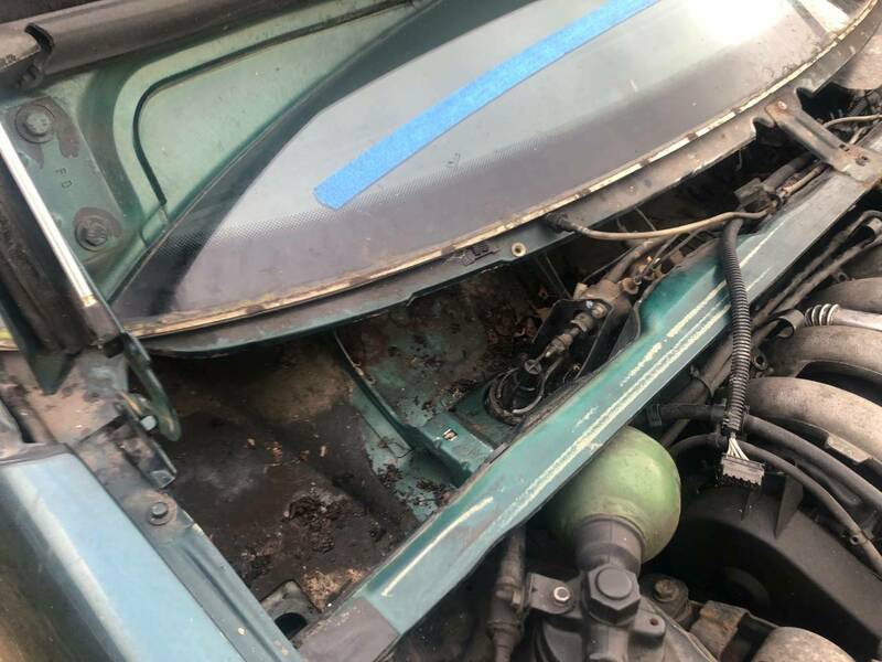

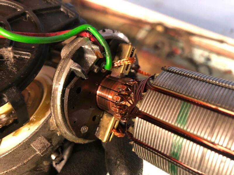

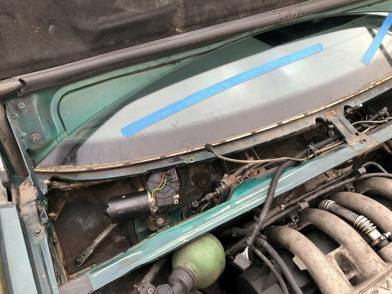

Lazy wiper mechanism then.

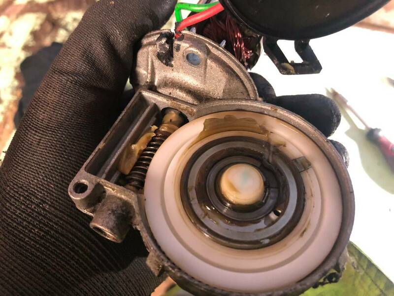

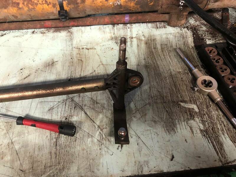

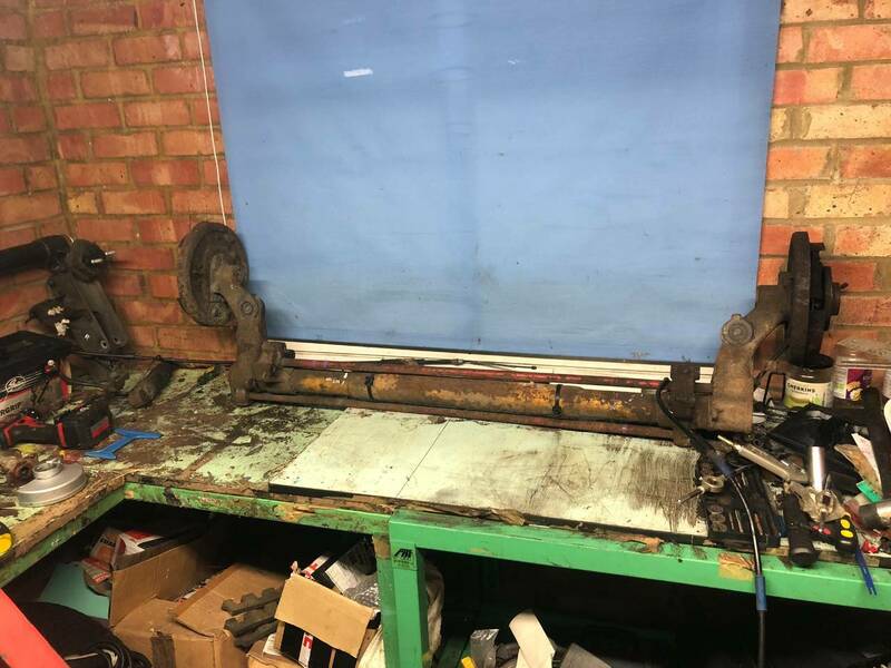

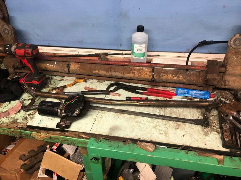

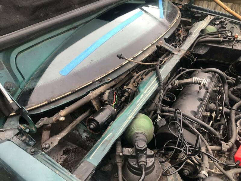

This was an absolute wanker to get out. Removing the linkages and putting the bonnet in service* mode was the answer:
I celebrated the liberation of the wiper mechanism by jabbing a pick through my finger.
Savlon applied and it was time to get the thing on the bench.
Fuck.
After some top tier throwing everything on the floor, we had somewhere to work.

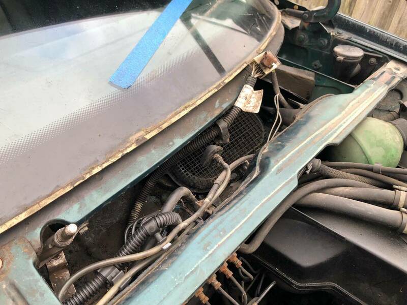

The fault was that the passenger spindle was seized cock solid. It received some hammer love, everything was cleaned, greased and rebuilt.

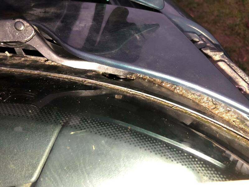

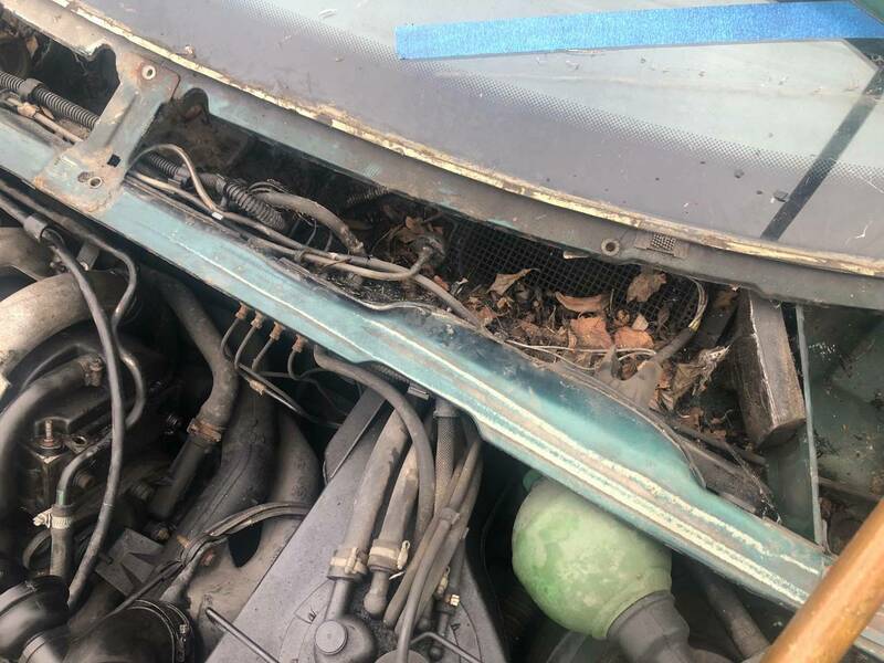

The scuttle was full of nature and shit
So I hoovered that out rather than ignoring it like I normally would.
Refitting is the reverse of removal, i.e. more fucking misery.

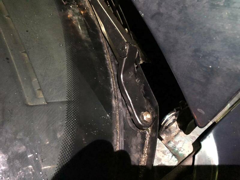

The linkages have to be pressed back in once the main assembly has been put in. Water pump pliers were handy for this.
It turns out the old park position was miles out. That'll fucking teach me for being proactive.
The good news is that the wiper mechanism works beautifully now on all 3 speeds.

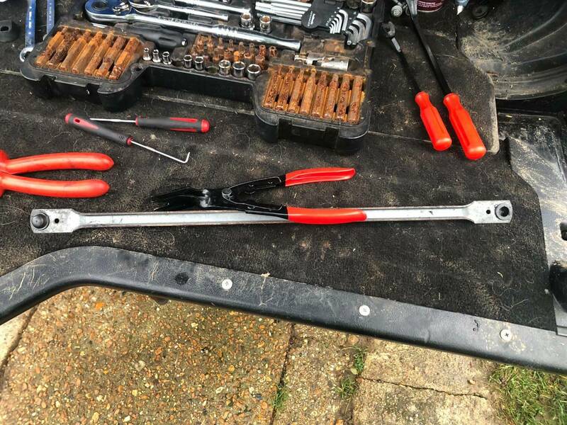

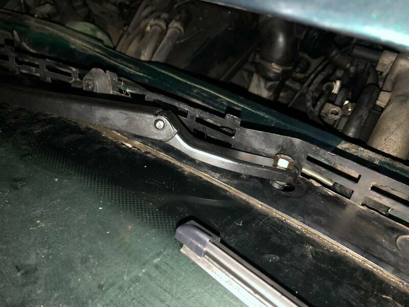

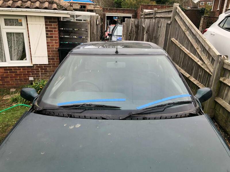

The bad news is that something doesn't line up quite right. The driver's side wiper arm knocks on the scuttle panel when it parks.
That photo is misleading but it's all I've got - it's actually the raised section with the pivot that strikes the plastic.
'Just move the arm on the spindle!' I hear you say.
I tried that - one more spline up and it doesn't strike the trim but it does sail off the edge of the screen at the end of travel. That's not good.
I tried swapping the arms around and the driver's side is then fine and it's the passenger side that strikes the trim. If I had two arms like this I'd be a freak of nature I'd be laughing.
It's this bendy one that's fucking me:

An update on the ABS - I'm told that the single blink I get means that there is an issue with the power relay. I'm not sure what to make of that as I didn't think my car had a relay.

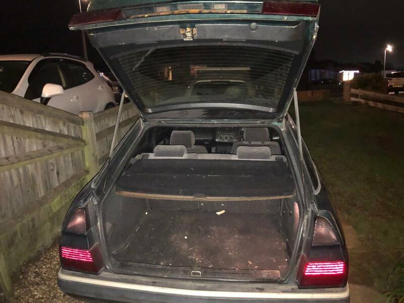

Oh, I also forgot to add that the boot now won't open for some reason.
I'm not sure if the problems are decreasing or increasing on this one...
I will have a look at the wipers tomorrow
I sometimes have issues with the handle not opening the boot. I think its something to do with the central locking. It usually fixes with a few lock/unlocks, or should still open with the key
I may be wrong but is the relay mounted on the pump body?

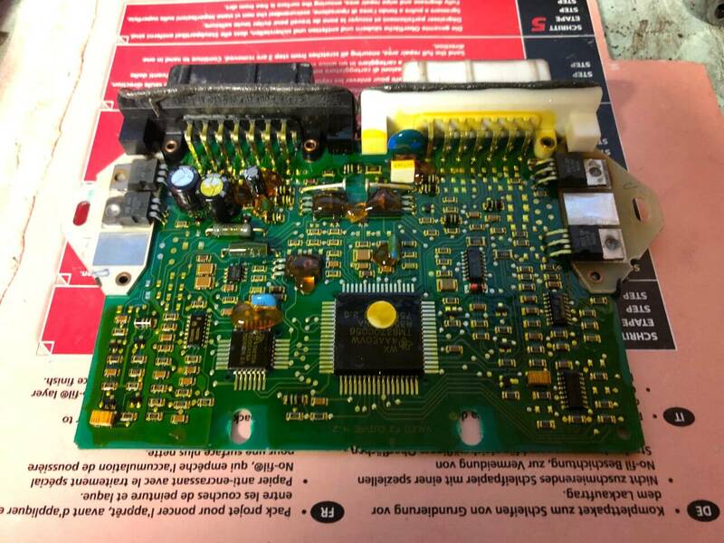

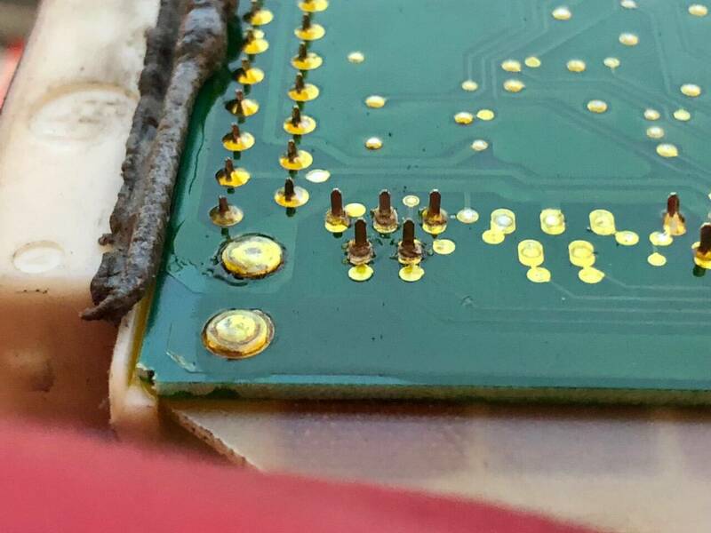

I had a bash at replacing the capacitors this eve.
I removed those three capacitors, cleaned the board as best I could and soldered 3 replacements on:
Still not working though. Tested the other capacitors and there’s a short at the terminals of this one:
but I’m unsure if that’s to do with the microcontroller.
I removed a capacitor to look at the board damage again:
I think I need to solder a jumper wire between these two tracks:
It’s possibly too far gone to save, but I’ll still give it another go.
Apologies if this has already been mentioned but holy oof! Never good when you find advanced burnage like that. With that shorted cap you've found, you'll need to desolder it and then test the same spot on the board and see if there still is a short. With that damaged and burned area though, I'm suspicious of that chip that's mounted to that heatsink. It may have failed short which has caused those tracks to lift and burn up. It looks to me as if it once looked like this:
A fibreglass pen would do wonders in scraping away all the charring and further revealing where everything used to connect to. A schematic diagram would be a godsend in this case.
Thanks mate.
My first instinct was to hammer the central locking but it didn’t seem to help. I’ll try again next time - the boot doesn’t feel properly latched so I’ll try sitting on it too. Maybe it’s not making enough contact or something.
Yeah I’ve just been out and looked after you posted those pictures… relay is on the side of the pump. Fucksticks.
Thanks mate - from memory the black area in the centre is a crater in the board 😳 but yes, would be good to clear up the tracks around it. That’s probably been pushed a good couple of months down the line now though as the water pump will take priority along with more XM and Proton fettling.

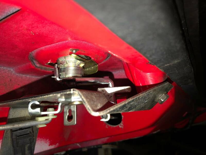

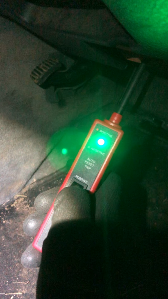

On mine the boot issue is really odd. you pull the handle and it clicks and depresses and almost feels like its opened it, but the boot just doesn't open. Try the key if the handle doesn't work, but make sure its pushed all the way home or the lock just spins

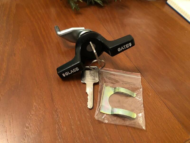

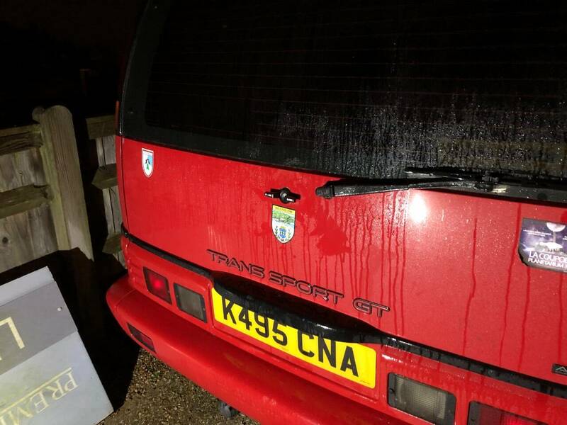

Speaking of Pontiacs, the chinesium boot handle arrived recently.
Perfect.
Up until now, the only way to get in the back was to shove my finger in the hole and give it a wiggle.
BEHOLD:
Its not a perfect fit, but it does release the latches
It also doesn’t lock.
I think I could probably build something workable out of the remains of the old lock and this new one, but until I sort the boot struts out I’m not doing anymore fucking around back here. The lack of a lock doesn’t stress me out as if someone wants to get in the car and steal half eaten baby biscuits, a hi vid tabard or some screws of unknown origin then they can have at it.
This was bumming me out:
So I put this back on
Then I closed it and called it a night.
There probably won’t be much action on the Pontiac front now until I sort out a water pump for it.
I meant to add in my first reply, predictably the key lock is fucked and the key doesn’t go all the way in - it goes halfway then gets stuck so hard it feels like it will break if you push harder. I’ll spray some silicone lube into it tomorrow if I remember and try again.
Good news everyone!
100 kilos of lardarse sat on the boot whilst mashing the button on the fob cured* it. I will take the boot panel off and grease everything soon.

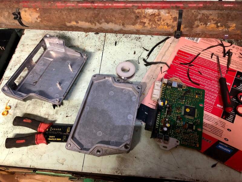

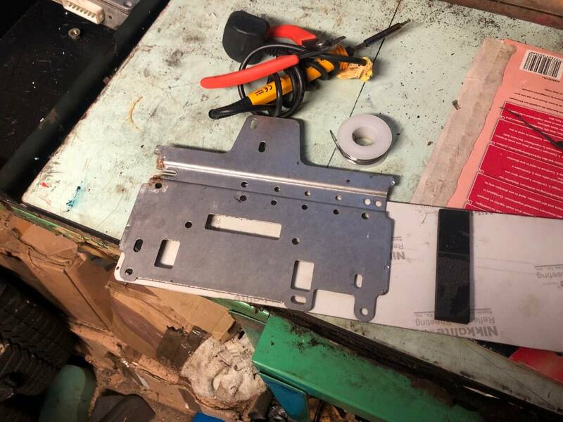

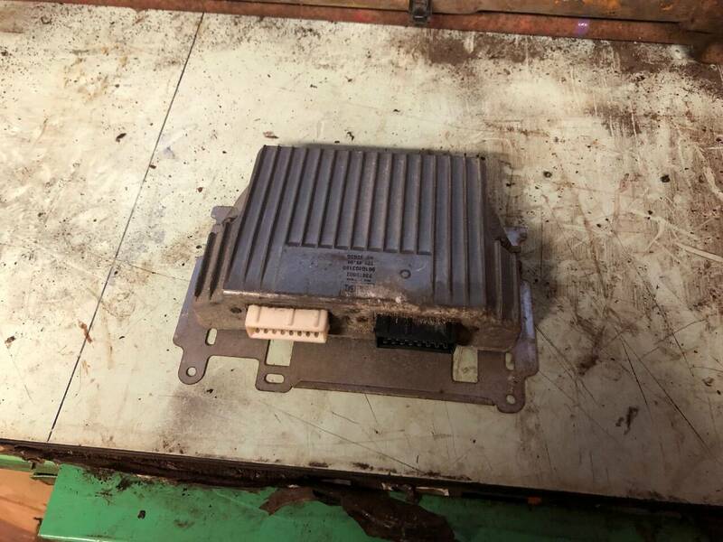

Whilst in here I removed both the ABS and suspension ECU’s. I then noticed that the suspension ECU was rattling inside.
Best open it up then.
It was a right bastard to get in to. It’s sealed with some sort of rubbery foam. I had to use a hammer in chisel to prise the clamshell open, then I had to hack around the connectors with a knife. Amazingly it didn’t get totally annihilated.

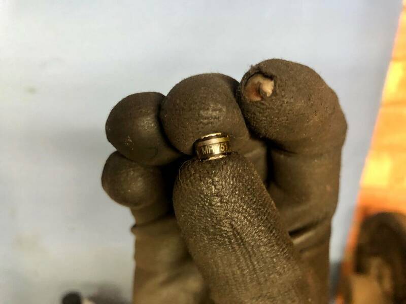

This was what was rattling around inside.
looks like some sort of diode. I think it lives here.
It says MR751 ZL9438 on it and has the diode symbol on it. It would appear to be some kind of diode…
My plan was to work out the polarity of the circuit and then solder it back on to the legs, but since googling the number on it I realised I can just buy a replacement component so I’ll probably do that instead.
I also think I have some dry solder joints
So I may have a go at those in anger too.

i could never get blink codes to work on mine but never tried with my power probe
In my head it made sense as it was precise enough to get on to the terminals and had a momentary switch for earthing the pin. It was an unforeseen bonus that the light on the probe would also flash out the code.
That said, every time I look at an 80’s or 90’s ECU I get Kraftwerk’s song Computer Love going through my head on loop, so who knows if my mind can be trusted.
More ECU stuff tonight.
But first! The Land Rover was jealous of all the attention the Citroen was getting, and so it decided to have its number plate drop off.
Using a template* I drilled the plate
and surprisingly my big drawer of fasteners provided some number plate screws
Sorted:
With that sorted I got my power probe out for the millionth time and checked the pins in the suspension ECU plugs to try and determine which way round to put the diode. I am re-using the original for now as I need the car mobile - I can replace the diode later.
Some shonky soldering later:
It’ll do for now.
I cleaned what I can only describe as Satan’s ejaculate out of the sealing area of the case and put everything back together.
I will resell it properly once I know everything is working.
Ive since plugged it in and turned the ignition on - nothing blew up.

Wouldn't it be amazing if that's the smoking gun, hope it works! 🤞
Dry joints never help anyone
Weirdly, despite the damage inside the ECU, I didn't appear to have any issues with the ride height system. It was a bit noisy (as in I could hear relays clicking constantly after opening doors etc.) but it wasn't throwing warning lights. So either it was happy, or the bulb had blown 🤣 The relays aren't as frantic since my 'repair', so maybe it has done something.
I'm hoping the ABS light is as simple* as replacing that sensors or repairing the wiring/cleaning the connectors. I'll find out by the weekend hopefully!
Fairly sure the diode in the suspension ECU was a common work around many years ago, common in the XM community, that fixed* the things going into sport hard mode all the time (this is from memory when i was really into citroens 20 plus years ago now though, so i may be mis remembering.
