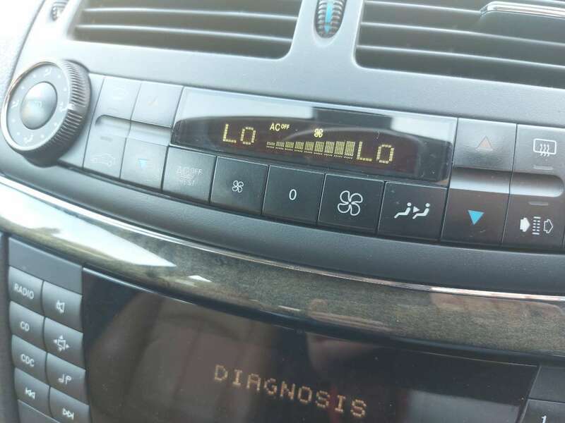

Leaving Brooklands, I put the air conditioning on LO as the temperature was almost reminiscent of summer and no cold air. 🥵
Plugged the iCarsoft in once home and the compressor isn't running. 🤔 190/200psi in the system so I'm thinking does it need a reset or something daft? I had another battery hooked up when fitting the new one so nothing was lost. Google.  I see posts about resetting and it was fine after plugging iCarsoft in etc etc then I noticed the display.......
Seriously? 😳  The display had the sun on it at Brooklands and was unreadable.
That's better, cold air. I think I might have accidentally pushed the OFF/REST button with the ignition on when I went shopping recently to enable the REST function. I normally use the 0 to switch the AC off, nearly two years of ownership I now know there's two ways. Investigations required in greater depth.

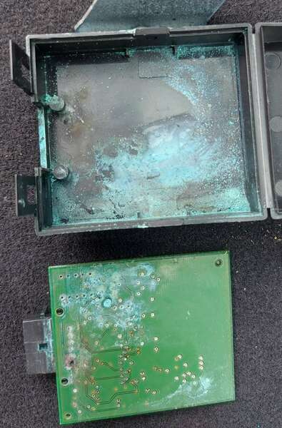

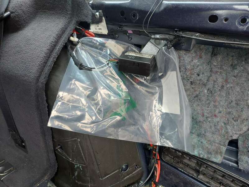

Fitted a replacement anti-tilt module and plug to clear an intermittent code. As posted previously, the original was destroyed by the rear washer hose popping apart and spraying straight on the connector flooding the unit. Judging by the previous repair this is not the first time but should be the last with the addition of a plastic bag cable tied around the offending hose.

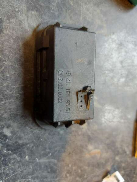

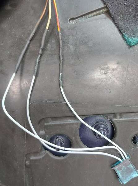

Also had another go at the intermittent tailgate closure switch previously repaired by an accredited insurance repairer. Incorrect 4 pin plug bodged on with wire twists and the switch socket buggered to fit. Soldered new pins in as one had broken due to the plug not being supported. I  have a plug and socket off a PCB and fan that will suit but can wait until I dismantle the tailgate again. Seems to be working at the moment.

Accessing the backup battery I noticed the pollen filter cover water drain gutter mouldings were filling with dirt so I gave that a wash, the pollen filter is a bit dirty and over a year old now so an Autodoc order is imminent as I also want to replace the front springs. The joys of identifying the correct springs, might have to take them off to measure and see if the colour codes can be found. I miss the days of simple suspension, "uprated springs sir, standard ride height or 1" lowered?"
