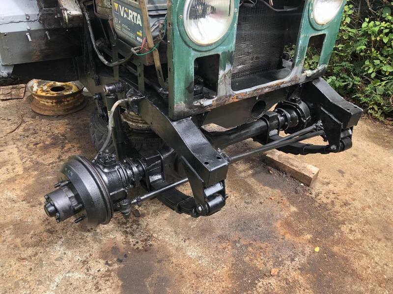

That’s the welding all done, time to put it all back together. I have acquired a posh ratchet tool for electrical connections and my own weight in paint, electrical hardware and fripperies like new lights and track rod boots. The second shot is a work in progress but the welding gas held out until it was fully welded up.

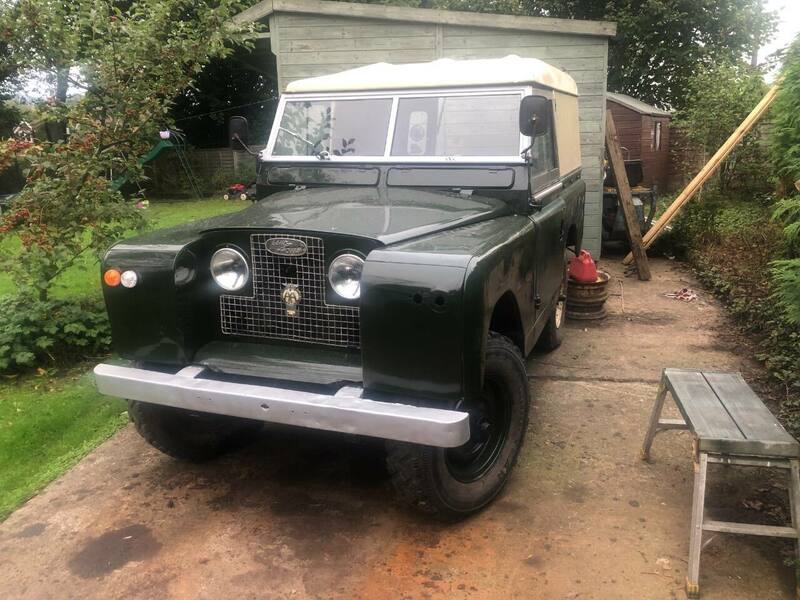

Update, mostly painted, just a door, tailgate and 4 wheels left to paint.
Rebuilt windscreen with proper never set putty stuff which cost nearly 25quid but looks good. My mate insisted on rotating the screens to equalise wear, so I humoured him on this.
Interior all back in, apart from painting just got to refit the driver’s side door lock and fit and wire six lights and the tow pack, reattach the roof and put the rest of the bolts in the rear crossmember. Weirdly all the electrics I’ve refitted all work perfectly which is a bit worrying.
Should keep me going for a few more decades I reckon.

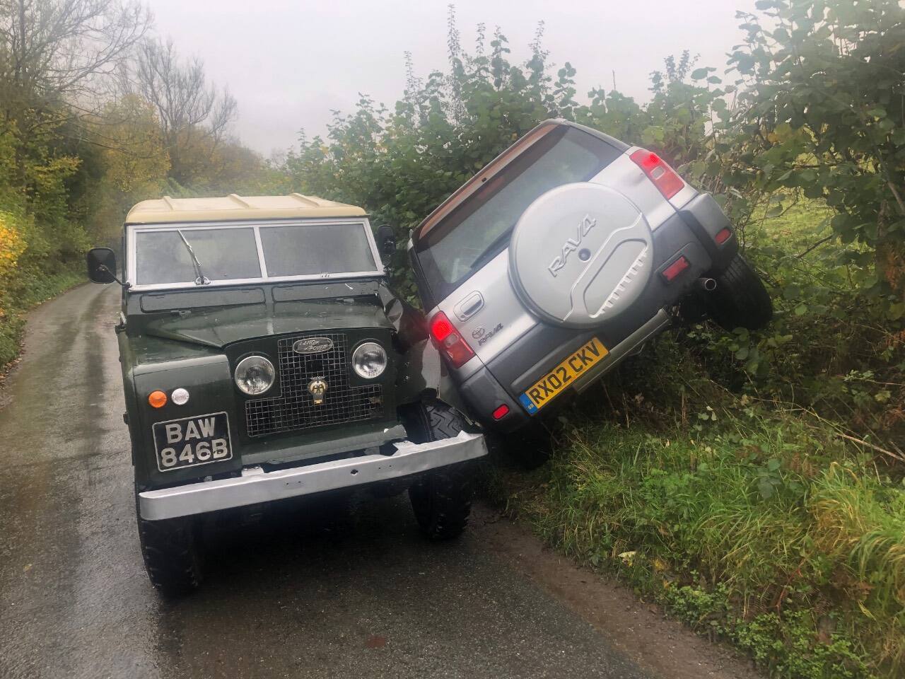

Bollocks. Made it all of three miles up the road then I was struck by a low flying Rav4.
Completely obliterated one wing, damaged the bonnet and bumper beyond repair and pushed the bulkhead back a centimetre on the left hand side.
At least no one was hurt.

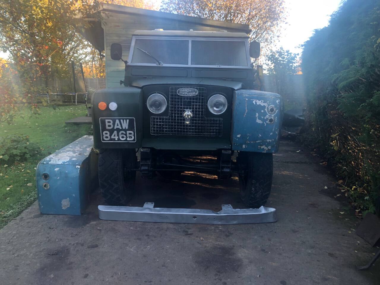

Right back to work on this. I did find a spare pair of very straight looking wings and a bonnet (the actual bonnet this vehicle started life with) hiding behind my dad's goose shed. I have ordered a new bumper too.
I am doing all the work myself and not claiming on insurance. The whole insurance thing left a very sour taste in my mouth, its all about trying to extract inflated sums of money from other people for things like bullshit injury claims or hire cars.  The main issue is time, I would like to have this all sorted quite quickly and not sitting there for months whilst the insurance people um and aah. Yes this leaves me out of pocket (the woman who crashed into me originally said she would settle outside of insurance and agreed a settlement but then reneged). I can't really see how I would be better off if I went through the insurance, I would certainly be worse off in terms of increased renewals in the short term whilst they sorted out blame.
Annnywaay, I have the parts and the paint. I need to fit both new wings really, despite the colour, they are off an ex military Land Rover hence the over and under lights. I'm not sure where the number plate will go, military plates are smoller, mine might still fit in the gap under the lights. I could conceivably fill the lower hole (fnagh!) and reposition them but I will look at that before I paint them.

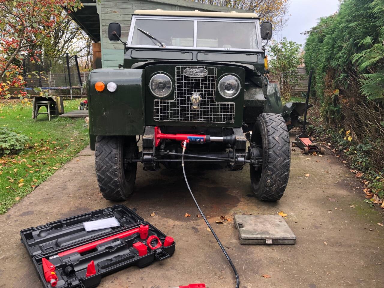

First job was to straighten the chassis which was bent about 1 and a half cms sideways and about 1cm down. Sorted!

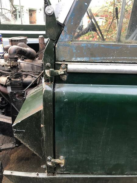

Next job was to reinstate bulkhead in the upright position. Took a few goes but...
Success! The door was no longer rubbing on the bulkhead. The banana shaped door pillar is a remnant of a similar accident 45 years ago. The door actually closes almost flush now which it never used to.
The mangled tinwork on the upper door pillar was unmangled using the spreading jaws and a panel beating hammer
Apart from a slight ripple which won't be visible once painted it is as good as it was before (if not better).
I've test fitted the shineh new bumper, all that need fitting is the new wings and bonnet then its good to go. Might give narrow country lanes a miss for a bit though.
