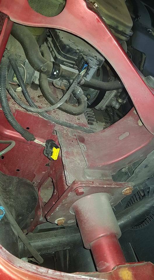

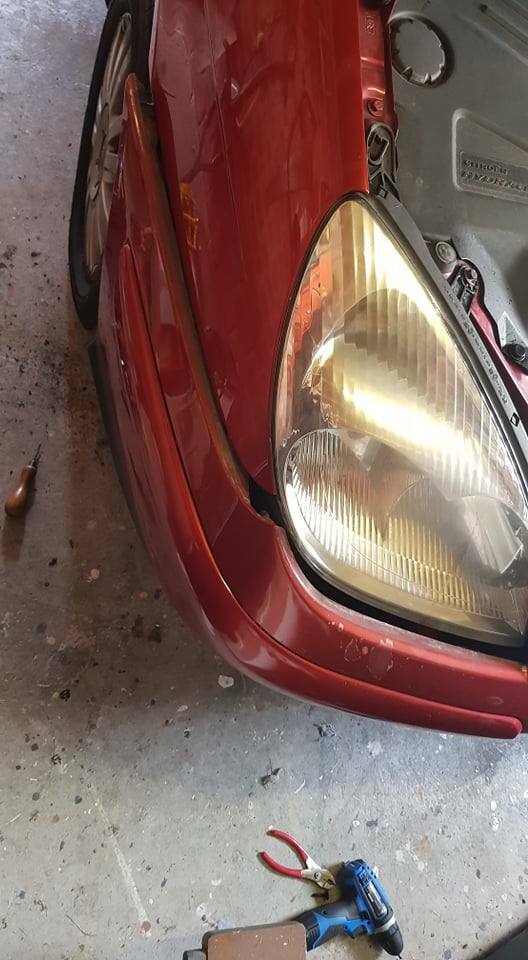

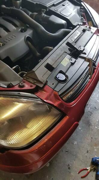

maxxo Posted August 23, 2021 Author Posted August 23, 2021 2 hours...... 2 hours to remove a sodding bolt from the front bumper i say remove, obliterate it anywayyyyyy today was the day i decided to replace the faded headlight unit we will gloss over the language which i used...... here is the bumper, in it's hanging off position, surprisingly no clips actually broke! but look how yellow it's gone again, cos some idiot didn't put UV protection on it when he cleaned them up said idiot is me once that was complete, i decided to destroy another bolt this time it was the little one on the top of the headlamp cluster don't worry i made a bolt substitute curious as to what it looks like with his eye removed? well here it is also zero rot, zero signs of accident damage in fact there isn't a single spot of rot on this whole car so here it is, really a vast improvement smartended the front end up very very nicely! i'm really chuffed with this car, absolutely rock solid underneath, drives beautifully and i think i really got a good'un here richardmorris, Mrcento, myglaren and 1 other 4
