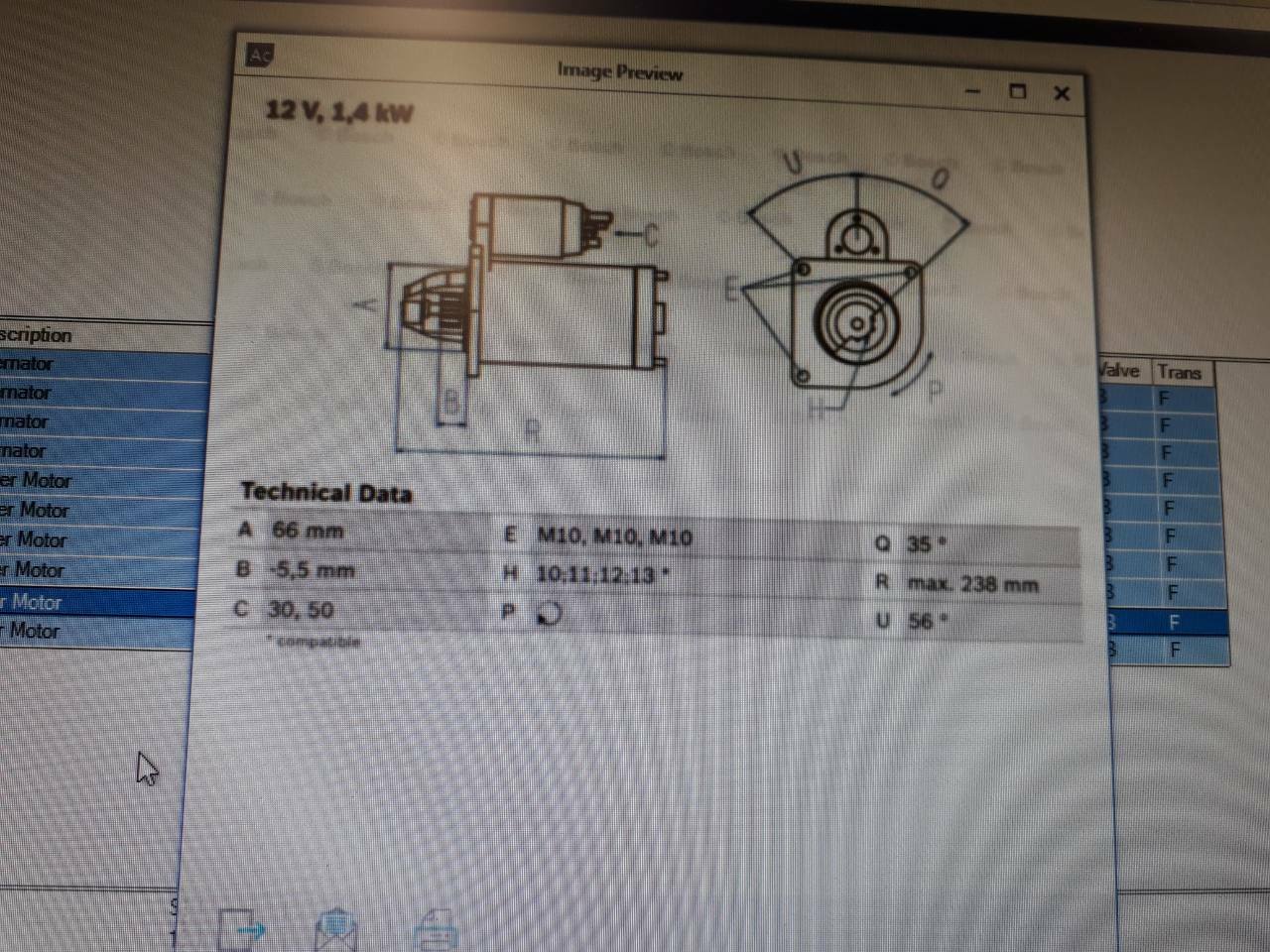

Try a good starter would be the first thing. You have high fuel pressure needed and they struggle to build it turning over slowly. (All common rail derv similar).
Lift pump would not do anything for this issue I’d have thought.
Think you could get a 1.3kw or 2.0kw starter on these. The 1.3kw is shite, especially after 12 years odd.
first thing to check is around the fuel filter housing, just make sure it's sealing correctly
then yes, i agree a 2.0 kw starter would help massively
okay so the lift pump runs when it cranks for ages
checked under the bonnet can't smell diesel at all or see anything that could be wrong (albeit i'm no expert on common rain high pressure injection systems)
this is really perplexing now
Start simple, is your fuel filter filthy? They're a simple change and rules out it as a problem.
apparently it was replaced before i bought it
i reckon replacing it anyway is worth it, cheap enough too
13 minutes ago, Andyrew said:
Looks like you may have got the 1.3kw jobby from the factory anyway.
hmmmmmmmmmm
very interesting, i imagine after 18 odd years it's not the best either
might be well worth wacking the 2.0 kw model onto it
