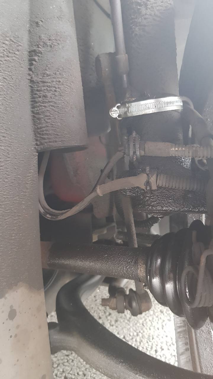

also did some fixing, LDS leak from the return pipe again
i dare it to leak now!
199814910_4138132079577527_9145234793262279108_n.thumb.jpg.b6ffefb3deaa35407b096347c4755a08.jpg

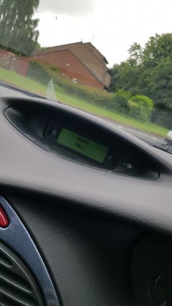

i had this beeping at me
206992941_4173397329384335_1633646554621496899_n.thumb.jpg.2fddddecc5855fd43b6093aa64db2b52.jpg
204493530_4173398036050931_7092496129024561834_n.thumb.jpg.34d0ea1a6cd0a7dfd3941c8e6c9f1c4e.jpg
pulled over up the road and turned it off and on again, it started perfeclty and the messages vanished
sooooo
it felt like fuel starvation, my first thought was the in tank pump, but now that doesn't seem to likely as that would cause running issues and it's running beautifully and has all the power still
i suspect, somewhere air is getting into the fuel system as it drains back to the tank, worse so facing uphill as gravity takes an effect
this is the most pressing issue which i need to sort, going to check the pipework around the injectors tomorrow to damage
there is some liquid around the injectors but it must be oil as it doesn't smell of diesel at all
any advice is much appreciated

Firstly, is the lift pump working?  It's under the back seats and you'll hear it when turning the ignition on.  Bad lift pumps will cause all sorts of poor starting, loads of cranking but not much starting, usually they run fine when going.  Next time it's cranking but not turning over and if it's not whirring give the top of it a few thumps, often it's enough to coax it into life again.    They do have a habit of going, I've changed one on an Xantia and a C5.
Secondly, a BSI reset is a bit of a cure all for oddball status messages.  You'll find plenty of guides online, just don't go and plug the battery leads off.  I've paid for that mistake before.
I think there's draw from the tank when the high pressure pump is working that you don't notice bad lift pumps when it's running.  At least I didn't on both of mine.
as far as i know the lift pump was running, i'm 99% certain i heard it
i'll re visit the location tomorrow, leave it for the same amount of time and see what happens.....especially listening out for the lift pump
i think the oddball message was from the battery voltage dipping....now....why it's dipping to the point of causing random messages when a bit warm and after a 15 mile journey is another question
apparently had a new battery a month before i got it, could it be the battery? going to use my tester on it and see
it's weird, it runs beautifully constantly, never had a single running issue, certainly worth checking the pump though
god knows how much that'll be to change
Lift pump is a DIY job all day. It's a little smelly, do it outdoors and do it when the tank is in reserve.
You'll need a big strap wrench maybe to undo the locking ring but otherwise it's a simple job. The system is self priming too. Just keep cranking and it'll fire into life eventually.
And yes, low voltage will cause all sorts of weird ECU issues. They do not like running on sub 12v
This is pretty much the same on the c5. The lower the fuel the less mess.
that actually looks pretty easy
any guaranteed way to tell if it is the pump?
If you don't hear it and it's not starting that's a guaranteed way. If it's not whirring or it's very sluggish sounding than it's than it's likely to cause starting issues. Once it's going and running it's hard to tell. They are common problems, especially as lots of the pumps are now 20 years old and have been sucking up variable quality fuel for years, it's on the unfiltered side.
I don't know if the ECU monitors the low pressure side of the fuel system so I don't know if Lexia would pick up on it.

Regarding the air bag fault, my 307 HDi does similar things if I’ve left it for ages and the battery is a bit flat. I think the airbag module doesn’t like the low voltage and throws up a fault. This is why it clears next time you restart. It looks like your excessive cranking dropped the battery voltage too much for it.
