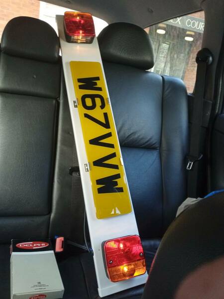

Several crimps later, we have a working tow socket. Just need to wire the recommended tell-tale buzzers in.
cheap tow board bought, new numberplate and snap-fixings assembled.
I mean, I may never actually use it, but...

Mondeo buzzers wired in, now no indicators on the board. I had assumed that a 12v buzzer would still pass enough current to allow the indicators on the trailer board to flash... hmmn. Maybe I should actually read the instructions...

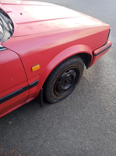

Bluebird spare wheel was just as buggered as the punctured one.
punctures also too close to each other to patch. Hey ho, new tyre time. More expenditure I don't need!

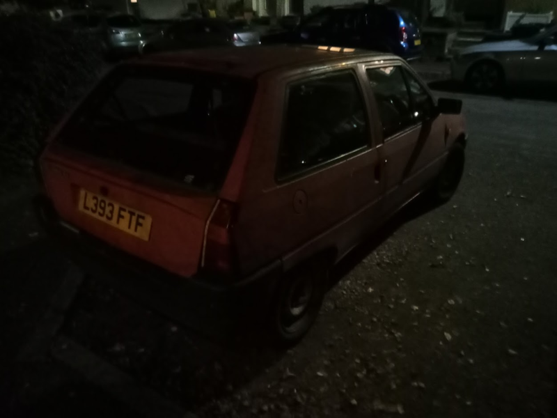

Meanwhile, got home to find someone's parked an AX outside.
only one neighbour has so far asked if it's anything to do with me. Reputation much?!

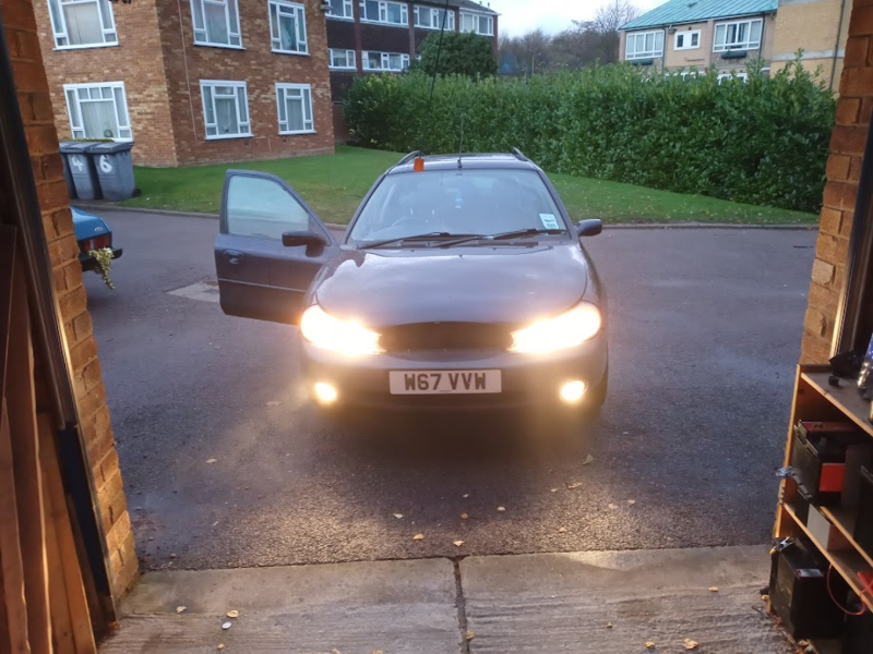

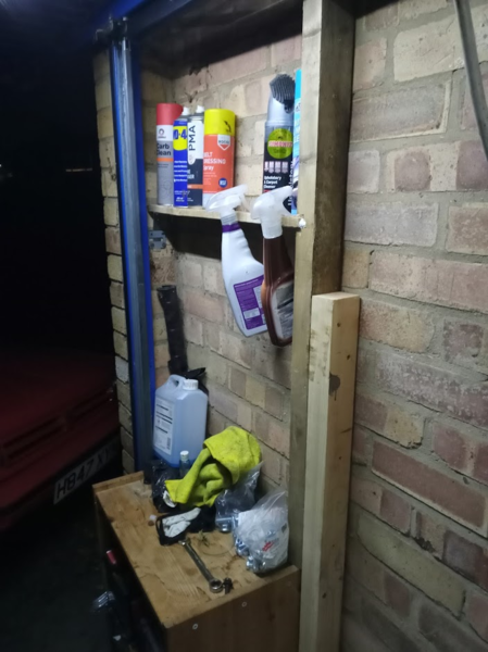

With darkness falling early I went down to the lockup to put the wheel with the fresh tyre on. The LED system works wonders at these times, especially with one set of LEDs being on a long board, perfect to take outside to do a job.
Some timber was being thrown away at work recently, so I nabbed some of it from scrap to add another cubby-hole shelf, this one by the door to save traipsing to the back every time I want a spray of something simple.

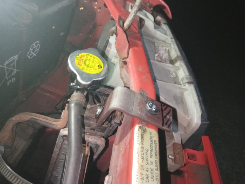

I also discovered a rubber mount buggered for the radiator. Temporary repair completed.
Looking downstairs, there's a metal L bracket that seems to have gone, which has presumably put extra weight on the rubber and caused it to go.

I unexpectedly had a bit of free time, so I decided to have a look at the rad mounts. The original rubbers are unobtainum, or at least not without paying ridiculous sums.
A bit of steel bar later, this is a trial fit.
I think there needs to be a repositioning of the upper hole. I'll do that, confirm it fits properly, then use that to make up two new ones of the right size methinks. Rubber washers should hopefully dampen any vibration. Total cost, £0 rather than £50.

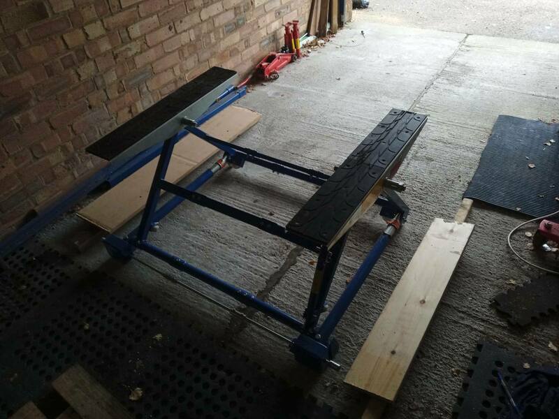

Back at the lockup, and I'm looking at options for the lift. I can't drive on/off it with the Capri as it fouls the low exhaust and diff. And the garage is too narrow to slide it from the side.
So what I'm thinking is...
...make up some low timber ramps (imagine these, but up to 3/4 length of the garage). About 3" off the ground. Wide enough to reverse onto without being too precise.
Hopefully that'll mean I can reverse in, the low ramps take me up just far enough to be over the lift, which can henceforth live in the middle on the ground.
Sensible plan? Completely flawed?
  • N19 changed the title to N19's fleet - lockup lift
Will you ba able to move a ramp when the car's in the air to access from the side - or do you only need to get under each end?

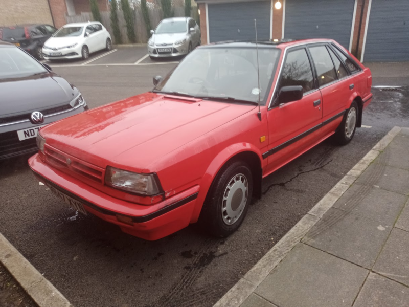

The Bluebird went in for MoT today.
Hmm.
That'll be a new exhaust then.
And the sills are a bit crispy...
image.thumb.png.b2233fedd1d76a7715b96bdd4058e8f8.png#

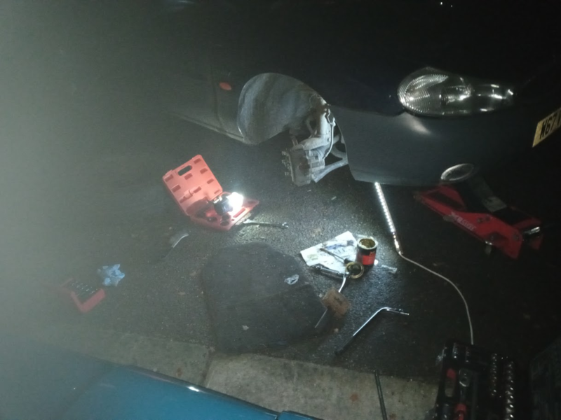

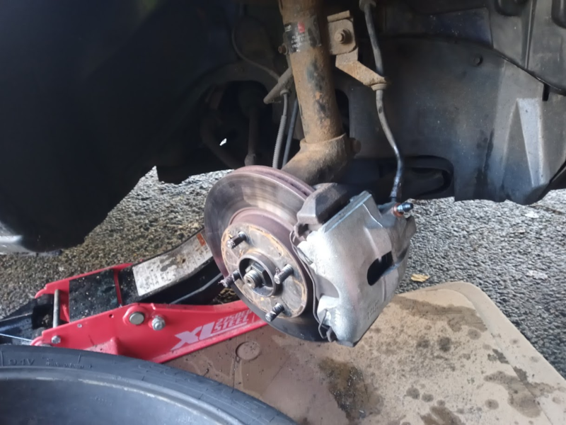

Driving home from work today and I can smell hot brakes. Hmm, that's odd.
I stopped off at the lockup and can feel the heat coming from the o/s/f wheel...
Caliper sticking, dismantled but it will only retract with a thump with a persuasion tool. Fiddlesticks!
Naturally, this all happens around 6.30 once most of the motorfactors have shut, but Midnight Motors in Watford open late and should have a new caliper by tomorrow morning.
I actually had a productive, enjoyable day without any real f*ck-it moments. This scares me!
A run to the motorfactors produced an exchange caliper :
taking the least broken fleet member
There was a bit of faffing to get the old caliper off, and I'm always super wary of rounding off the unions. But an application of crack-it spray worked just before I threatened it with a blowtorch!
Right, clean everything up, new caliper on,
work in progress shot inc mandatory lucozade
all back together, brakes bled, and behaving well. Hurrah!

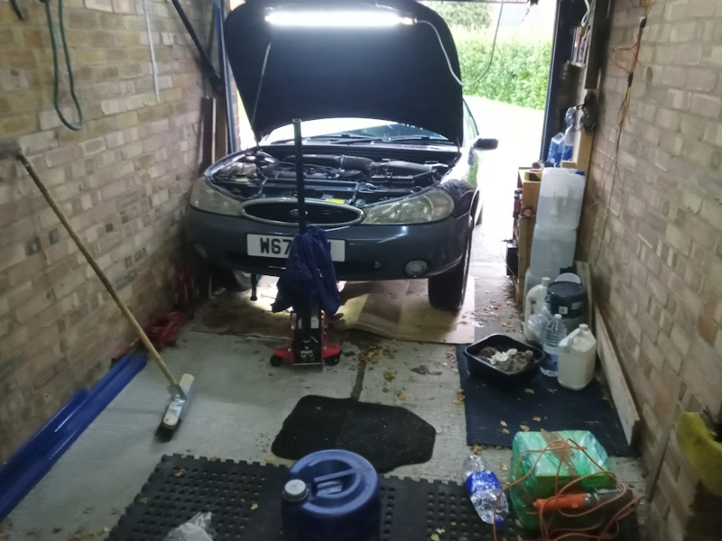

Having been called into work on a Sunday to put right some issues, I headed off in the Mondeo. It was not happy at all. Engine stuttering, revving but failing to provide power, really a struggle to do anything. Gave up and left it outside the local garage with the keys through the door after a nice text with the owner - manic week next week and no time to look at it. It's not the clutch (replaced last year, and the third-gear test gives a healthy stall). Idle is all over the place too.

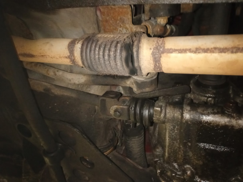

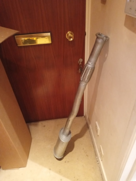

So the Bluebird took up the mantle adequately (although, with the exhaust still blowing, noisily). Looks like the centre section of the exhaust can be had for £70 or so, so I'll order one up tomorrow and hopefully change it at the weekend. I had a session of WD40-spraying on the bolts earlier, and I'll do a couple more during the week to hopefully make the process a bit easier on the day.
The postman has been... now just to fit it!
No gaskets supplied - not fitted an exhaust before, so not sure if that's normal or whether the paste is sufficient?
  • N19 changed the title to N19's fleet - exhausting
I am not familiar with the exhaust on these but I would assume that the joint at the top of the picture must have a gasket simlar to picture below?
Amazon.com: Walker Exhaust 31388 Exhaust Pipe Flange Gasket : Automotive
Yeah that's what I'd assumed it'd be! I may just have a nosey around the motorfactors on Saturday. I have some generic gasket material as well.
